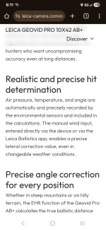

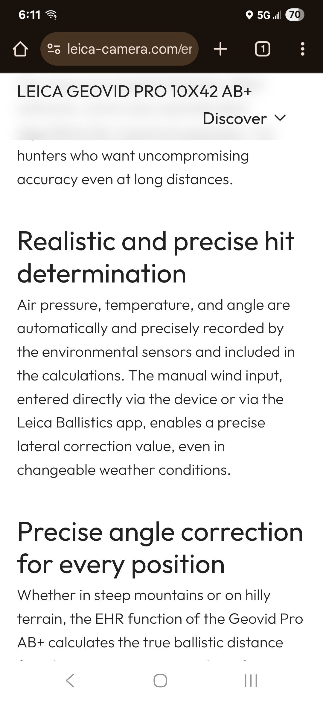

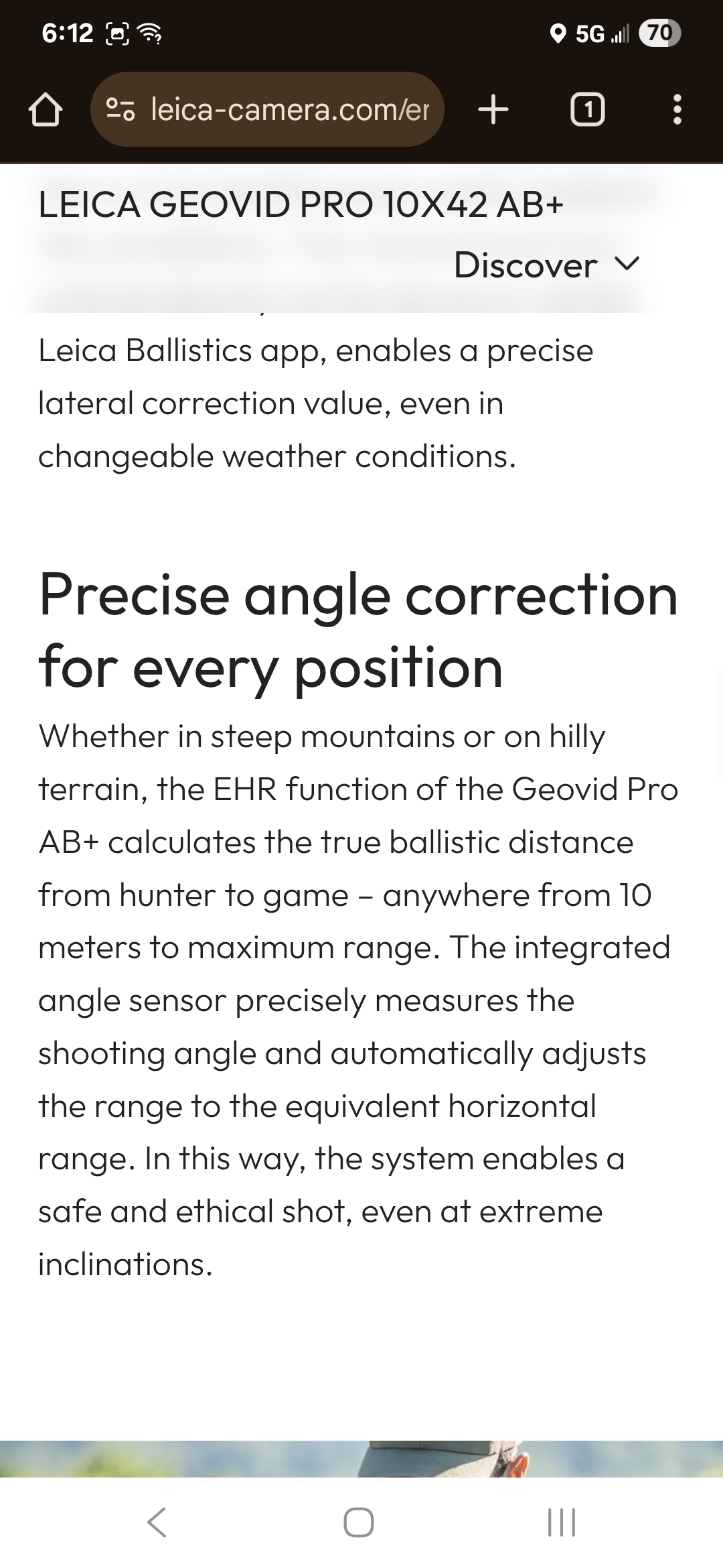

    Hi I asked this in another thread on the vector x, I’ve also emailed saphron/vectronix with no response. I’m going to hopefully go out and verify this for myself today or tomorrow but does anyone know if any of these bino’s that utilize AB are giving corrected firing solutions? I know to see the angle corrected distance on the vector x, the ballistics needs to be off. I have no idea if the firing solution is LOS or corrected distance. Also I’m interested in knowing if they are connected to the kestrel would that give a corrected solution or if the inclination needs to be entered manually
    The Leicas use angle in the ballistic solution. Can't speak for the rest, but it would be stupid for them not to include that in the math.
    Reactions: notacos4u and codym
    Agreed, I don’t why they can’t just state it. I know there were some at one point in time that didn’t, or allegedly as I read it on another forum. Being that I never got an answer I went and checked from the steepest angles I could find in my shooting area and to be honest it literally made no difference which was surprising the LOS and EHR were all within a few yards. I’m going to have to find some steeper terrain to try to verify but I think for 99% of the match shooting I do it won’t matter
