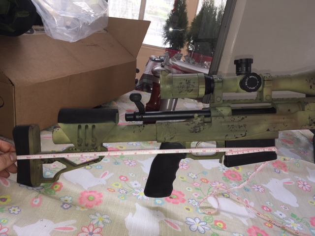

What’s up fellas, I’m knew to the hide and have a rudimentary question that seems to have been covered several times already but I’m having issues with setting my LOP on my savage 10 in an XLR industries chassis. Elbow pit to bent trigger finger, correct? I come up with 12.5” but after adjusting the but stock to that I’m all up on the damn scope. Just wanted to check that I’m looking at this right before I move the scope.

Thanks guys. sgtsmmii kinda nailed it. I tried kl3309 take on it, as the 12.5” was just way to fuckin short, and moved around until it felt right in all positions and came up with 13 3/8” and I’m 5’9ish so using the 13.5” +\- an 1/8” per 1” came out on the money. Its pretty wierd as I’ve always been told the elbow to second knuckle on my index finger but have never needed to use that method until now . I will stop advising that’s the way to do it because that was way too short! Thanks guys.

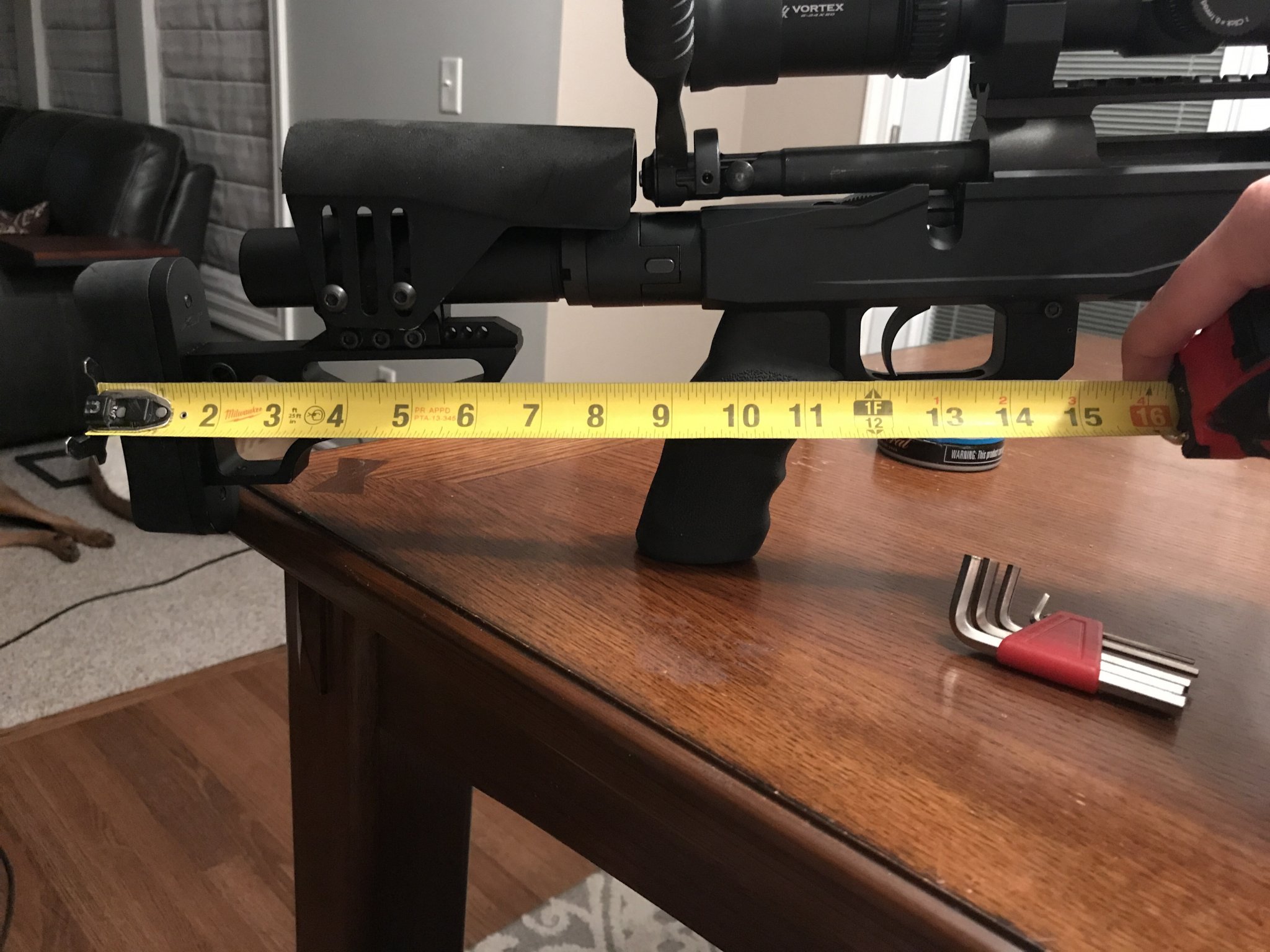

i also measure myself at a 12.5" LOP......and thats what all my other match rifles are set at......however on the XLRs it feels really cramped setting it that low.......i ened up bumping my stock length out around an inch, and have plenty of clearance, hanvent really noticed any difference in shooting with the 1" extra of pull
