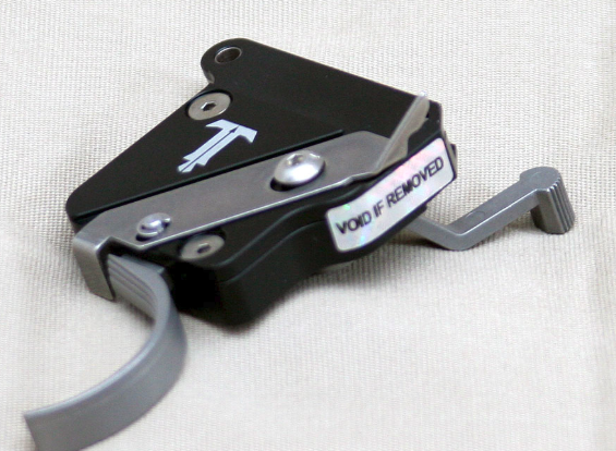

Yes, any rem 700 trigger will work. Just take the bolt release off. Should be a simple screw or e clip or two as shown here to remove it from a new trigger.

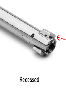

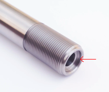

No, remage prefit barrels wont work. The bergara uses the same threading but the breech face will be different.
The remington 700 bolt has a recessed bolt nose, there is a counterbore cut in the barrel to allow for this
7047003
7046997
A bergara has a coned bolt nose, as such it can not properly fit into a proper remington style barrel. You will have to have this done special for a new bergarra barrel, not prefits on the shelf ready to go.
7046998
7047002
View attachment 7047003View attachment 7046997
View attachment 7046998View attachment 7047002

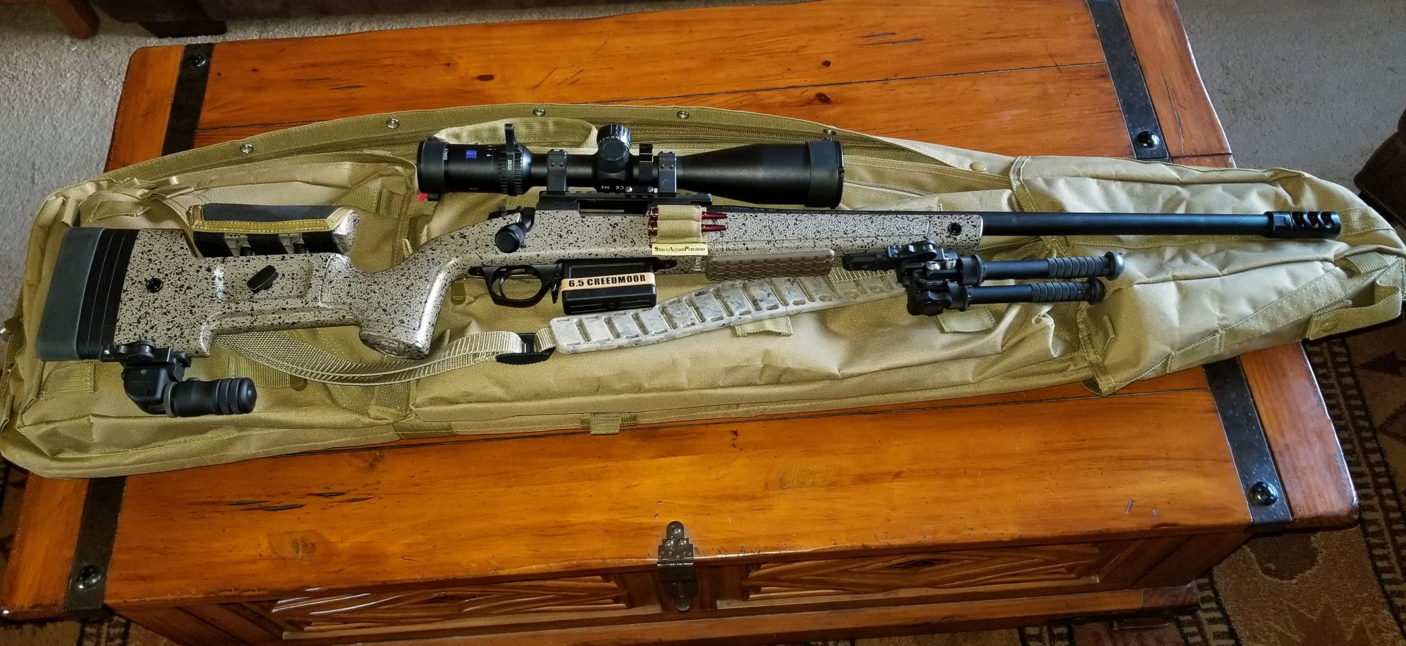

Bergara will rebarrel from what I've been told for $500 with stainless barrel, cerakoted, test fired, labor and shipping and handling included. As for aftermarket trigger I've currently got a TriggerTech Remington 700 Special for right hand, no bolt release, curved with PVD black coated safety mounted in mine. By the way BassPro has the Bergara B-14 HMR in 6.5 Creedmoor with a 24" barrel instead of the 22" as everywhere else.

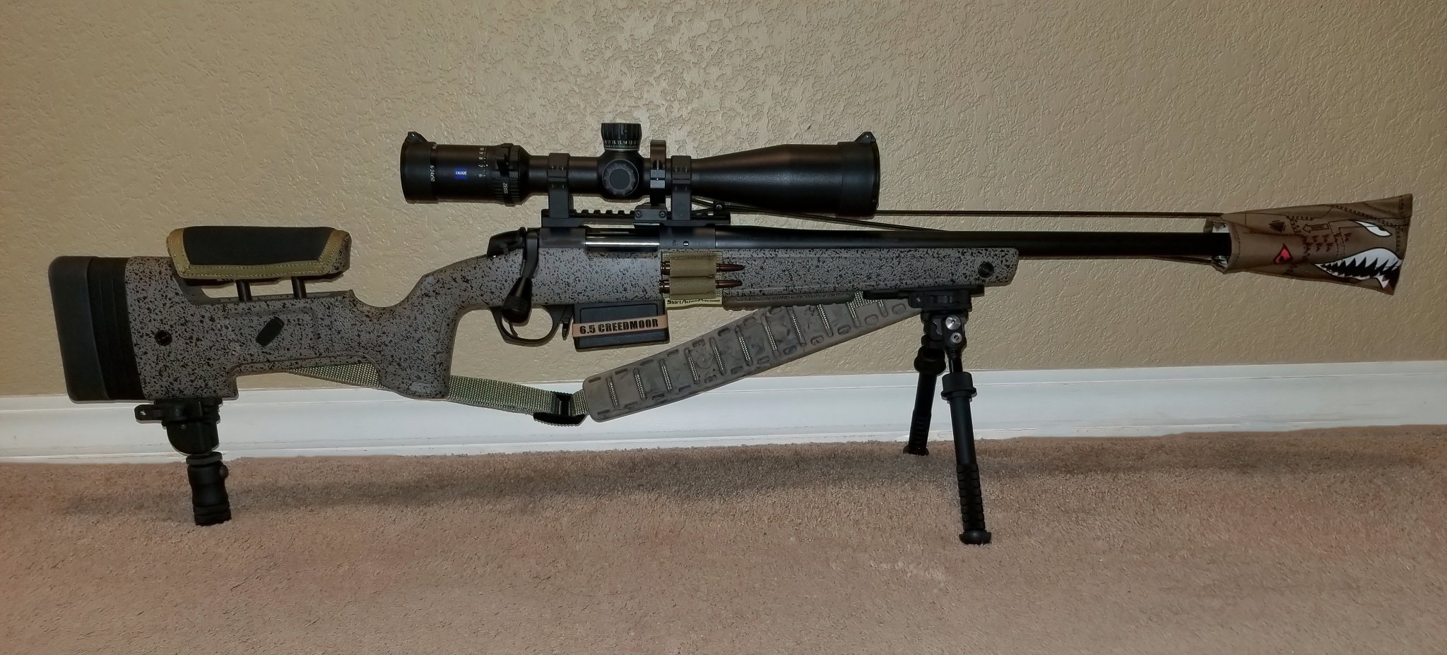

I wonder if they'd put a longer barrel on their .308. Not a huge fan of the 20-incher on the HMR.
Give them a call and ask, it might change the price by a bit but I'm sure they'd probably do it since they've been in the barrel making business longer than the rifle making business, and produce different lengths, contour, and caliber bolt action and AR barrels. Rifle barrels from Bergara grace a lot of actions from other manufacturers including custom shops.
By the way, forgot to mention, no need to remove the bolt release from any of the TriggerTech triggers whether you order the Primary, Special, or Diamond you can order them just as you want with, or without and several other options from TriggerTech. That's what I did, hassle free and usually took a week from date of order.
https://triggertech.com/collections/bolt-action
