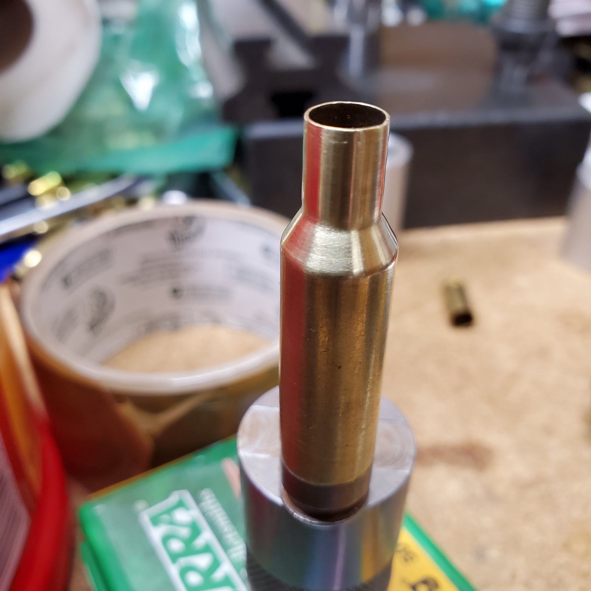

I got to find the post, but if I understood it correctly, someone was using 277 fury cases, with the stainless case head, and getting high velocity with 30 cal bullets in the modified cases. (Maybe it was @45-90 ?)
Not exactly a 308.
But maybe those cases can be made for 308 so that 70,000 psi or higher is ok?
Got to find that post…

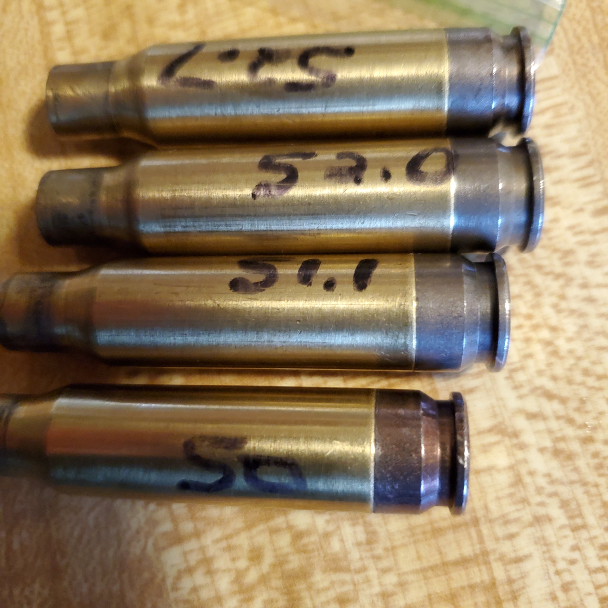

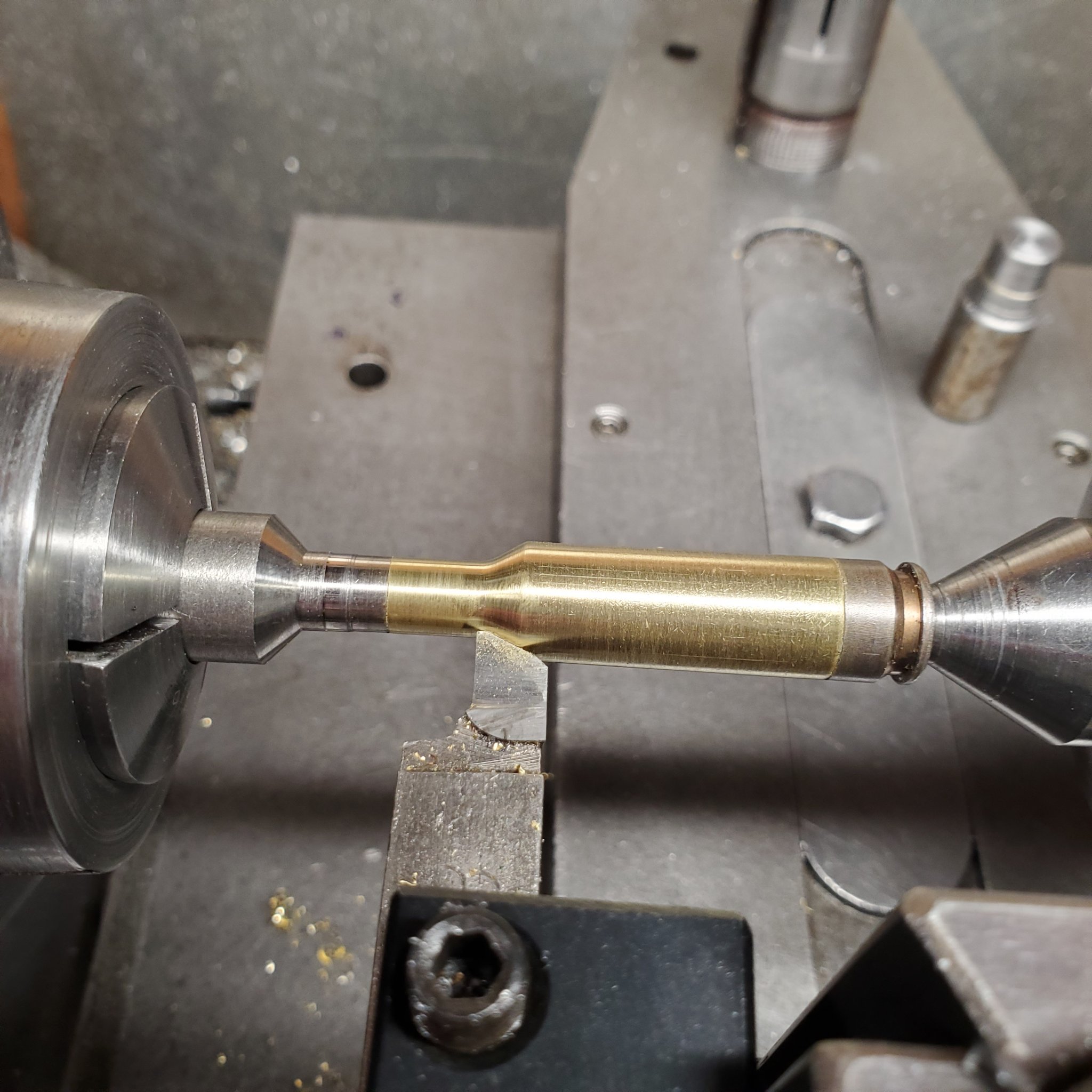

It was me, and the cases can be made in 308 easily...and 6.5 CM, and 358 Win as I have done...other calibers too.
It's been discussed on how it's easily accomplished...and ya don't have to go full 80,000 psi, to see an improvement. Ain't gonna explain it over and over, took pictures to show what I used...these are 6.5 CM neck turned and finished, needs OAL trim...and 308 fired cases, plus a 358 Win case necked up. I like Lee resizing lube for the task as shown.

Swaging a bullet down "in barrel" to obtain a higher BC?

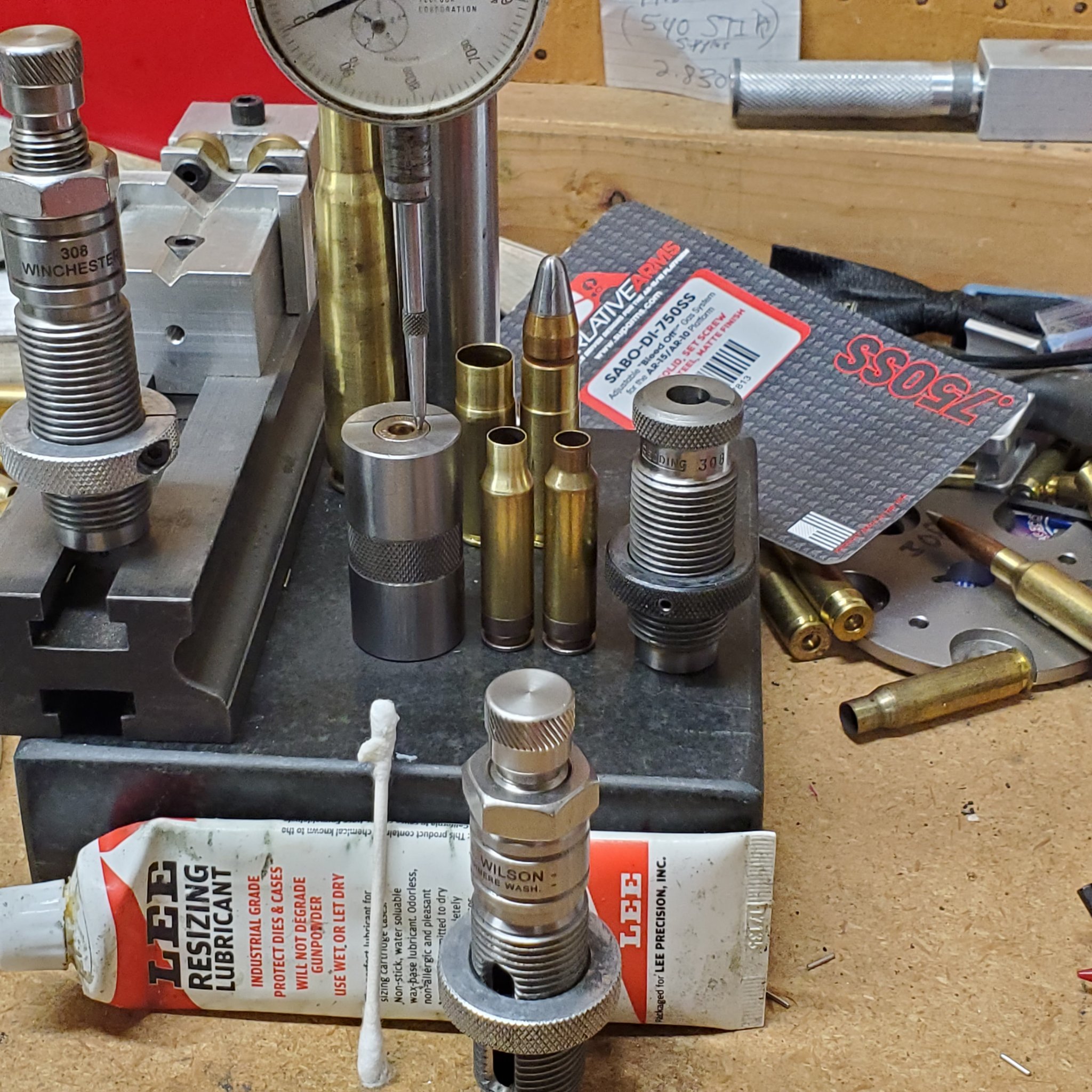

I swage .458" jacketed bullets to .452" all the time plus a bunch of others..
Example 450 bushmaster 16 twist 500 gr jacketed SP 458 to 452 in a die... not in the gun...plus they probably wouldn't chamber.
I swage them down before shooting...in a Rockchucker press, lube em up run through the cheap available Lee bullet sizing dies, or make your own or polish them to any size ya need.
50BMG takes more pressure when sizing, so there moved to an arbor press... the rest a piece of cake.

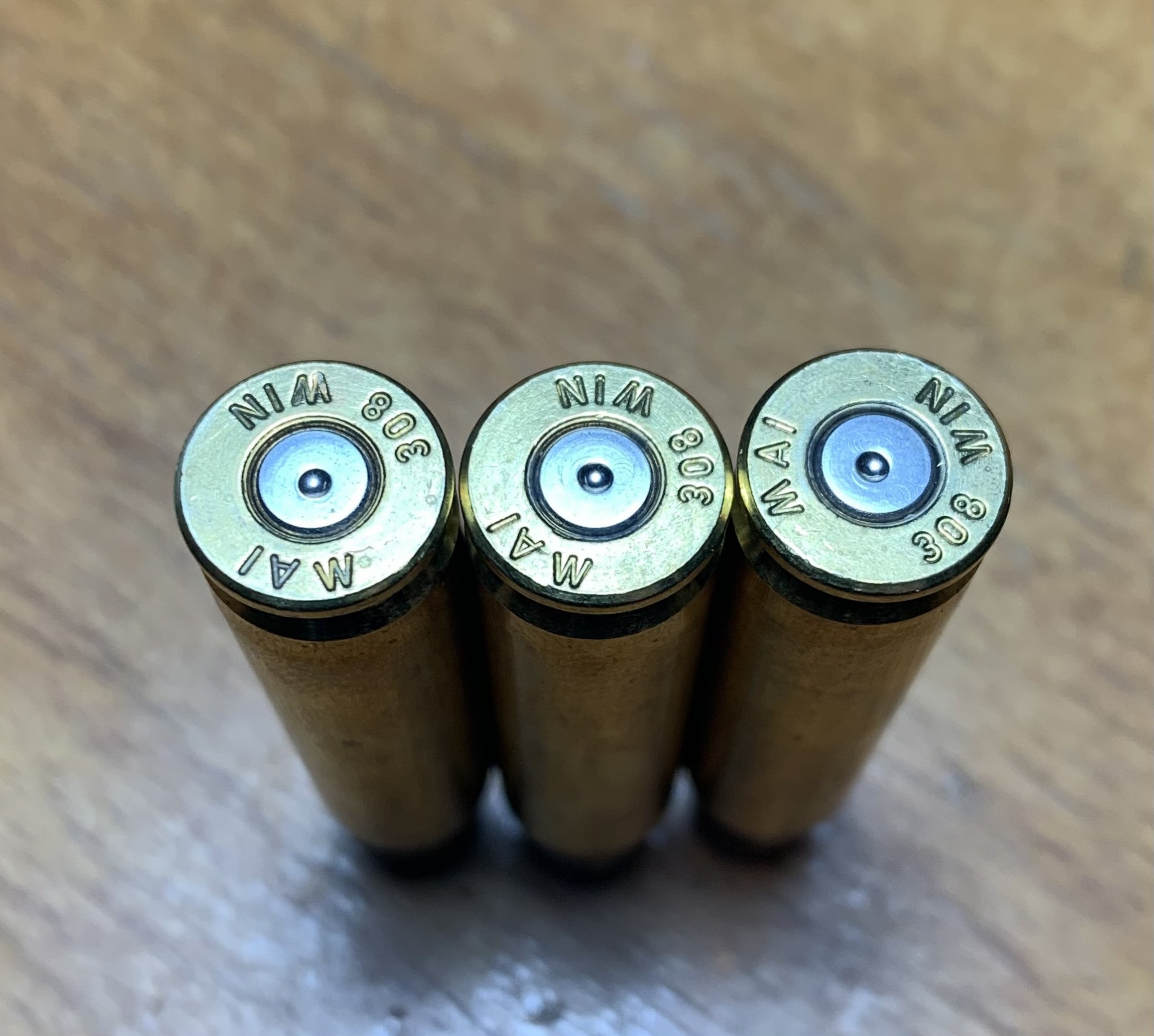

Anyway I ran 3 loads in some Virgin primed MAI (Norma) 308 LR brass. Neck mandrel &od/id chamfer was only prep.
26" Osprey 10 twist 308 Win PVA barrel.
160 Flat Line loaded 2.954" = .018 off lands. G7/.278 G1/.556
Primer ?
Lever
47.4 = 3002 SD(P) :devilish: 5.8
47.8 = 3024 SD 10.4
48.2 = 3055 SD 15.1 Primer flat, but no cratering, no hard bolt lift. SD headed up. Pockets tight.
None of the above are compressed loads 48.2 is close.

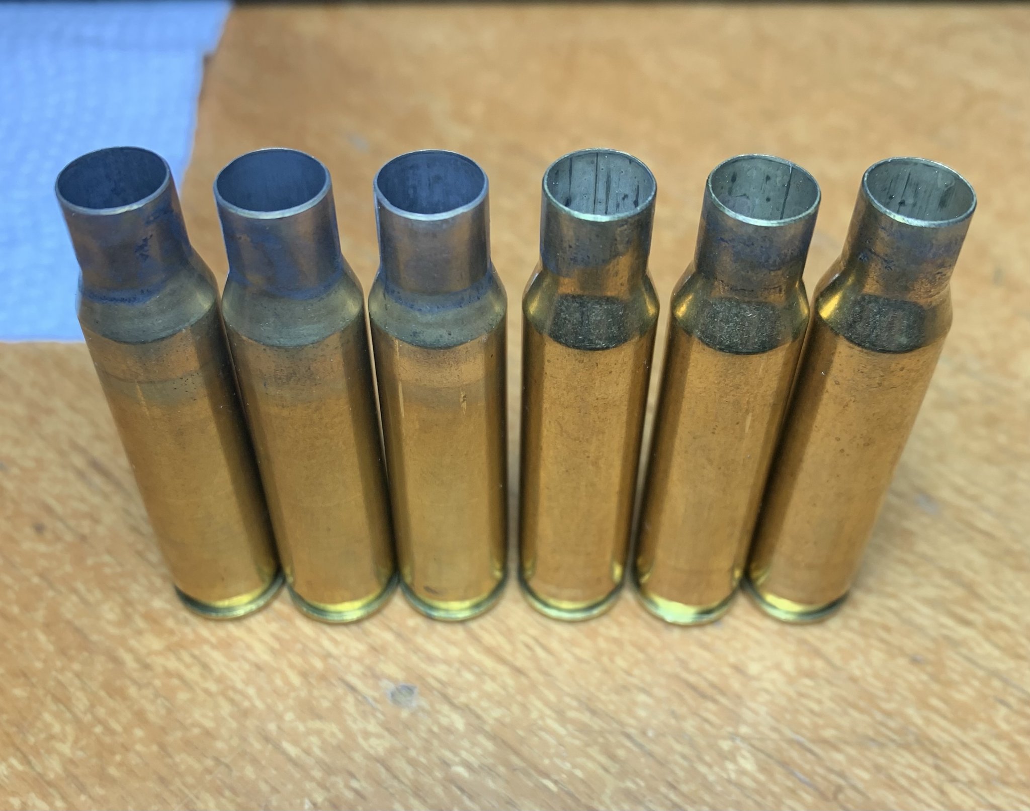

Below pic of 47.4 Lever 160 FL load.
The 3 on the right are the 47.4 Lever (pretty much zero carbon), compared to the 3 on the left 45.4gr RL 15.5 with 177 smk @2760.

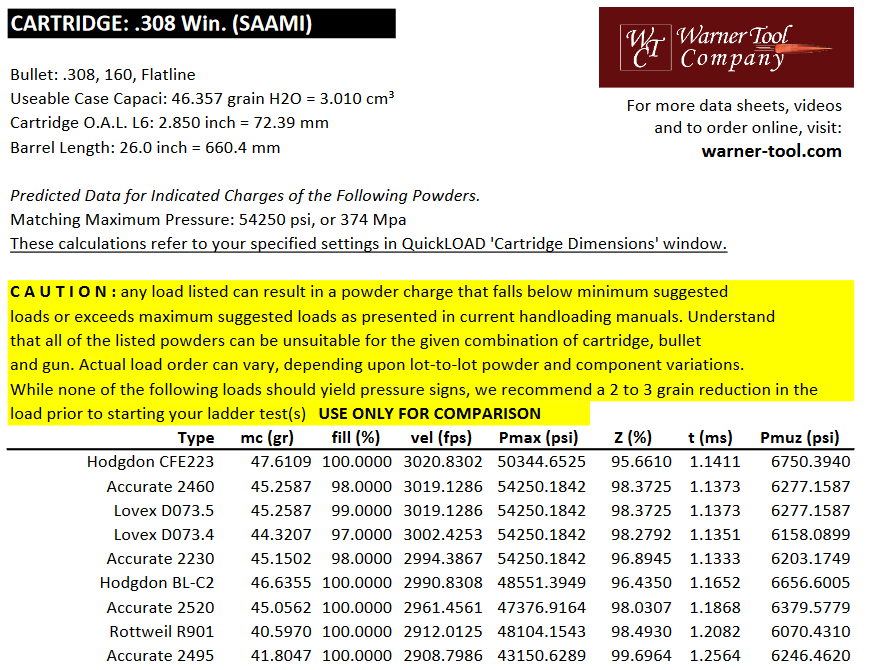

Edit: Here is a snip-it of Warner load data for a 26" barrel with the 160's
Notice I'm loading .100 longer. The Norma case capacity is on the smaller end of the spectrum for 308 though.
