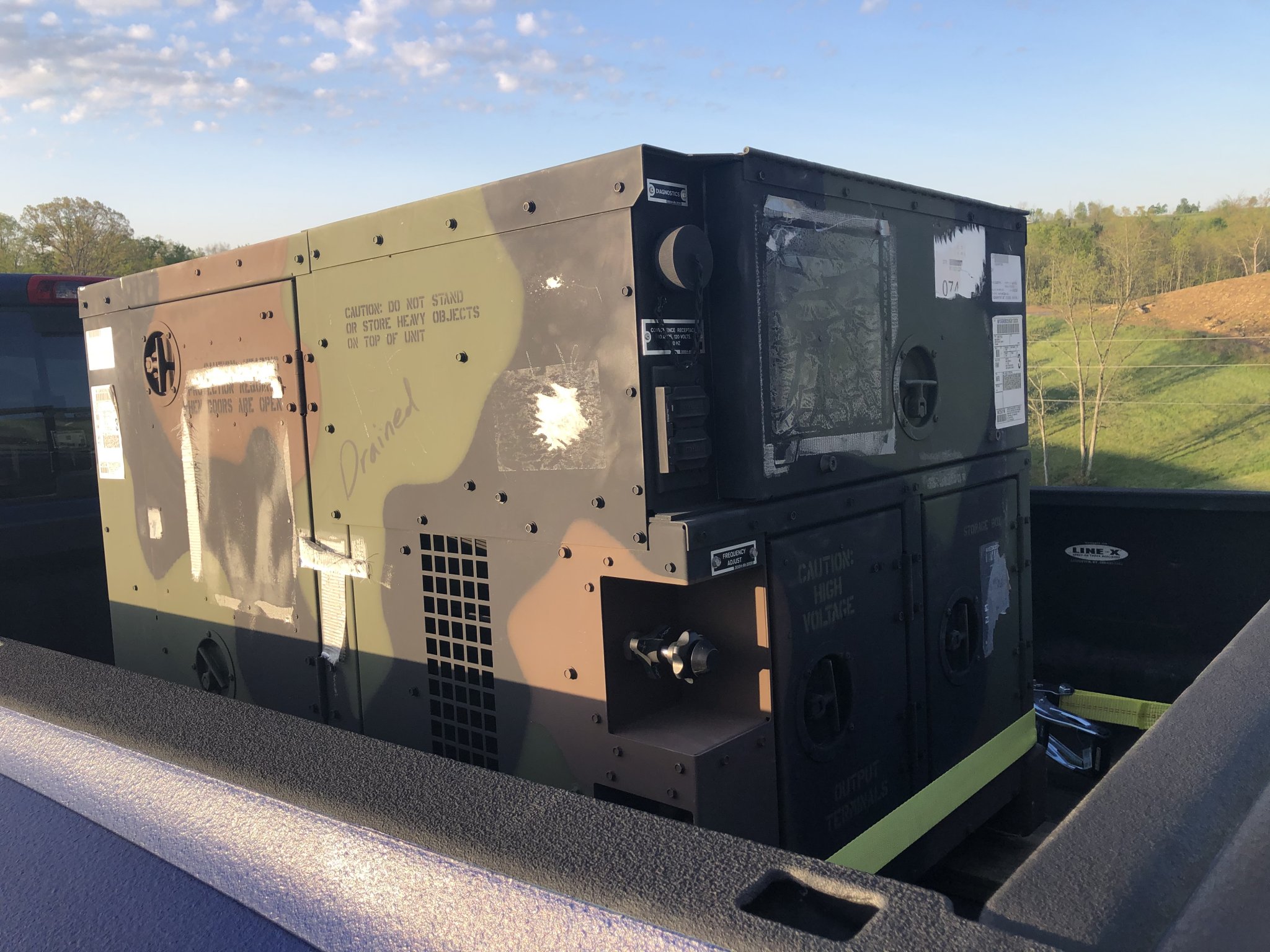

Liquid cooled MEP-802a (5KW) and MEP-803a (10KW) or Air cooled MEP-002a (5KW) and MEP-003A (10KW).
If you want a nice home diesel generator that doesn't cost 15k this is the way to go. The military generators are all underrated (KW wise) and quality stuff with Lister Petter diesel engines. Perfect for a off grid cabin setup. These generators have went up in price and are getting a little harder to find but I'm sure you can still find a deal on one. Look at .gov auctions.
Study up on them here: https://www.steelsoldiers.com/forums/generators.55/
There are a lot of very knowledgeable people on that website and they are happy to take questions and help you troubleshoot if you have a problem with your genset. If you are somewhat mechanically incline and can change your own oil you can work on these generators if you had to.
Having vast experience with those, they do not like light loads (possibly partially because they are under rated?). If you can’t get a good load on it they are very susceptible to wet stacking.
You are correct about being prone to wet stacking. A simple solution would be to plug in a space heater or two to get them to about 80% load and not running them at light loads for extended periods.
The air cooled MEP-002a and MEP-003a are not as prone to wet stacking as the newer models from what I understand.

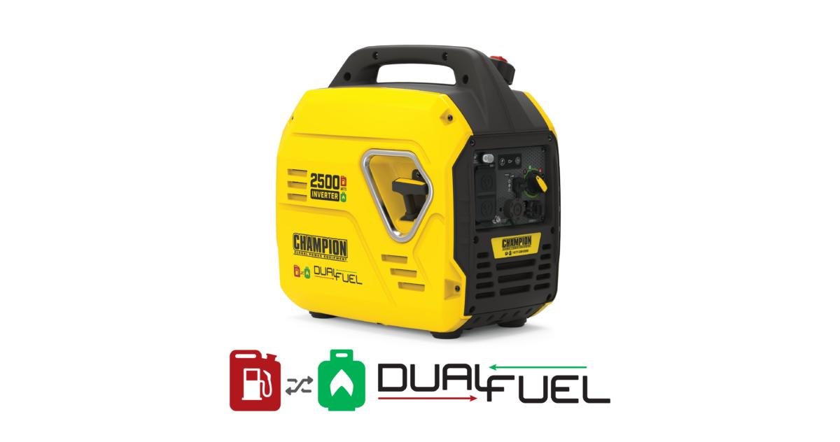

I picked up this Champion 2500 duel fuel about a month ago
I just wanted SOMETHING for when the power goes out for a day. I don't mind swapping plugs, this is emergency use only for me.
Very small, quiet, light weight, can buy a second and parallel them.
I have only run it for 1 hour to test it out so far (on gas only) so far so good.
Was less than $600 on amazon
