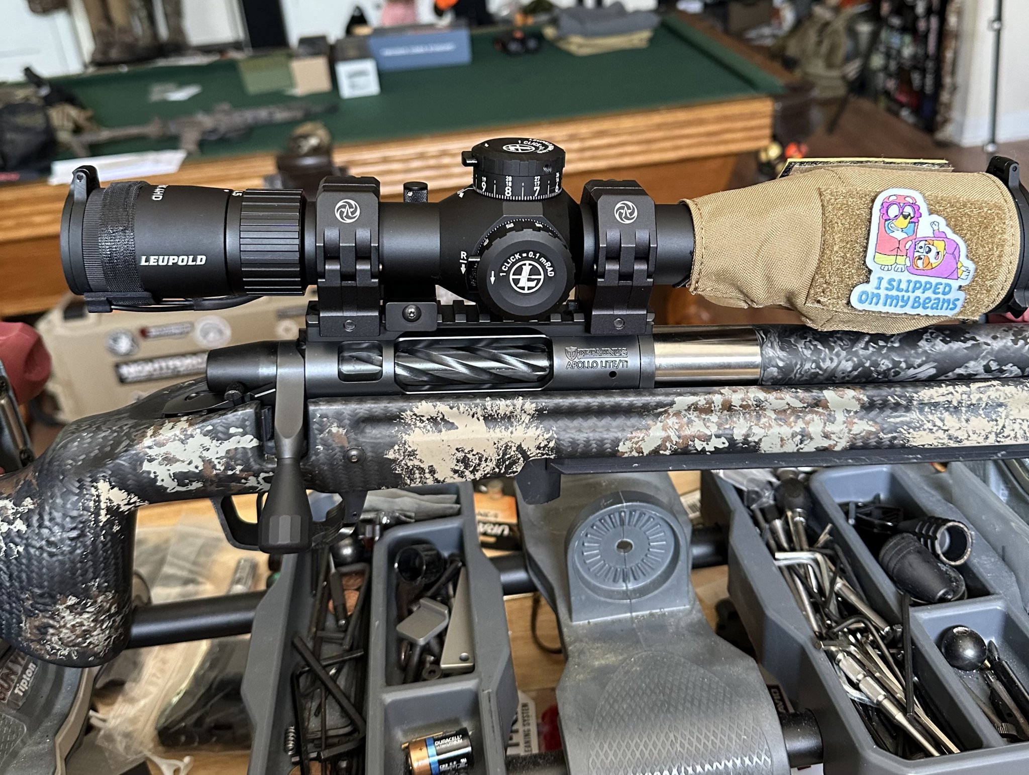

Got my 2.5-10 in a couple days ago, and interestingly the elevation turret is much better than my 4.5-18. The 4.5-18 isn't bad, but the 2.5-10 is exceptional. Zero mush whatsoever, very snappy and a good bit more audible. Obviously a different erector for 30mm tube vs 34mm.
How much elevation do you have?
A friend bought the same and after bore sighting he has nine MRAD - which won’t get him where he needs to be.
Maybe this will change after zeroing, but it is still strange to me.

I haven't even been able to shoot it yet, hoping tomorrow or Sunday I can. I have it on a 40 MOA rail and it boresighted with no problem. I haven't checked available travel after doing that.

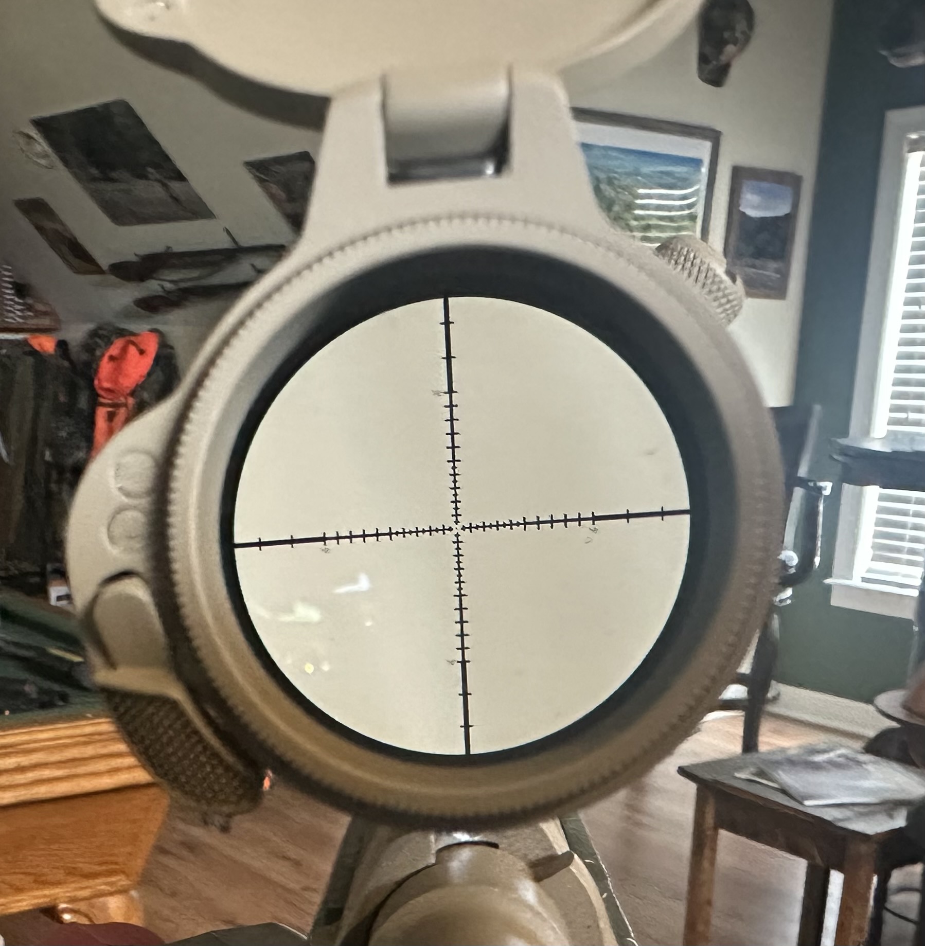

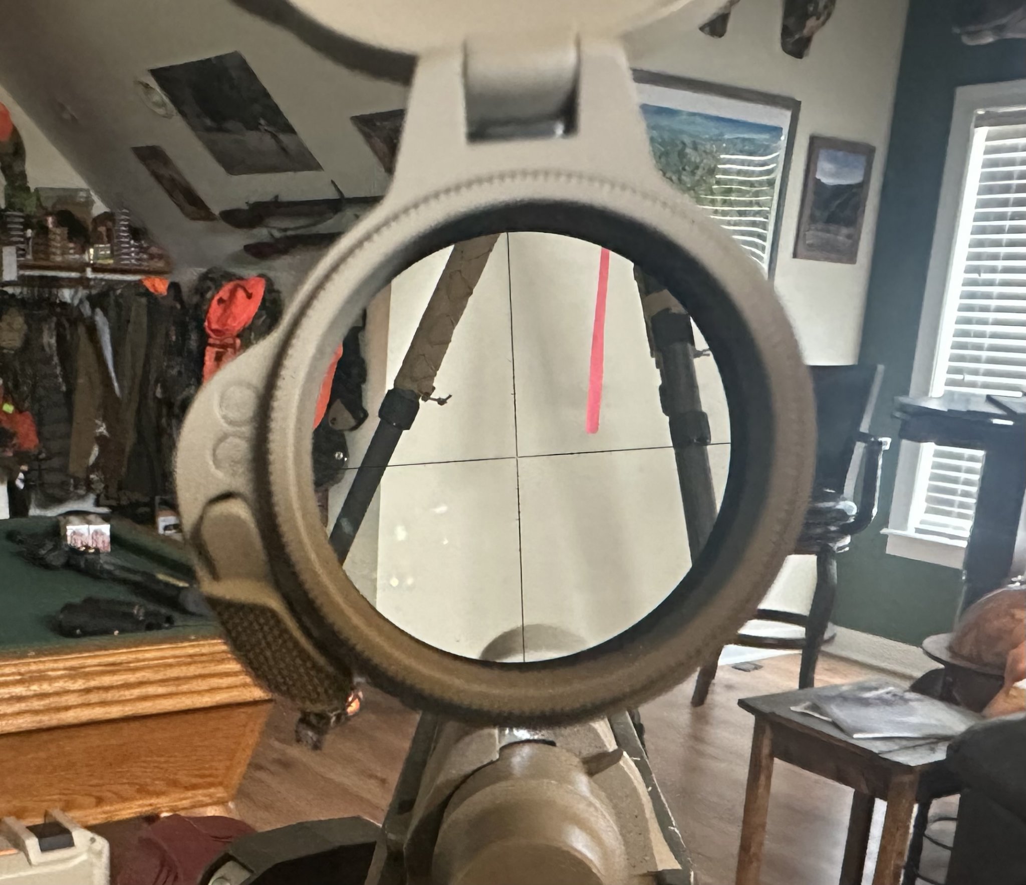

Any chance of some pictures through the scope a 2.5x and 10x?
Do you think illumination is necessary on this scope or is the reticle thick enough to be used on 2.5x without it?
Sent it off for some cosmetic work, should have it back Friday and will do. I got the illuminated version because of concerns for a hunting rifle, but playing around with it I did think to myself that I didn't need it.

I have a 2.5-10 tmr non illuminated and the reticle usable on 2.5 as a duplex. I probably have 200 rounds on mine through a 223 and really like it. Just bought another one Monday from a member here.

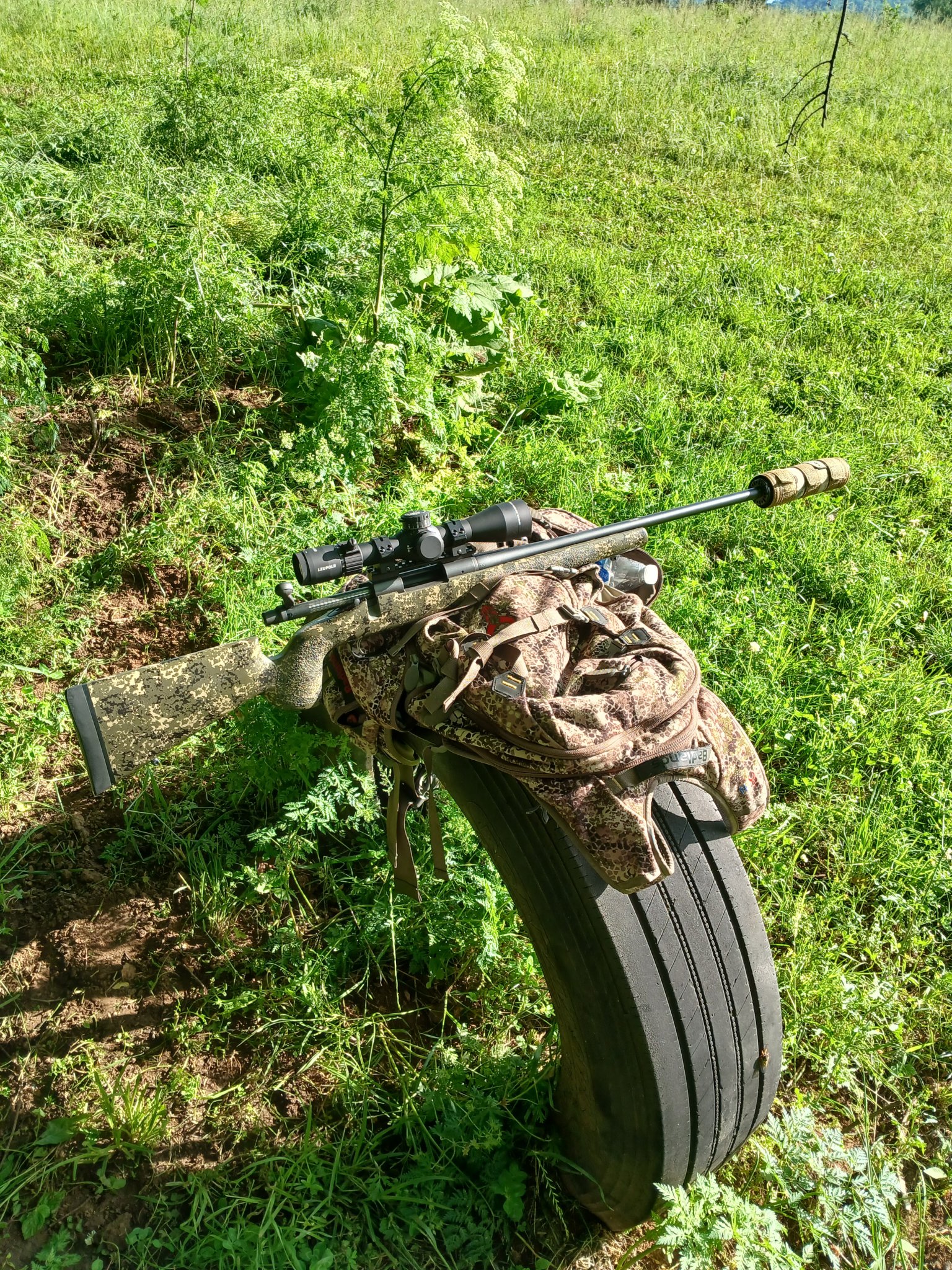

Back on course, 4.5-18 is mounted on my NRL Hunter rifle. I like it for the package and price for sure. I’d say the turrets aren’t quite as tactile as the Mark 5HD, but again price point and 34mm vs 35mm tube has brought me back into the fold. Also non retarded windage now and made even better by locking on zero.
Small things, but I like Loopys “throw lever” and Leupold Alumina caps are nice. Didn’t get to shoot it this weekend, hopefully next weekend. PR2 reticle is nice, really wish I could get it or even better (for hunting IMO) the PR3 in the 2.5-10. Which speaking of the 2.5-10, USPS has decided to hold it for a few extra days hopefully it shows up soon.

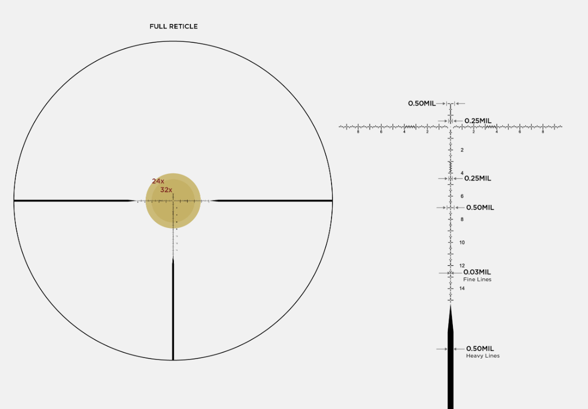

PR3 in 2.5-10 would be....well, what a lot of us have been asking for.
Would it? It looks like it would be way too thin to be of any use from 2.5-5x (approx).
I definitely think the TMR could do with updating/replacing but the PR1/2/3 would all need so changes in order to help visibility on low magnification.
Some thing like the ZCO HTR or March FML-1 where the thick outer bars come in fairly close, but still have 3-5 Mil of wind holds.
A small tree like in the PR2 but with the TMR line thickness would probably be perfect for a 2.5-10.

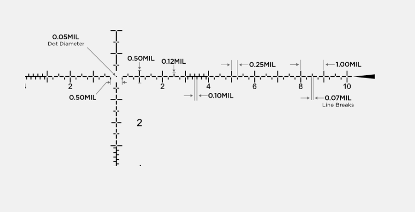

TMR fine line is .05 mil which is about what you would expect as the thickest most manufacturers would ever go. Then you get the illuminated TMR which is .1 mil for fine line thickness!
Spend $200 more for illumination and get the fat girl for hunting the thick stuff. If Loopy has their shit together and these prove reliable (I’m not talking about falling down a mountain 50 times during your hunt like the other website, must be the clumsiest fukrs ever) I can’t see them not being popular especially if it’s just the erector that’s different from the Mark 5.
I have the unpopular G2B reticle in my XTRIIs and they start at 4X with the thickness at .05 mil and they work well now that I’ve used the hell out of them and have become acclimated to it. Still like the Mil-Quad from SWFA.

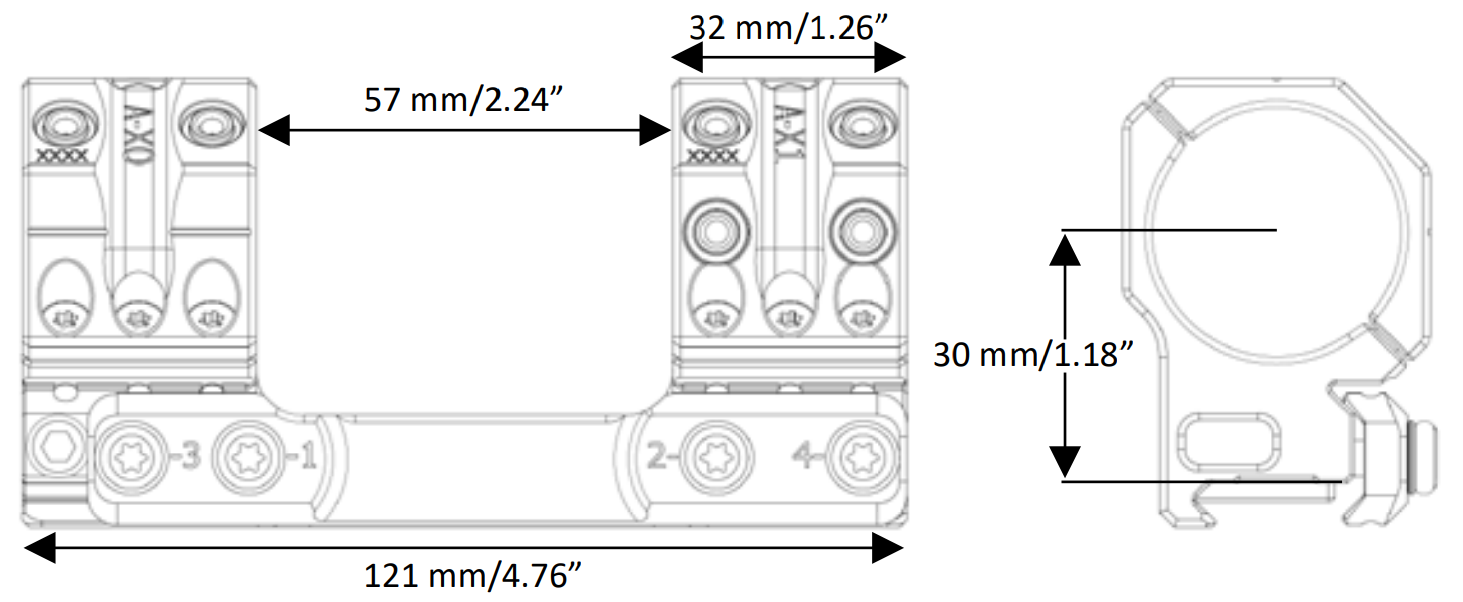

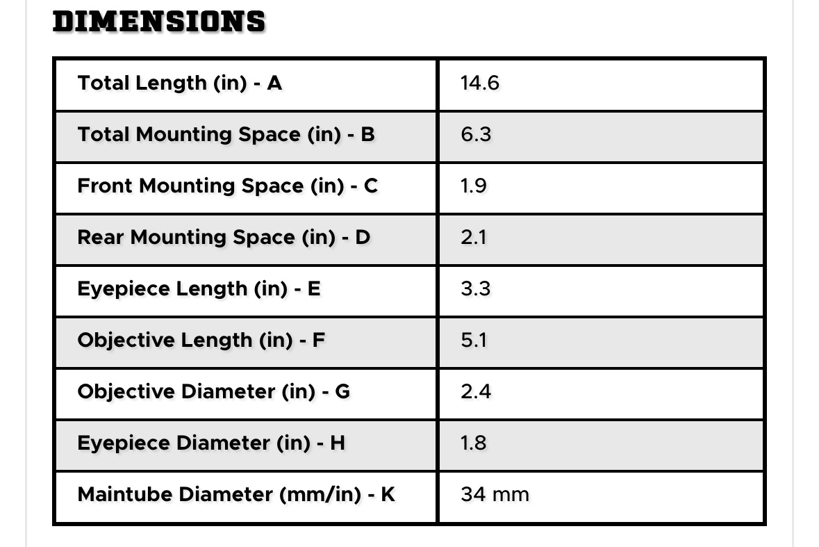

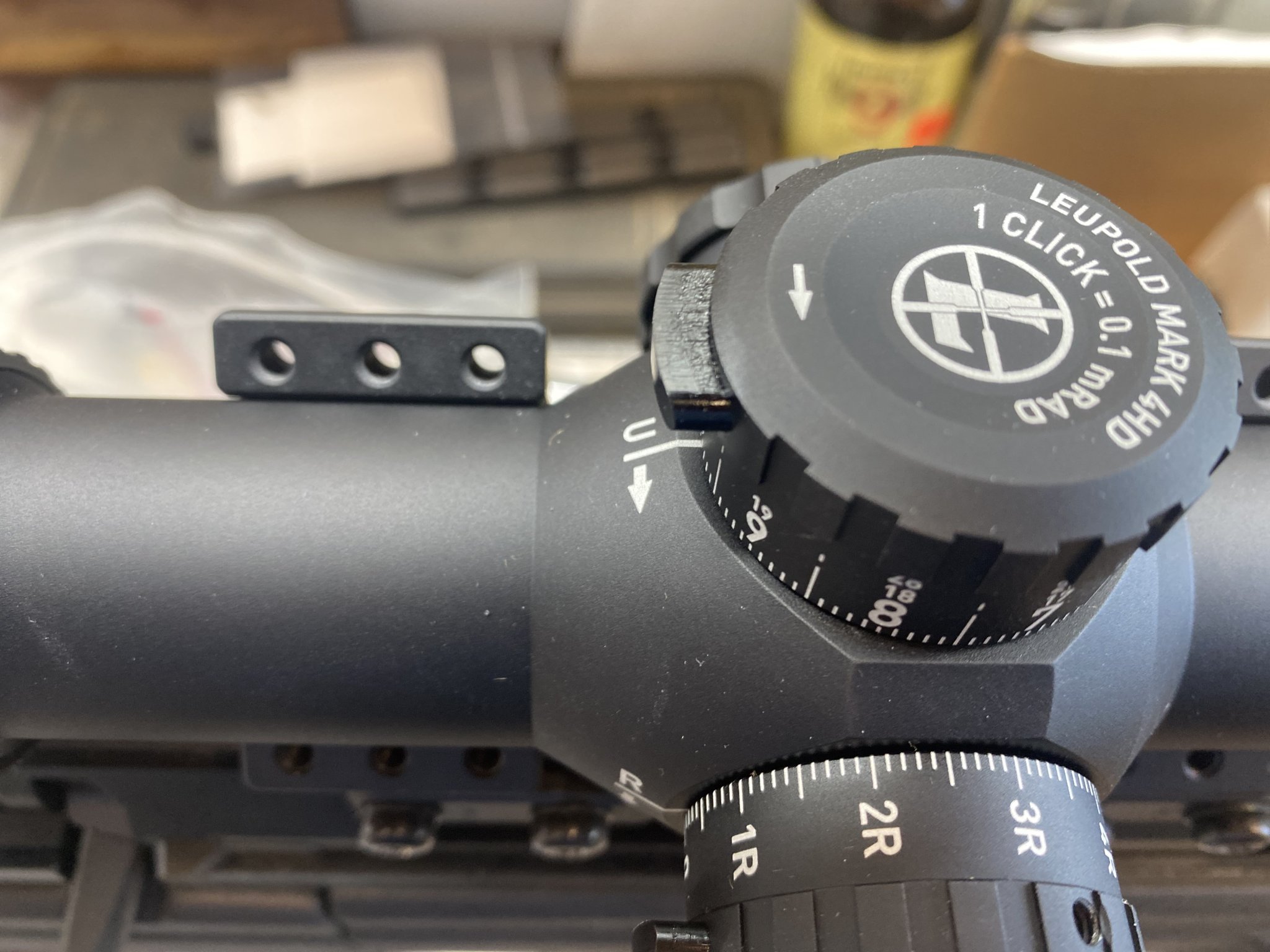

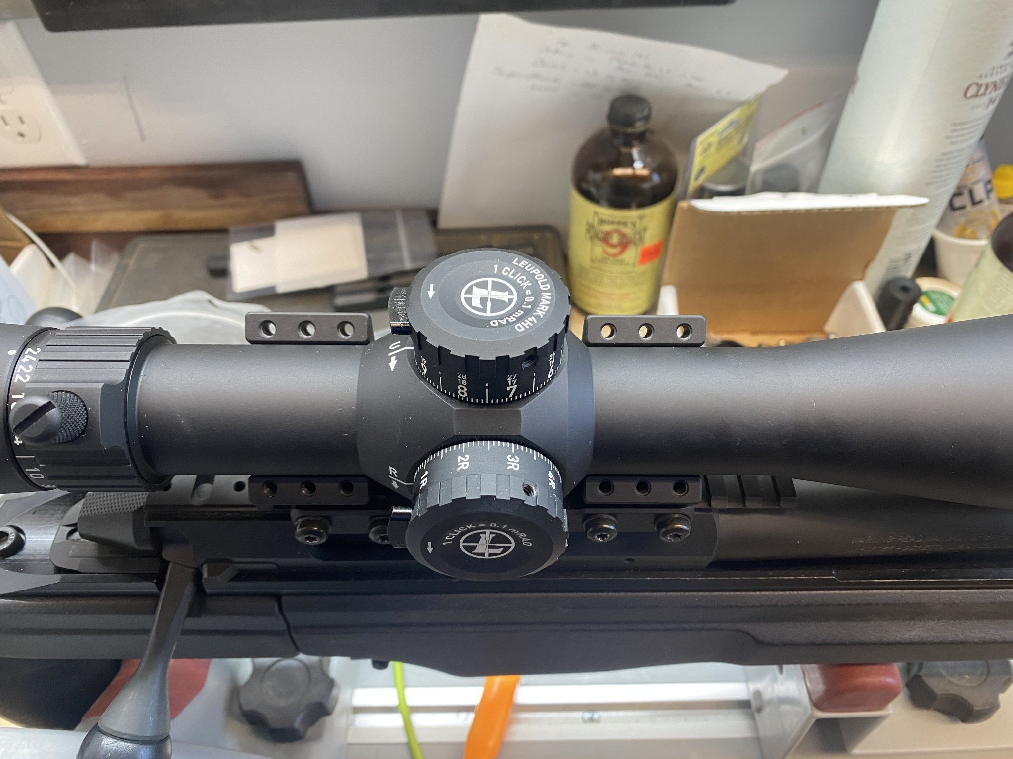

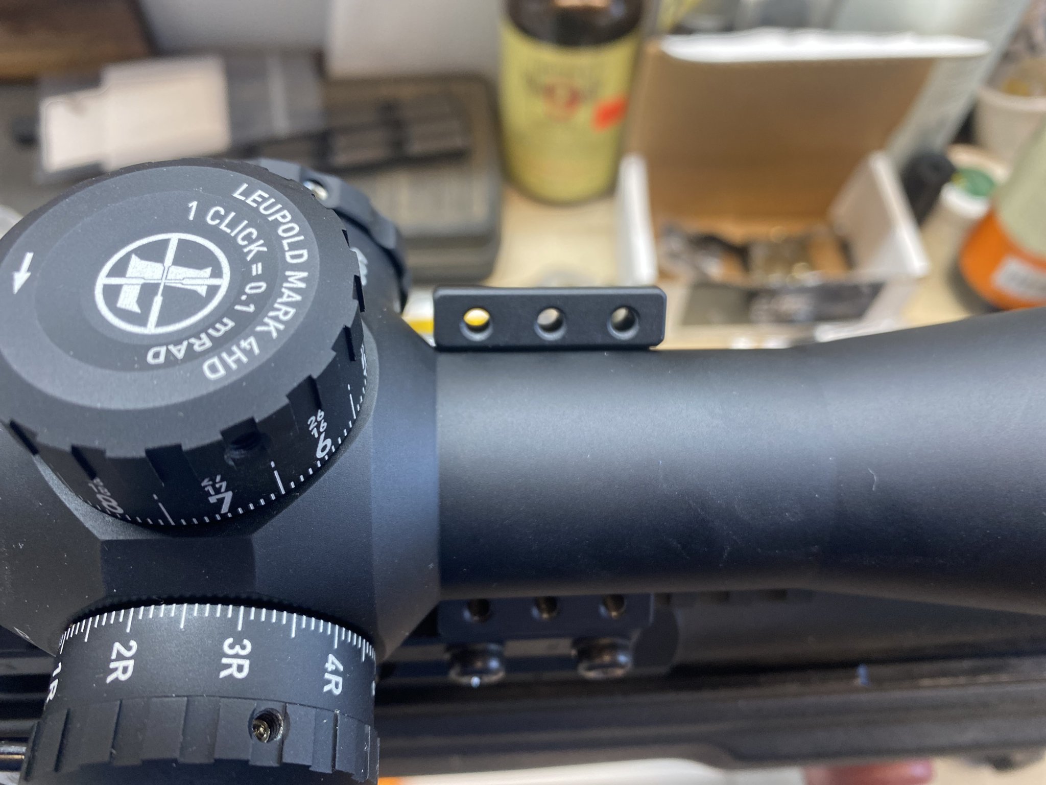

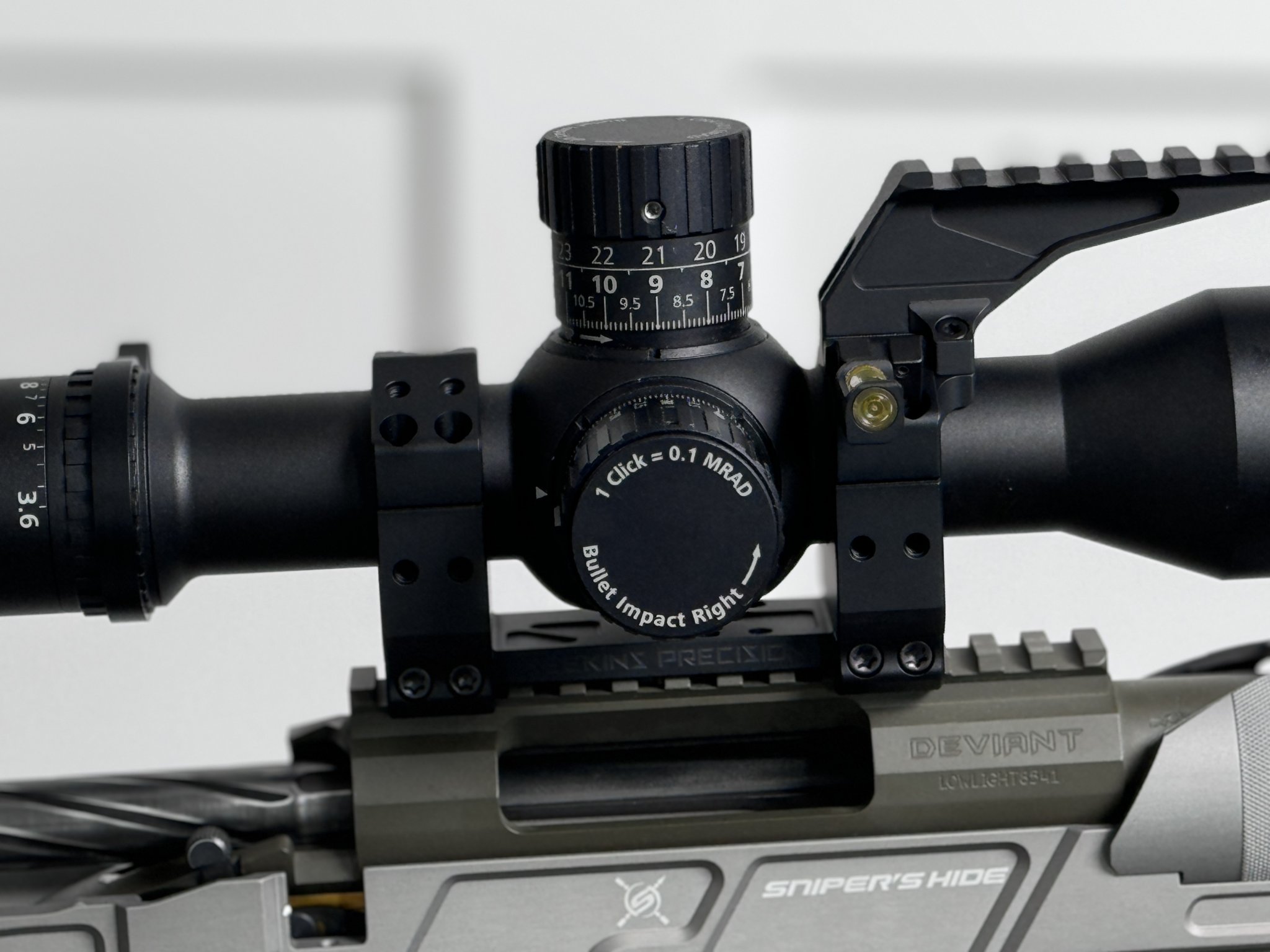

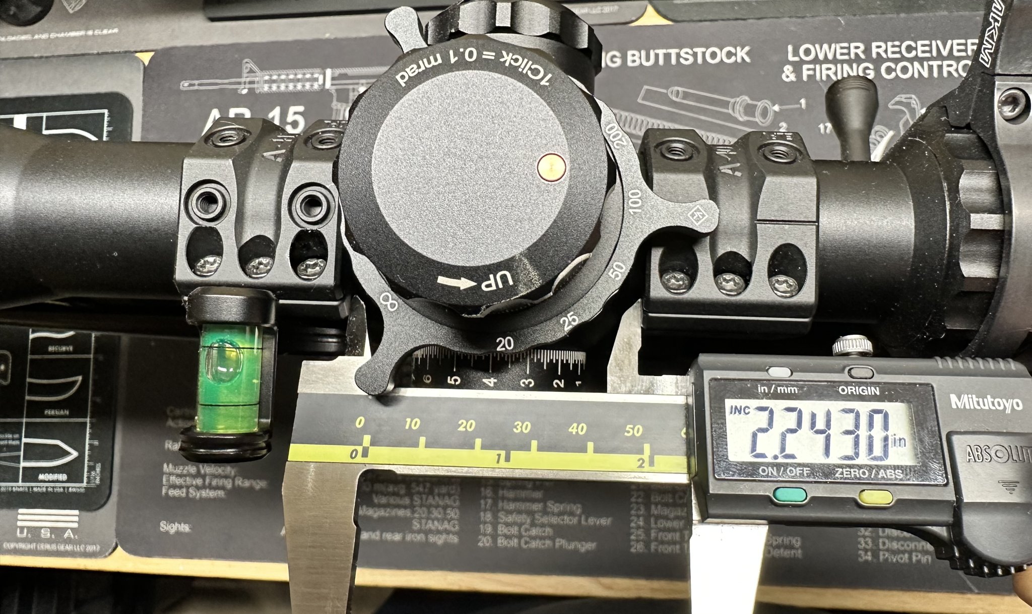

FYI the 6-24 didn't fit between the caps or at least was so close I wasn't comfortable in my Spuhr SP-4601.
What does this even mean, too close to the saddle ?
I looked a couple Spuhr as they have different lengths and the shorts one still gives you about 1/4" on each side of the saddle, then on the average one it was almost 3/8th on each side of the saddle ?
Not to mention a lot the rails today are shorter, like on the Gap production rifle so not getting it, tight is not a bad thing ?
But if you look they are all pretty tight with a one piece mount to the saddle, not to mention the stuff that can bind is more towards the outside vs inside.
The mark 4hd is longer than any other scope i have around the turrets.
Reactions: jafo96 and ChrisAU
Is that the short spuhr or the longer one? I think they make a 4.5 and a 5" long model.
It’s an older SP-4601, 4.76” long. I’m not sure where it falls in the length vs others.
I did notice when i when looking for my invoice to get the model number it says in the description “fits most 34mm tube scopes except those with extended erector housings”
It has also been discontinued, it looks like the newer version may have a little extra room due to the new cap design, one side with 3 sets of machine screws and the other with only 2.
It has also been discontinued, it looks like the newer version may have a little extra room due to the new cap design.

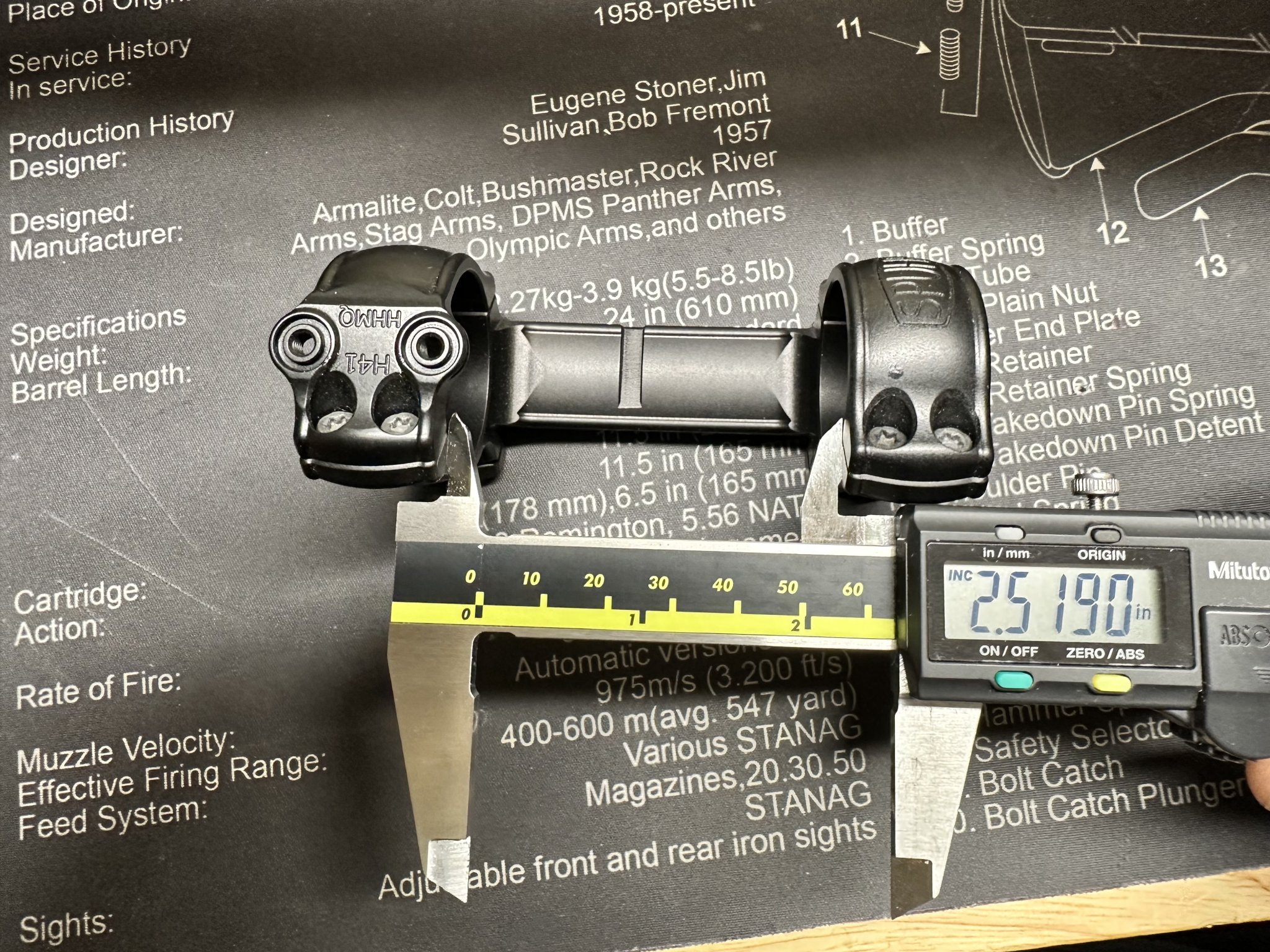

So roughly how much room between the caps do you think I need...?
Reactions: Weatherby_Eyebrow
Not much, I debated trying it but ultimately didn't want to gamble with my warranty or resale should I happen to be wrong.
Sorry, guess I wasn't very clear... How long would you say that erector housing is? Pretty sure I've got an extra 4001 downstairs I was planning on using with a 6-24x as soon as I get the email from Euro, curious if this plan will work.

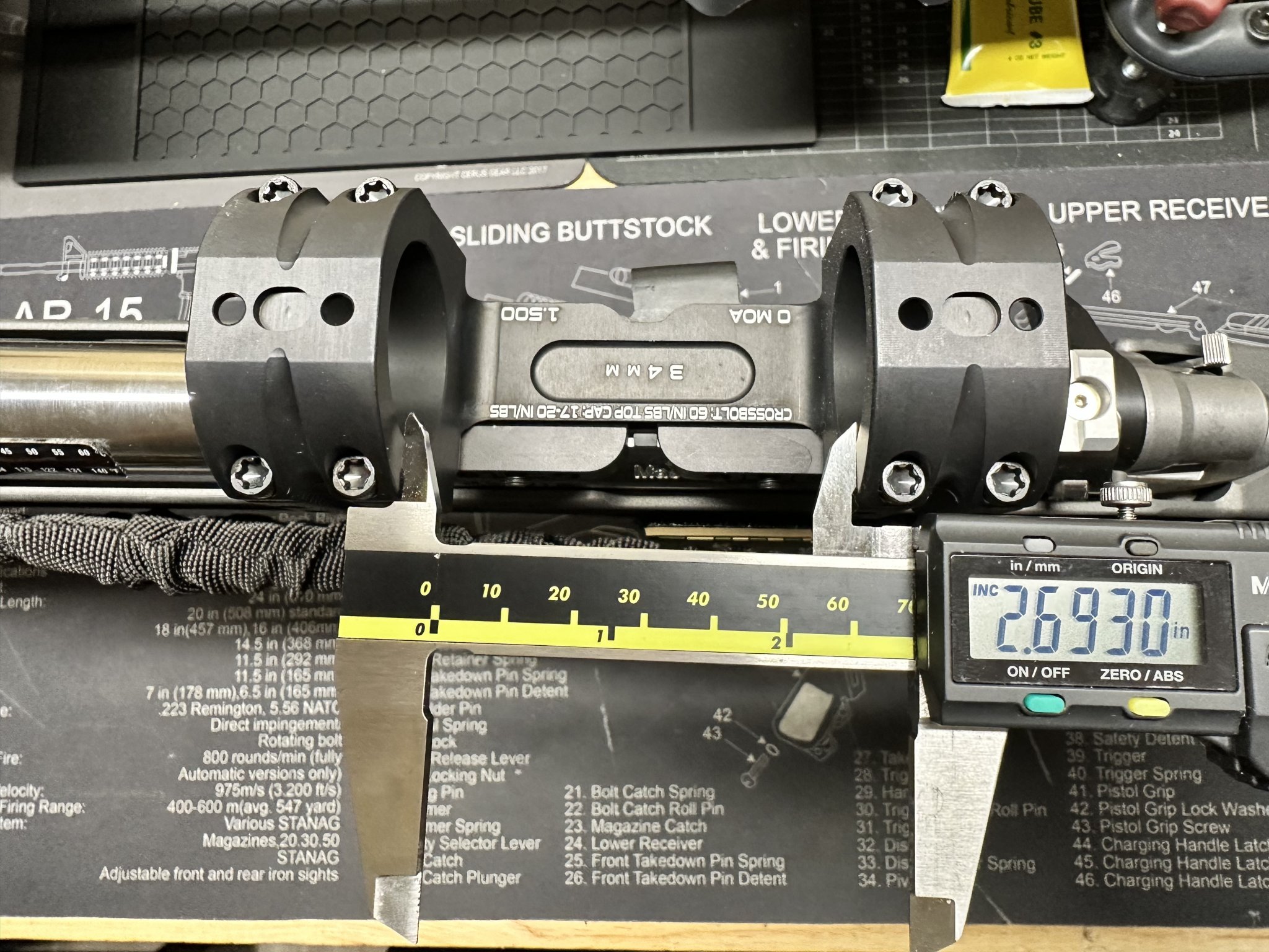

Measured a couple one pieces I had sitting around. Don’t have an ARC at the moment. ARC specs say 2.59"(66mm).
Spuhr 4002 (4616 was the same) - My default is a Spuhr 4002 and doesn't look like that will work for sure.
Spuhr SCP-4006 hunter
MPA BA 34mm
