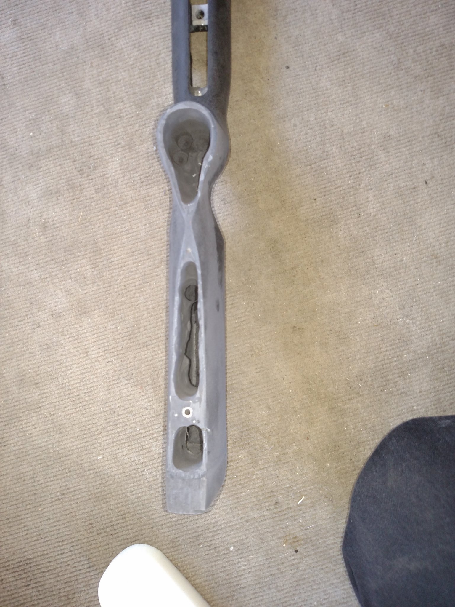

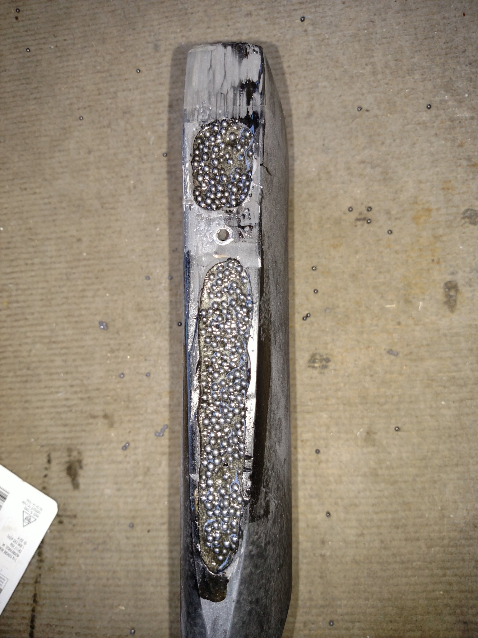

I have a cage a plate and a box of screws holding my neck together and shoot everything from 14 Flea to 50BMG Improved and weight is your best friend when it comes to recoil.
The picture is of a 338 Lapua in the 111 Savage. Even with a 33 inch barrel recoil was too much so I added 8 pounds of lead to the buttstock. Simply hollow it out with a spade drill then mix epoxy into the lead and pour it full.
Cheap easy removable and it works every time.
I added a Tap Plastics made runner on the bottom so it rides the bags better. They make them for $19.
If more weight is needed I can remove the bag rider and replace it with one made out of stainless steel or bronze for more weight.

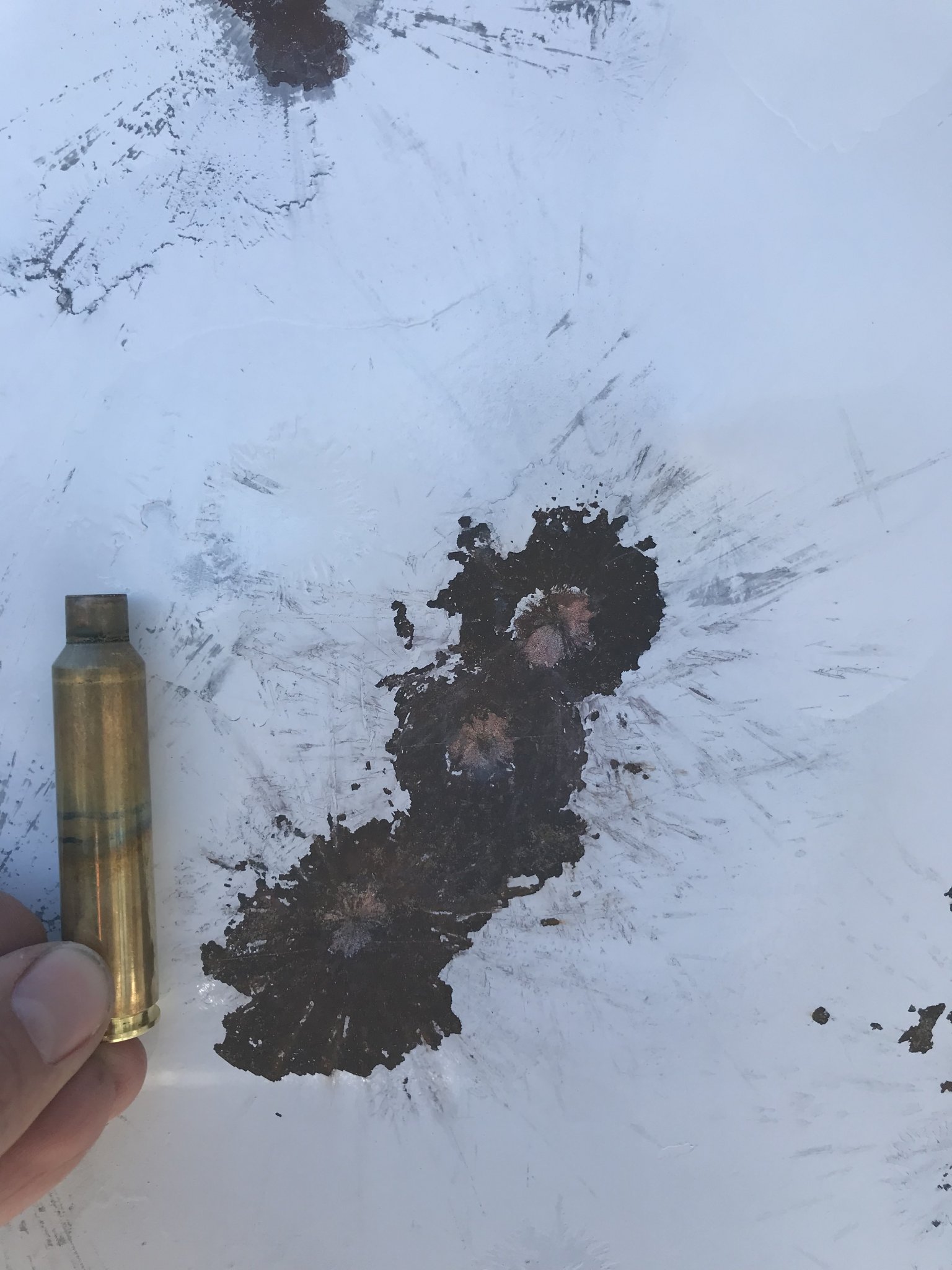

I’ve shot some of the smallest groups I’ve ever shot while forming brass. I don’t see it as a draw back. This is the first 3 shots out of my Snipetac this morning at 915 yards. One is the cold bore.
7044771
I just find a load while forming just like I do with any other round. Then when I’m done forming all the brass I find another load. The seating depth almost always stays the same
