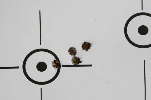

Range trip went really well today. All shots were 100 yards using a bi-pod.
<span style="font-weight: bold">140 A-max's at 100 yards 3 shot groups.</span>
First group out of the gun

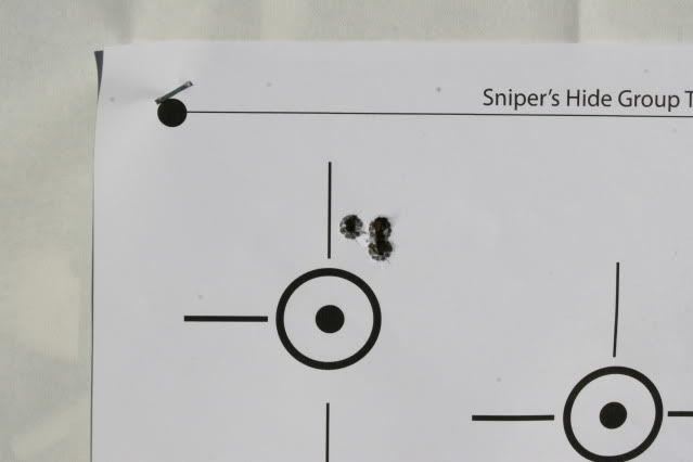

2nd group (pulled last shot) still under .75

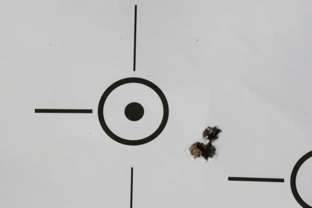

3RD group

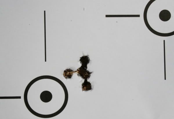

<span style="font-weight: bold">123 A-max at 100 yards - Didn't like as much as the 140's</span>
4 Shot group

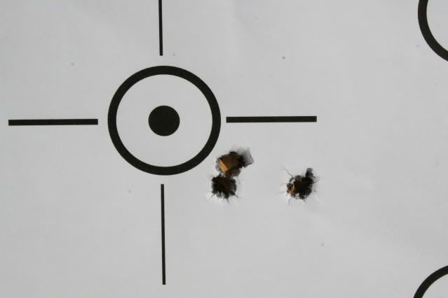

5 shot group around .580 center to center
Speeds were pretty good. I shoot these loads out of my other .260's. They are usually a good indicater on how the rifle is going to run and show its potential.
The 140 A-max was 42.6 grains of H4350 and were averaged at 2673FPS. This load shoots 2790 in my 24" .260
The 123 A-max was 45.1 H4350 and were running about 2918 but SD was not so good.
