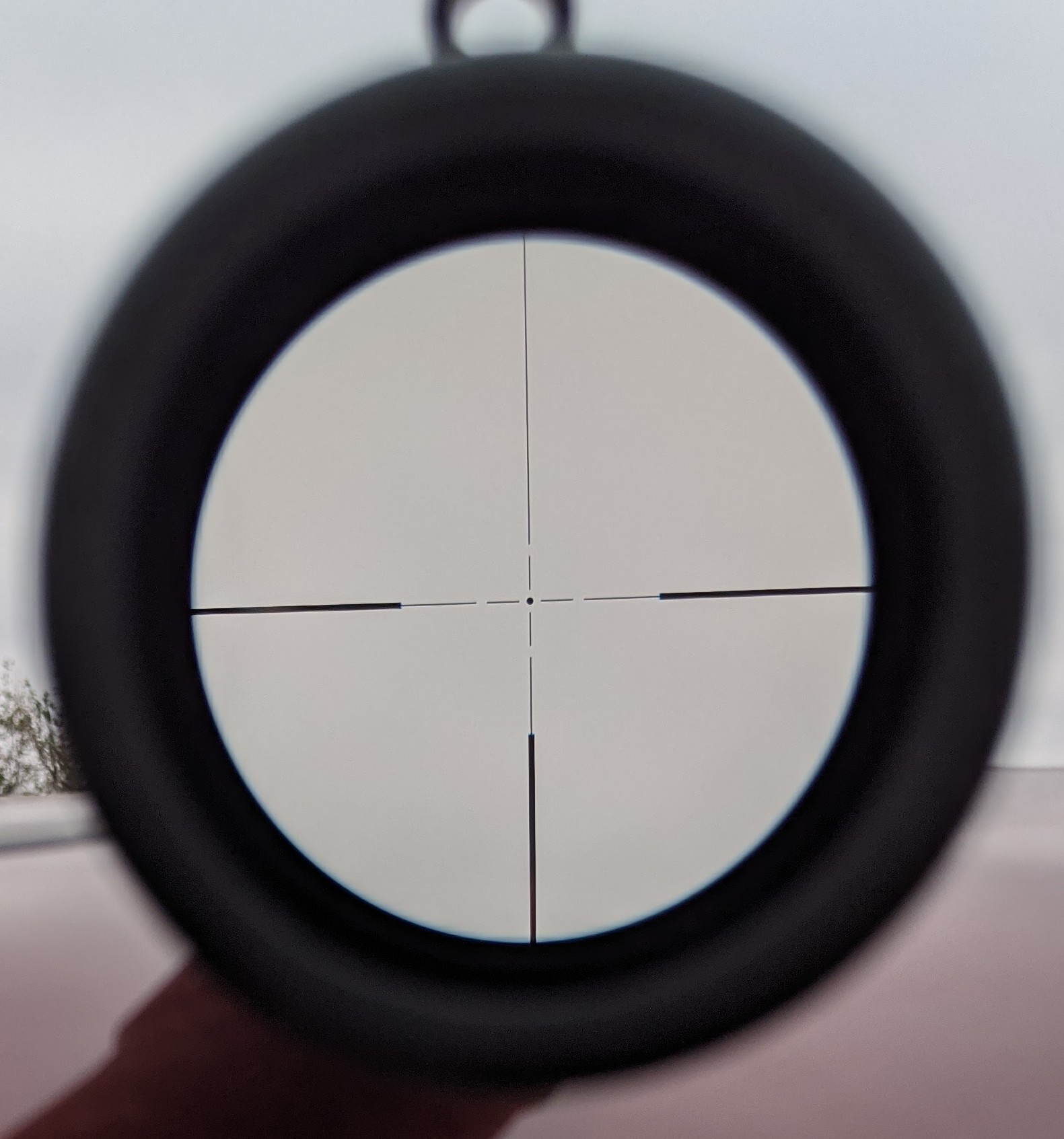

I ordered the 2-16x50 Forge and it arrived yesterday. I hate to do this, but I've got to let you know that the reticle in the scope doesn't match this picture. It's close, but the center aiming dot in the actual scope measures 1" at 10x at 100 yards (tested against a grid target). This picture shows the center aiming dot being about the width of the thinner stadia, but this isn't the case. I've tried to get a picture through my cell phone of the actual reticle.
There's more to say about this scope based on the short time that I've had it, but I wanted to put this up so that everyone is aware of the actual reticle versus the one that is shown.
Again, I'm not dogging the scope - there's a lot to like for the price - but I wanted anybody thinking about it to know what they are actually getting.

I found the resolution and contrast to be quite good on the 2-16x50 Forge. It also has 0.05 MIL adjustments (marked 0.5 CM). I didn't measure FOV but it seems to be good, at least I didn't notice that it was lacking in any setting. Chromatic aberration was pretty well controlled as long as you stay in the center of the eye box, pretty much like my 3-18x50 (Chinese) Forge. I did notice a significant amount of barrel distortion (fish-eye) at low power, and it was detectable even at max power. It didn't really bother me just looking at a target, but it's very noticeable when scanning across an area. And then there's the big dot in the center of the reticle, as mentioned previously.
It feels very solid and substantial, and reminds me aesthetically of my Athlon Cronus. The locking turrets on all the Forges are really nice, and all the controls were smooth and free moving. I'd have been happy to keep if the reticle dot had been as fine as shown in the marketing materials.

I looked up the FOV it looks pretty good, 42ft @100yds I'm just not sold on that reticle. Have you tried a lrhs or lrts for glass comparison? I know it's stated that both have the same glass

I have not used any of the elite tactical line optics. I have a Razor gen2, and Athlon Cronus, an Optika6 5-30x56, and a 3-18x50 Forge for comparison. This Forge model seems most similar to the Optika6 to me as far as resolution, contrast, and stray light handling. It exhibts a bit more barrel distortion and CA, but it also cost significantly less than the Optika6. Based on what I have looked through, that's about the best comparison I can offer.

I've looked at the optika6 as well, just not sure what to get yet. I think I'll try the 2-16 forge because it fits me well. I'll deal with the reticle
