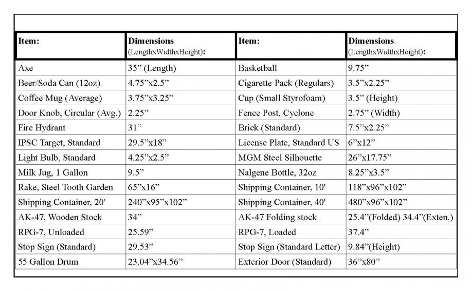

Found these in another thread. I was looking for copies of the reference pages my Magpul data book, but these look pretty close from what I can remember.
Sorry, the page keeps freezing when I try to upload the second page, but there's only a few items on pg 2, so this should at least help a little while I try to get the other one up.
