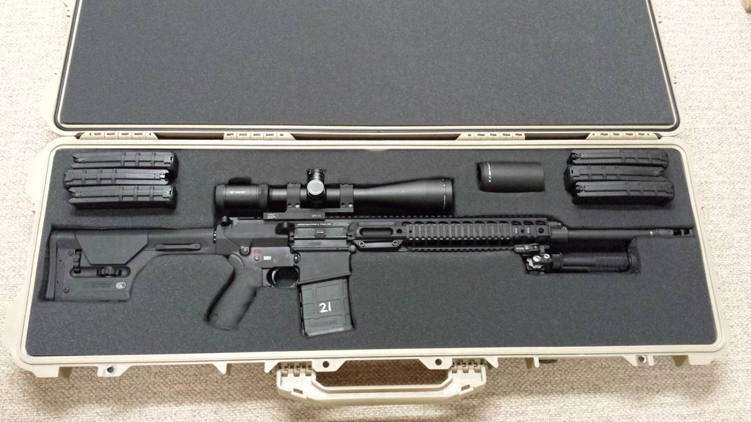

Picked up one from a member here on the hide. Nightforce just came in for it so all I'm waiting on now is some rings from Griffin.

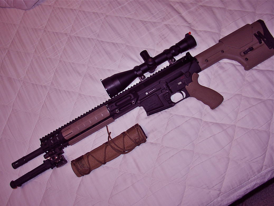

I've had my MWS for a couple months:
I got the 16" CL in .308 as the original configuration, which will shoot right around MOA if I do my part. I like how this gun has a bit of girth behind it to soak up a bit of the recoil (I'm a sissy about recoil).
And yesterday I got the 20" SS .260 Rem barrel:
I'll get the new barrel out to the range on Sunday morning. I'm using 120gr A-Max bullets, so the barrel should be able to stabilize those pretty well. From what I understand, a 1/8 twist is required for the bullets heavier than 135-140 gr.

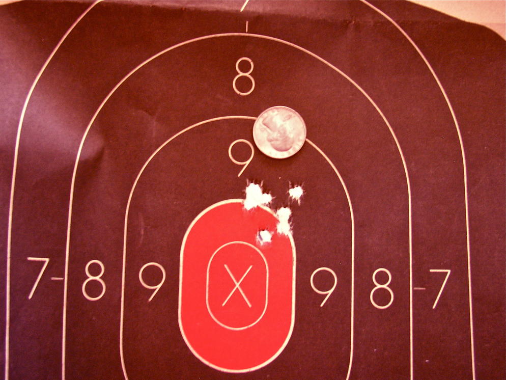

First ten shots out of my .260 Remington barrel:
0.875-0.260=0.615" for ten shots.
The caveat here is that there wasn't enough powder to reliably pick up the next round. It extracted and ejected just fine, it just have enough oomph to pick up the next round.
120gr Amax
36.8 gr Varget
Remington 9 1/2 primer
Rando brass trimmed to 2.025
COAL 2.775
I picked that charge of powder just because it was on the low end of what the hornady manual told me.
If I learned anything about reloading, is that it's better to have a mouse fart than elephant flatulence.
I'll dial it up a tad to see where it can reliably cycle the weapon and still give groups like these.
holy cow, that's awesome!
