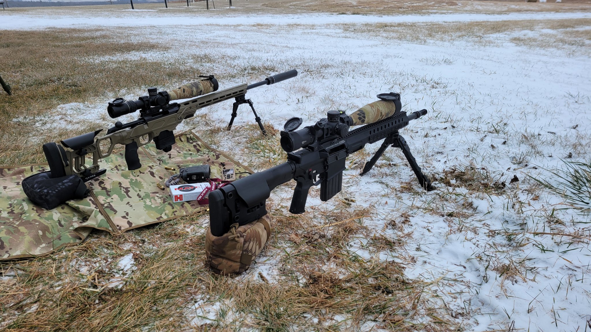

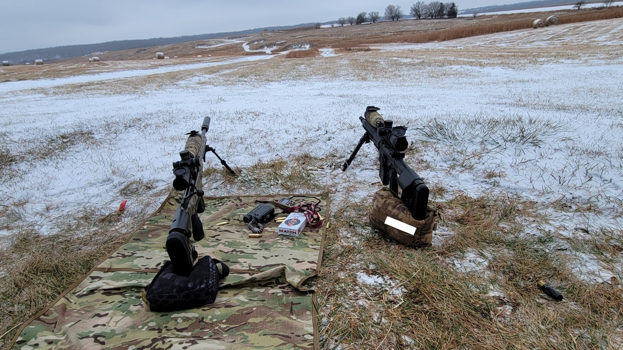

Took my MWS and other guns out this last week to let a friend get some long range time in. Shooting to 750m in ~10 °F temps all day, it did phenomnenal with 175 smks. Reliability stayed strong in the cold even with the Brt tube and xh buffer, sans suppressor. The gun saw 100 rounds at 3 different times while the gun sat outside for 8 hours. I did not observe that the cold bore shots significantly deviated from the following shots. Good times were had.
