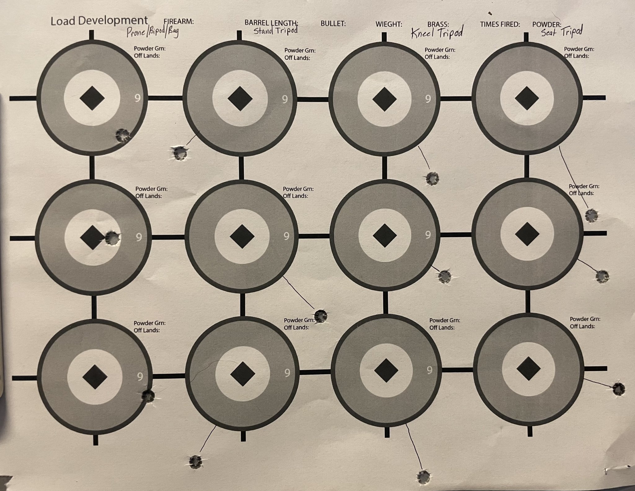

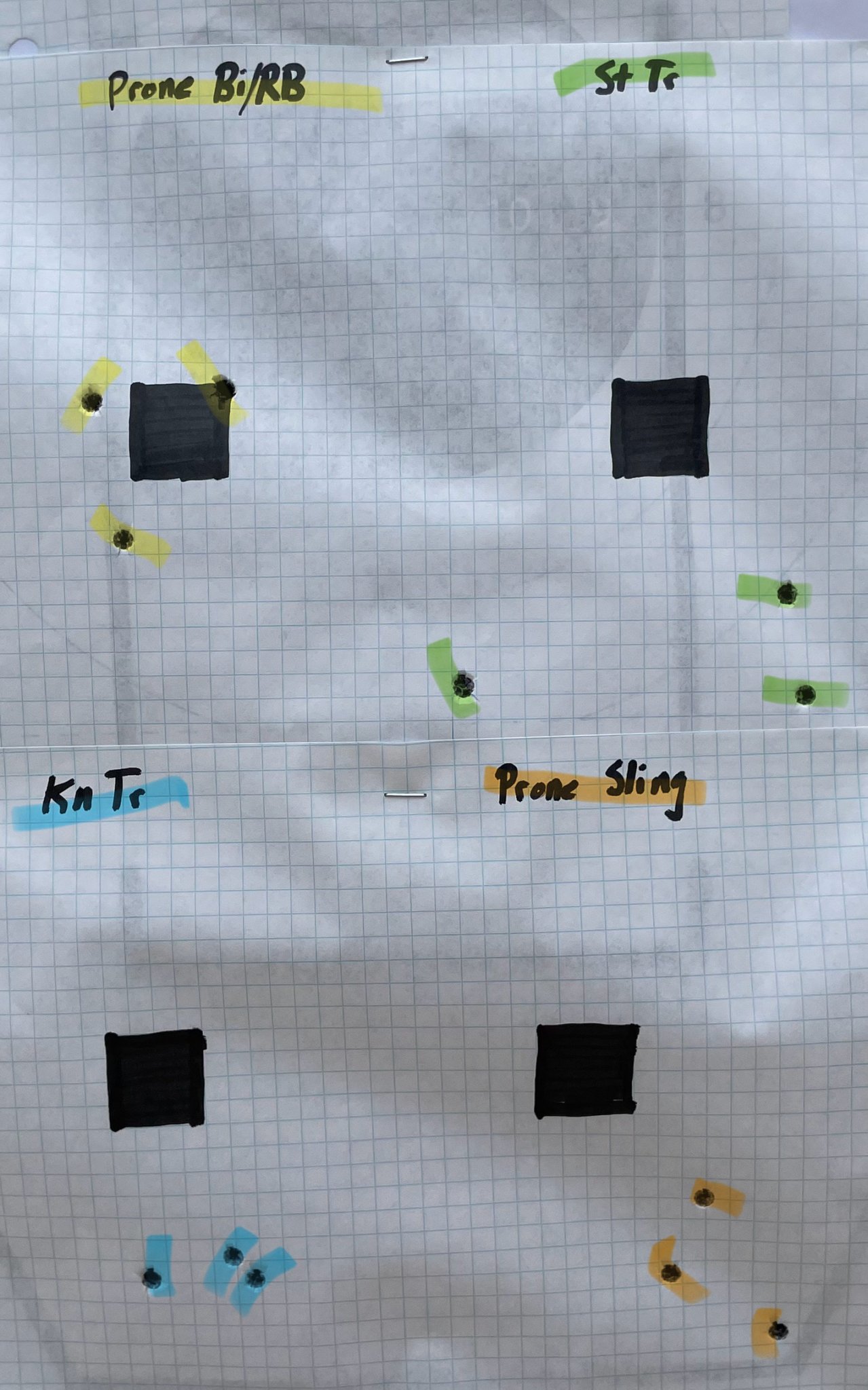

Well, beside me and my barrel not doing well today, there was obvious shifting from different positions at 100y.
Top left: probe with bipod and rear bag
Top right: tripod standing off bag
Bottom left: tripod kneeling off bag
Bottom right: prone sling support
And yeah, I need more tripod/standing work I know. This BRT barrel today was 1.5-2 moa, which was not very good. On a good day it’ll do 1.2-1.5. Perhaps I’m asking to much from a hammer forged, chrome lined barrel. Perhaps I just want a Mk12modH.
Is the above typical for y’all though as far as zero shift. Seemed that the non-bipod positions were fairly consistent.
You may just need to do a little experimenting with different ammunition or loadings to see what that barrel may perform with. Not having any information on what ammo was shot out of a CL barrel, the groups looks normal. for a practical accuracy stand point of hitting steel, i would consider it acceptable.
FWIW, if you, or really anyone is going after something SPR'ish in terms of performance, I am not sure that a CHF CL barrel is the right tool for the job. I would of probably went with something like a bartlien from cradock precsion. You are going to spend twice as much on the Bartlien, and you rifles going to be noticeably heavier than a general purpose CL barrel, but its accuracy is going to be noticeably better.
I think alot of times we as a group get caught up on trying to jam as much capability into a rifle as possible. 10 inch carbines with 8X optics. SPR's with flashlights, vertical grips, and 1.97 mounts. Most "battle" rifles being configured as DMR's.
In regards to the shifting, not sure I've noticed a shift like that in the past. Are you getting a consisting cheekweld/position? what optic/mount are you running. years ago, I was getting groups like that out of an 1-8 accupower, and it wasnt until I got home that I notice that like an asshole, my mount/rings were not torqued down.

Ammo: AAC 77 OTM, 2630 FPD, 24-26 SD. This ammo is so far the more accurate out of this barrel.
Barrel: Black River Tactical 16” “Optimum” CHF CL barrel
Optic: Trijicon VCOG SCO 1-8 set at 8x
Yeah the norm for this barrel is 1.5 MOA. And yeah I chase the Mk12 concept while keeping it as “general purpose as possible”. Its not the best idea I am seeing. I want the precision but also the barrel life.

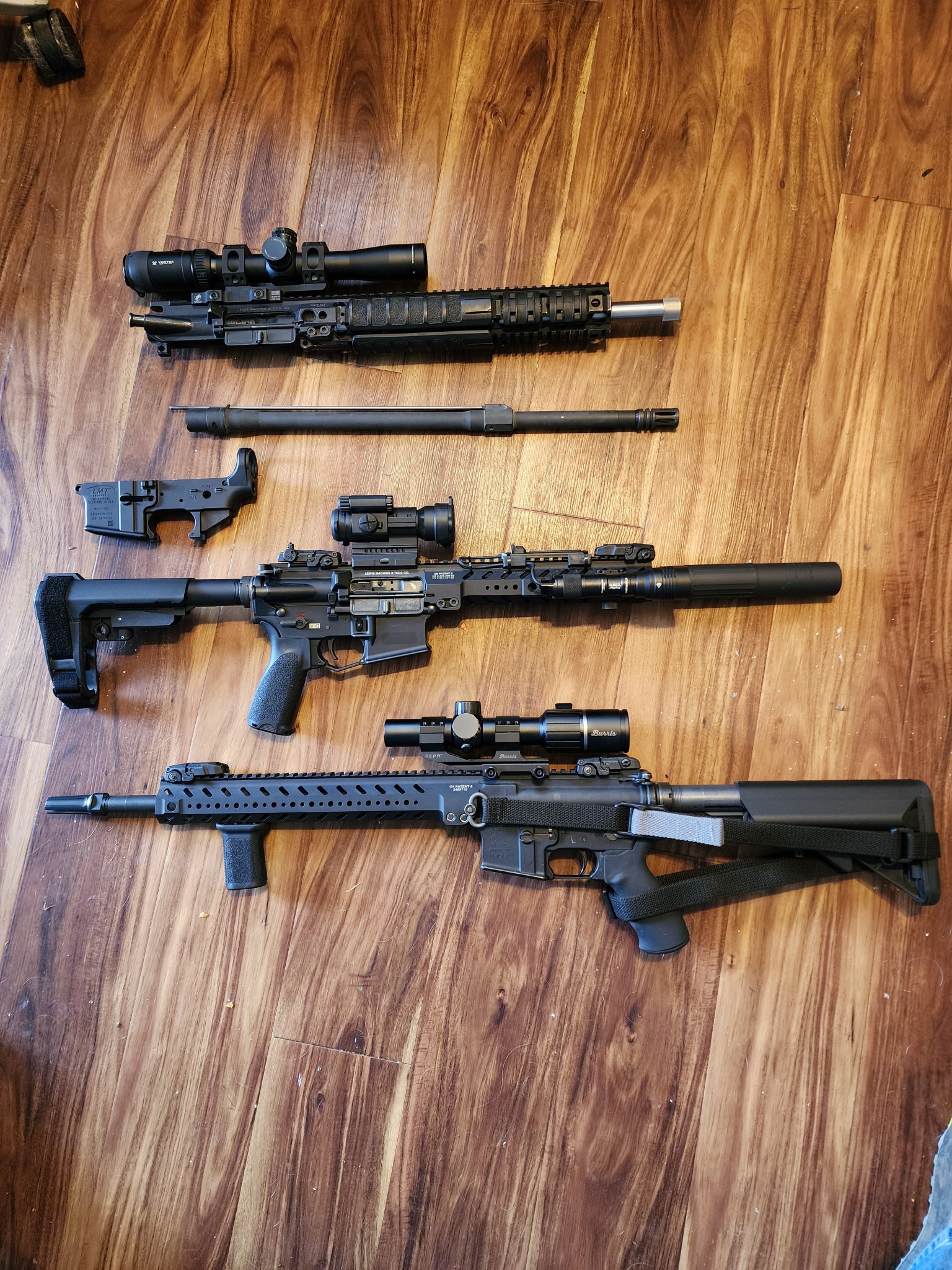

I'm an admitted LMT fan boy. The quad rail upper is from a LEO trade-in I got from Colonial Armory. Anyone else remember Steve? Lol. That upper came with the lower on the bottom rifle. Over the last few years I've picked up both SLK uppers, a 224 Valk conversion, 10.5" 5.56 barrel, MARS lower on the pistol, and had @unclemoak do a 450 Bushmaster conversion which is in the old quadrail. I know I don't use them to their potential, but I also know they will 100% function when I call on them. Now I just need to decide if I want to build another pistol or rifle with my lonely defender lower.

More testing today with POI shift. I can definitely see a d.wilson modded MRP in my future. Today saw an average deviation of -.3 mil elevation and .2 mil right compared to the control prone/bipod/bag string.
Kinda feel like the MRP would clean up the deviation. For now, I’ll add .3 to my DOPE and hold left .2 when shooting in other positions. Hopefully it’ll pay off for a DMR match on Sunday.
