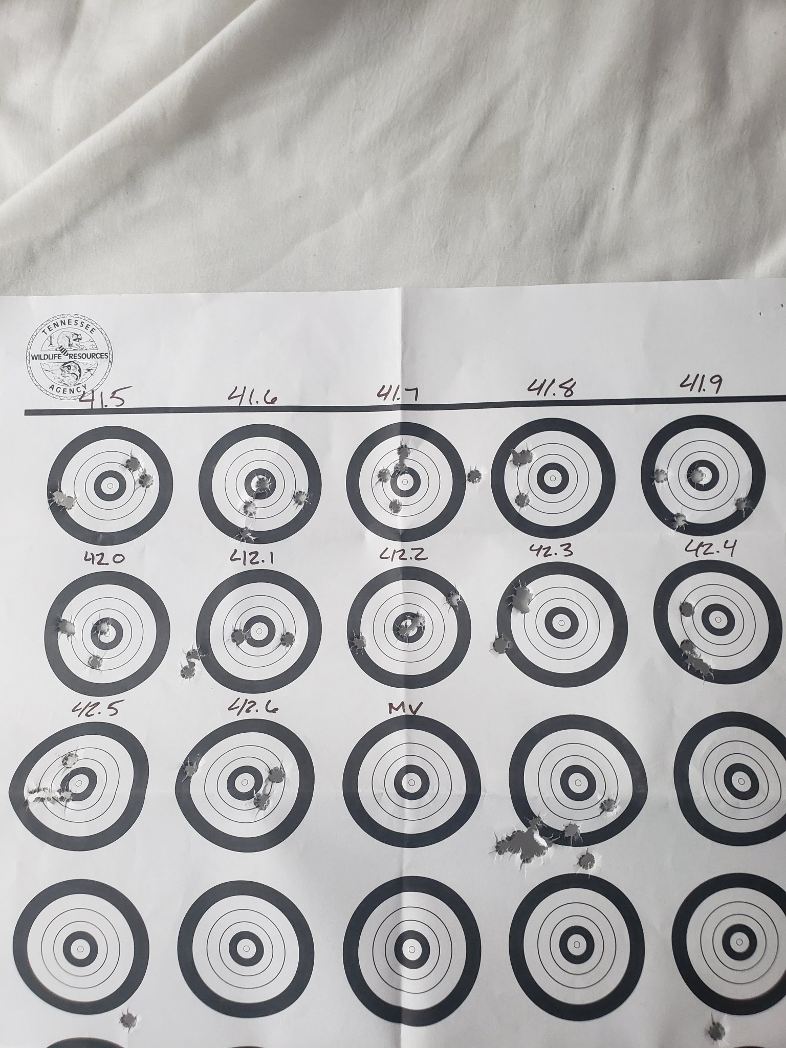

Have you run an Optimal Charge Weight test yet? (Ignores group size, sees where groups have similar average points of impact up close)
Have you run a Ladder test yet? (sees where shots land in relation to one another vertically at distance)
If so post up some pics of your target results.

As for ocw. Yes I did, I'll post pics as soon as I figure out how. Ladder test no I haven't yet.

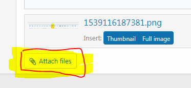

If you have them on your phone or saved on the computer you can use this tool
Or you can "attach" and then with your cursor where you want it you can click the full image to insert it into the body

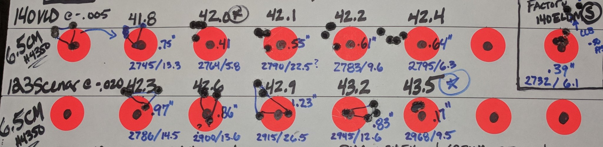

That is tough to decipher, centers of your groups shift pretty good even with the .1 increments.
Can you confidently say that you were shooting good last weekend? Sometimes Ill have those days where I struggle to get everything to make what could loosely be described as a group, the next weekend with the same exact load work ups and they are shooting great.
Didnt answer it above: these were all shot with unfired brass? Im going to guess yes and thats the center of your issue.
I'm confident in saying i was shooting good that day. I brought 2 other rifles out to confirm that for myself and both of them shot like they usually do, groups were consistent and tight with them.
And no, that picture is once fired brass

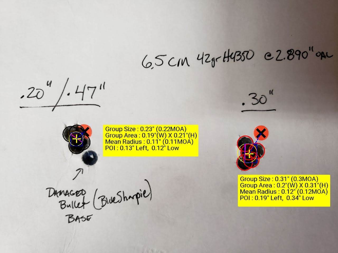

I've got a Criterion 6.5CM also, in a Howa 1500 with Bighorn barrel nut system (Remage for Howas). It shot a bit iffy to start - like .75-1.25moa. I took it apart, torqued nut again and let it shoot itself in a bit. After about 80-100 rounds it came right in to 1/2 moa.
Personally, I've not had much luck with Satterlee method; statistics being what they are, its possible to get a flat spot in the wrong node (i.e. good SD/ES but bad precision) and Chase your tail trying to improve groups.
I have much better luck with a 4 round OCW test starting at .010 off lands for VLDs or .020 off lands for Secant/hybrid ogives. I typcally shoot them at .3gr intervals in a flat row with a level line drawn across the target. This helps identify the "high point" and "low point" of barrel harmonics. Like this:
In this example, I already knew ~42gr was the node but wanted to confirm with .1gr test. First two VLD group was shot at wrong paster so I just marked accordingly and transposed group with sharpie.
Notice the group center at 41.8, 42, 42.1 and 42.2 are all similar L/R and U/D. 42.4 shifts left and down. That was shot with about 100rounds down barrel; it has tightened up considerably since with same load (and very limited cleaning).
With the SMK, while 43.5 shot SUPER well in that group, it was not repeatable (at least not .17" repeatable). It shot about .5" in subsequent test of same load but the SD/ES weren't all that great around 16/30+. But it was still in the best node for that bullet test. The barrel was at it's bottom point so it shot pretty well.

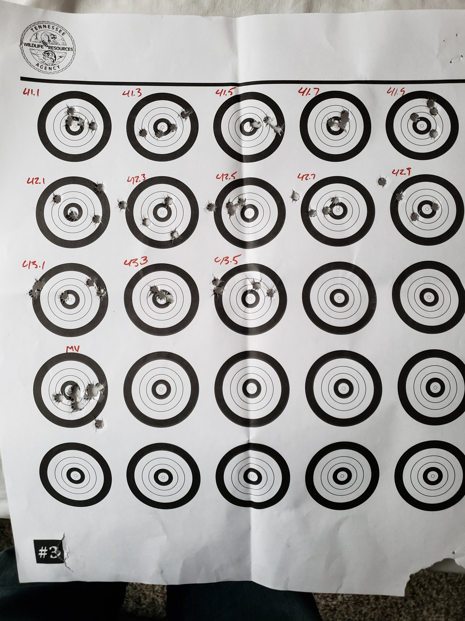

I loaded up some berger 130s and the results were way better than last weekend. Note: 1 round for velocity and 4 for groups.
Charge weight, mv, group size
41.1 2779 0.69
41.3 2772 1.23
41.5 2803 0.70
41.7 2811 0.45
41.9 2831 0.82
42.1 2849 1.12
42.3 2868 0.95
42.5 2864 0.84
42.7 2889 1.11
42.9 2879 1.57
43.1 2916 1.54
43.3 2939 0.48(theres a called flyer to the left of this one)
43.5 2922 1.59
Over all it's a lot better than last time I had the gun out. I think it just does not like the 147s. Next up is to pick a charge here I like and load up some more for a seating depth test.

I would have done 42.6, reasoning being 41.5 is strung out to the right side and 41.7 is centered, telling me that 41.6 would be right in the middle of the two but if it gets hot or cold that could cause it to shift to one of those sides
42.5 and 42.7 are both strung out but they are strung out centered in the same location so hopefully with the seating depth adjustment you’ll be able to close those groups down smaller and not have it shift to one side or the other.
