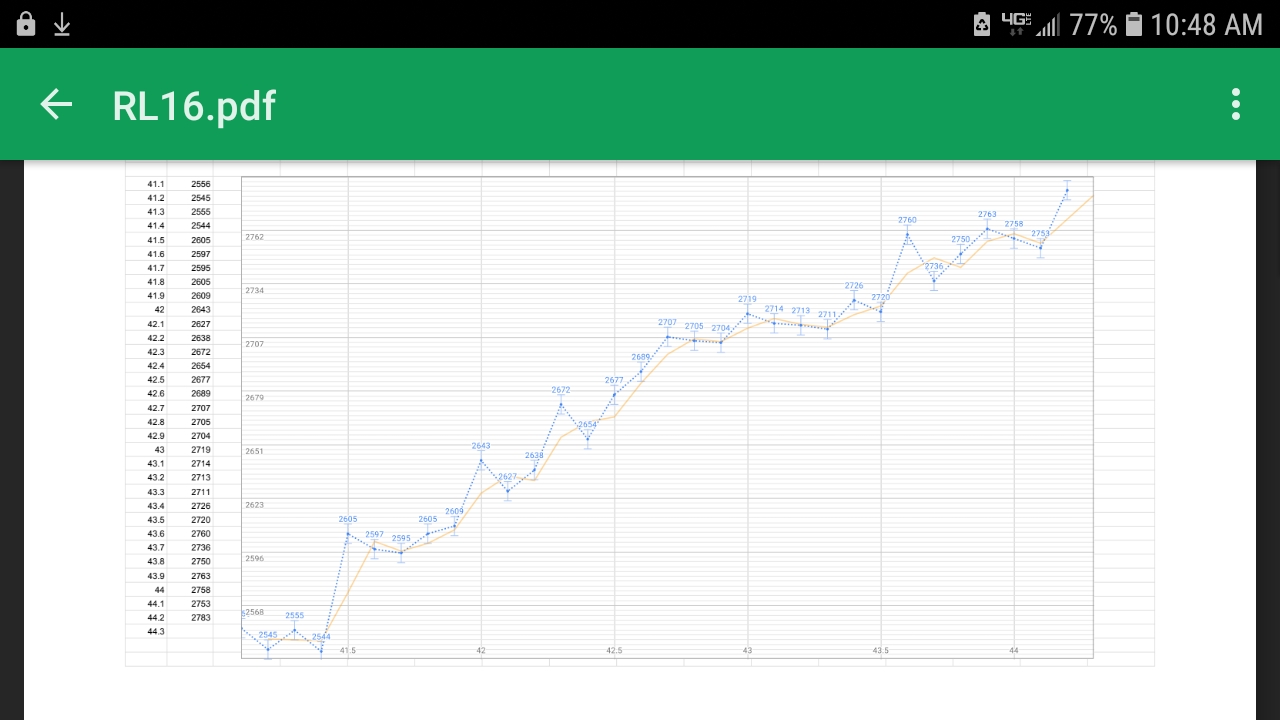

I use RL16 in my 6.5 with 140 hornady match. 42.3 grains sub .5 accuracy
7083265
22" Remington barreled action
6.5 Creedmoor once fired Hornady
BR2 primers
140gr ELD .040 off the lands
Shoulder bump to just over sammi max.
I went back out and tried the 43-43. It was ok.
Also tried 39.9 with two of the same fps and one +15, and 44.0gr and got three shots within 1fps. All around 2800fps
Started getting crunchy around 44.4gr
