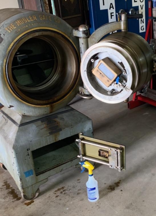

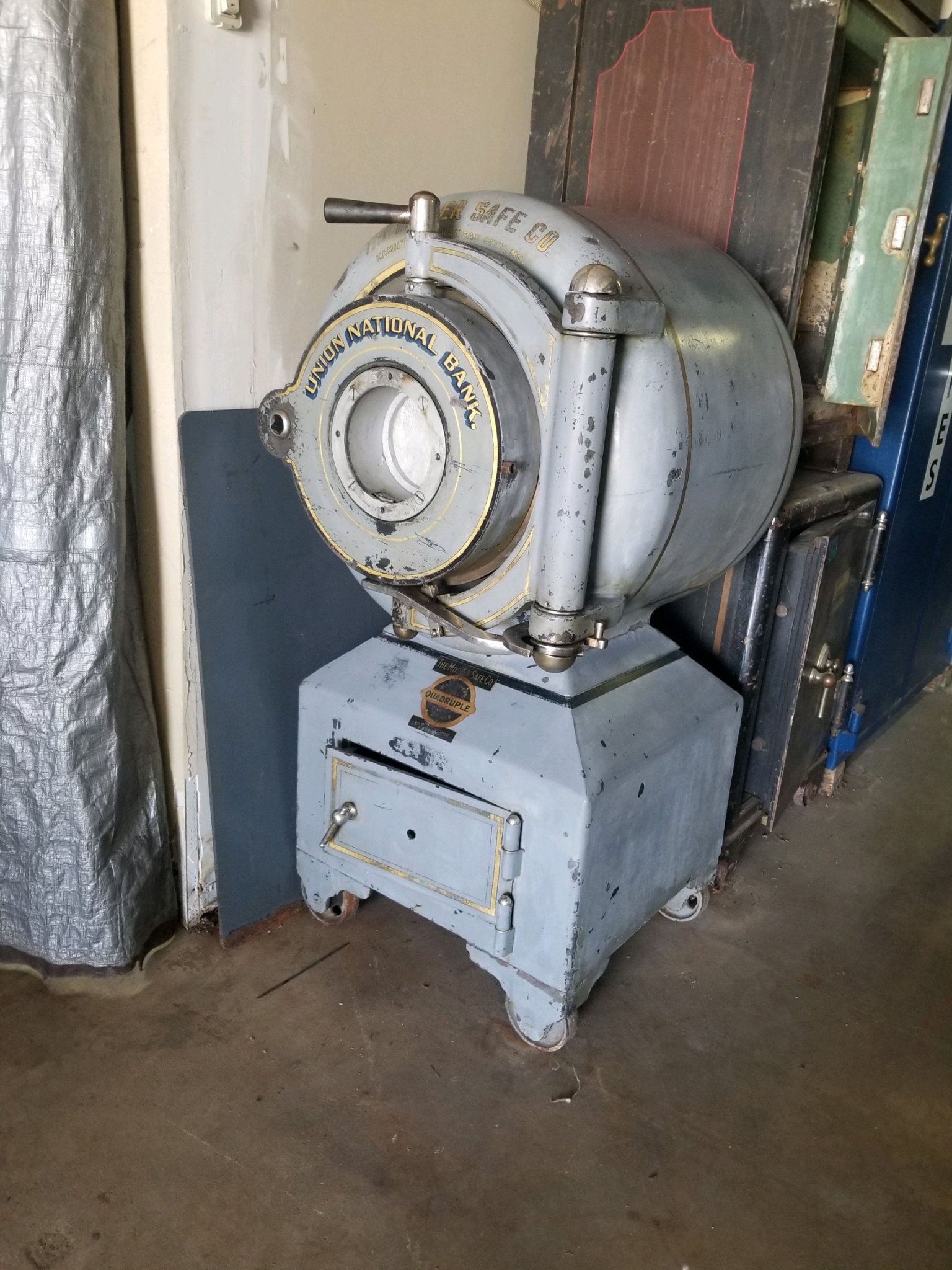

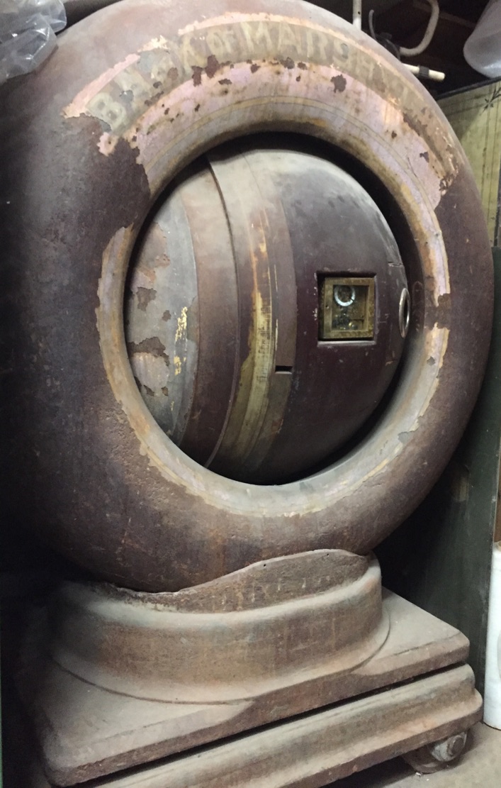

Here's a 1926 cannonball safe. About 4 feet tall, 2.5 tons. Storage about the size of a couple of small desk drawers. The ease of turning the ball is astounding, but you can really feel the mass of the thing.
First time I've ever seen anything like that. Can you post a photo of it with the door open?
Reactions: TACC
It's been several years since I had the privilege of seeing part of a well-known local locksmith's private collection, so memory is a bit fuzzy. It never occurred to me to photograph open/closed state.
There is no "door." Rather, when the clocks - one of which is visible in the image - unlock, the ball can be rotated to expose a drawer which is pulled out like a desk drawer. If I recall , that drawer was about 3 inches tall and maybe 10x15 inches. It's a tiny amount of storage for such a massive device.
Edit: there may have been two drawers. I simply don't remember. Maybe one of the experts here has more info. I do remember its owner saying it was, and remains, about the most secure safe design ever contrived.
Thanks for the explanation. I suppose there is a tradeoff of space available vs. security. You can make something so massive it cannot be lifted and carried away, and/or so secure its lock cannot be defeated but holds almost nothing.

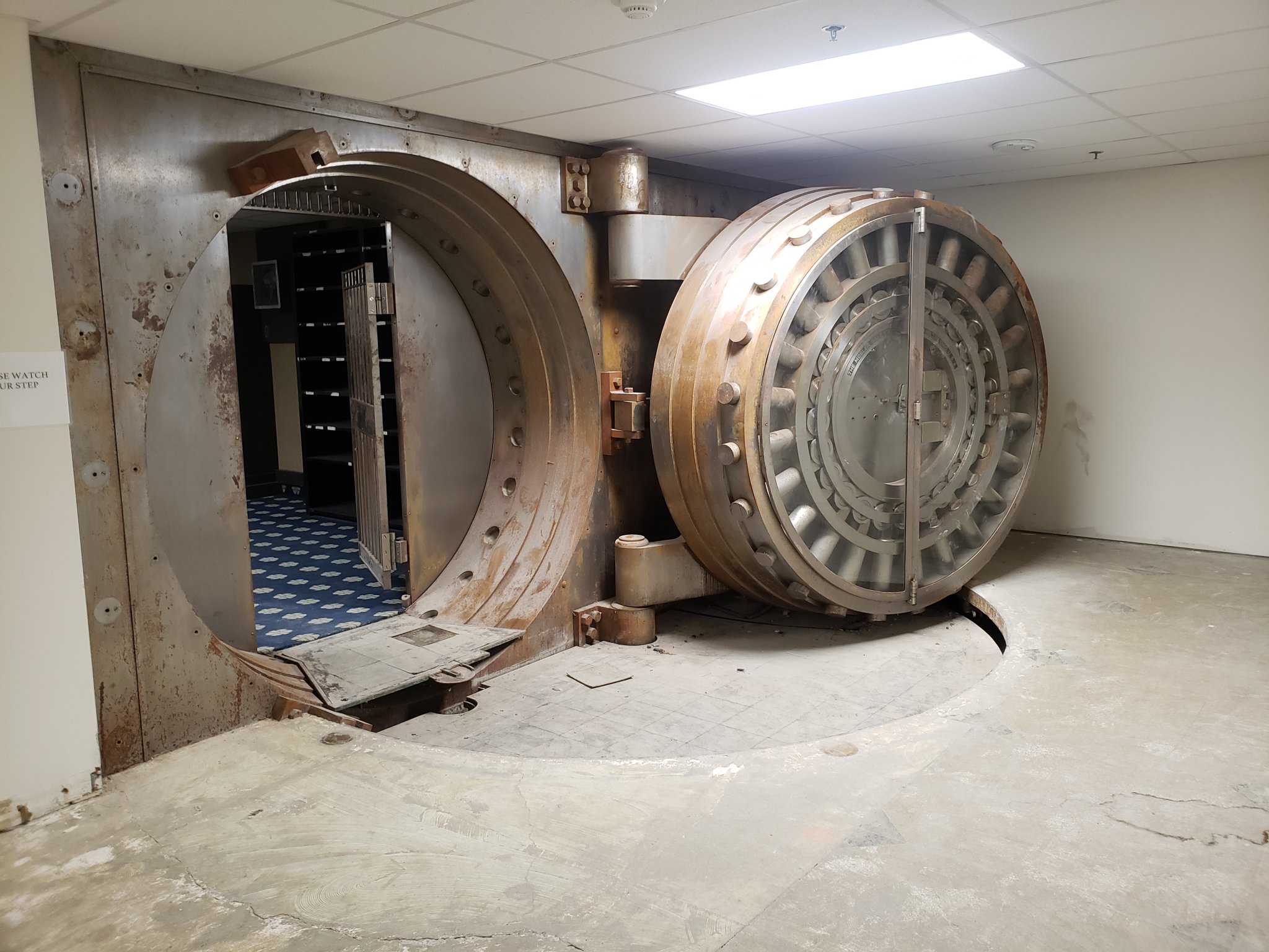

One of three vaults in an old bank building in downtown Wichita, KS that has been turned into high end apartments. The door is a good 8' in diameter and the floor in front of it is raised and lowered with a gear driven mechanism so the door can open.
Bigger than I need for my guns. So far. Maybe next year. . .
I just love those old safes! They are a work of Art and ALOT of machining & Engineering!

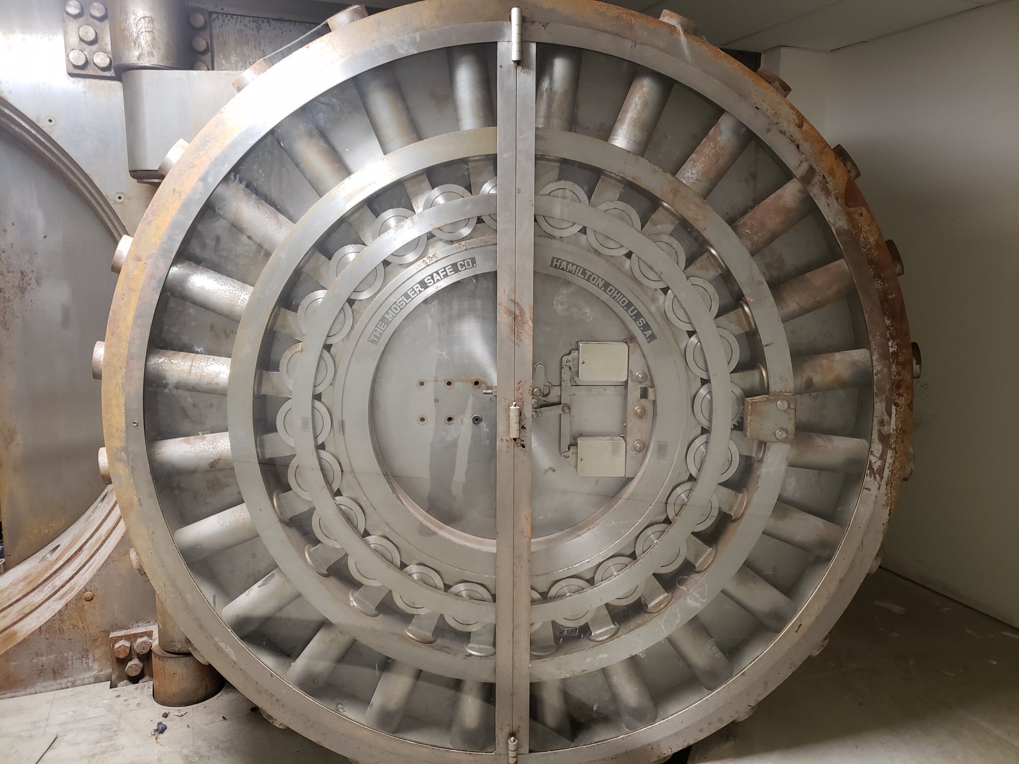

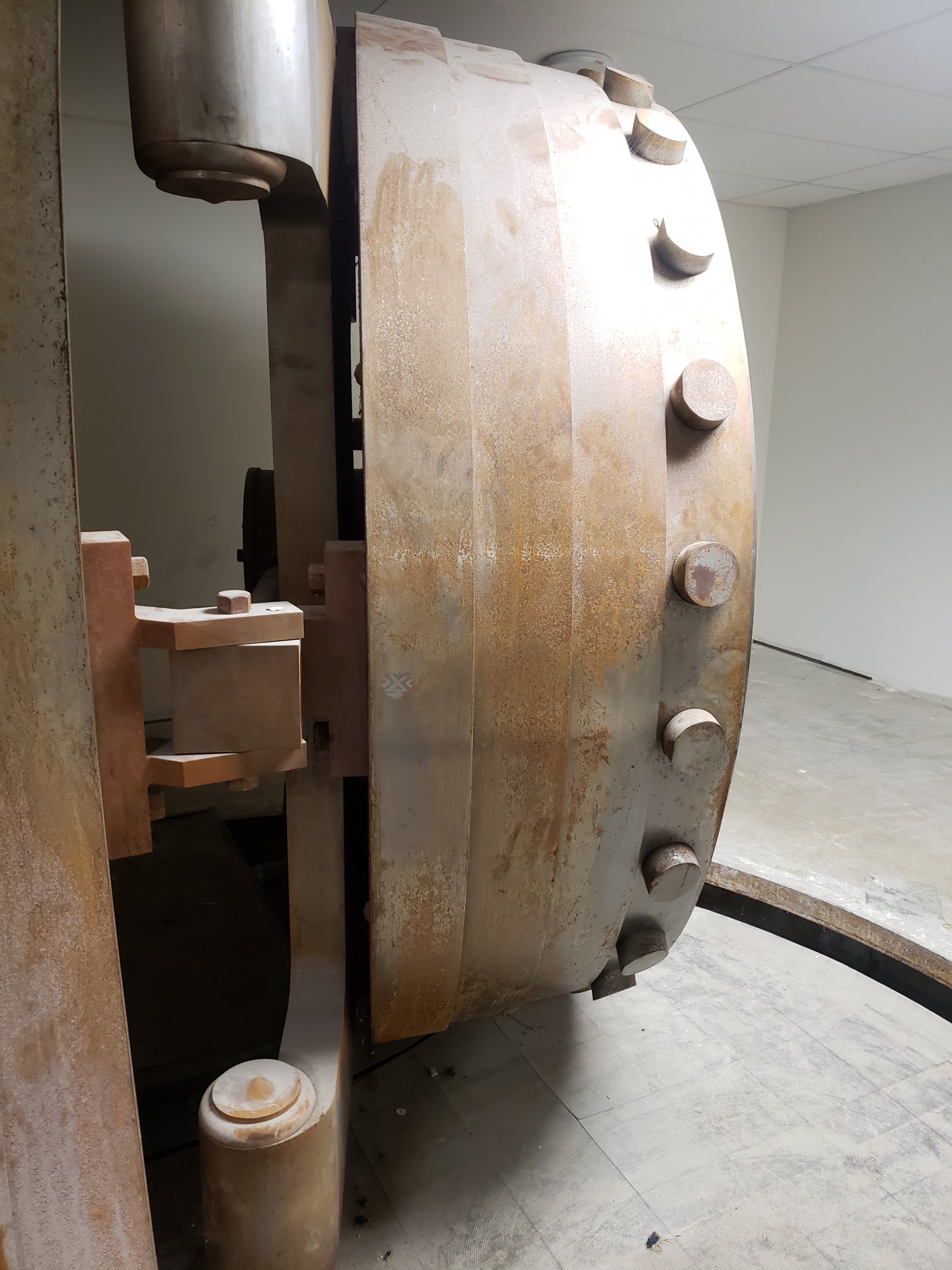

One of three vaults in an old bank building in downtown Wichita, KS that has been turned into high end apartments. The door is a good 8' in diameter and the floor in front of it is raised and lowered with a gear driven mechanism so the door can open. View attachment 7285774View attachment 7285775View attachment 7285777
I cleaned MANY of those doors, they had to be cleaned regularly or they would rust.
When that vualt was assembled,you needed to be able to close it with one finger for it to pass quality control.
They weigh about a ton an inch
When that door was installed they didn't use a big ass crane, they built a ramp into the basement and drove a big truck down it.
The guys that installed these doors made big money,my FIL was making 100k in the 70's
For the period of about 50 years the only places that made those doors were in Ohio- Hamilton and Canton
Diebold/Hamilton

I'm laughing at the bottom door, because Diebold,Mosler and Hamilton ALL used the same locks for everything.
It always amazes me to discover that some huge piece of equipment -- a vault door, in this case -- was shipped hundreds of miles or more before we had trucks and highways. When I moved to northern Nevada I discovered the water for the town of Virginia City was piped about 15 miles from a high mountain lake (man-made), down a valley about 1500 feet lower, then back up to Virginia City, not much lower than the lake where it started. No pumps, and the pipe, made of flat steel, spiral shaped and riveted together, was fabricated in Scotland and carried by sailing ship (this was in the middle of the nineteenth century) to San Francisco, then overland to Carson City. I read somewhere that the steel used for the pipes was 8" thick at the bottom of the valley. Amazing!

I have a big Rhino Metals USA made model with a Sargent & Greenleaf electronic pad/code lock. I like it. Its not top of the line but neither is the stuff on the inside LMAO
