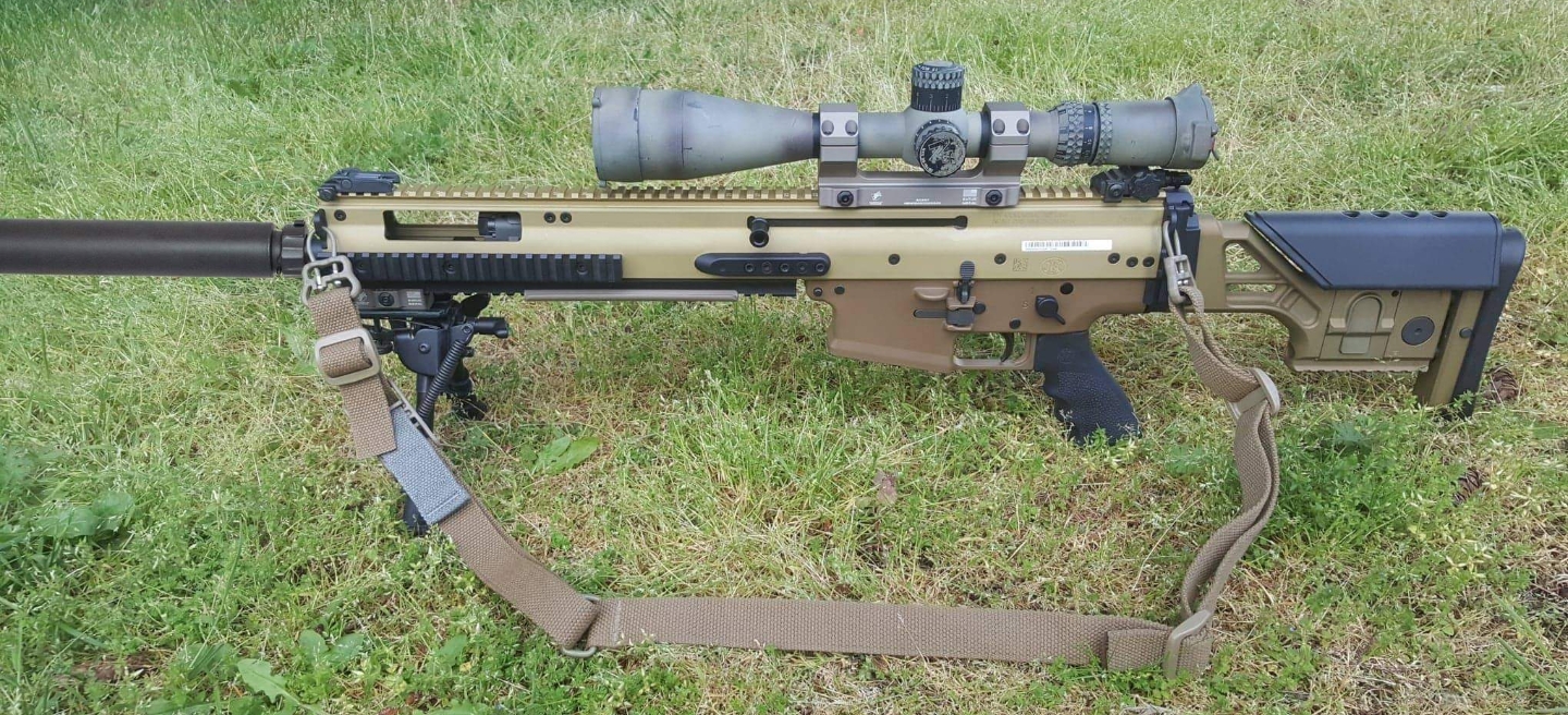

I know, I can get a Scar 17 already in 16 inch, but I want the heavy barrel and 3 lug mounting system for the barrel. My Scar 20 is ridiculously accurate, and so my thinking is a 16 inch version would scratch the itch of wanting a 16 inch 308 rifle, but not using the light barrel Scar 17. Id also swap the stock for the standard folding setup, then I basically have a bad ass looking full rail 16 inch Scar with sub MOA accuracy and a heavier profile barrel. I already have a Scar 17 13 inch SBR that shoots wonderful, but I havent had good luck with the full length Scar 16/17 running a can because the barrel gets warm and strings shots, and even then they are typically 1 MOA at best, where as my Scar 20 is consistently Sub with many groups 1/2 or less.

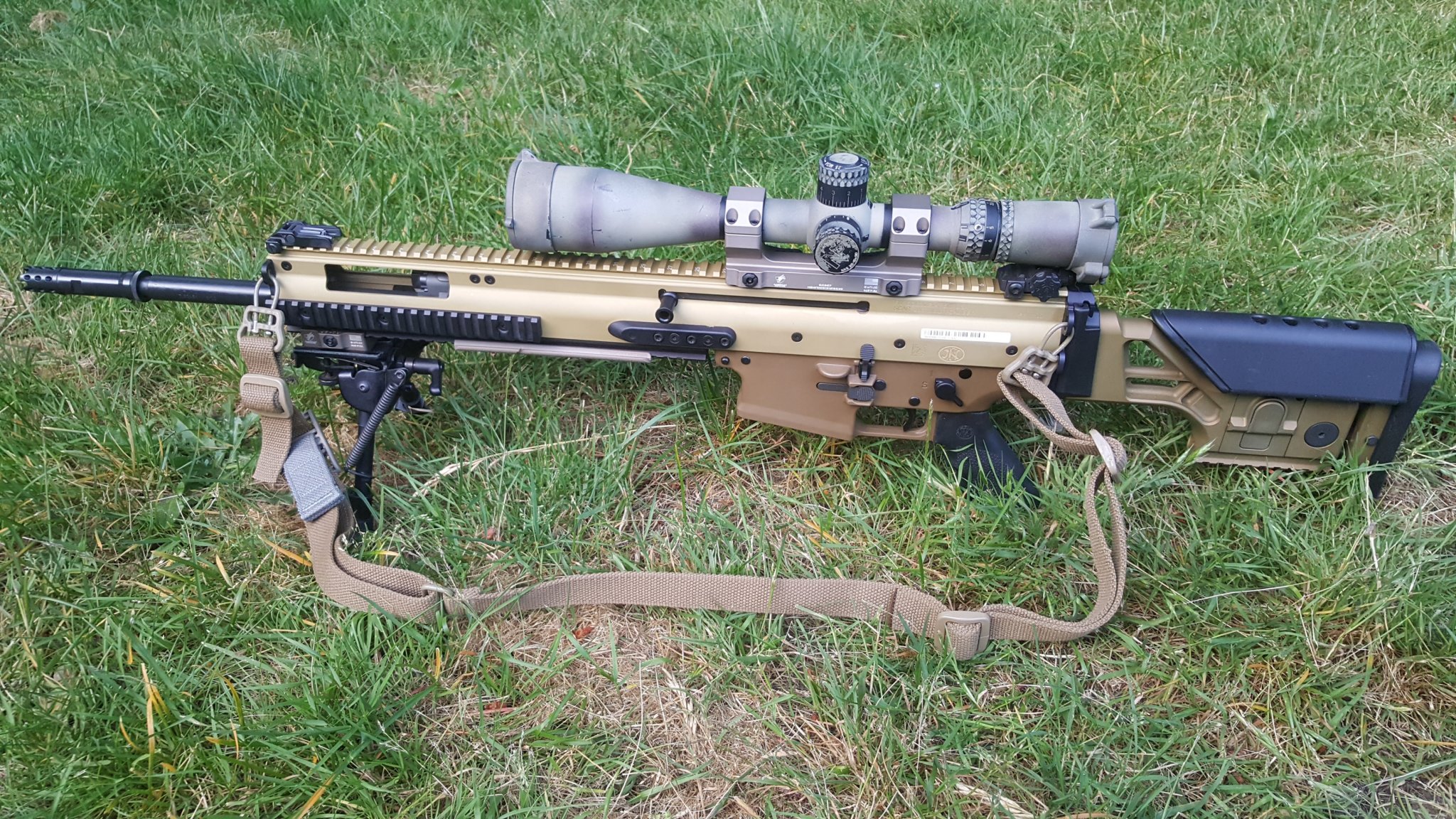

Hey Mike- I have one and I am going to do the same thing. I seen a guy over on a SCAR owners group posted pics of his cut down and it looks awesome. It was a company called Weapon Genetics and I think he said it was 150 for cut and re-thread. There are some pics over on the gunsmiths facebook. I am probably going to use him since he has a fast turn around as well.
That looks pretty awesome...

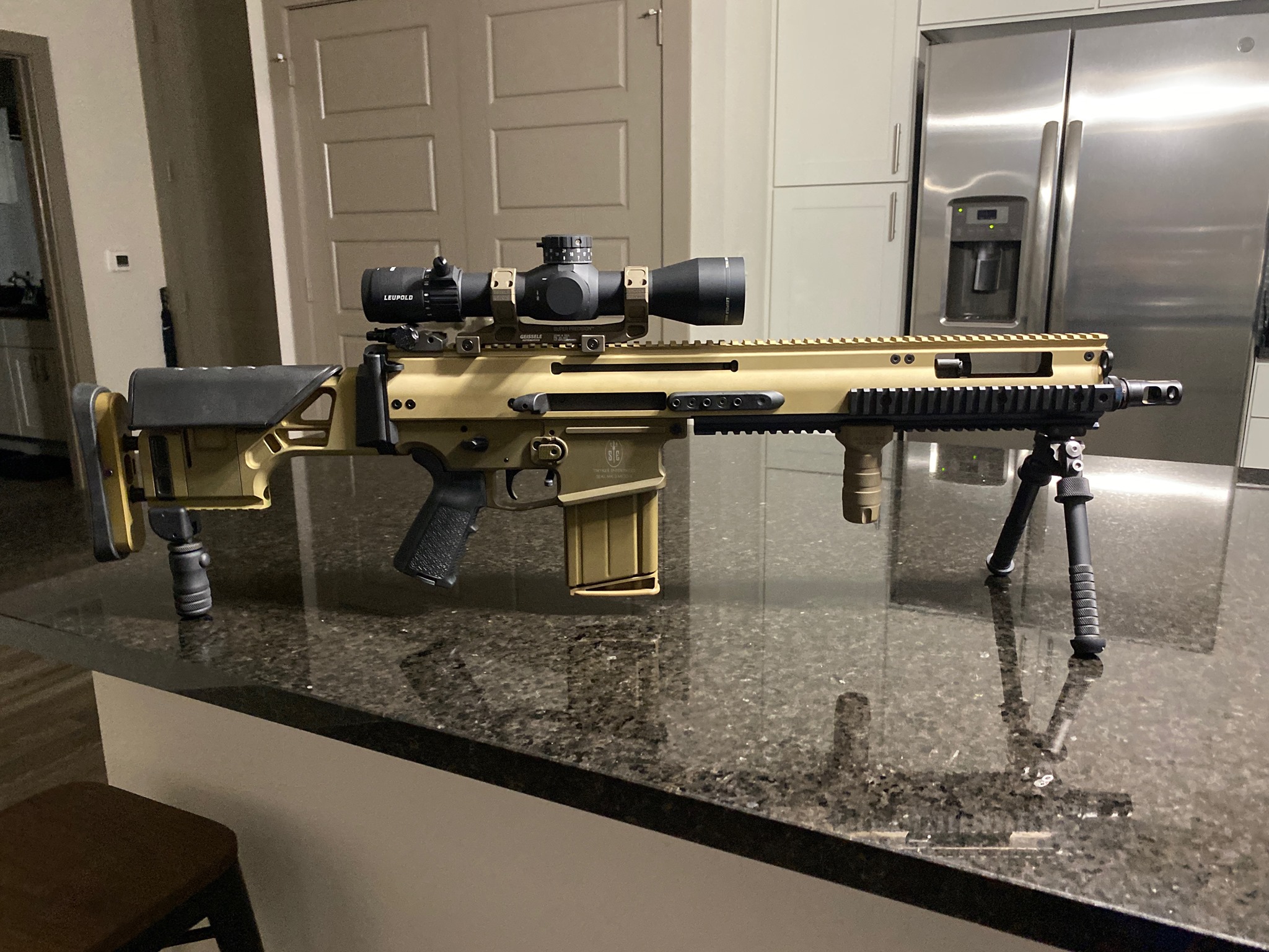

I got inspired, so I brought my MK20 in to my gunsmith to cut and thread down to 18". I always hated the step down back to pencil barrel diameter the last 2 inches. A little shorter, a little lighter with little velocity loss sounds like a good deal to me. I'll update when I get it done.

curious to know how it shoots. the step down looks odd, so i put the surefire brake that goes over that part.
i assume the military requested the step down to accommodate a similar muzzle device (gone now with the 6.5CM version).

I recently cut my 20s down to 18" to get rid of the lousy step down at the last 2". It feels perfect to me right now. Lighter, better balance and my accuracy improved. I could care less about warranty as fn wouldn't give you parts much less the time of day regardless. I probably voided it when I put on a suppressor anyway.
