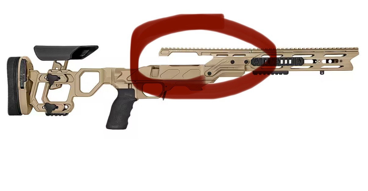

Hole patterned actions? Where the scope mount is not i regretted into the chassis right? Not interested in prs in the slightest
The integrated top rail will only fit the top of a 700. Otherwise you can put use the integrated top rail as is and can use any action with a flush rail (like impact) if you don’t intend to use integrated top rail
Like a b14 hmr action would work
No. This piece circled will only work on an actual rem 700 action not any of the clones. I would be more concerned about the action than chassis
If you’re not worried about using that piece an impact action should work or any action where the pic rail doesn’t extend beyond the body
