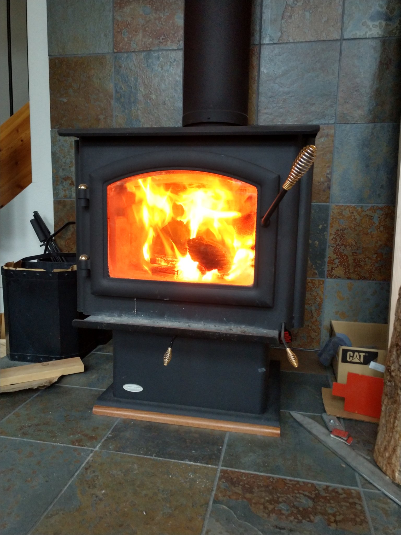

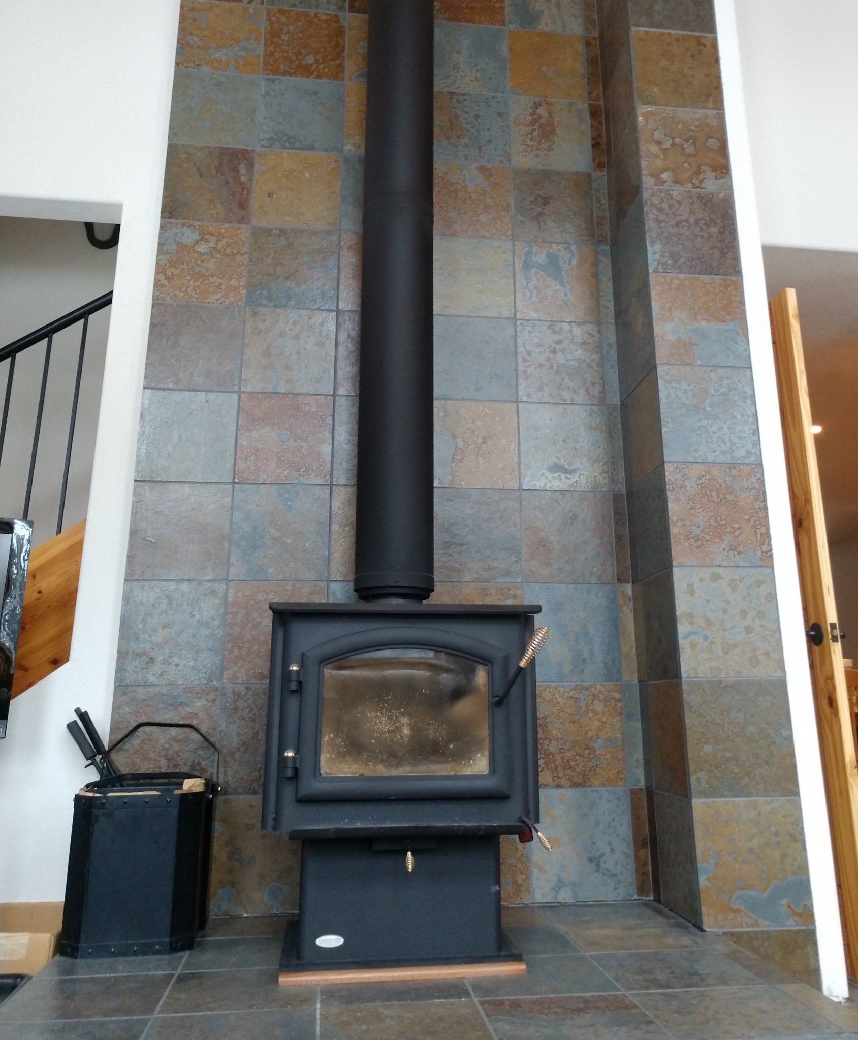

I run mine 24/7 six months a year. Heats 2400+ sqft, and I use it as my primary heating source when I'm home. I keep my thermostat set at 62-deg, and the only time the furnace kicks on is when I'm away.
Pictured stove is 15-years old. Dealer said to go with 8" stove pipe as I have almost 30' feet of rise. I installed a cold air kit when building the house. Draws cold air from the outside through 4" metal duct into the bottom of the stove, so you're not pulling as much warm air from inside the house, and sucking cold air through window and door seals.
My next build will be the same exact stove. I have a close friend who is a stove dealer, who I met a few years after buying and installing this stove, and he said I made a good choice with my set up.
Stove burns so clean, I only have to sweep it every four or five years. I only burn lodgepole pine with the occasional aspen, and usually wake up in the morning to hot coals still in the stove.
Forgot to mention. Make a decision on what you want the purpose of your stove to be. If Primary Heat, or Backup Primary Heat, get it out of you thought process that you want a low cost or elegant looking stove. Focus on efficiency, reliability, heat output, and size of firebox.
Between my neighbors, friends, and my buddy who sells stoves, I constantly hear stories how people who purchased stoves based on cost, or how fancy they looked, and then found out later that they are totally unhappy with the performance of their stoves. Typically its the same story; hard to get a fire started, hard to keep the fire sustained unless it's running wide open, and/or they wake up in the morning to a cold stove, and have to repeat the process of starting a fire.
With my Quadra-Fire, I can get a fire going with a single sheet of newspaper, a few small sticks of wood, and a couple pieces of kindling. After a few minutes of burning full size pieces of wood, it's like a blast furnace in the stove, and I can dampen it down without it smoldering or burning out.
