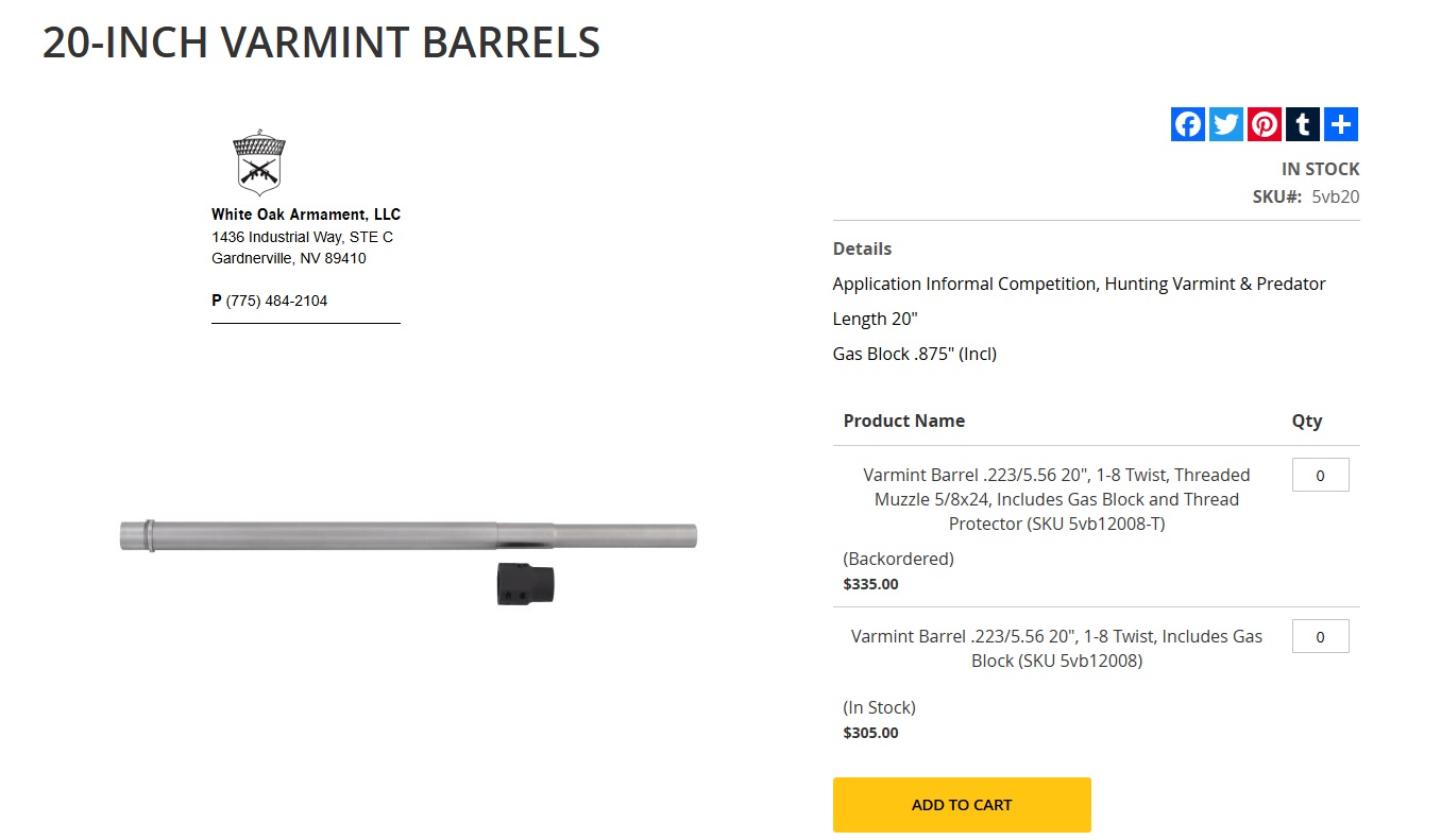

You can get a brand-new White Oak varmint barrel (16-22 inches) installed into your current upper for way less than $650 for a new rifle.

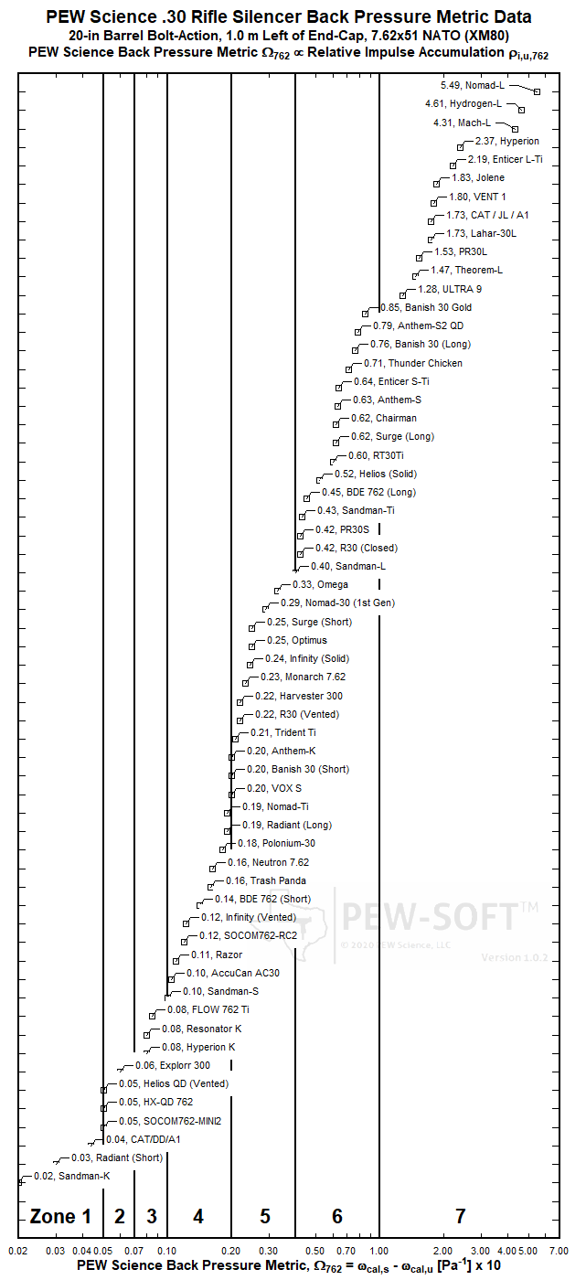

Suppressors can affect the function of a gas gun, and the shooter's comfort to some degree. This can usually be resolved by using various tuning methods, but if you plan on running a high back pressure suppressor all the time, the best way to start is to have a proper gas system length for the barrel length (dwell). There isn't really a universally accepted back pressure rating system, but the chart below shows values assigned by one organization for various suppressors. The higher the rating, the more that you might need to tune the gas gun.

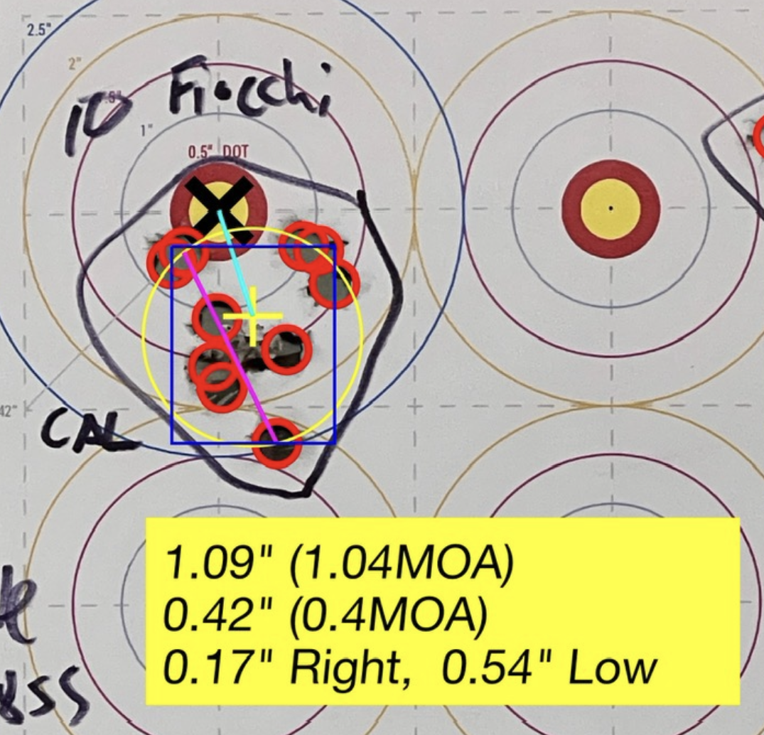

in 55gr loads, both the Hornady 55 V-max & the ADI 55 Sierra BK are good; I don't buy either regularly as I handload both bullets, but the factory ammo I have shot of both are decent.
In a heavier bullet, factory loaded, the IMI 77gr Razorcore has been good in every rifle I've shot it in; 77gr Razorcore is the group on the right.
