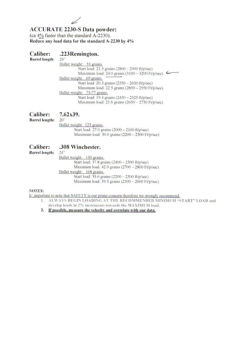

I found some loading data for AA 2230-S but cannot find this powder. All I can find is AA 2230. It say the AA 2230-S is 4% faster so can I assume a load of none S can be 4% hight than S and still be safe.

Thanks. We found some AA 2230.
Is off the shelf AA 2230 an S type powder or is this a special powder not available in the US. Does this mean that max load should be reduced to 23.04 gr instead of 24.0 when using non- S type powder? See note under title of page. I know, start low and work my way up but the 24.0 gives me the 3200 fps I'm looking for if that turns out to be the more accurate load with a 55 gr blitz king
  • 2230-s.pdf
You'll want about 24gr of AA2230 and 2.220" COAL would be my guess. The Speer varmint bullets are affordable and shoot well. There is a whole thread full of 223 loads here:

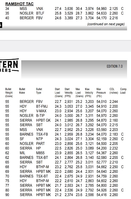

Well, I looked at all three powder and each one can get me close to the 3,240 FPS with maybe a few 1/10 over max load. That would get me in the ball park of matching the speed of factory 223 match ammo off the shelf. Now to find out which one if the most stable in all temperatures and burn rate is consistent. Never used any of these powder because I never owned anything less than a 243 Winchester which I regret getting rid of as well as my 7mm mag. Anyway if you have more information please let me know. In the meantime I grabbed some Accurate 2230, Sierra 55 Blitzking, LC Brass and Federal small rifle match primers. Now the funs starts. If anyone has a know good load for this combo please let me know. Thanks in advance.
Well it's now onto the next question. I have this chamber in my RRA -https://www.shootingillustrated.com/content/223-wylde-the-ideal-ar-15-chamber/ and have fired ~ 500 rounds. I saved the brass and now as you can see want to reload. I need the ammo to fit into the mag so I am assuming I should just do as the manual says and make sure I am at factory OAL and all will be well. Should it be 2.251 or 2.260 difference manuals are giving different OAL for an AR 15

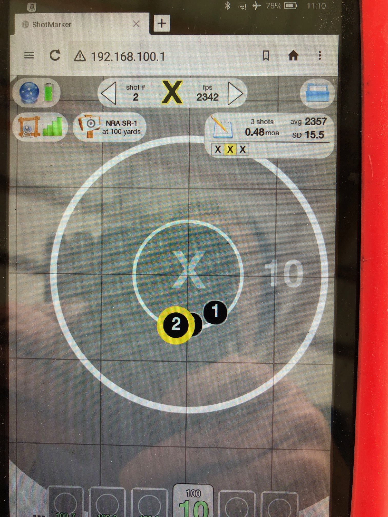

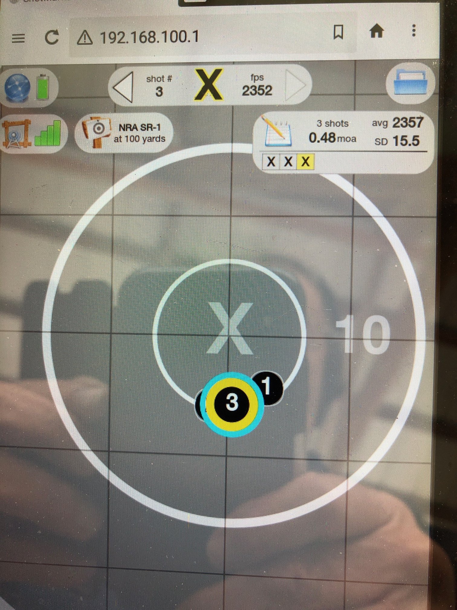

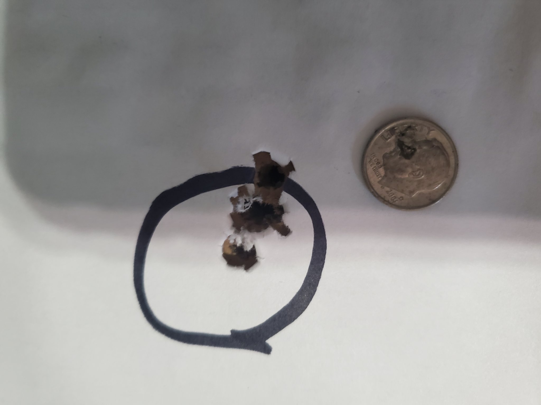

Well, after using red dot vortex 1 - 6 on the range yesterday at 100 yards trying to group I discovered the best I could do was .800 MOA and that to me is not all that good. This comes from shooting the center out of the paper target with a 308 prior to trying to sight the AR 15 in at 100 yards where the red dot basically filled the entire 1" X ring on the target leaving only a partial white line around the remaining X ring to try and make the red dot concentric to the X ring before pulling the trigger. So, with that I guess I need a crosshair scope for the AR with possibly a green dot when needed and powerful enough to actually see the center of the X so I can place the crosshairs dead center of X intersection. I also don't want to spend an arm and a leg. If anyone has some suggestion, please advise.
Well, I lost my old post I wanted to update with this photo but the best I could do with off the shelf PMC 55gr FMJ-BT 2,900 FPS was as shown with a 1-6 Vortex red dot @ 100 yards. There was just nothing to aim at except for a blown out 1" dia center which only had about 1.4 of the white line that surrounds it left. Yes I know this group is high but for me that's okay since all I am doing now is testing ammo. Eventually I want all three rounds in the same hole or at least a cloverleaf pattern. My next shots with this PMC 55 gs FMJ-BT @ 2,900 FPS will be shot off a lead sled elimination my inability to hold dead nut and to ensure rifle level. Having said that we are still pursuing an accurate load for a 223 using AA2230 pushing a 55 gr Blitz Kind, federal brass and federal small rifle match primers.

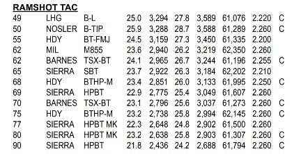

I've had good results with BLC2 and Tac using 69 and 75 BTHPs from RMR.
With Tac there is both 223 and Nato 556 load data available.
For the 300 to 700 yard distances I use the Nato loads.
The 69 and 75 definitely do better than the 55s both in the wind and long distance.

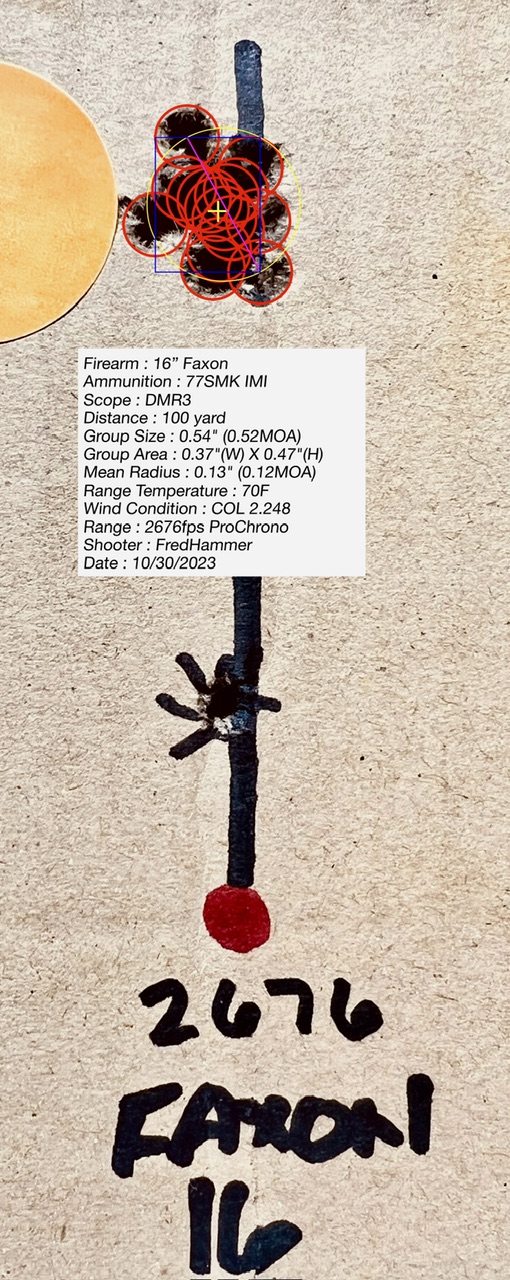

My RRA NM A2 Upper likes shooting 77 MatchKings with 23.5gr of Varget or 22.5gr of IMR-4895 at magazine OAL. Will hold 1 MOA if I do my part correctly.

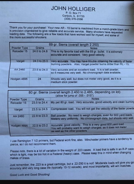

Yeah, he means 62 Sierra Game Kings. But its fine. You want accurate loads?
Here is a few, but note, every barrel is different. so BASICALLY, no matter what barrel you have, will "probably" like within .2 grains of the following
77 SMK 2.260
Varget 24.0
SW Precision Rifle 23.9-24.1
N140 24.1-24.2
N540 24.5
Benchmark 22.0
N135 22.0, 23.0
8208 XBR 23.3, 23.6
AR Comp 22.8
AA2230 22.0
RL15 24.0
to name a few popular loads.
69 Grain SMK 2.260
Varget 25-25.1
RL15 25-25.1
Norma 203B 25-25.1
55 Grain Blitzking
Benchmark 25.0
AA2230 26.0, 24.5
AR Comp 25.2-25.3
W748 26.4
H335 25.0
N133 24.5-24.7
N530 25.1
62 Grains Gameking, etc. Not many people load for this, for accuracy. So exclude this...its not accurate bullet compared to SMK.
BUT, if you want ot try your best..then here is what you will do. Get 1 of these powders:
Benchmark, AR-Comp, or N135. Load from 24.2-24.7, and probably near 24.5 with one will be your best load possible.
of all the loads on this list, AROUND 24.0 grains of VARGET for 77 SMK is BY FAR FAR FAR, the most popular. Its ultra temp stable, and its nuts accurate. Many people on here will say that if your gun cannot shoot 24.0 of Varget with 77 SMK, then your barrel sucks, because straight up, that load is probably universally GOLD status. lol

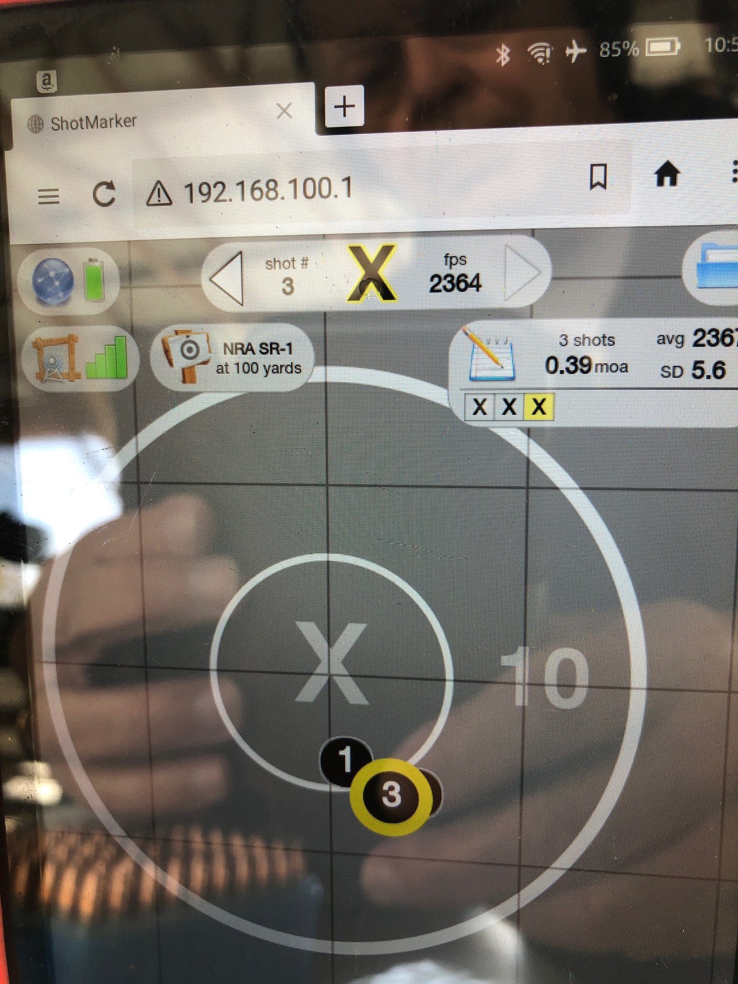

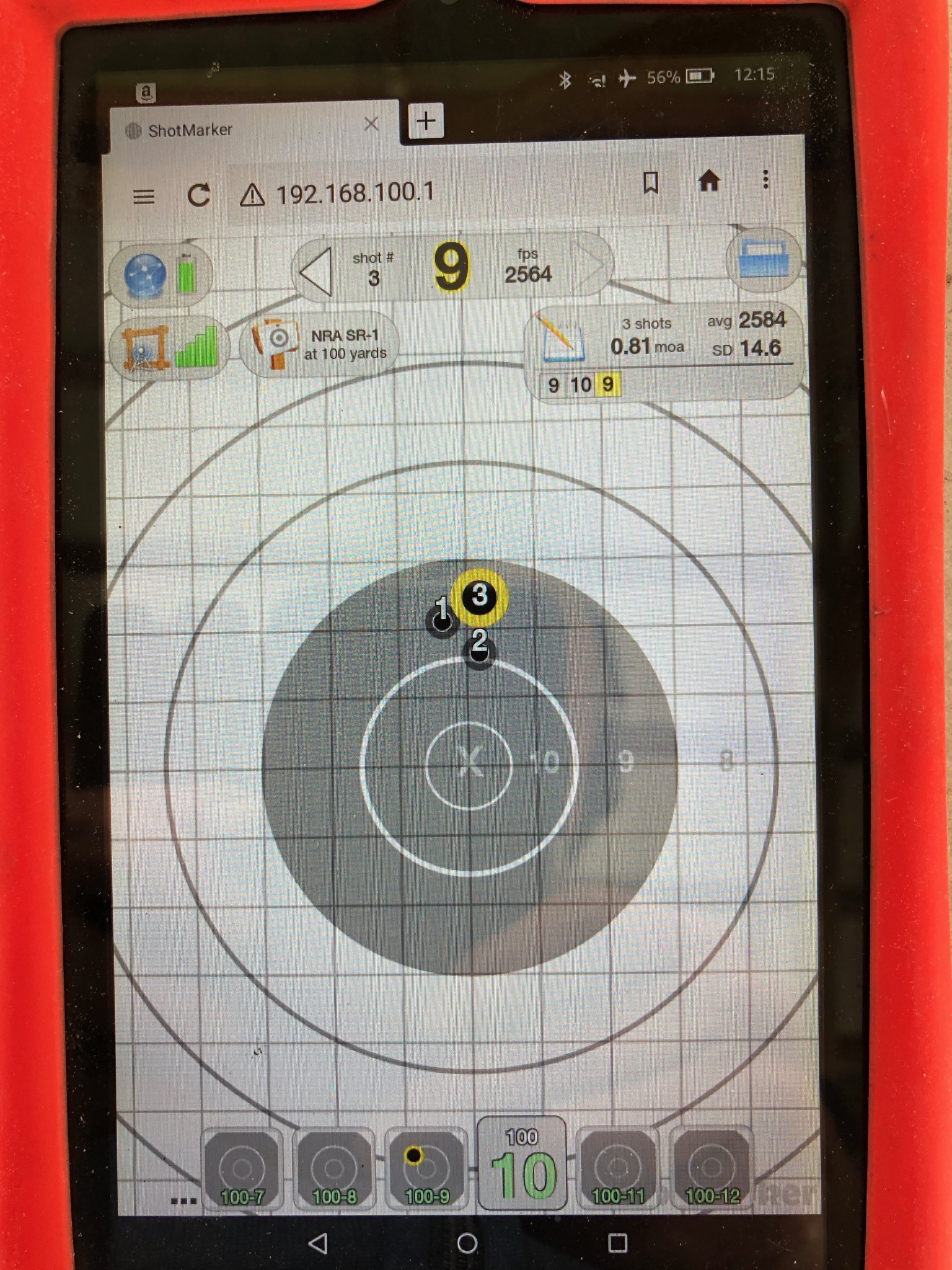

I could not get Varget but I did get A2230. From what I see here 77 SMK w/ AA2230 22.0 should be fine. Would you happen to have a photo of a group shot using this load. I am guess this text above 77 SMK 2.260 mean 22.6 grains. Please advise
I think it shows 23.7 gr of Varget is a compressed load so 24.1 must really be compressed. Anyway thanks for the insight. maybe some cases hold more than others. I'll be using PMC, LC and Remington. Don't have any idea which one has the most volume.

2.260 is the OAL. not the load. The load is 22.0 grains of AA2230. Which shoots pretty good for 77 grain bullets. Don't expect high velocity. Expect around 2600 FPS for 20" barrel. NATO pressure will be in the ballpark of 23.2-23.7 depending on brass basically. And that will generate 2700+ easily from 20" barrel.
For now I am loading 24.0 gr of TAC and it seems to be doing good but we will have to try the 23.2 - 23.7 gr of AA 2230
Reactions: simonp
The higher I went from 24.2gr of TAC in IMI case (H2O 31.5gr) with 77SMK the higher the SD went. So stayed 24.2 with 2715fps 18". Will be cruising 2750s @80F.
N135 at 23.7 in same case showed same velocity and great precision.
I got 8lbs jugs of both TAC & N135!
Running them to 1000yds, so need that speed.

Just got some things enroute by which I am excited to post the results in comparison to the 77SMK:
- 500 box of 77gr Berger (TACT)
- 21st Century .2215 mandrel
- Ginex primers. (Supposedly decent primers)
Test barrels will be the usual sub-MOA champs: 16" Faxon, WOA 18" SPR, BA 18" SPR (Sold BA 12.5",14.5", BA 16")
Also excited about the crops getting out and the ground drying out for some long balling the 77s of both brands to 1000yds.
Stay tuned!
I would be beyond excited with those results out of a Faxon barrel! Looking forward to seeing your results with the other barrels you mentioned.
What are the rest of the load details for this one ?
Reactions: FredHammer
This is with factory IMI 77SMK Razor Core. I am currently working on a clone of this clone of the MK262.
