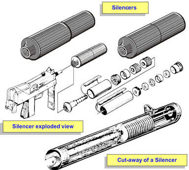

Image of cut-away and expanded views of a firearms silencer
Note: Any device that meets the definition as stipulated above in 18 U.S.C. § 921(a)(24) is also subject to controls of the National Firearms Act 26 U.S.C., Chapter 53.
