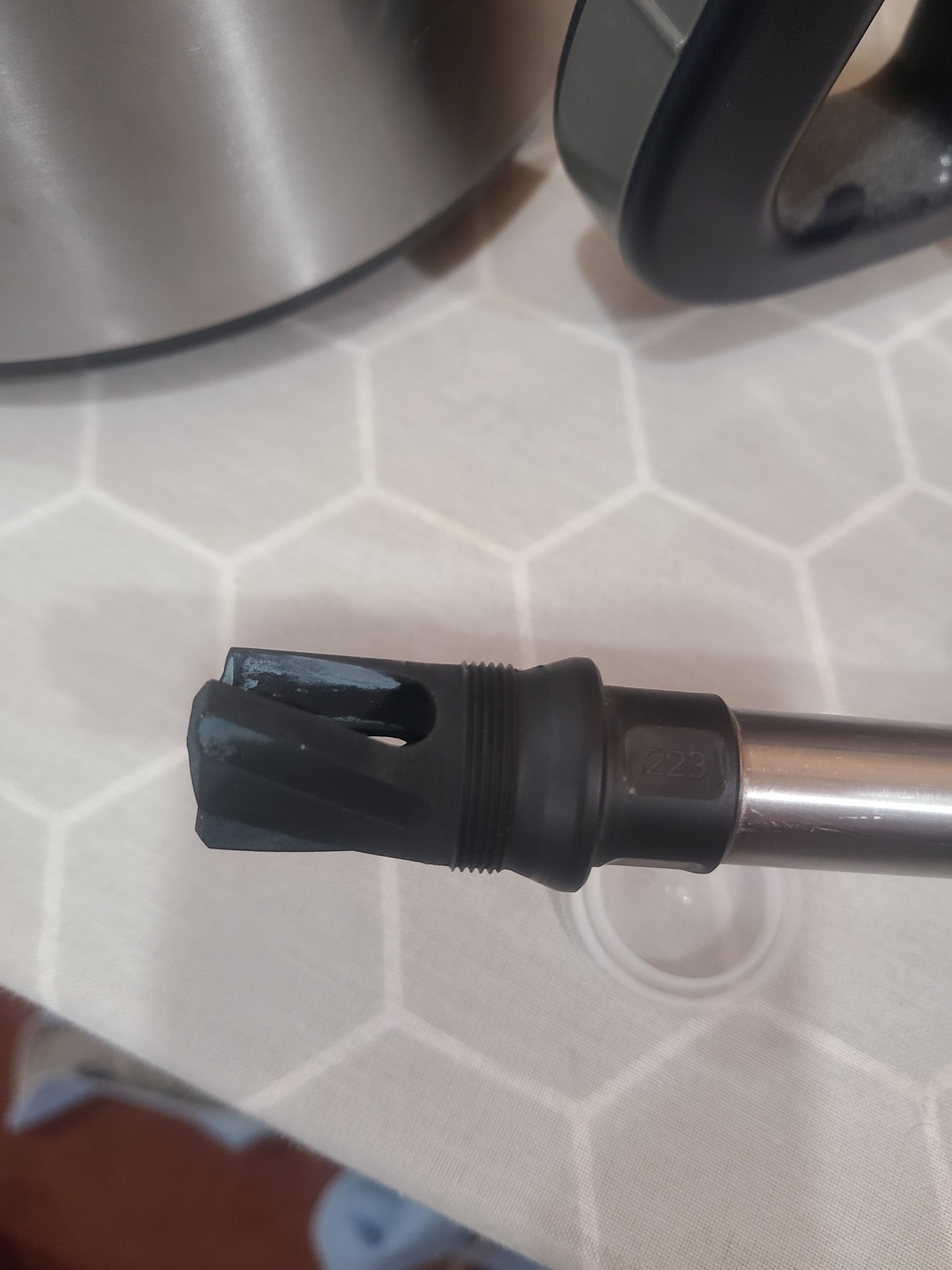

My Tikka with its Thunder Beast cb brake.

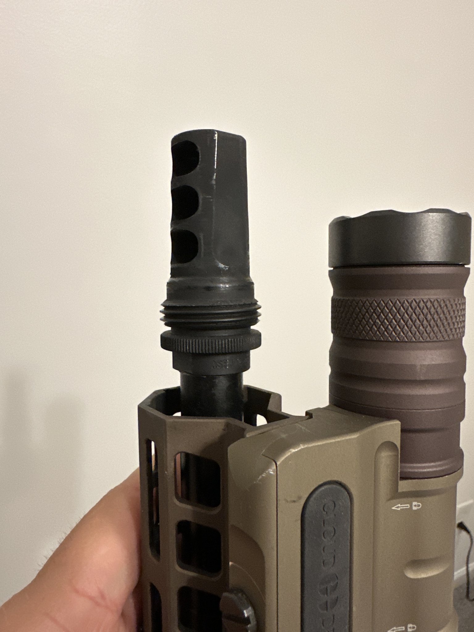

My ar's cb flash hider.
Not all brakes or flash hiders are suppressor hostable. All (as far as I know) suppressor hostable devices are flash hiders or brakes.
You have to match the device and the can. You put a device on that matches the ecosystem of the can. For mine I chose Thunderbeasts CB system. Others choose HUB, others choose other systems. Can't really interchange between systems with very few exceptions.

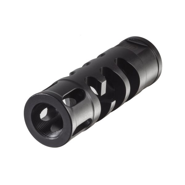

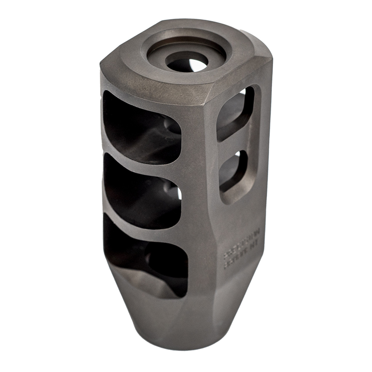

Yet not all Brakes are threaded aside from the barrel thread ,so obviously muzzle brake or flash suppressor would need Dbl thread correct ?
Yes, the muzzle device is threaded to attach to the barrel, and threaded to attach to the suppressor. You buy the muzzle device that interfaces with your suppressor mount. The muzzle brakes that you posted are not designed to work with a suppressor.
Reactions: Ex E6
Thank You ,as I was wondering how in the hell I would attach one with my current brake on the .338LM simple answer ,NOT gonna happen .
