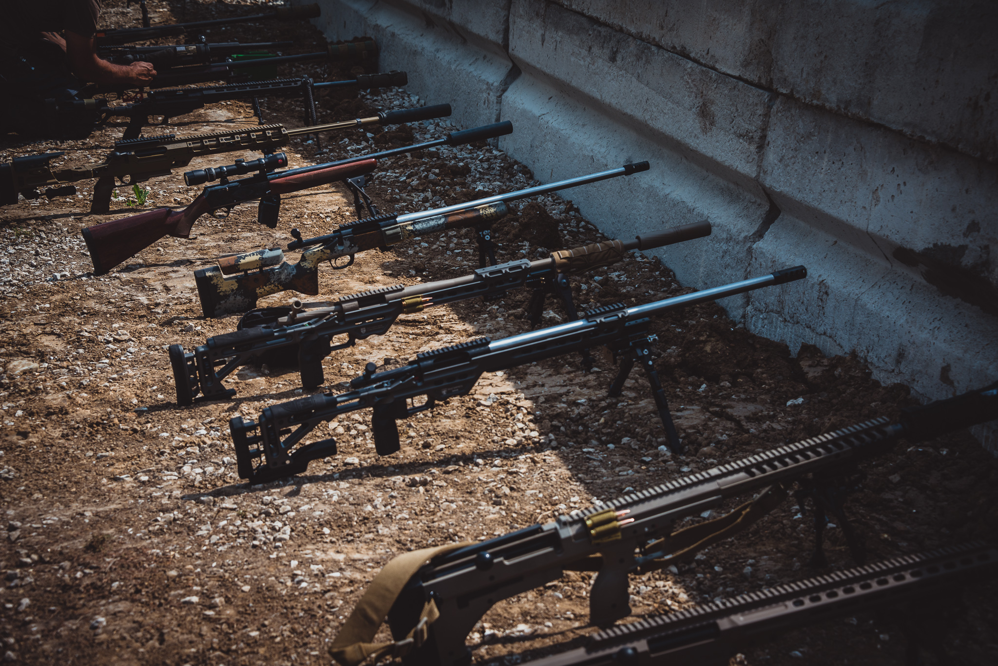

It's an interesting dynamic,
Because we remove every scope, we see a wide variety of results:
We do test each one, within reason, and honestly the results don't always match reality, which is part of the problem.
Some set ups go right back to zero, hitting almost exactly where we left them prior to removing the optic. Others are wildly off the mark, better than 3 inches off, which I consider a lot.
Can you look at something, tall target test it and make a ruling, maybe if you hit the point of noticeable extremes, but 90% of the time you can't. Using the optic is the only real test I have found. That means dialing elevation, and shooting, then coming back to confirm. Working out the turrets tells the tale better than anything so far.
As I noted, torque values are not the entire picture here. 15-18Inch LBS is definitely the safe zone. But since we can't see inside the tubes, how do we know the Tube is in spec? We have seen some tubes vary vs others. So the possibility of binding the mechanism is very possible.
Most of these are mass produced and only batch tested. They get a load in, maybe 1000 of them, and pull 5 out, give them a look on the collimator and call the ship good. It's easy to overlook things.
Next to the bullets we shoot, which are mass produced by the millions, the Optic is the weakest link in the system next to the shooter. We try to minimize the potential for error by picking brands with a solid reputation. Which again, a contradiction of terms, the Popular Scopes are the most common, so of course we'll see more problems with them. It's a weird numbers game we play and it's not very good game to begin with.
The pairing of scopes and rings is becoming something I look at more and more. That is coming from someone who figures, I bought a decent set of rings, it'll be fine. Well that is not always the case...
Lastly the issue of torque is becoming a problem. The ever present, quick and dirty torque drivers we are using are not scientific tools people think. We are cracking aluminum with them, because they can and stack values. The practice of constantly checking torque every time you pull the rifle out is an issue. A bigger one that we realize. In fact I filmed the recent Spuhr mount video and saw a screw slip on camera. If you are checking torque, you need to unscrew the bolt first then retighten from loose, not hit it heavy every time.
If you are pulling out the rifle, checking torque, just in case, you are probably creating an issue. stop doing it.
