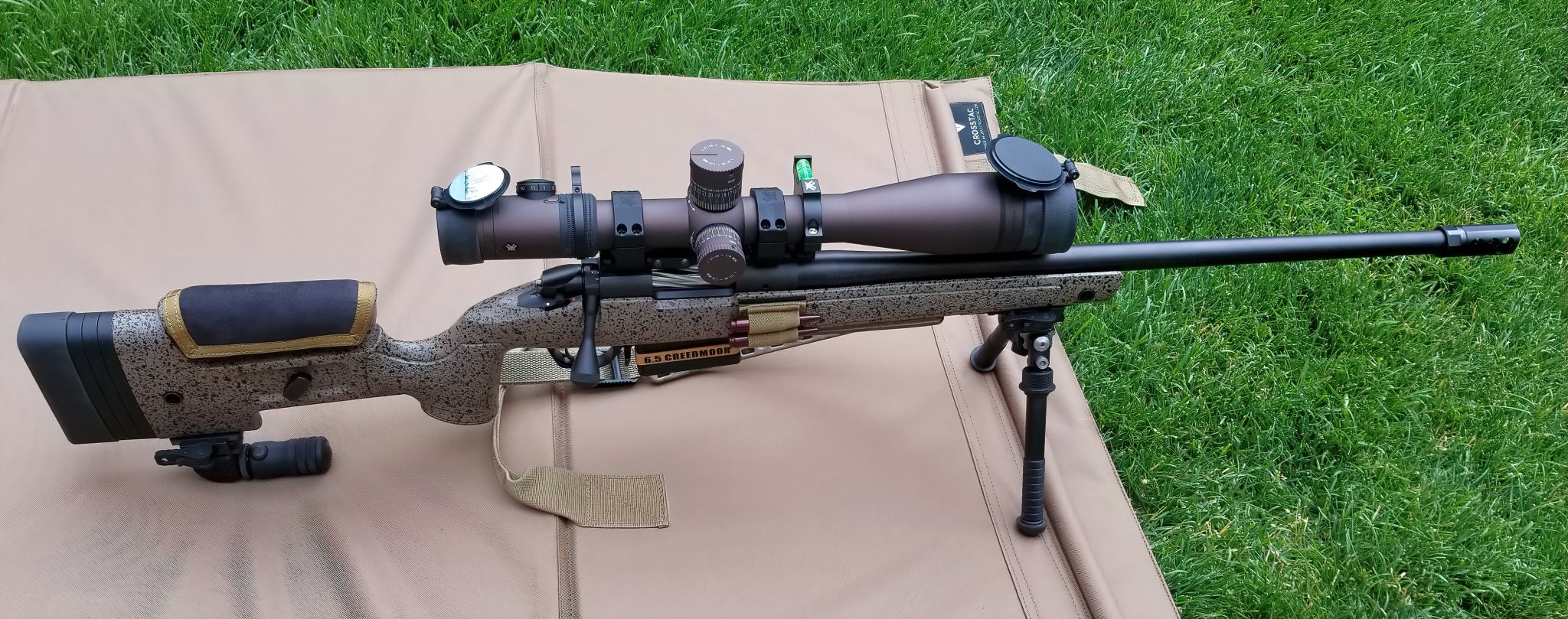

This is what I did with my 6.5 Creedmoor B14 HMR, shot great out of the box, trigger was also good to go but I like to improve my guns so I replaced the bolt with the Premier SA fluted bolt, and added a TriggerTech Special. It's a keeper! Other guns might get sold, some definitely will, but this is one that will stay and get re-barreled only with a premium select when the time comes.

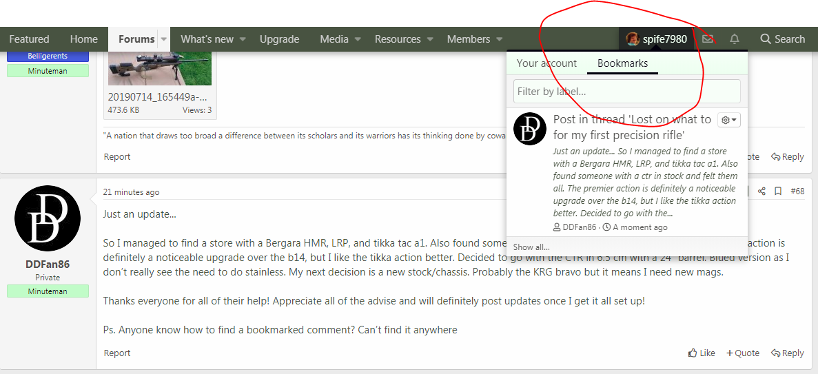

Ps. Anyone know how to find a bookmarked comment? Can’t find it anywhere
