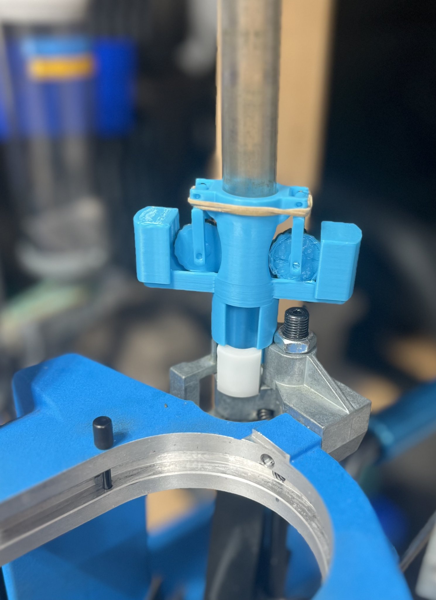

and there is one more way - that i made. works very well.
