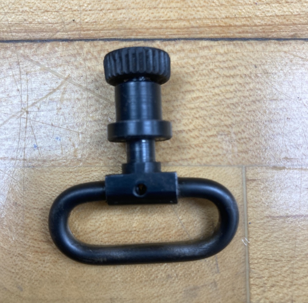

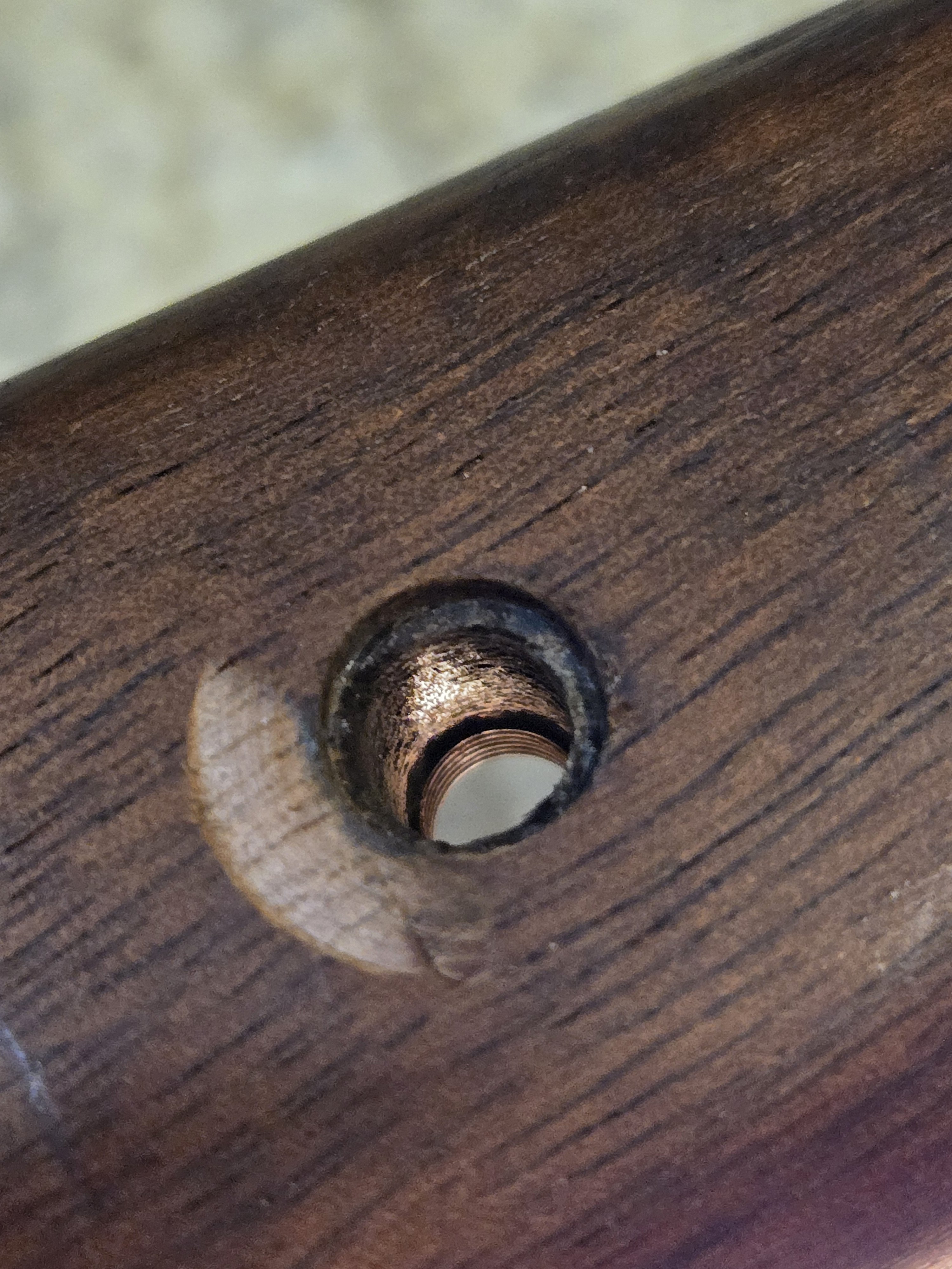

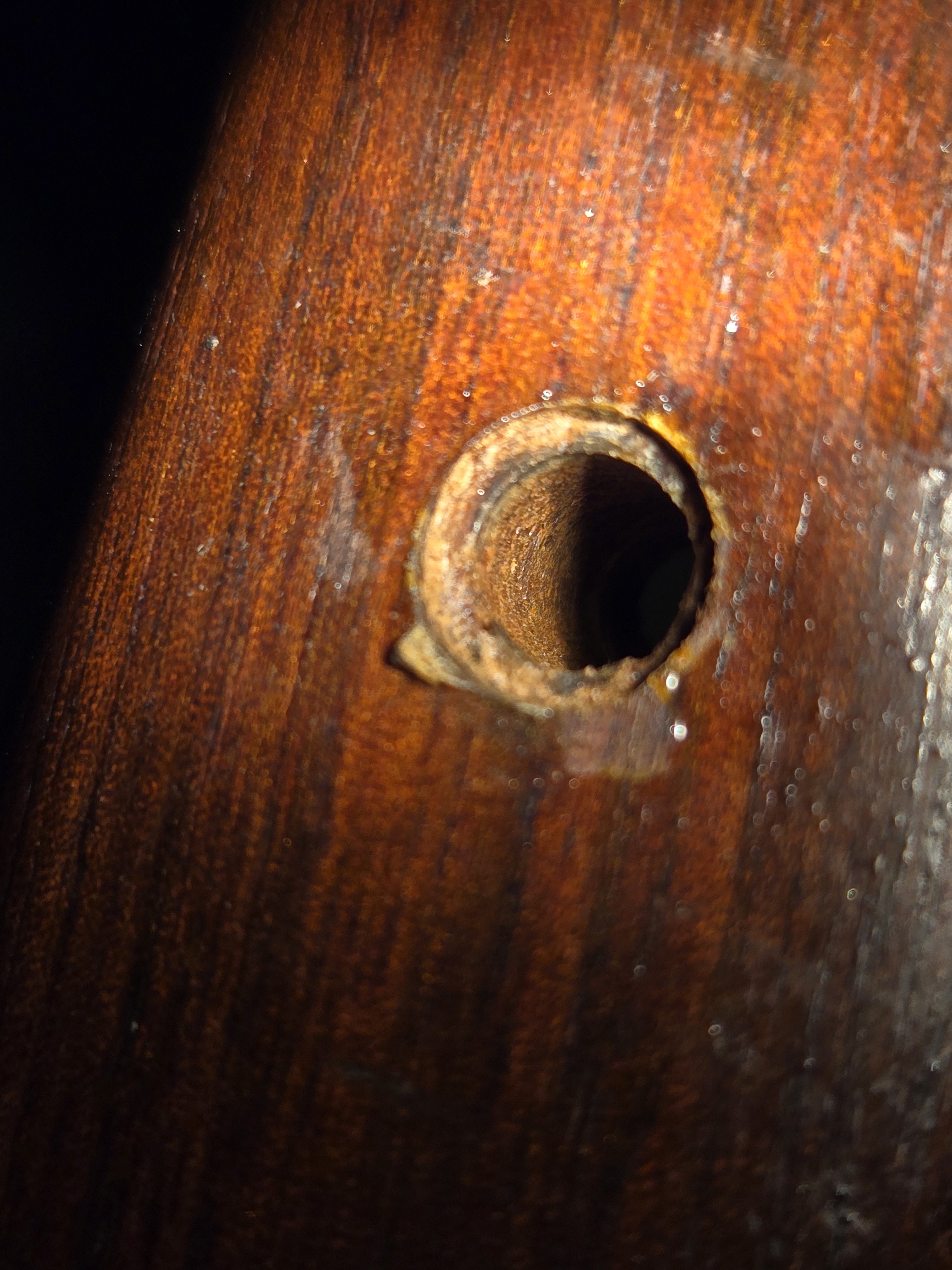

I wonder if someone may have a picture of the escutcheon that the front sling swivel on a M40 screws into? Preferably separated from the stock, I know I'm asking for unobtainium but it's worth a shot. I might know what Remington used but need to see a real one from an M40 to confirm or disprove my idea.
Is this a the correct front sling swivel used on the M40? I know the loop is not the correct size, but the rest seems to check out. 7/32x40 thread, and the escutcheon looks right.

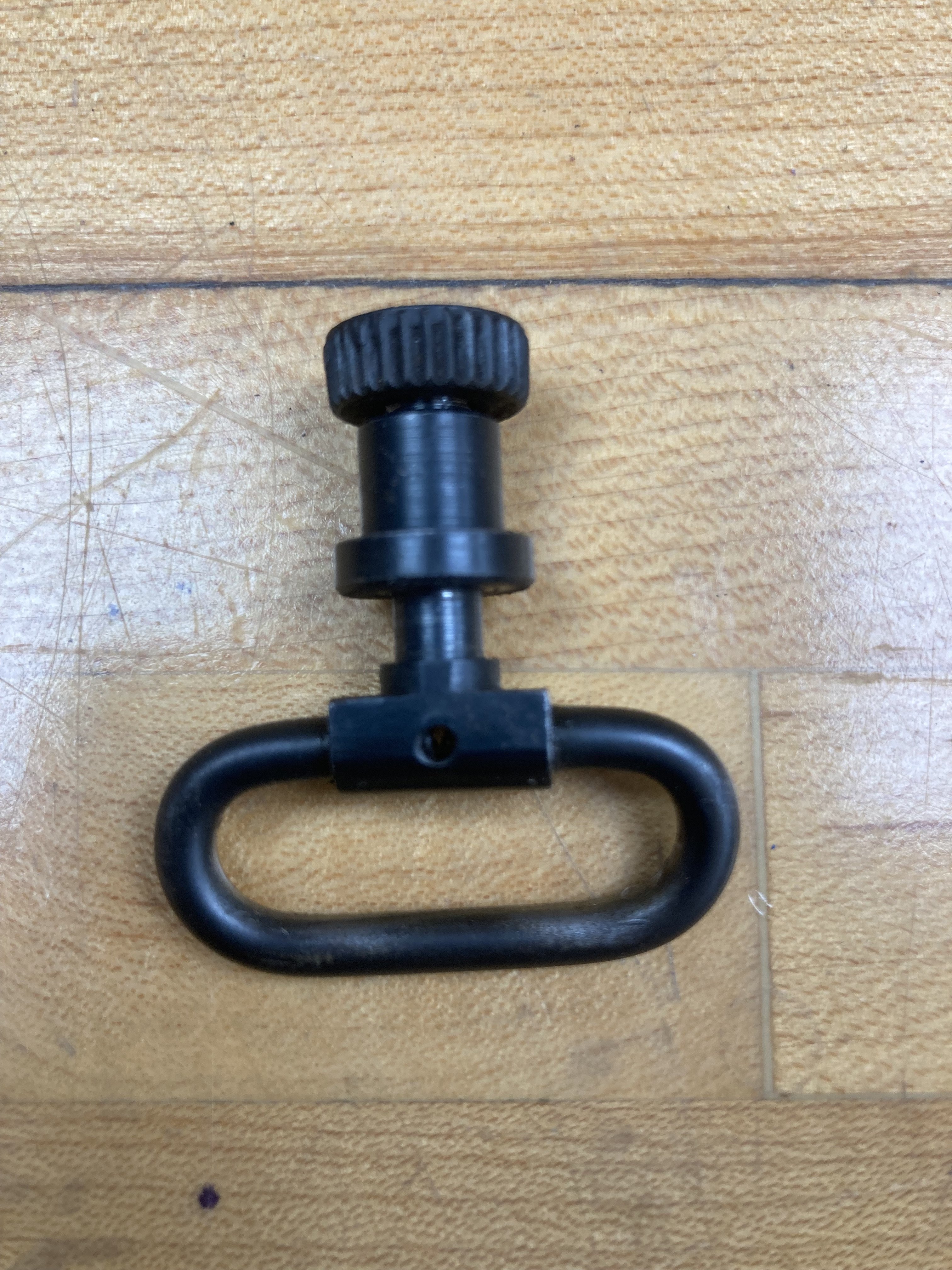

Is this what you're looking for? I purchased these about 10 yrs ago. View attachment 8741234View attachment 8741235
Andy,

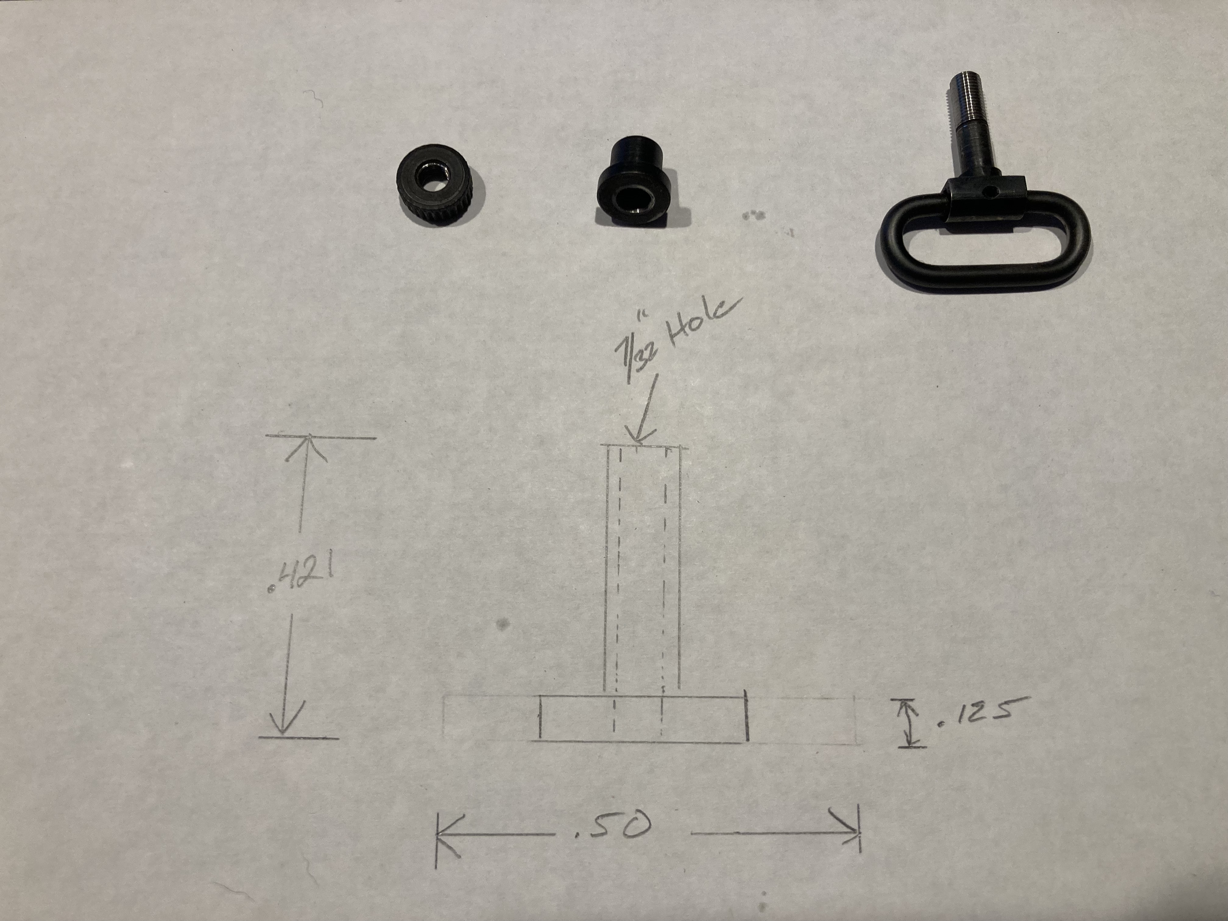

Those are for the M40A1, I have been trying to find a picture of the front swivel for the M40 and so far have been unsuccessful. The swivel in my picture is from a Remington 725 stock, I thought I read somewhere that Remington used "in house" parts and thought it made sense. Just hoping someone could verify if this was in fact the correct swivel arrangement. I'm sure the swivel and euscheon are right, just not sure about the other piece that goes on the shank and keeps the swivel from digging into the stock

Is there actually enough meat in the forend for that escutcheon
Yes. How this set up was done is the knurled portion goes in the barrel channel, then the other "top hat" shaped piece is inlet into the bottom of the fore end. When you install the swivel and tighten everything up it the two parts keep the swivel from digging into the wood.
So am I to understand that the escutcheon is two pieces and the swivel is separate (3 piece assembly)?
Got it. I was under the impression that the shouldered stud was inletted into the stock - hmmmm. Thanks for the clarification. Are there any dimensions on the tophat (bottom)?
Does the shouldered part of the stud sit proud of the stock?
1) Yes 3 pieces
2) A quick drawing, not to scale.
3) No it sits flush (top hat shaped piece) with the bottom of the fore end.
Please keep this in mind, this came out of a stock for a Remington 725 so I cannot verify 100% this is what was used on the M40. Hoping one of the forum experts may chime in with a yes or no. From a few pictures I have seen here, I believe this is what was used.

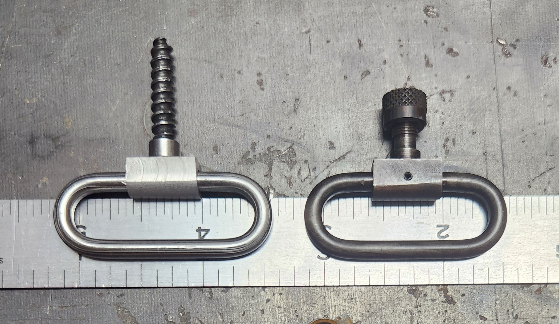

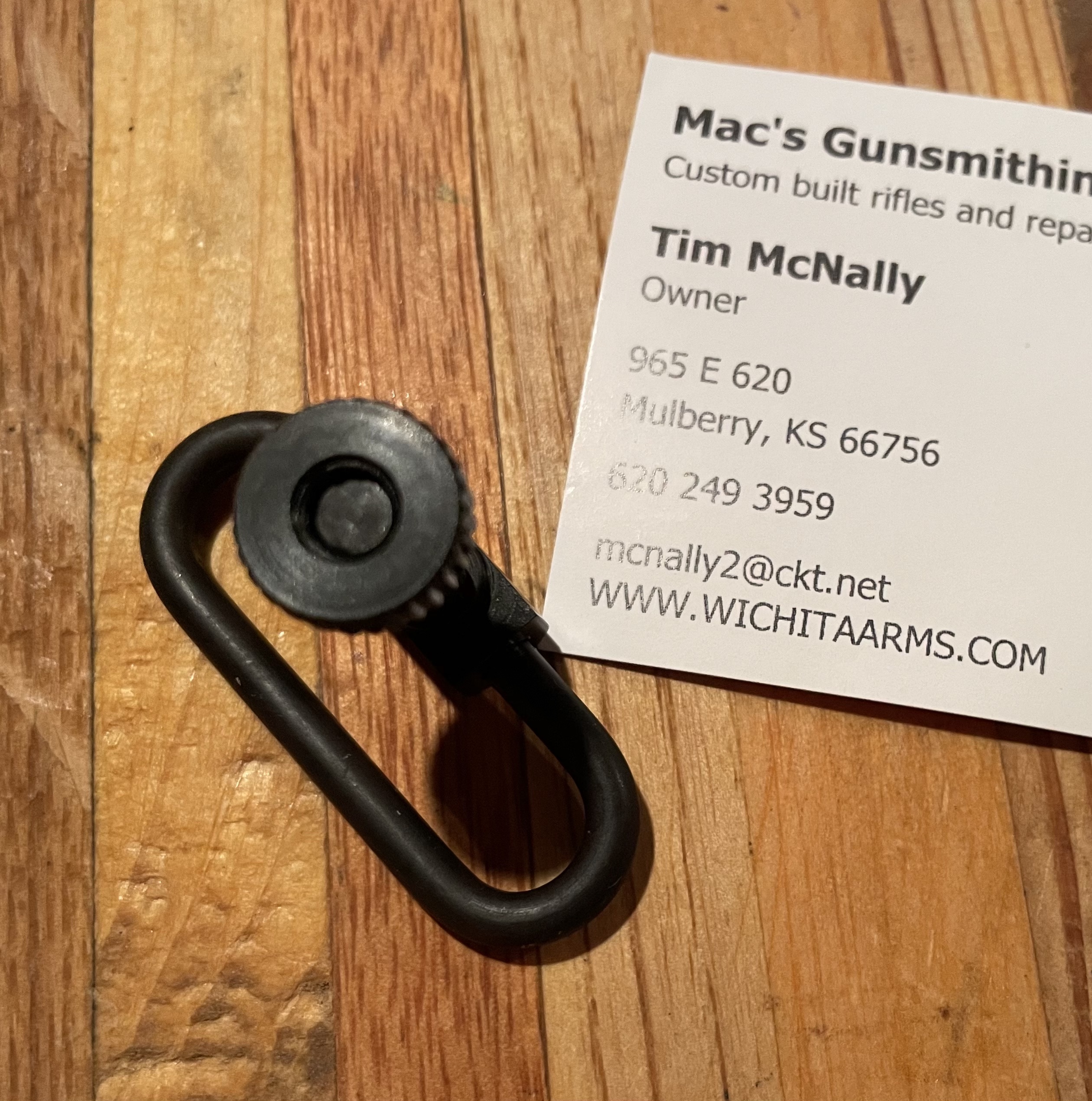

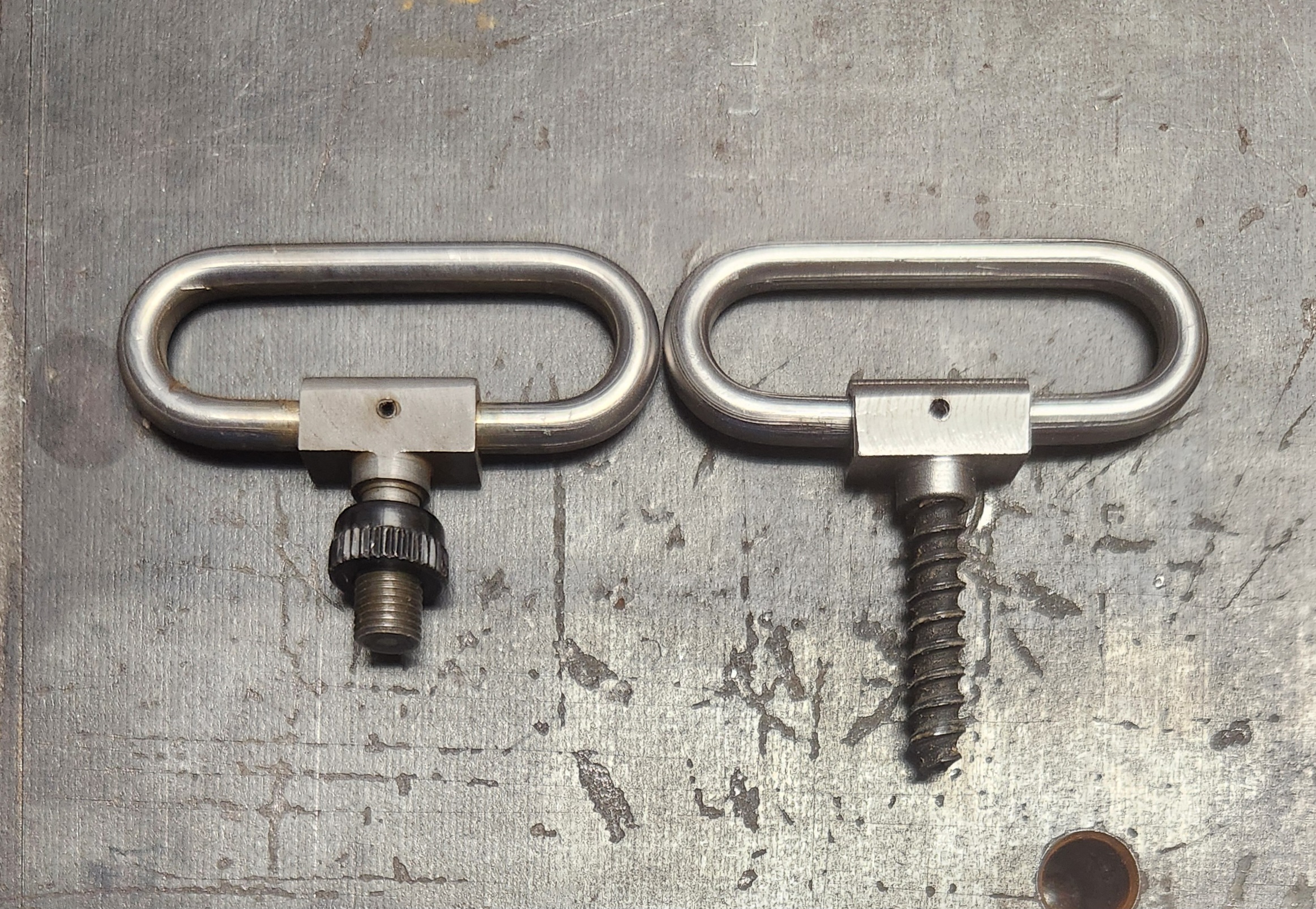

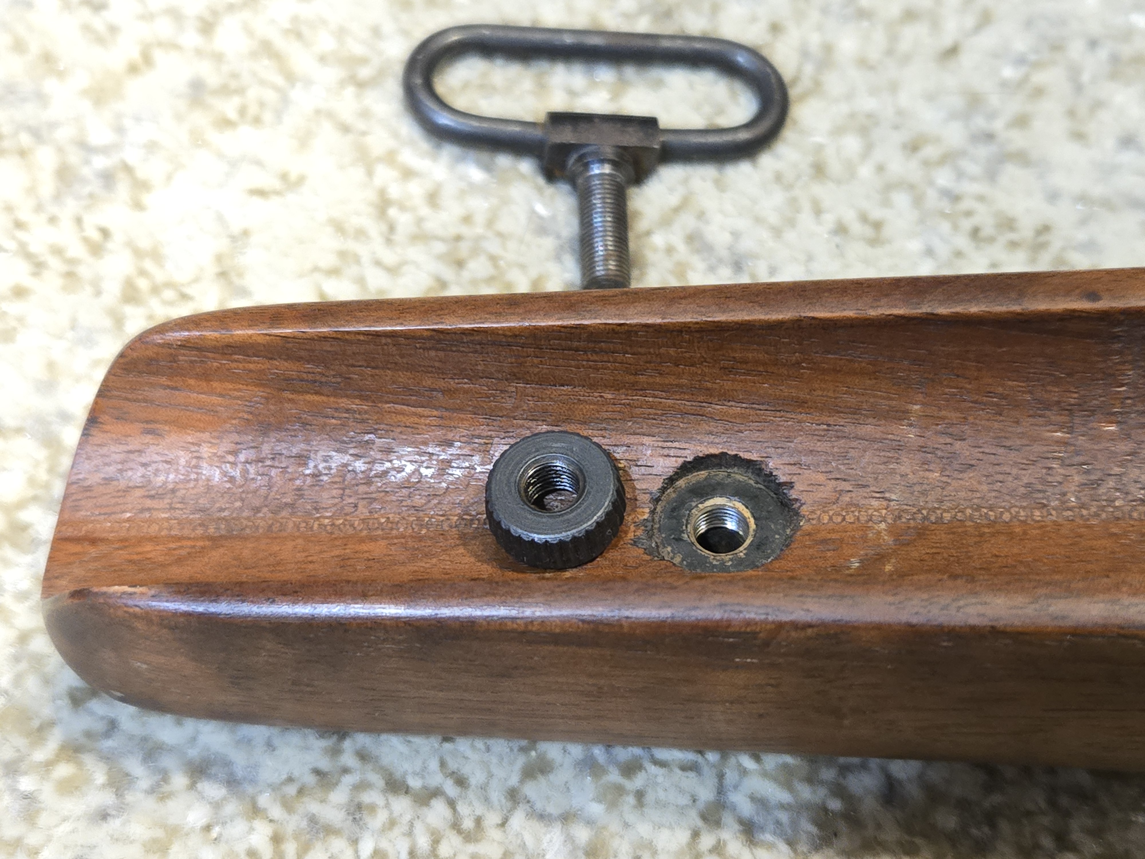

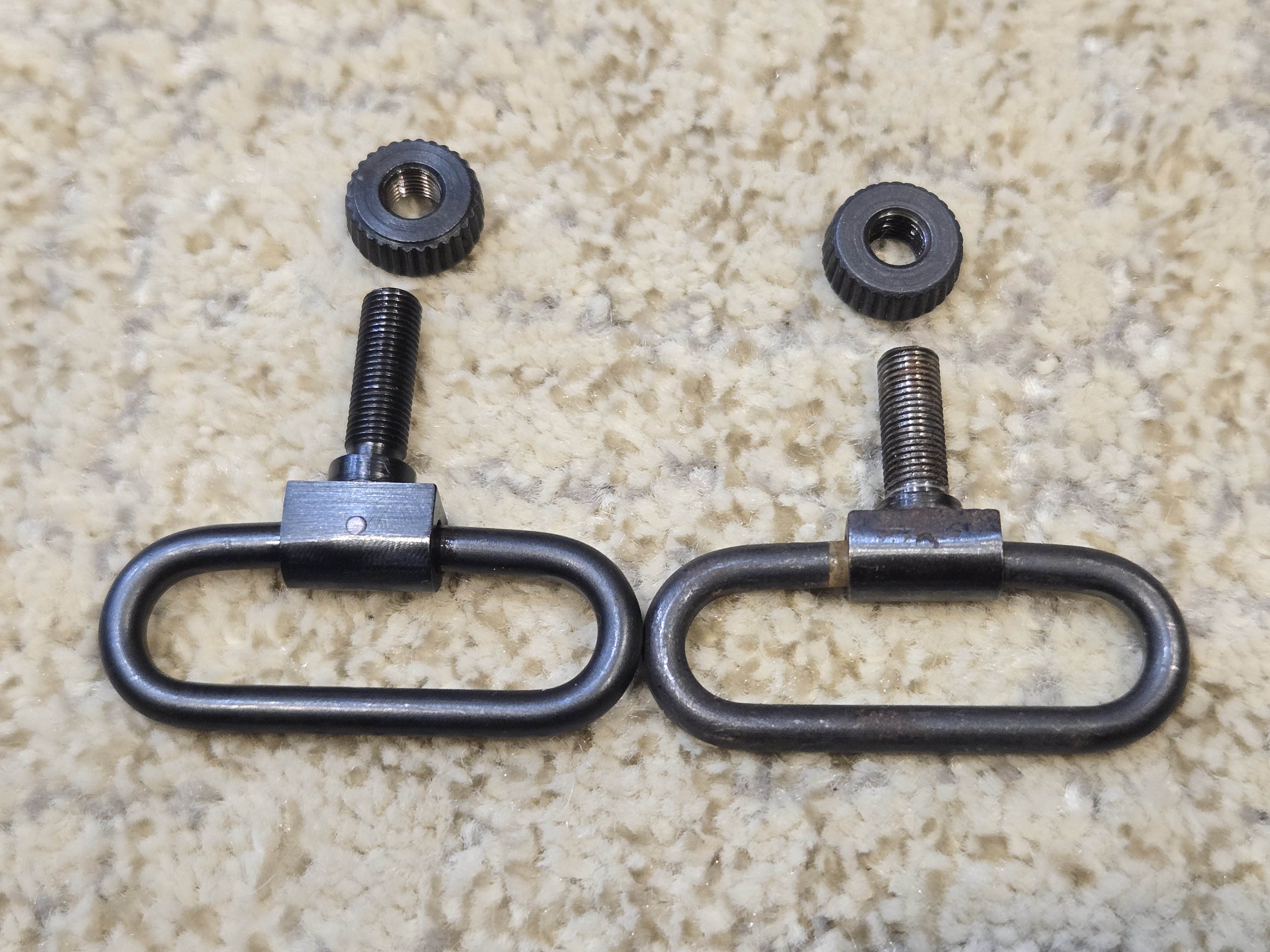

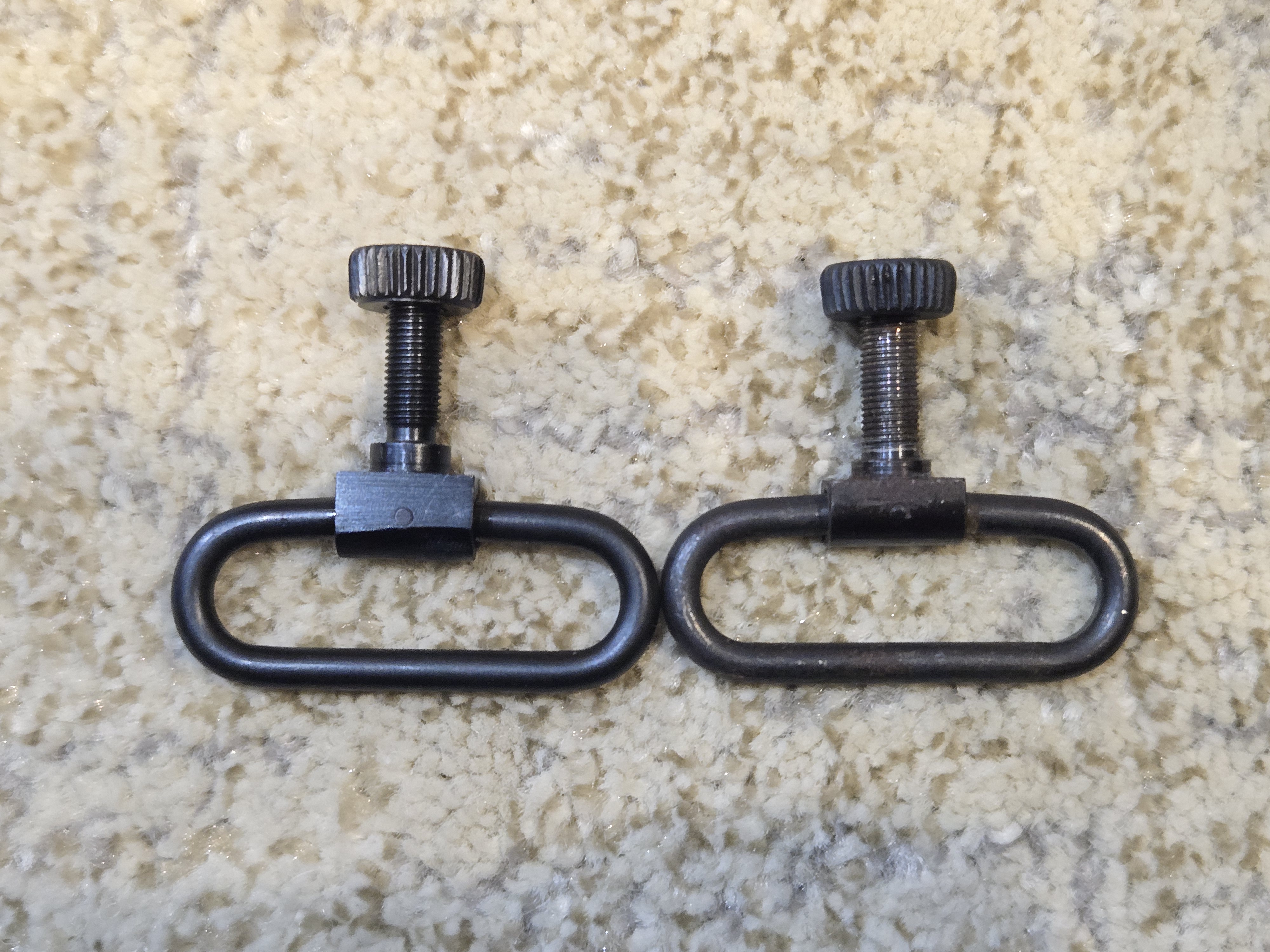

It is not a three piece set up. It's just a tapered nut with a reeded edge. The tapered nut is put into the barrel channel, and the front sling swivel screws into the nut from the underside of the stock.

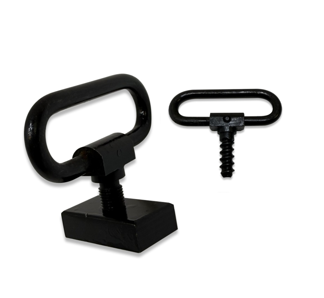

Wichita actually made a run of reproduction M40 front sling swivel nuts to go with their M40A1 front sling swivels (since guys have been incorrectly using these A1 swivels on their M40 builds). The Wichita set is on the left, and the original USMC M40 takeoff set is on the right.
I'm working on restoring a Navy M700/M40 using and original stock and have been fortunate to have Ryan N. pointing me in the right direction. Too bad he stepped away from the forum. He would have dropped a ton of info and pics in here.

0812,
Thanks for the info and pictures. I was hoping someone would jump in here and let me know if I was incorrect in my thoughts. Is the M40 your working on a 6257 Serial number ?

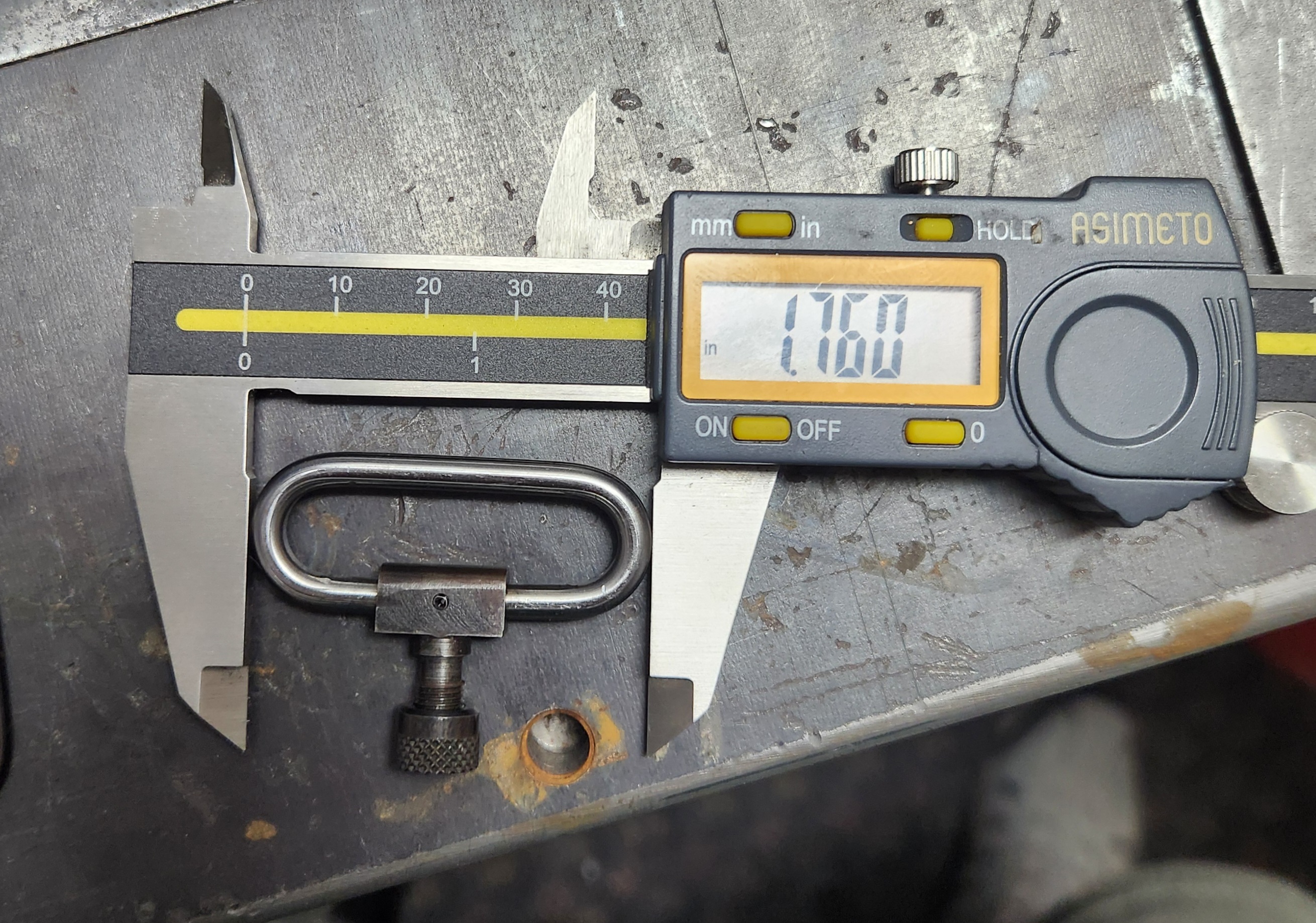

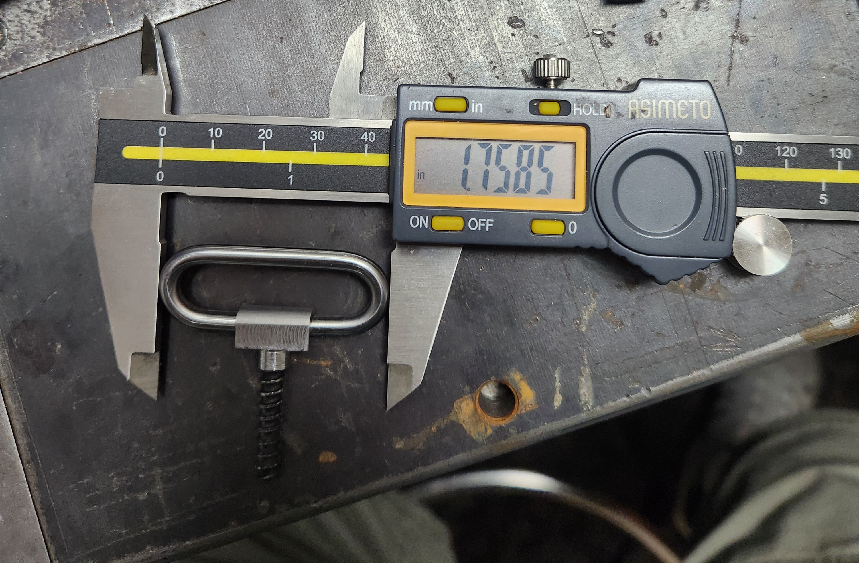

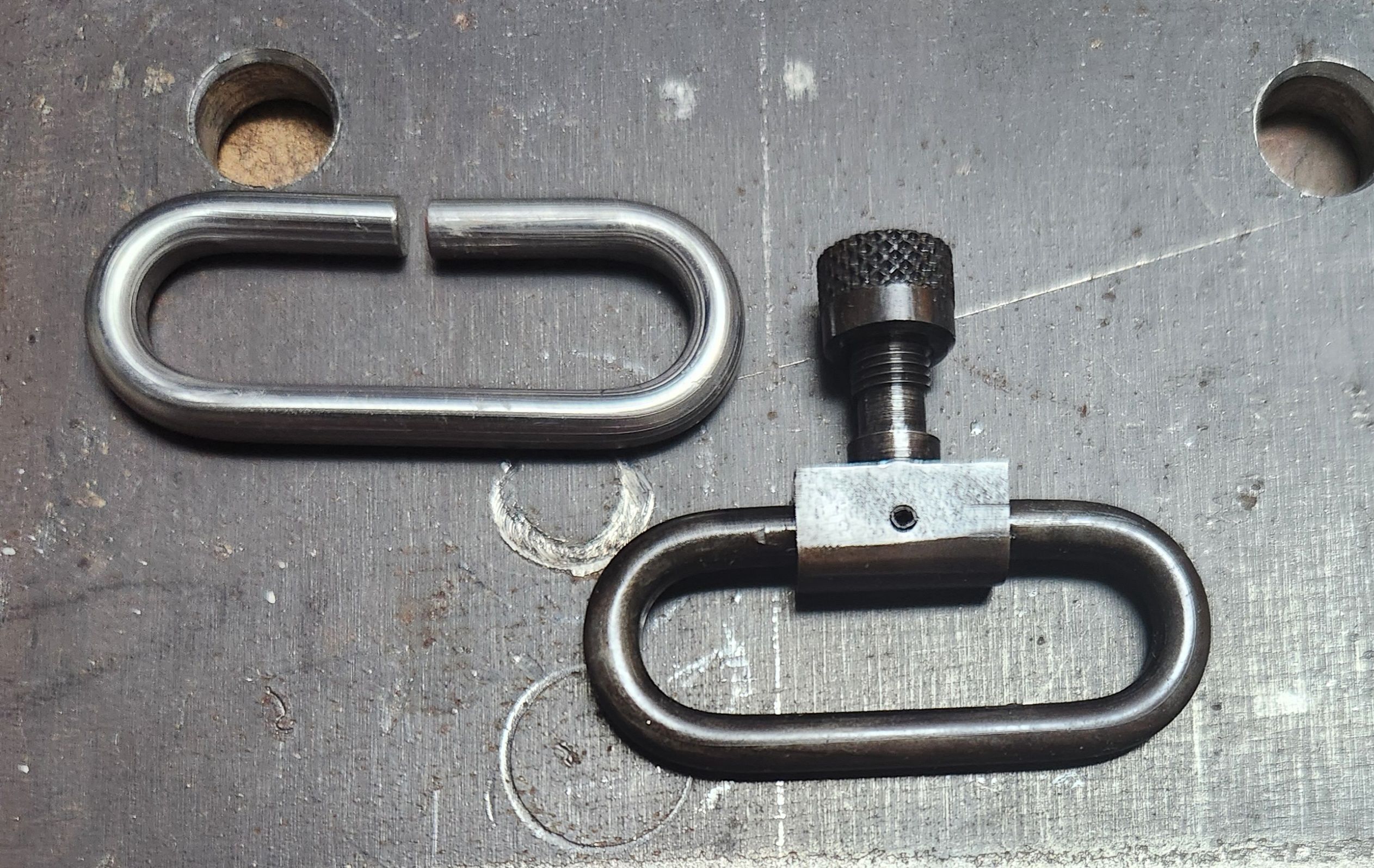

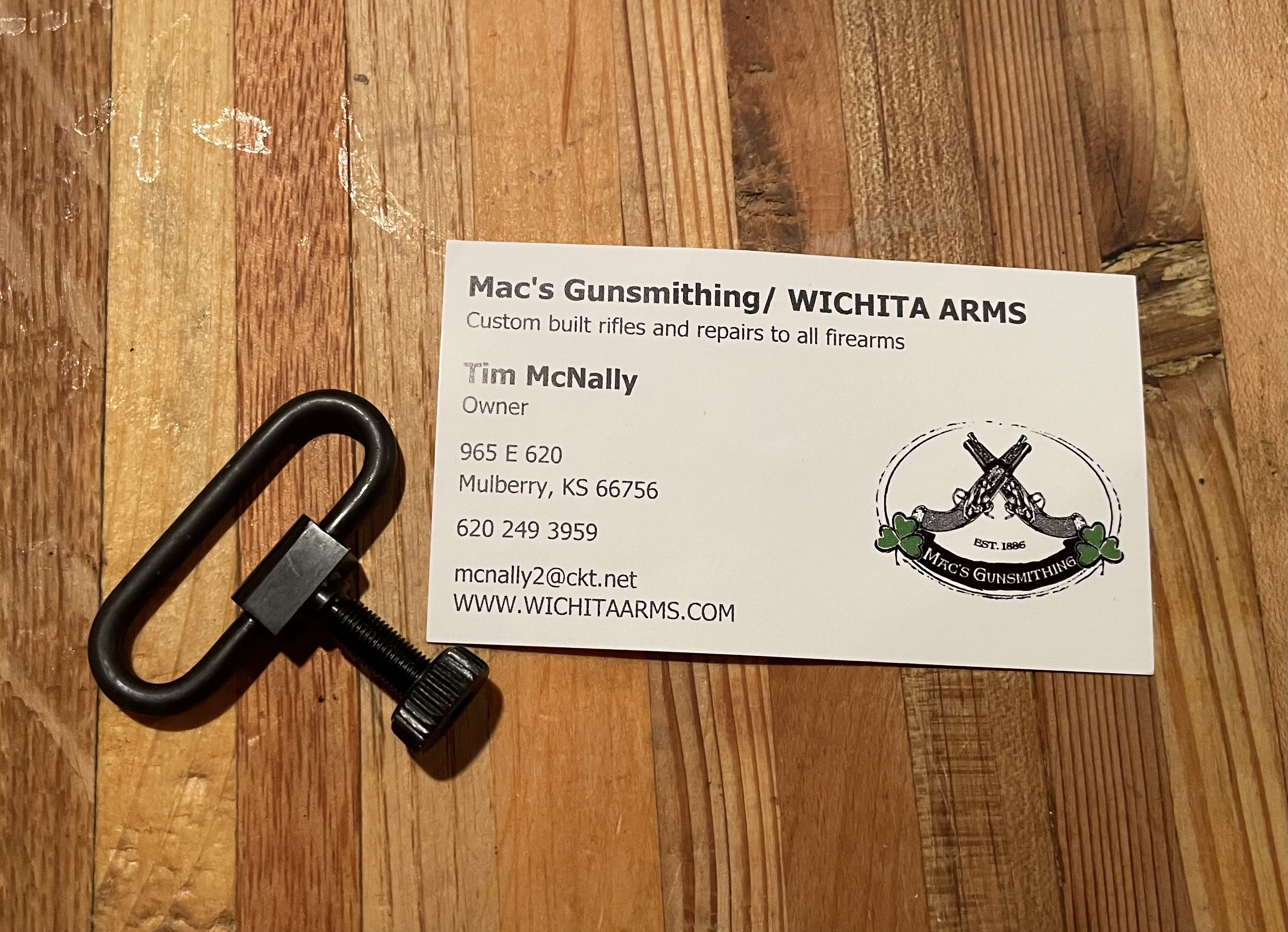

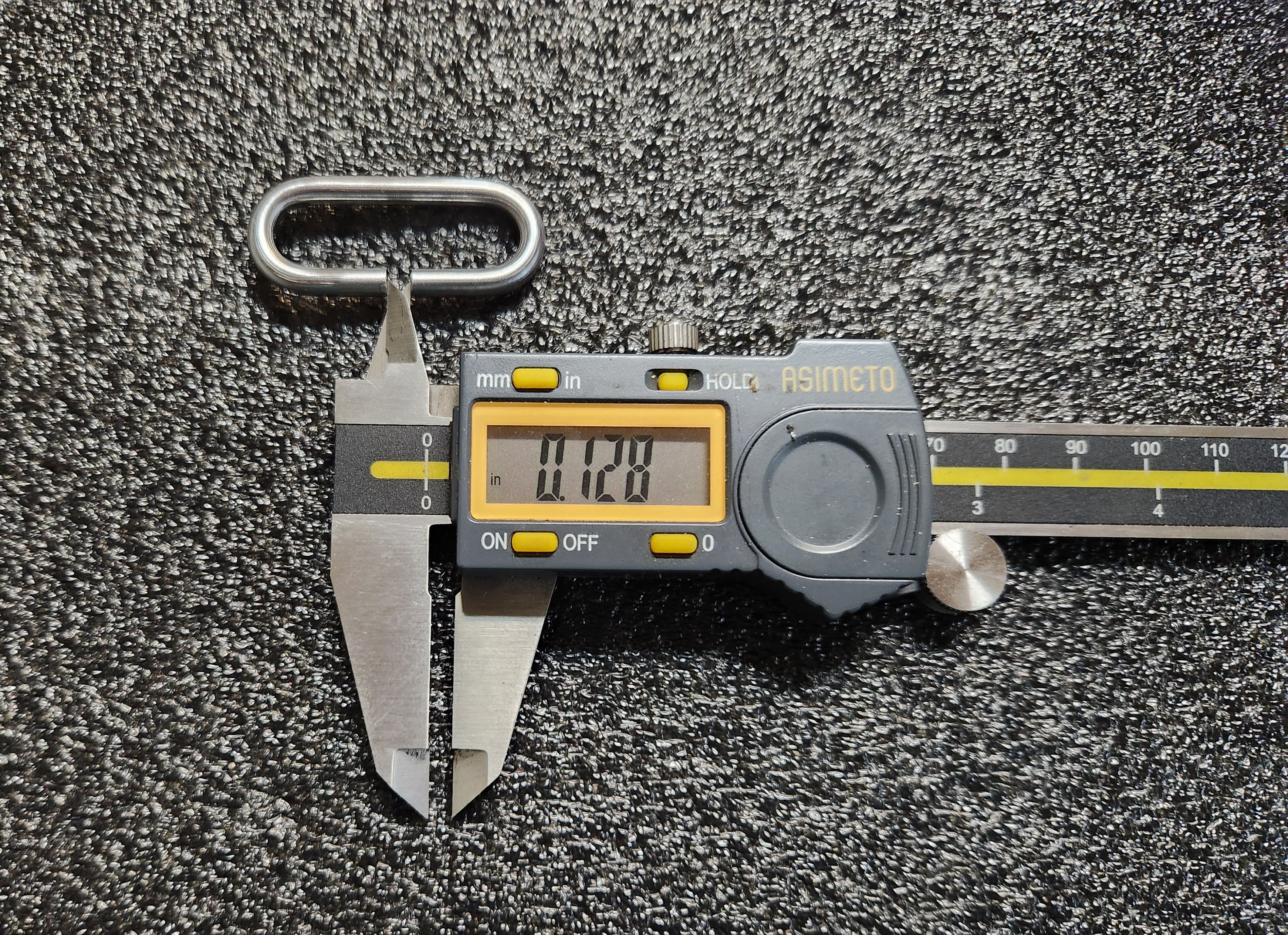

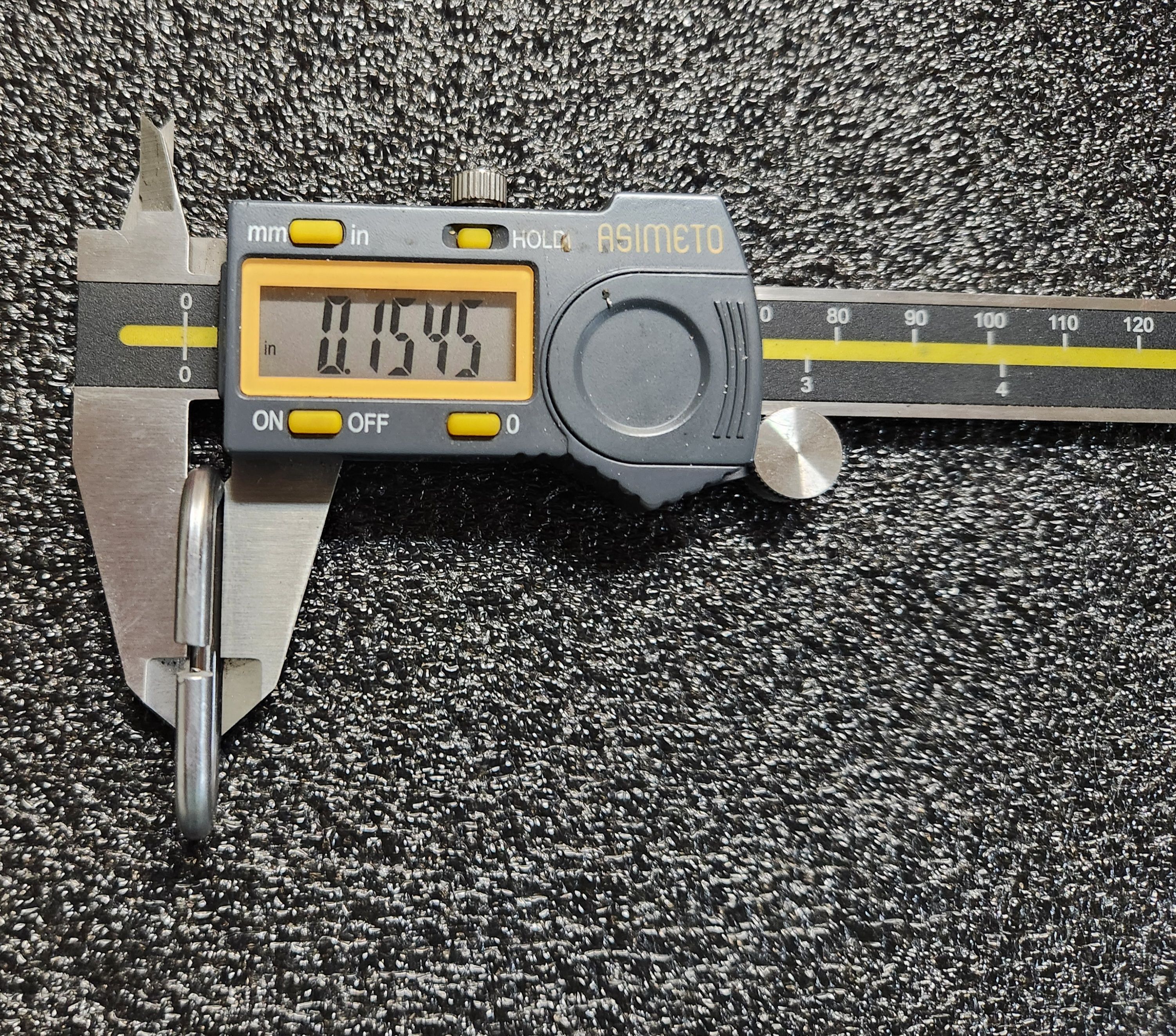

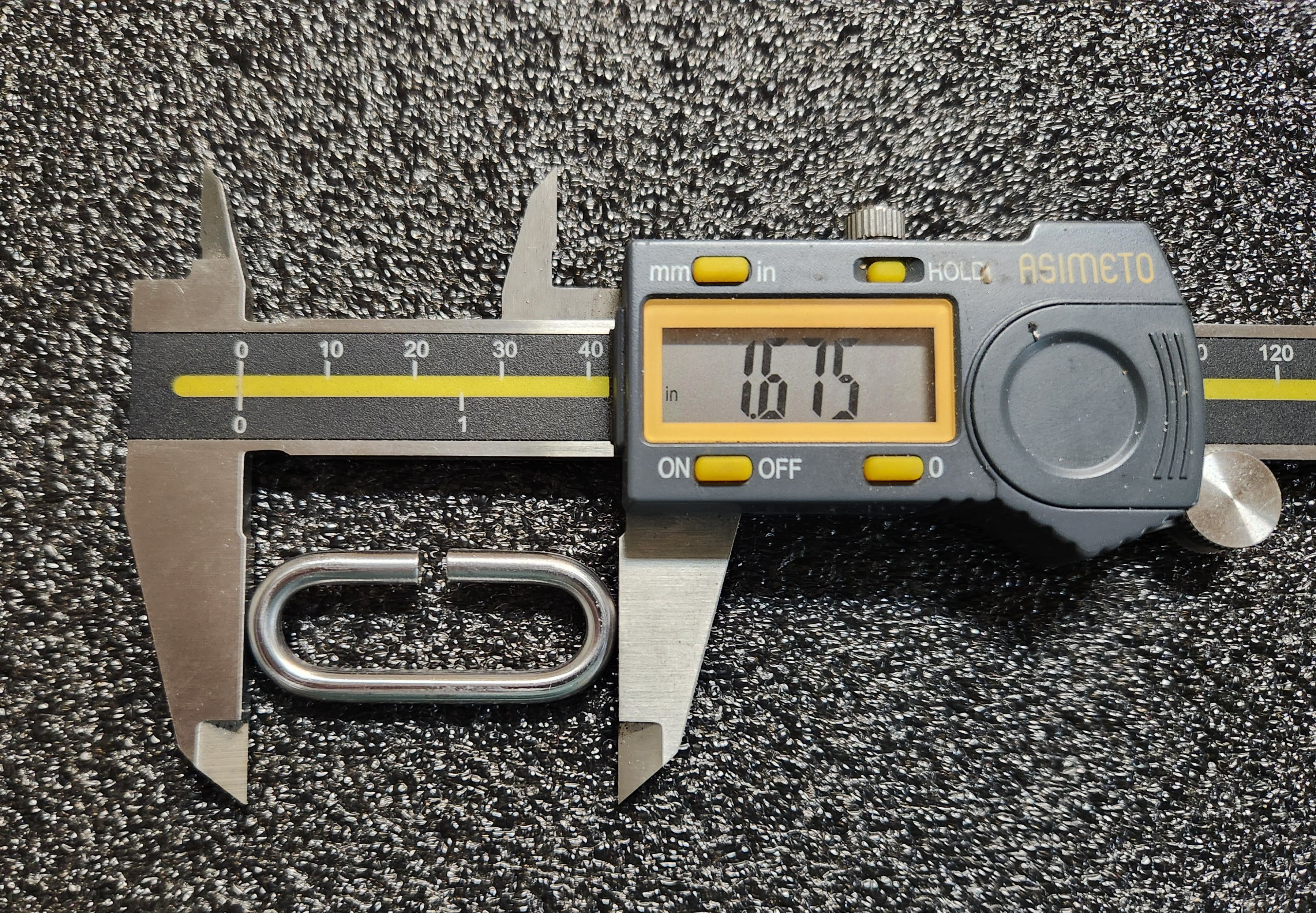

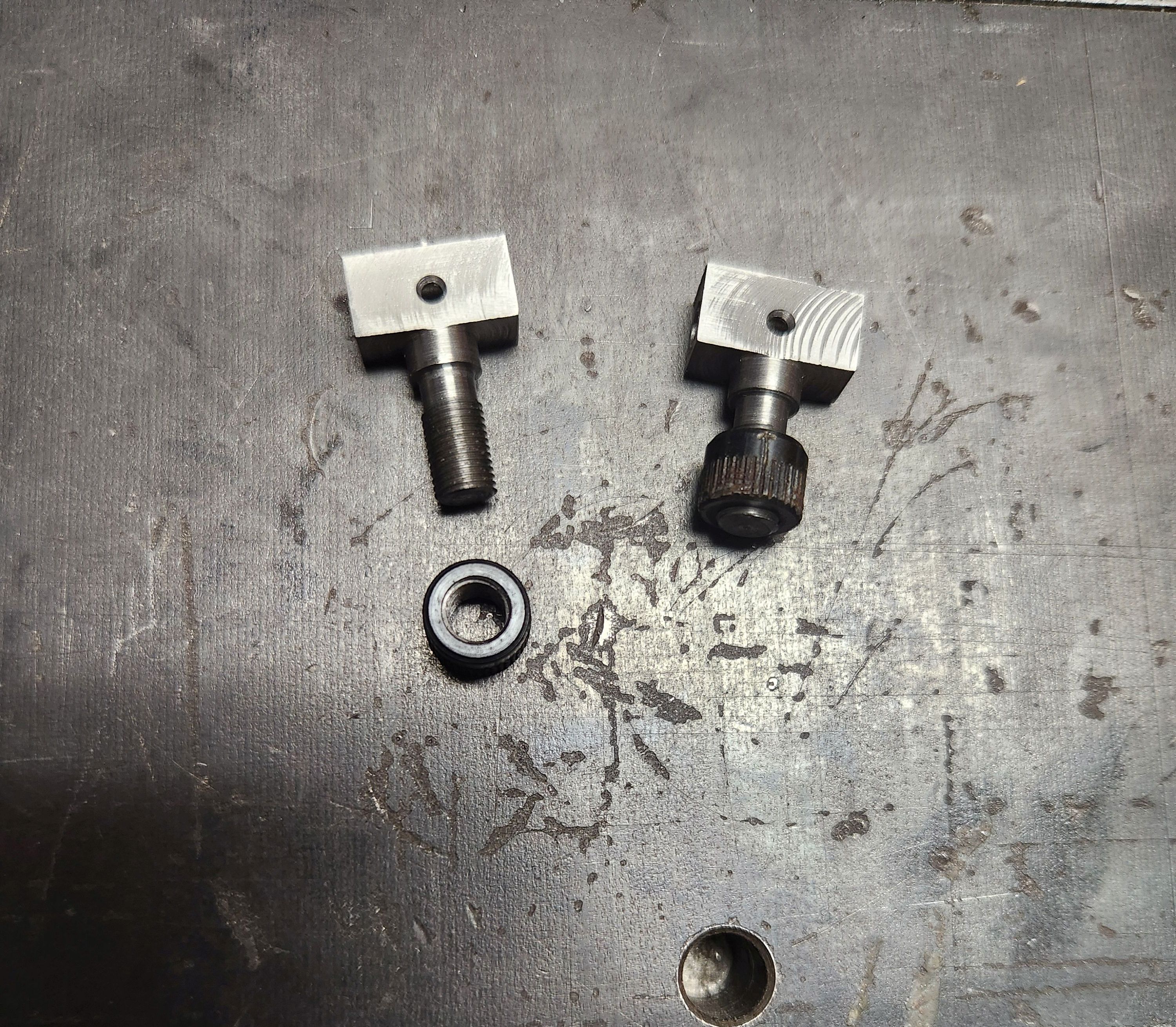

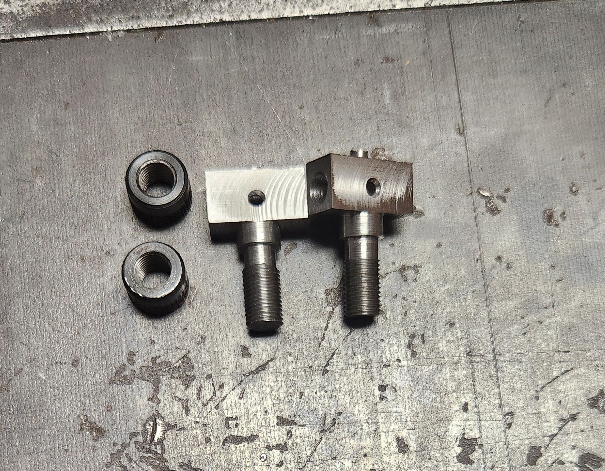

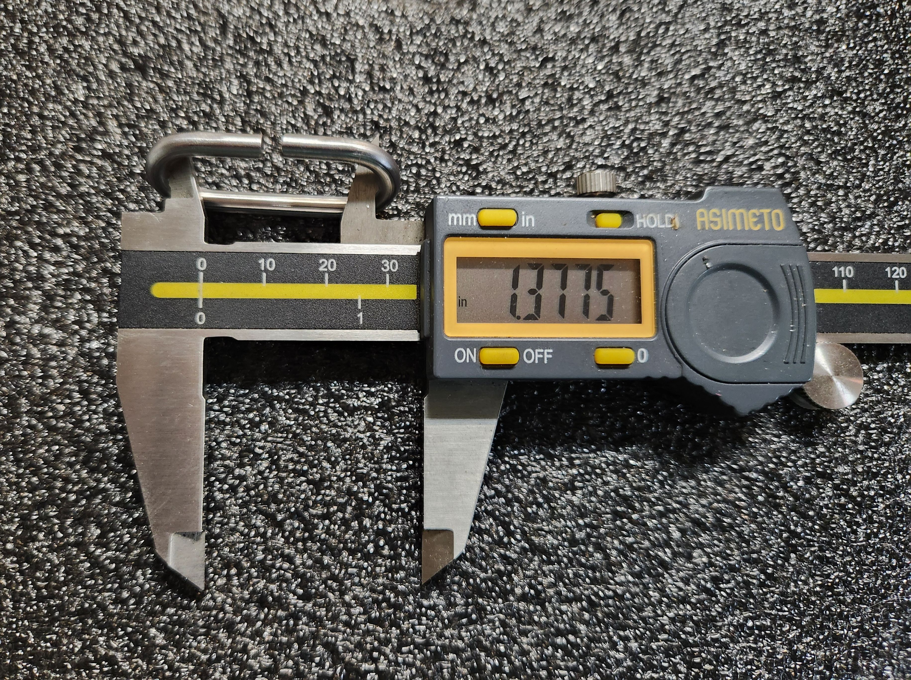

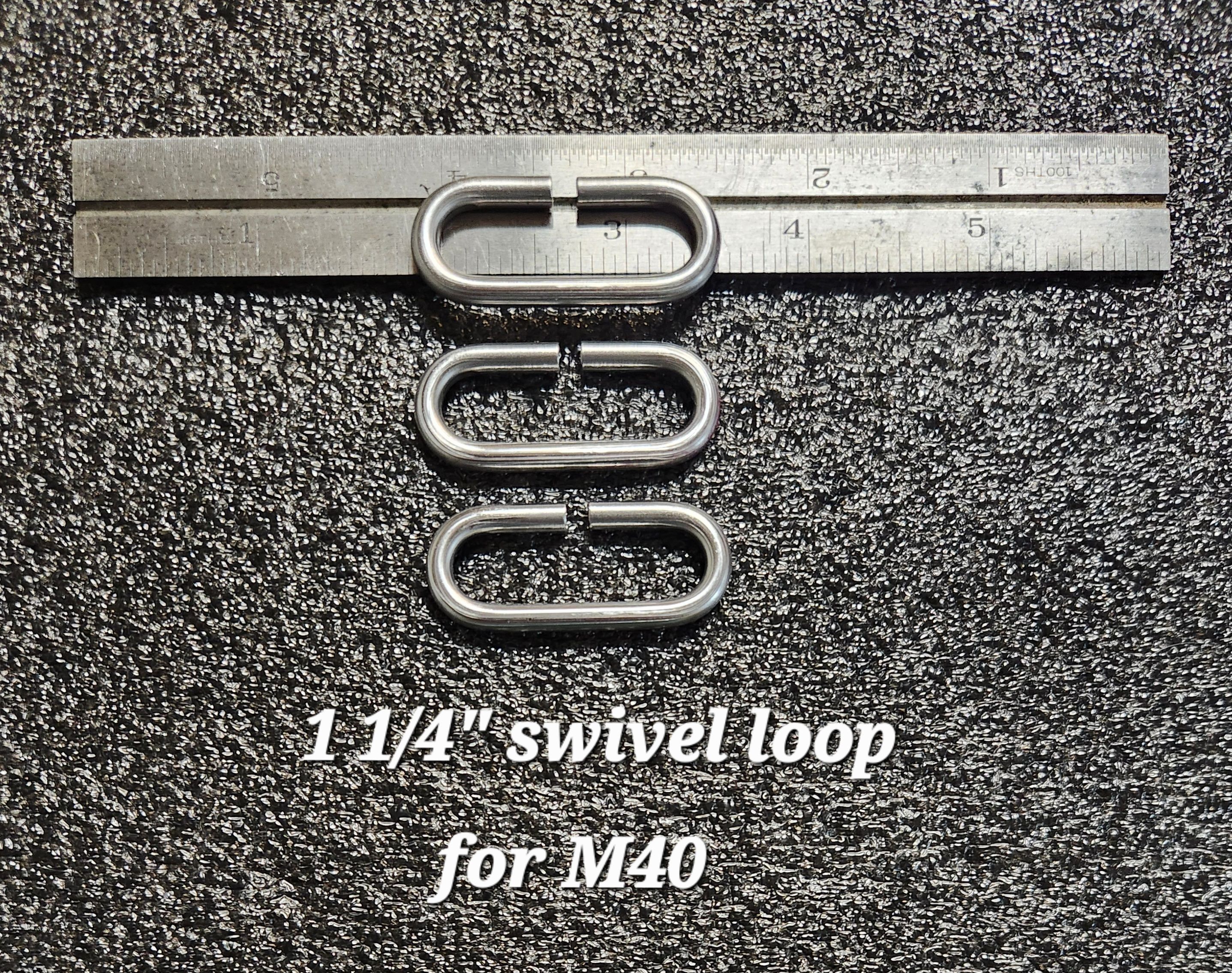

I can’t help but find this whole swivel business a little sketchy—there’s no shortage of self-proclaimed “smiths” churning out clones. After poking around at a few clones made by friends, I figured it was time to stop guessing. I decided to put my machinist skills to use and built a jig to bend the loops precisely to the dimensions I’ve determined.

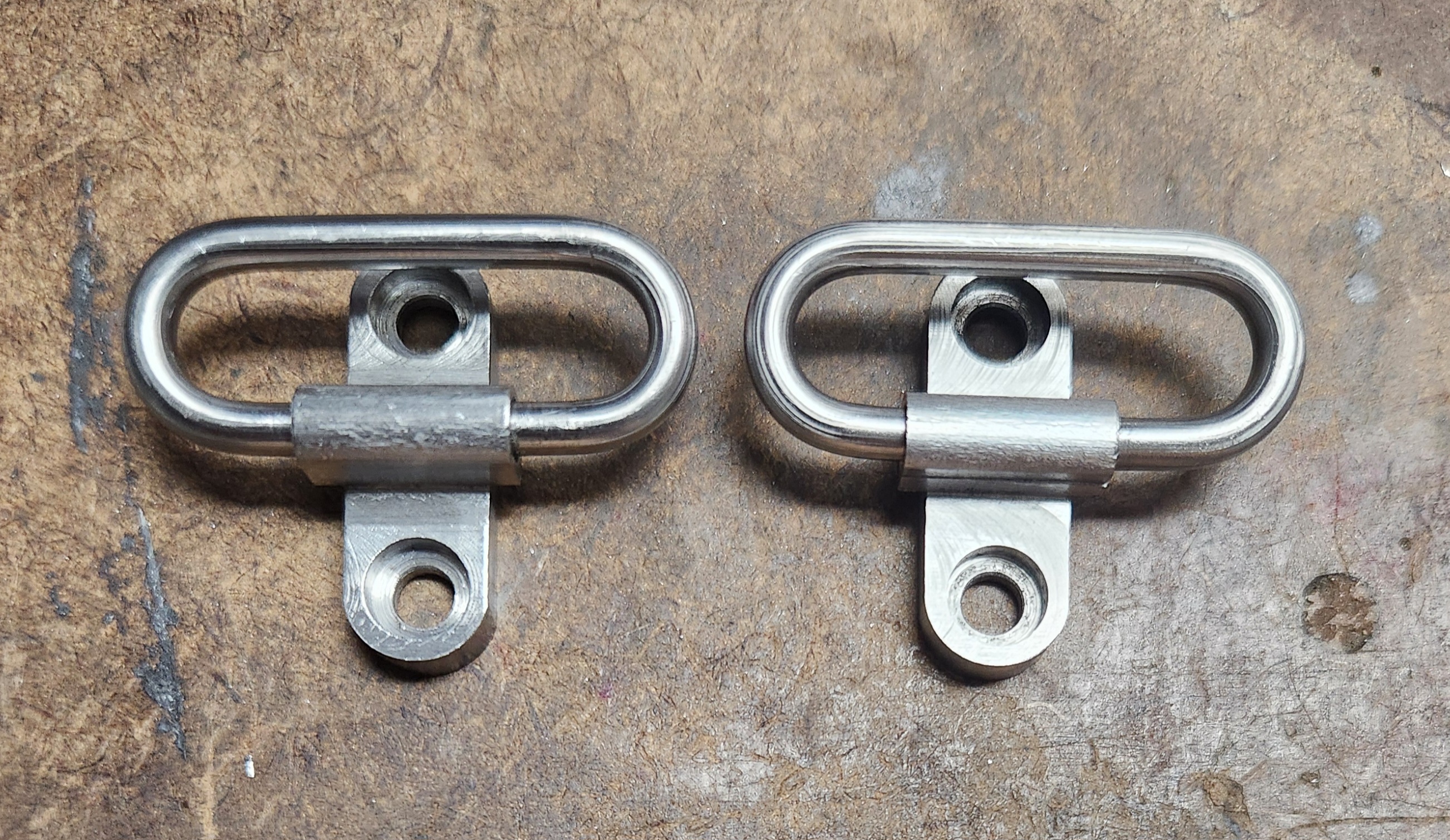

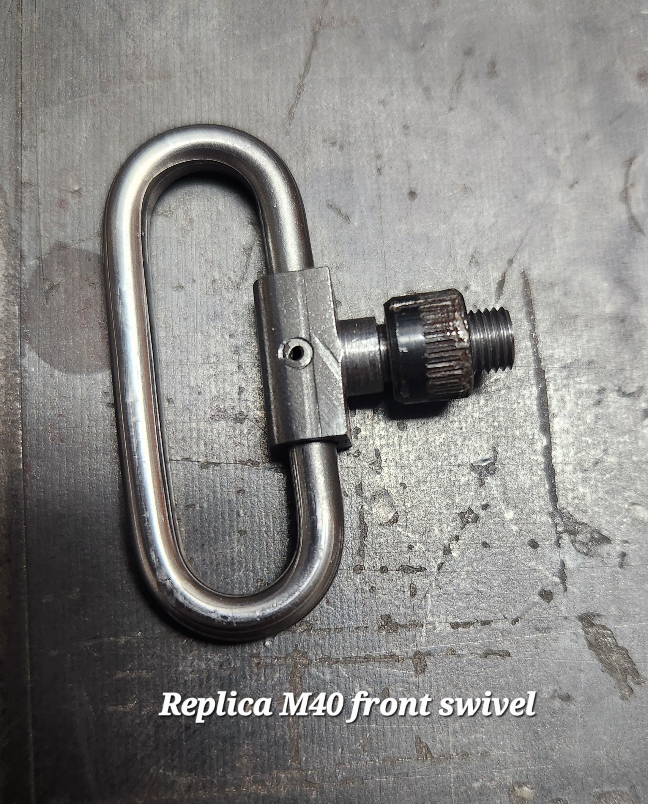

Because my M40 is not a true clone, I elected to incorporate a few modifications of my own design. I was never satisfied with the original swivel arrangement, so I fabricated swivels patterned after those found on the Winchester Model 70 Super Grade, utilizing two points of attachment. These swivels are inletted into the stock, preventing any possibility of twisting, and are dimensioned to accept 1¼" slings. If this project had been intended as a fully authentic clone, my approach may have been different; however, given its nature, I chose to proceed in a manner that suited my preferences.

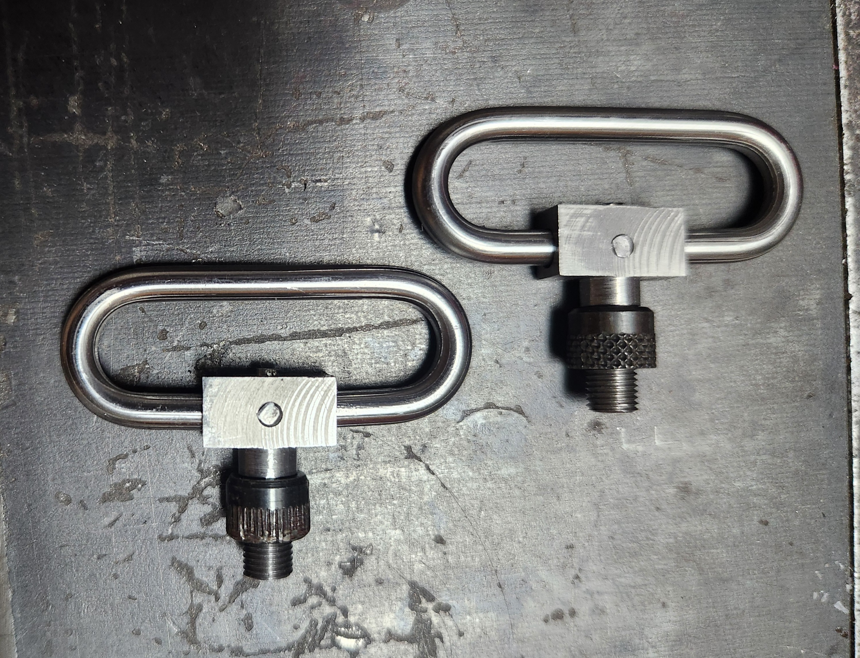

This is my latest version (and hopefully my last), finished with pinning and rust bluing, focusing on an authentic look with modern improvements. The front swivels, secured with a 1/16" roll pin, offer greater serviceability compared to the original staked-in pin. Each swivel body is precision machined from 1018 CRS and threaded 7/32"-40, while the loop (formed from 5/32" 1018 CRS) is sized to fit a 1 1/4" sling. Built to honor the classic look of the originals

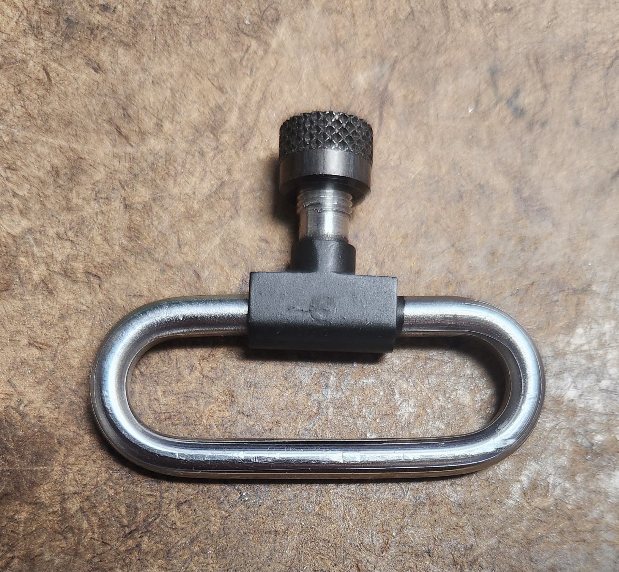

John,
Good catch.....
After measuring, I realized I put an older version on the front swivel. With so much crap on my bench it's fairly easy to pick up the wrong part. The error has been rectified.
John,
Good catch.....
After measuring, I realized I put an older version on the front swivel. With so much crap on my bench it's fairly easy to pick up the wrong part. The error has been rectified.View attachment 8766427View attachment 8766428

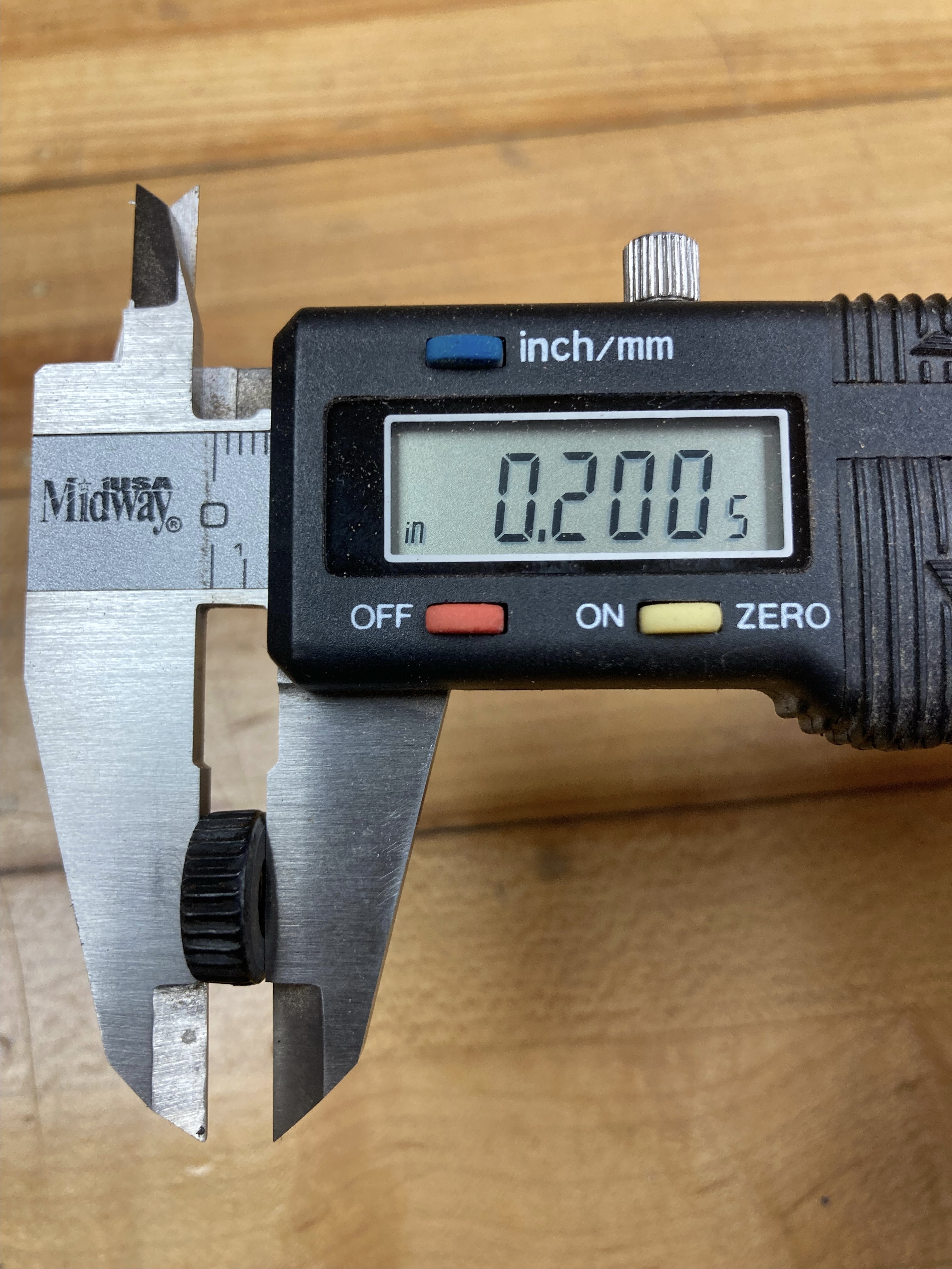

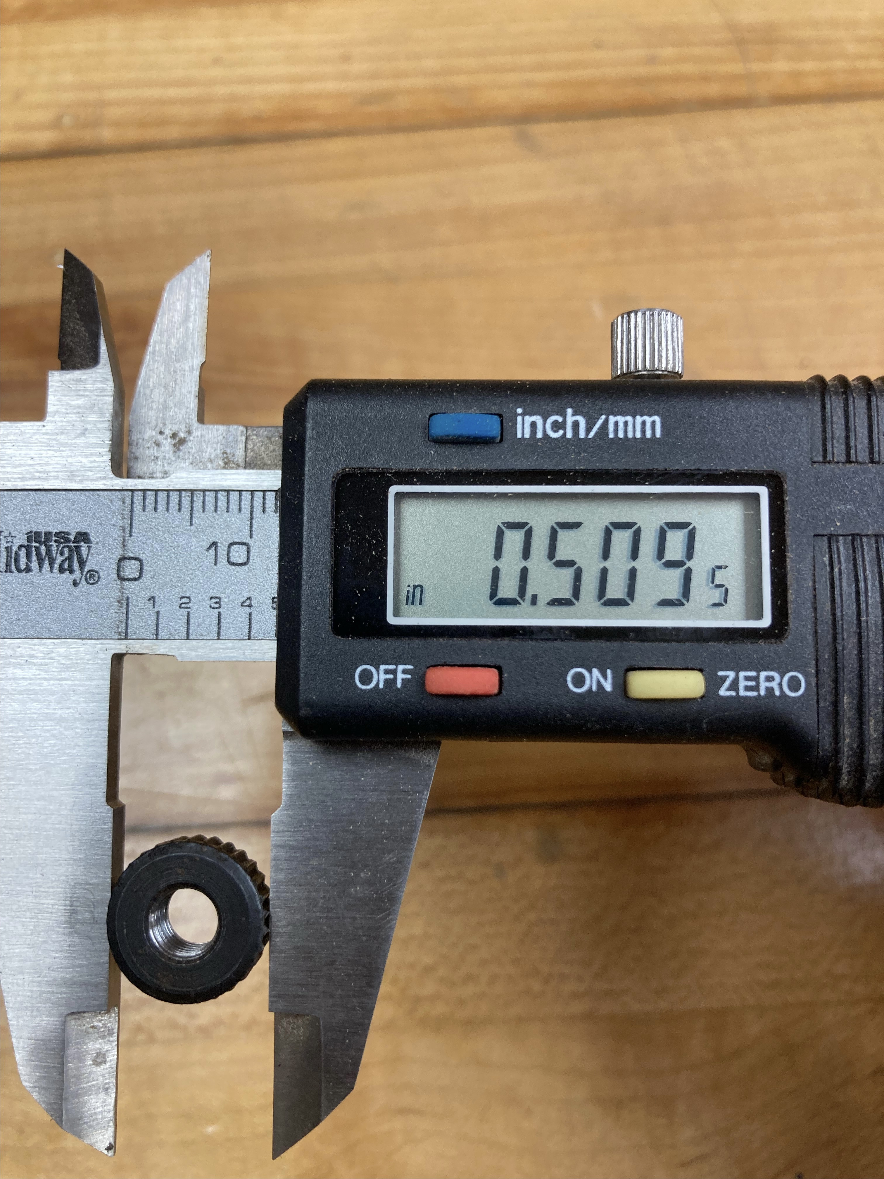

Thought these might help, it's the small disc that gets installed in the barrel channel for the front swivel.
John,
How important is the retaining nut as opposed to the one on my version?
John,
Probably no difference, I just posted those photos for your, and others, reference depending on how "clone correct" you want to make your swivels. A recoil lug bushing off of a M1 Carbine will also work as it is the same thread pitch, but again it all depends on how hung up on the details you want to get. Never did I think I would spend so much money trying to duplicate a damn sling swivel and I'm still not done.
