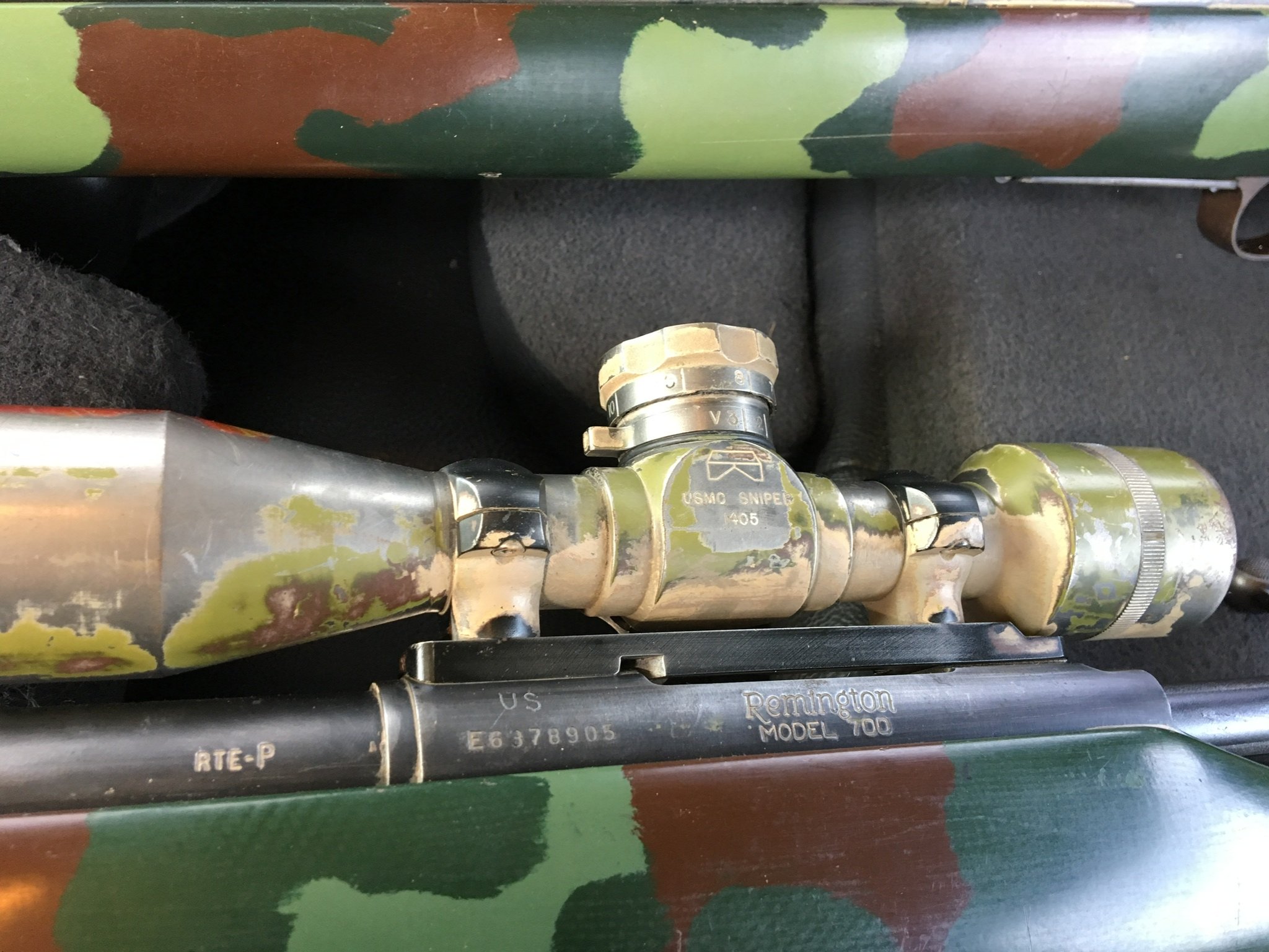

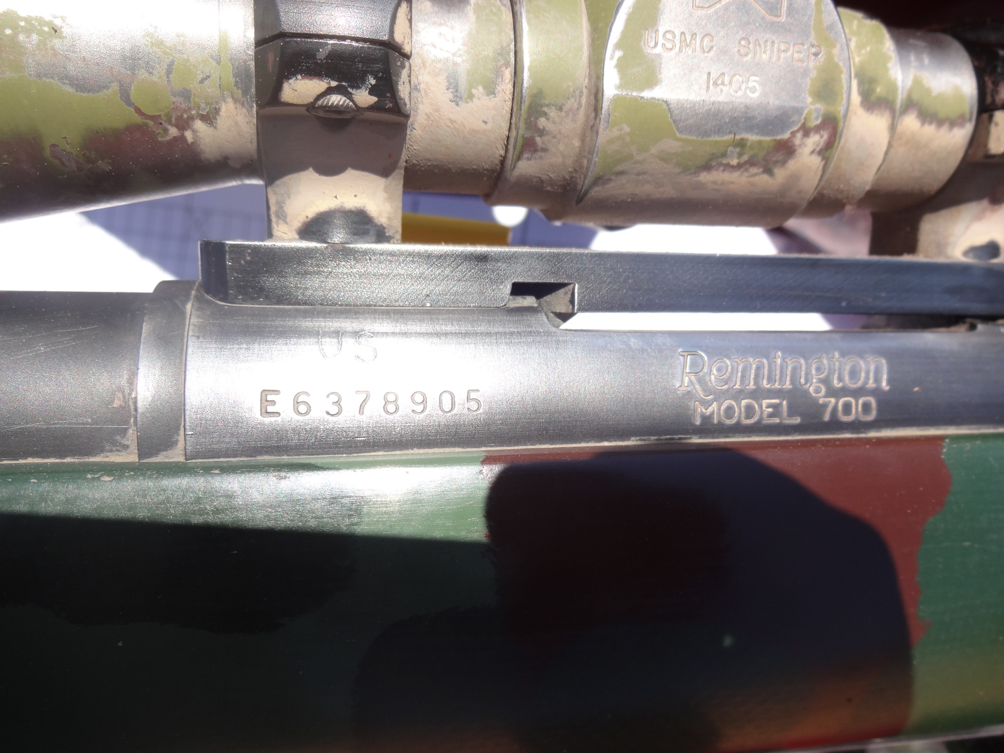

The pic shows that E-prefix guns spanned more than just the E676xxxx serial range most quote. Granted, this rifle is an A1, that receiver could have been carried over to an A3, A5 and maybe further.
In my opinion, the E665xxxx the OP mentioned would be "correct" to build from.

Paul, what's the second digit in your above photo of the M40A1, a 3, or maybe an 8 , so E63...? I cant' quite see it for sure. I have an M40A1 list going. Great photo, thanks.
I found a list of known guns with E and G serials from in service photos in an old file of mine including: E6547189 (M40A1); E6704912 (M40A5); E6763571 (M40A5); E6765371 (M40A5); E6763788 (M40A5); E6763874 (M40A5); E6763901 (M40A5); E6763950 (M40A3); E6764041 (M40A3); G6654291 (M40A5); G6654294 (M40A5); G6654295 (M40A5); G6654309 (M40A5); G6752839 (M40A5). This list used to be posted over on the M40 Forum, supported with some photos of some of these in service guns themselves that were posted in the Gallery there. I don't see the list there now, maybe someone you know who pulled it down, but photos of some in service guns are there in the Gallery.

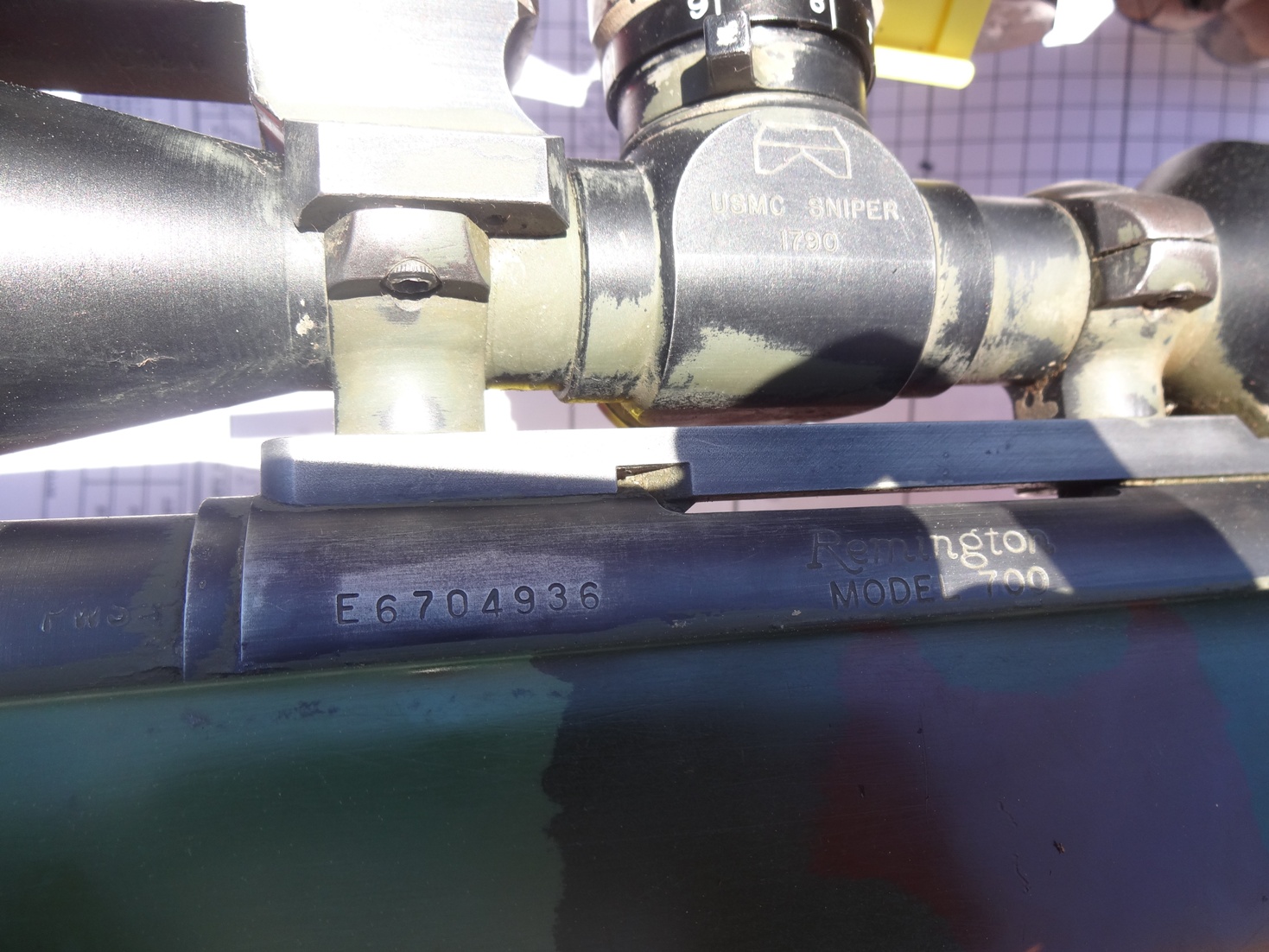

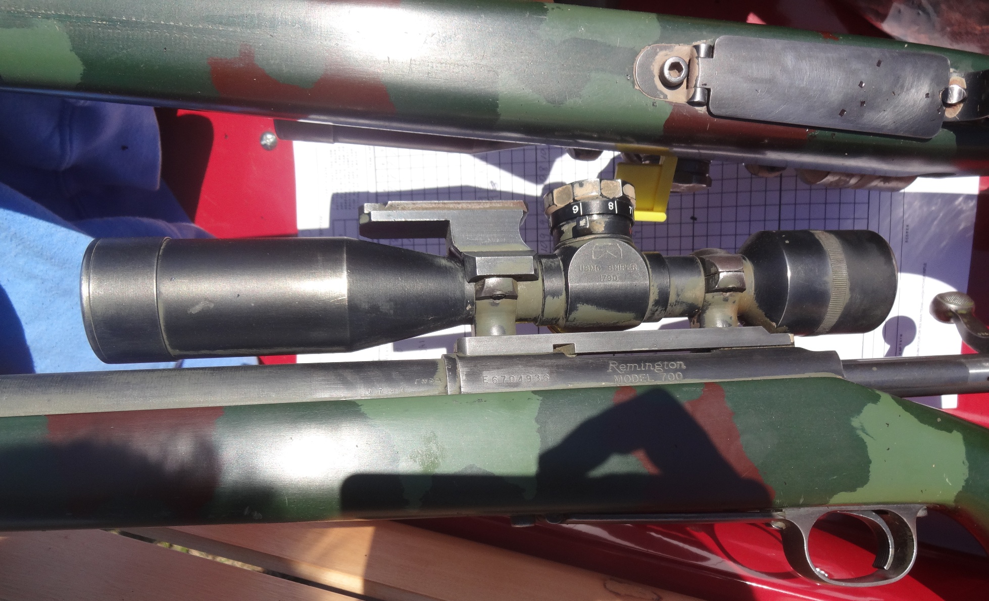

Attached are a couple of E prefixes for your list (circa 2016 pics at Quantico)
As to the original question:
There are a couple of rifles that I am looking at that have a serial number of 'E665xxxx'.
...that serial range falls between the two real M40A1s shown (E637xxxx to E670xxxx), so to me its fine for a replica.
