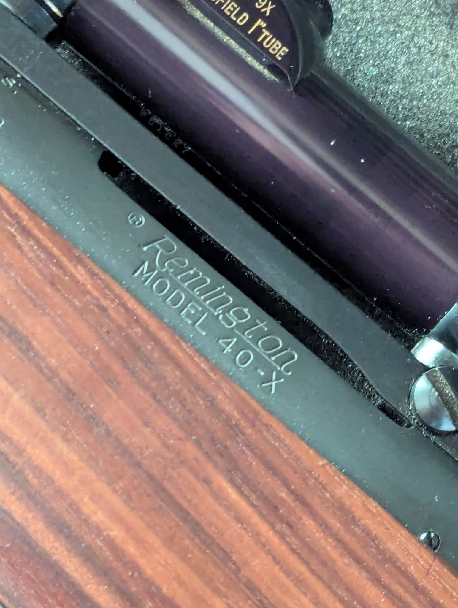

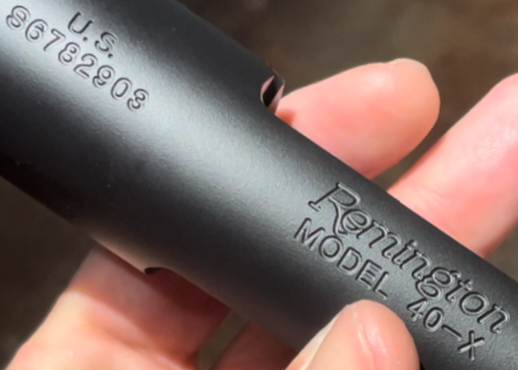

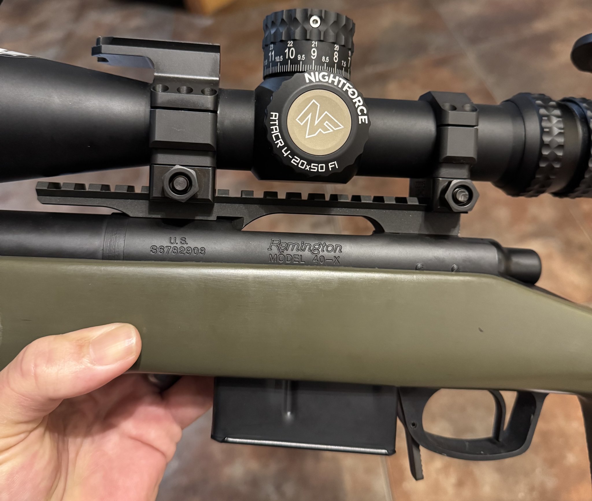

I'm convinced PT&G put the 40X on that receiver. It doesn't look like any other 40X marking, and as you noted, it's a Remington 700 serial number. I doubt they are messing with serial numbers.
DW
It could very well be that PTG welded up the 700 and remarked it with 40-X. Here's the OP's PTG receiver, notice how long the dash between the 40 and the X is, that's not normal. Also notice how there's no registered trademark symbol to the left of the word Remington. All of the regular 40X receivers I've seen (not including the laser engraved 40X-BR receivers and the titanium receivers) have the registered trademark symbol to the left of the Remington marking. I cropped this image to focus on the markings, but if you look at the OP's photos in this thread, his receiver lacks this registered trademark symbol.

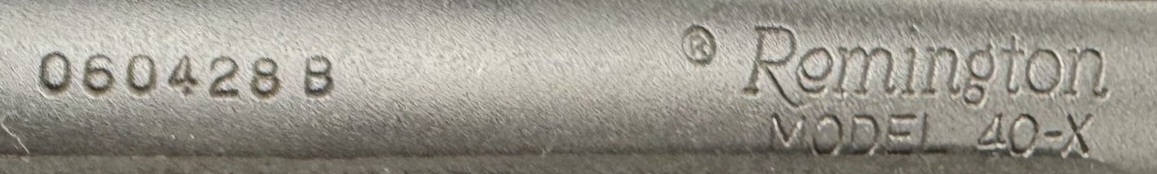

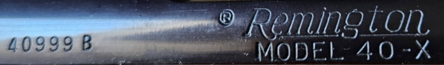

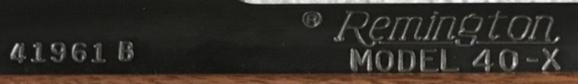

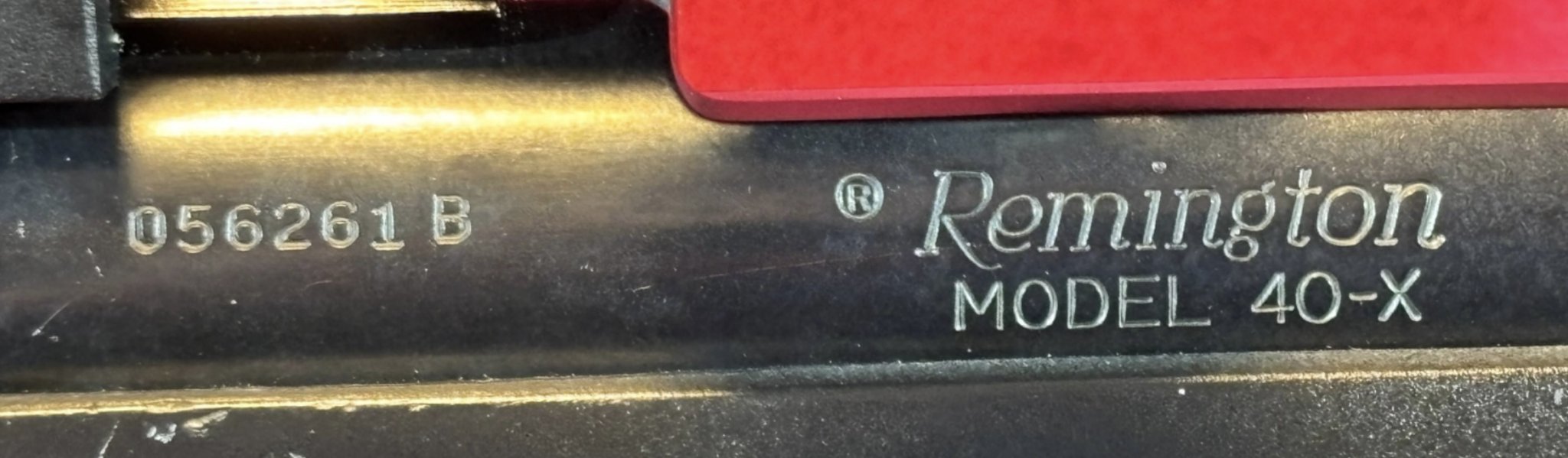

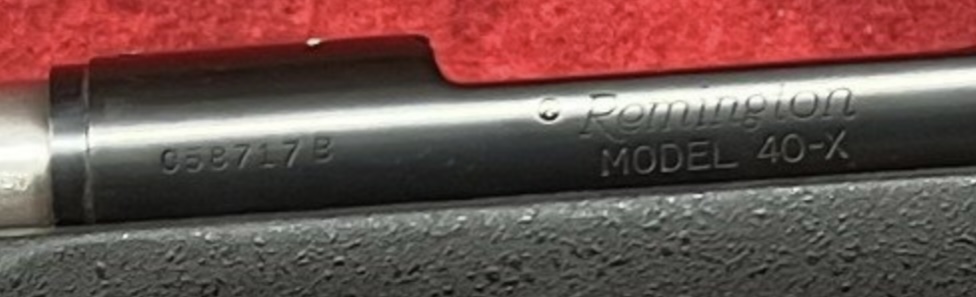

Here's one of the earliest 40X centerfire receivers I've come across, notice how the serial number doesn't have a letter suffix (it's early):

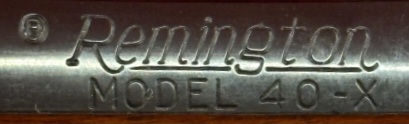

Other early Remington 700 and 40X receivers have the word Remington underlined, that's a dead giveaway to the receivers being pretty old (1960's and 1970's vintage?), and they have the smaller size dash between the 40 and the X:
And some more recent Remington 40X receivers that don't have the word Remington underlined. These receivers still have the registered trademark symbol, and thry have the smaller size dash between the 40 and the X:

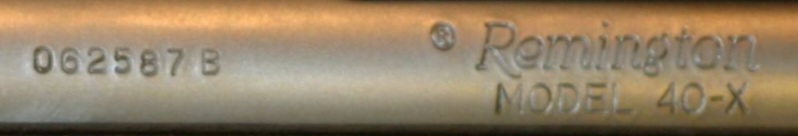

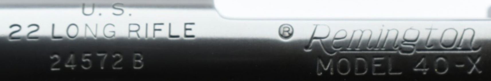

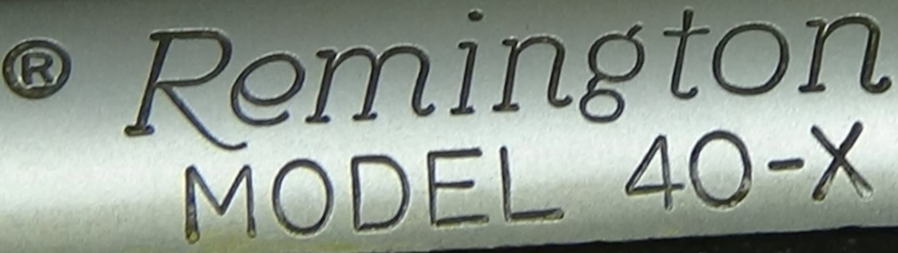

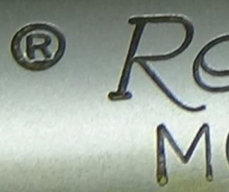

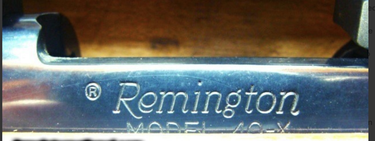

Even the old .22LR Remington 40X receivers have the registered trademark symbol to the left of the Remington marking, and the smaller size dash between the 40 and the X:
40X receiver without a serial number in the photo. Notice the registered trademark symbol to the left of the Remington marking, and the smaller size dash between the 40 and the X:

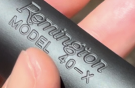

Here's the OP's receiver markings vs. the markings on the 2 original XM3's that I've owned:

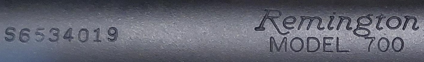

Remington had different variations of the Model 700 markings, so I'm not going to post a bunch of photos of them. Just notice that the OP's receiver is in a similar serial number range as my two XM3's, but it lacks the Model 700 marking. Either Remington really messed up this receiver, or PTG welded up the 700 and marked it with 40-X (or more accurately 40------X).
I agree. Stainless 700 receiver, filled and remarked “MODEL 40-X” Or possibly never marked 700 if it was from a bankruptcy. If it was manufactured and put on the books as a Model 700, would changing that be a problem? Similar to altering a SN?
Check the size and placement of the ‘MODEL 40-X” on these rifles. Yours almost looks like the MODEL 40-X is touching the Remington. Also the alignment is not the same. These are from rifles for sale online.
Again, not piling on, but the more facts and references we post, the less likely someone else gets taken.
Greg
You make a good point about the Model 40---X alignment on OP's receiver vs. known Remington original 40-X receivers.
Here's the OP's receiver (top) vs. an original Remington receiver that's unmodified (bottom). You can check the markings on OP's receiver vs. all of the unmodified Remington 40-X photos that are in this thread. There's only 1 single lone receiver that's photographed in this discussion thread that is different than all the rest. On OP's receiver, the R and M begin at about the same point on the receiver. All the other receivers that aren't from PTG show the M starting at about the middle of the R. I hope this makes sense, but this is not looking good for the PTG receiver:

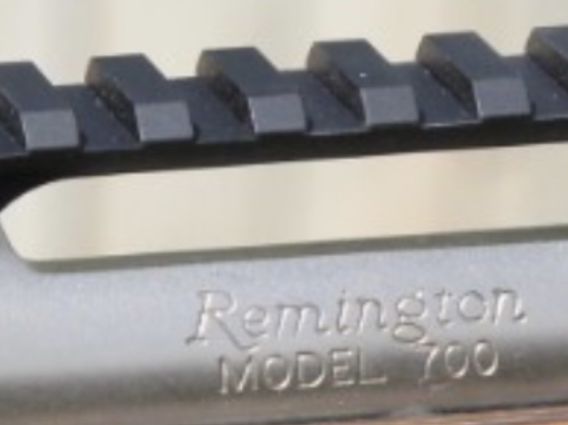

There is no trade mark on my Remington SS receiver View attachment 8596299
That's because the Model 700's didn't have the trademark, only the 40-X had it. Since the trademark is missing on OP's "40---X" receiver, it stands to reason that it's a remarked Model 700 receiver (alone with other defining characteristics).
Ah got it
Learned something new. I guess I’ve never owned a 40x to see the trade mark logo

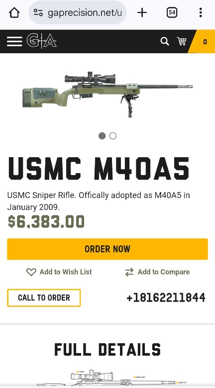

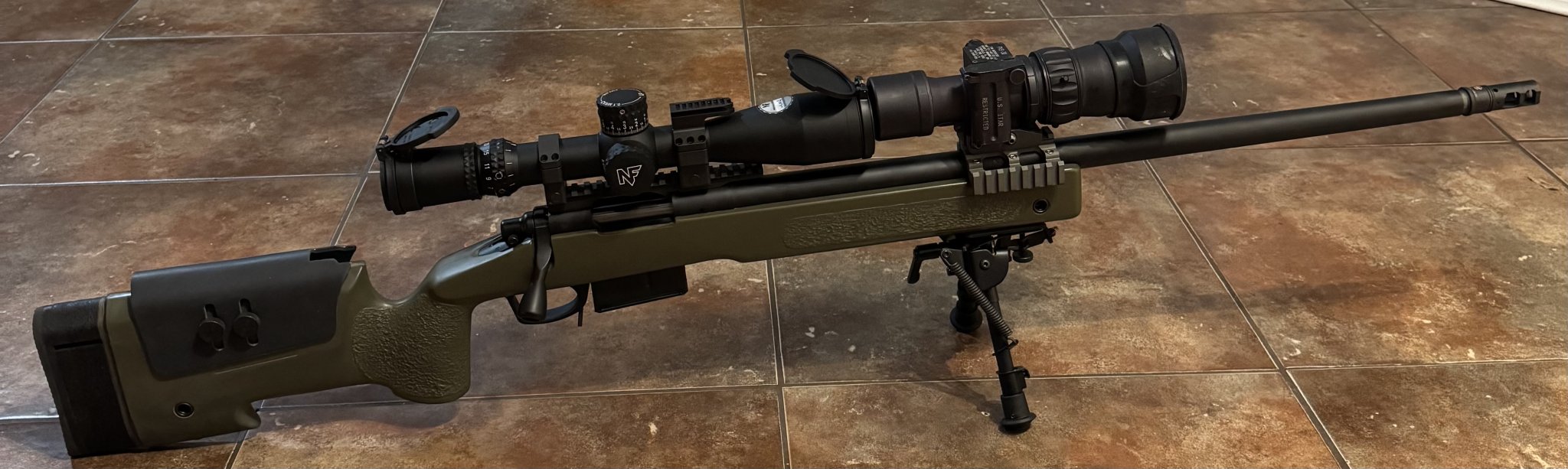

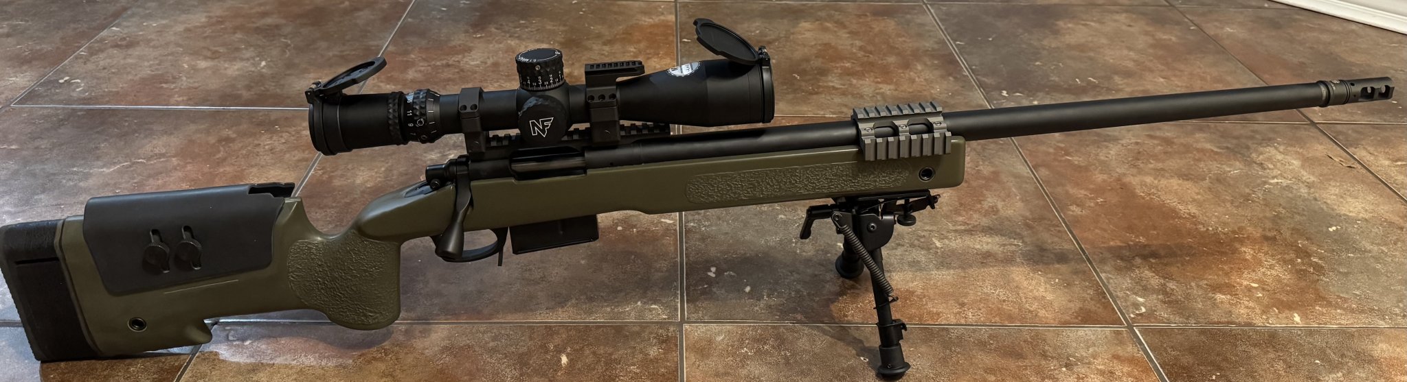

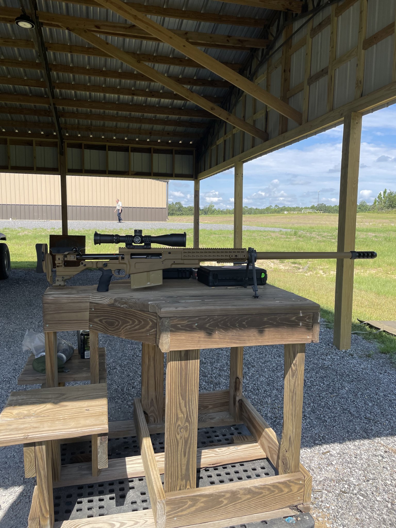

I just got my M40a5 from McMillan. It has a G date code.
Nice custom rifle, but that's all it is, a custom rifle. There is absolutely no way that it's an M40A5 clone. It looks like a very nice rifle, and you're probably going enjoy it for a long time, but there's no reason to call it an M40A5. This designation and nomenclature actually means something, and we shouldn't just make up names for custom rifles that have nothing in common with the actual military rifles and their civilian clone builds. My personal opinion, others will have their own opinion on this.
Reactions: HarryBC
Clone M40a5. Happy now? I emailed McMillan and told them to stop using the name M40a5. Should I also call GA Precision who advertise it on the their website?
I tried to be nice, I complemented your rifle, I clearly said that my post was my opinion and other people's opinions might very on this topic. And you respond with a passive aggressive attitude. Yeah man, sure, go call these companies and tell them they're wrong. You don't need my permission to do so, just go ahead and do it. Better yet, email those company's a link to this thread so that they can read this. Do it.
However, before you call up GA Precision and tell them that their M40A5 clone builds are wrong, you might want to see exactly what their clone builds look like. So, here's a screenshot of their website showing their M40A5 clone build:
And here's your custom rifle:
img_3010-jpeg.8597591
Notice how these 2 rifles have absolutely nothing in common beyond a Remington Model 700 receiver and Badger M5 bottom metal. Are you able to see these differences? Do you understand what an M40A5 clone is? Or is there a different reason for you posting in this thread?
There's literally no reason for you to drop you rifle in this thread, and yet here you are. This is a thread about fake PTG 40X receivers, not M40A5's. So why post your custom rifle here? Maybe you read my previous post in this thread where I specifically mentioned sniper rifle nomenclature, so you knew that at least someone would say something about your custom rifle being called an M40A5.
So, congrats, you got the exact response that you knew that you were going to get. This isn't the first time people have purposely done this in threads that are irrelevant to what they posted. You knew exactly what you were doing when you posted your custom rifle in a thread that's completely irrelevant to your rifle, and you got the response you wanted. It's that simple. We all know it, this isn't the first time this shit has happened in this forum, and it certainly won't be the last time it happens.
Did you have fun? Was this everything that you hoped it would be? I played my role to perfection, you're welcome.

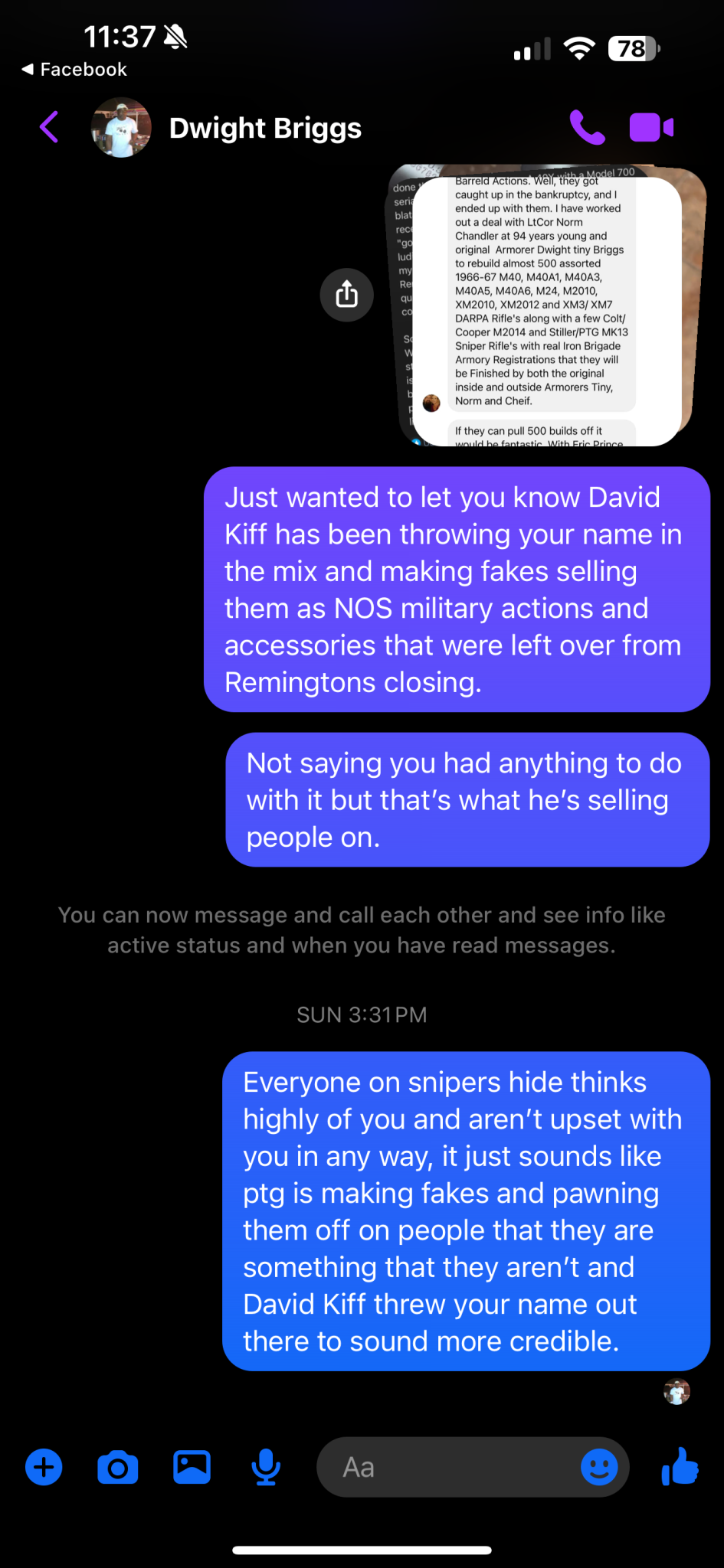

Still no reply from Tony and Kiff still hasn’t read my messages though the ptg FB page did but didn’t reply. The (Sorta40) will be done Friday and here’s some of the photos of the rail and action after correcting and decking that shitty clip slot before it got blasted, the barrel screwed in and got coated.

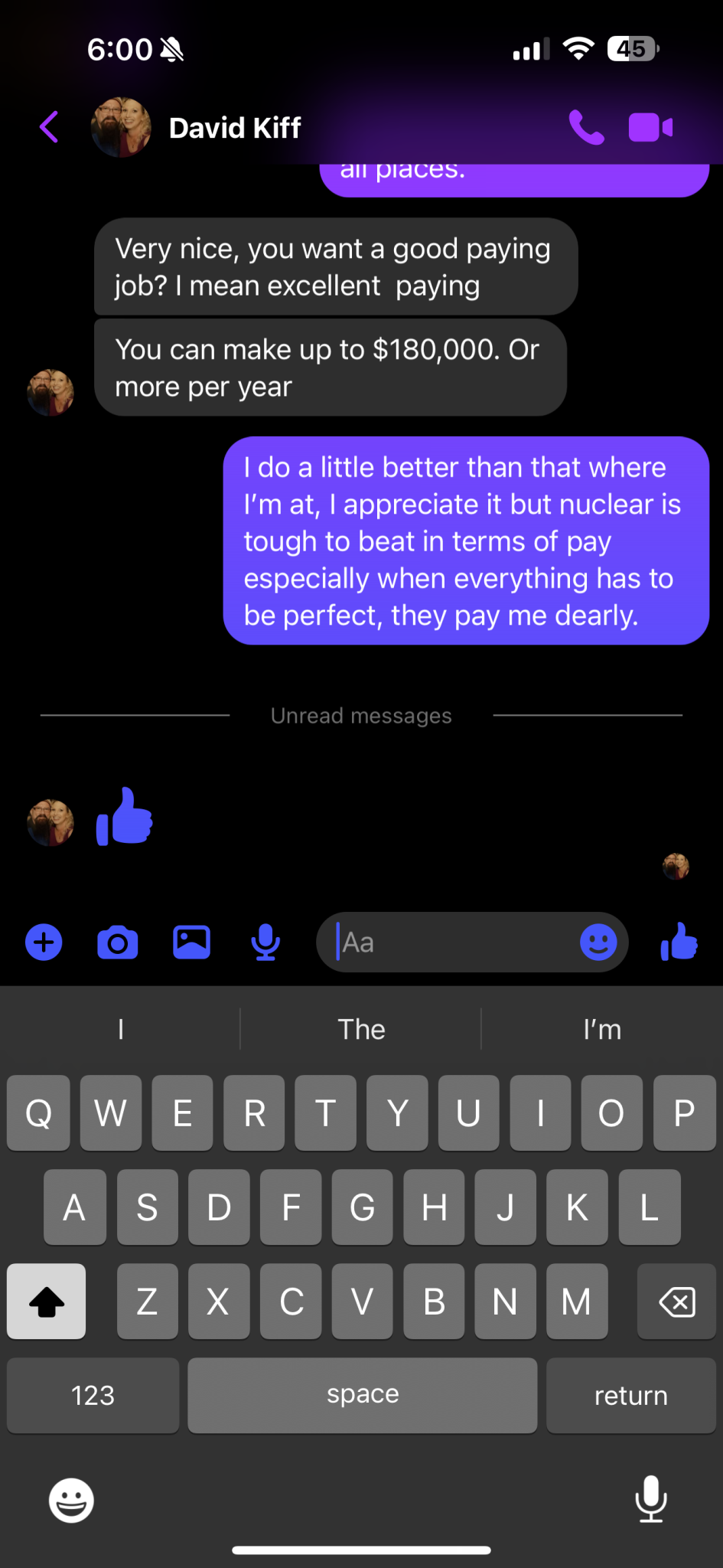

Holy fuck, I have no idea where to even begin with this stupid shit! Does he have any other names to drop? That seems like a hobby of his at this point.
"They we not true 1988 through 2019 of M24 SWS or R, G or E M24 or 1966 through 2019 M40's.
They were made during and after the bankruptcy"
Yeah, no shit. He finally admits they're fake guns, and yet he sells them to people as the real deal. Fucking scumbag.
"People who know me know I try not to cheat folks."
Holy fuck, this is the absolute most insane thing Kiff has ever written! There's literally a saying on this forum - "There's 2 types of people in the gun world, those who have been screwed over by Dave Kiff, and those who will be screwed over by Dave Kiff at some point in the future." The first time I heard that saying it was from a vendor who used to do business with PTG. The guy sells fake shit left and right, and lies through his teeth. All he knows is cheating folks, otherwise he would be selling people fake receivers and 40X scope bases.

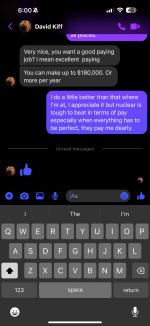

And what role at PTG would be a $180k per year job? Or does he have another company managing hedge funds? I can't think of anything at PTG that would ever pay that much. Maybe laser engraving receivers? Lol.
Ask him if you can do it part time, 100% remote. Might as well get some money out of this, but good luck with that.
Reactions: USNavy06 and Jrb572
🤣🤣🤣 tempting but hard pass, i don’t believe i would be comfortable with my associates 💀
