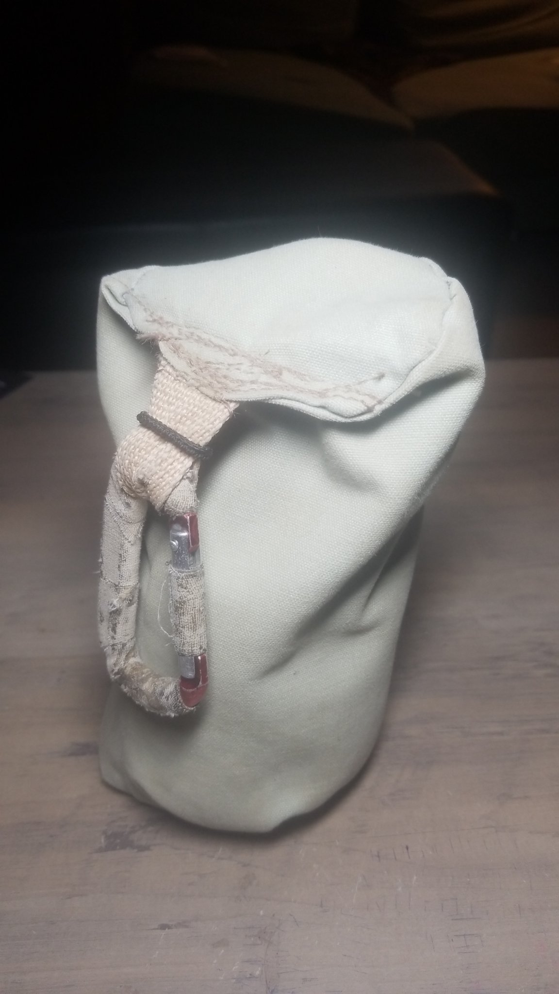

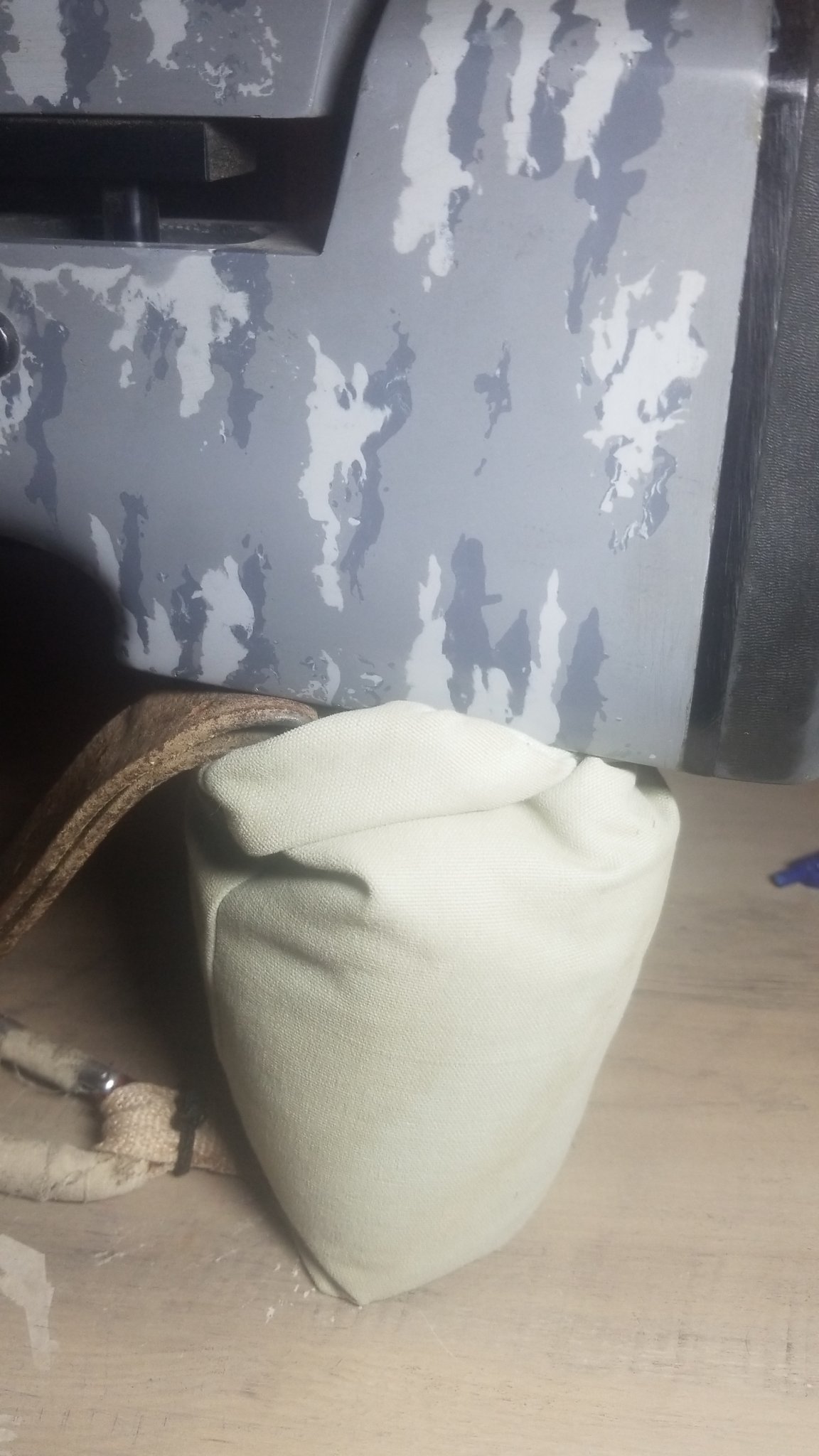

Respectfully submitted for shits, grins, and general entertainment. Spent a couple hours on this today. A lightweight rear bag. Turned out 'bout how I expected.
I will say this to anyone who has looked at some of the nice offerings seen on this very site and paused/cringed at the price. There is a fair amount of labor involved in one of these. Unless they're outsourced to a huighur concentration camp, anything of this sort that's made in the US is probably fairly priced. My hat's off to any cottage industry manufacturers who see this.
A fun experiment on an afternoon off.

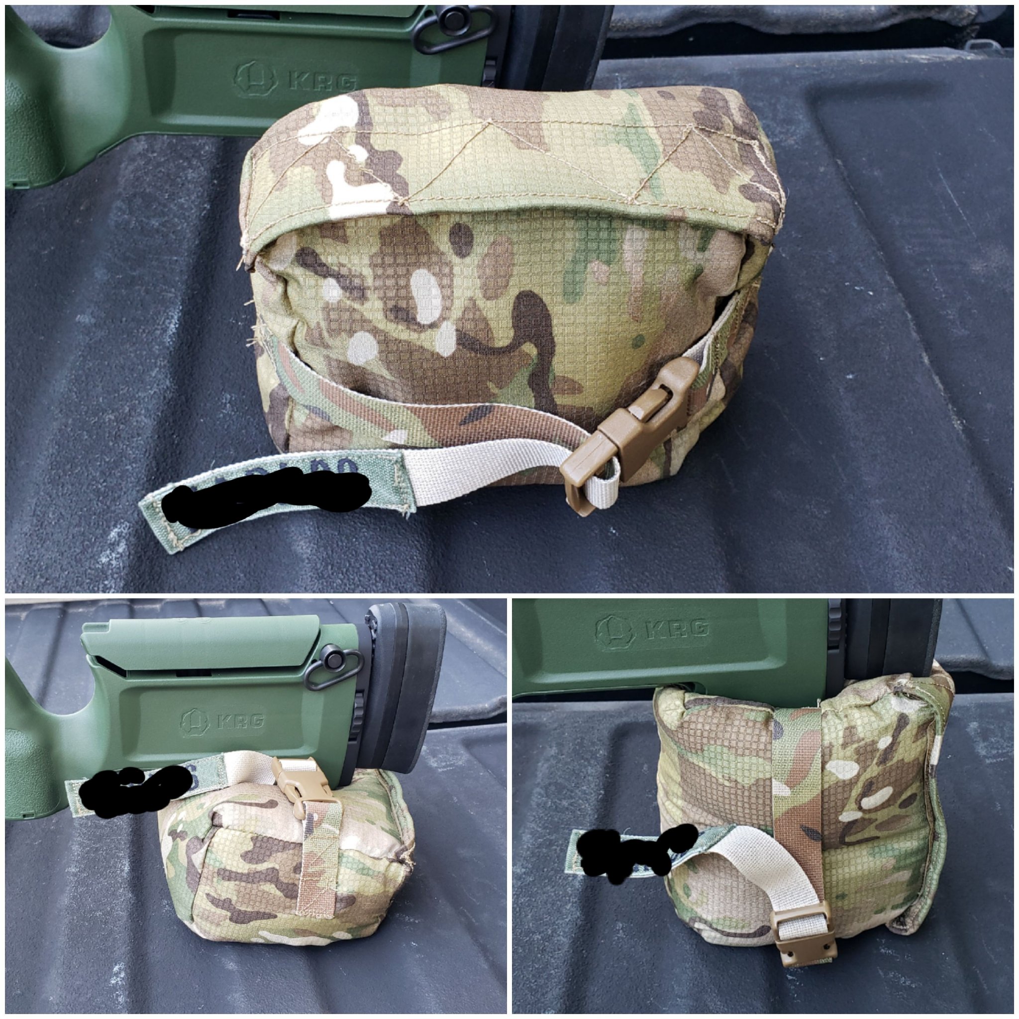

I've stitched some together myself. This is actually my second rear bag. The first one lasted me about 8 years before the seams blew out. They can take a bit of time to fab from scratch, but if you plan ahead you can streamline production.

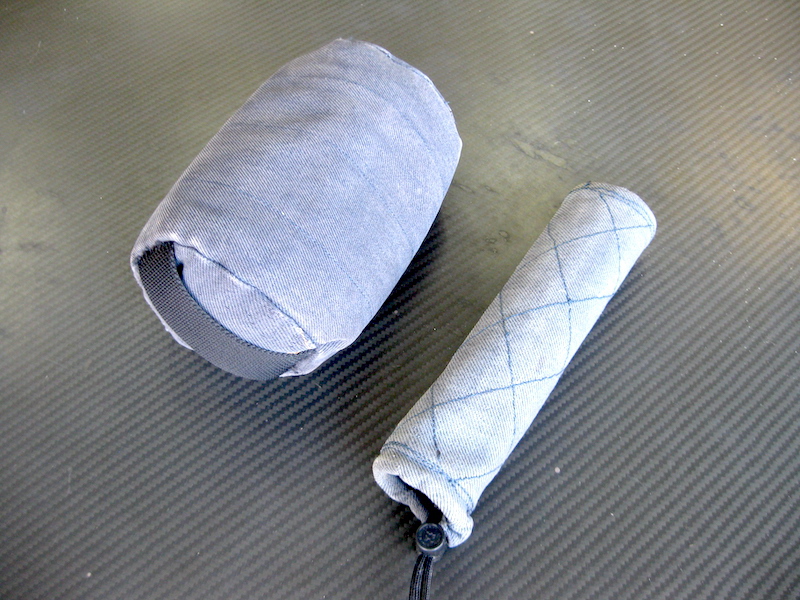

Camera kind of washed out the color, but it's more a charcoal grey in person.

What did you make that suppressor cover out of?
Double layer of canvas, with a thin sheet of PTFE and "heavy duty" aluminum foil quilted together. I didn't trust any other synthetic materials (besides Kevlar $$$) not to melt and stick. Intended for bolt-gun operation only. No 10" AR mag dumps. Really only intended to keep the mirage down between shot strings.
Reactions: greentick
What did you use for filler?
This stuff
Total project weight was 3.5oz

Design based on beating the old sock filled with beans.
Looked a few pics on this site and wanted a roughly something 4"x6"x8" dimensions.
This was just fooling around. I had bought the materials for a project I never did, just wanted to do it and I needed a rear bag to replace the old sock. The name tapes came off of old BDUs. If I do a rev 2, I think I'd make the ends oval shaped to avoid sewing corners and speed up completion.
I need a suppressor cover but I believe I'll pass on that project. I like your use of available material...
