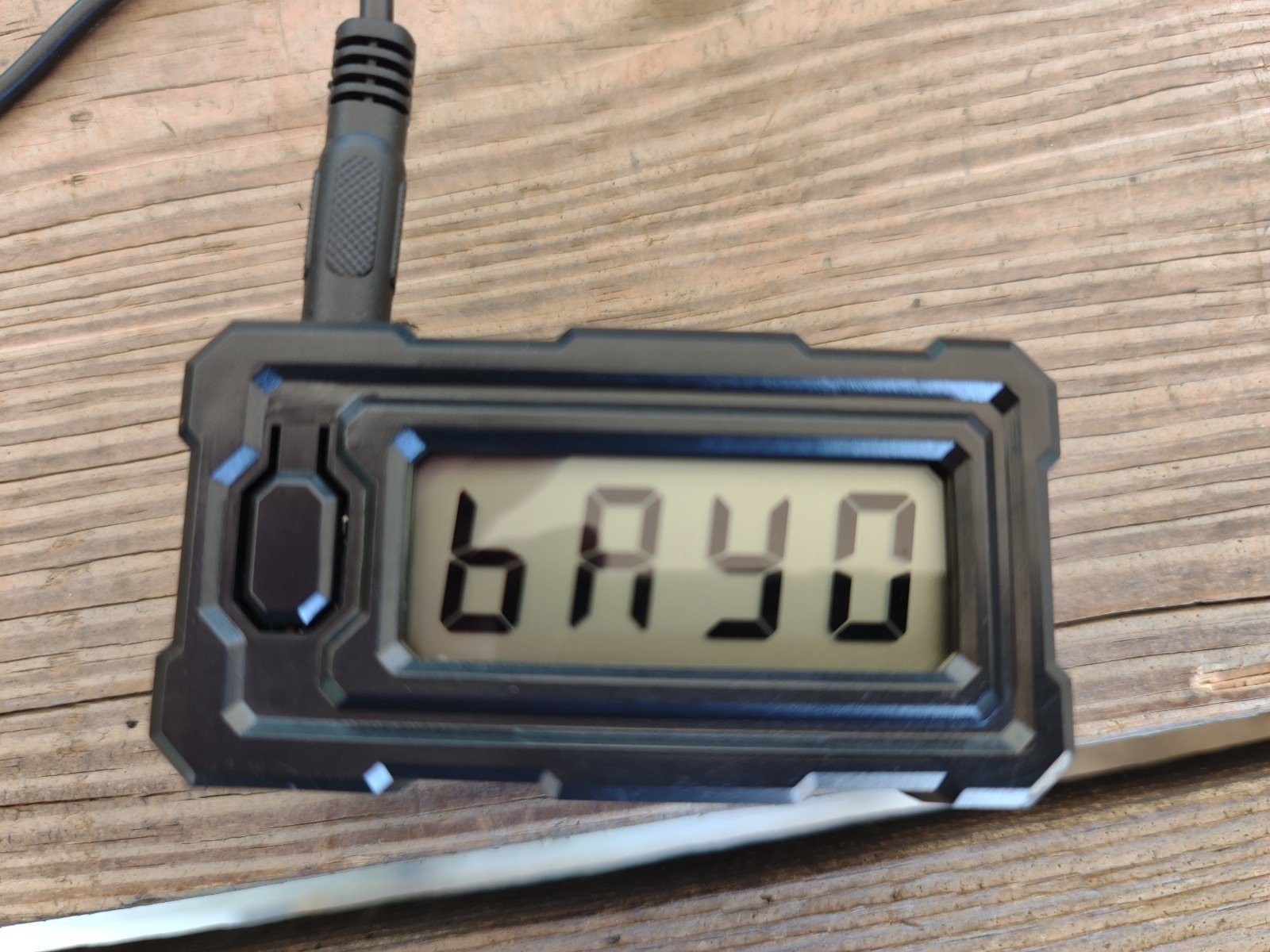

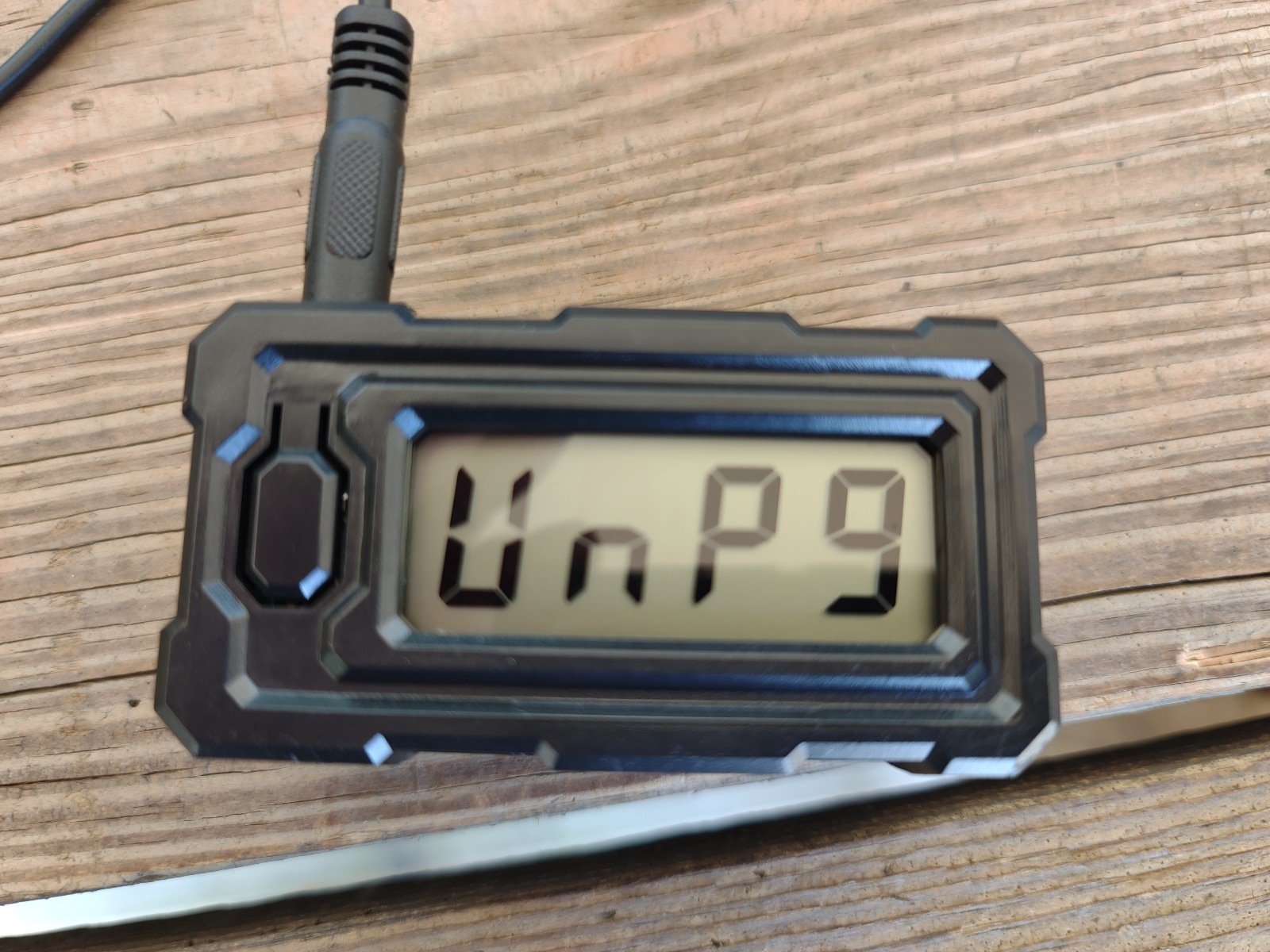

So, I was at the range today. Al things going well and good. Set my rifle to the side for the barrel to cool, pick it back up and get an error that the bayonett is unplugged, when it was plugged in and working fine 10 min before. Anyone run into this?

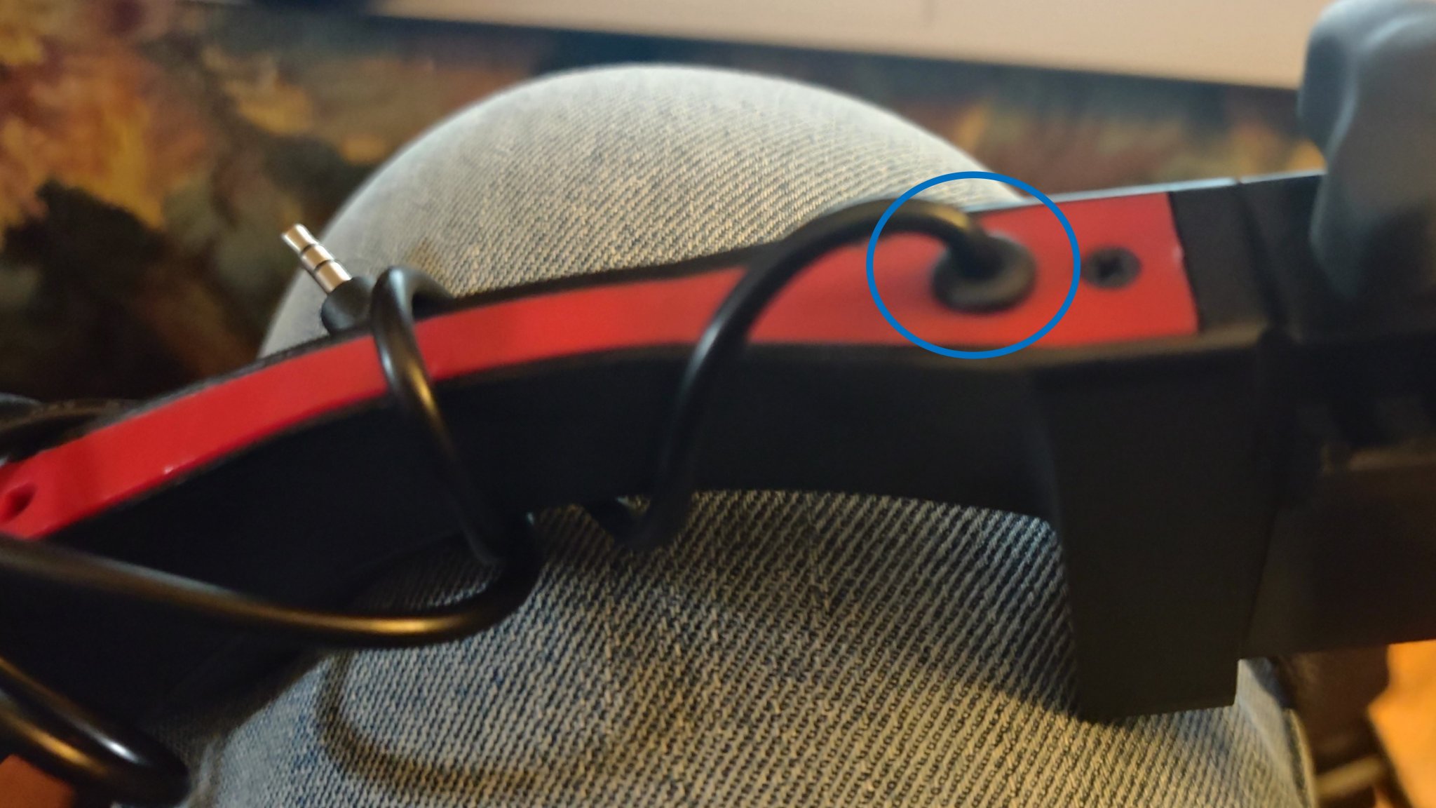

I would guess the cord is either broken inside or broke free just where it is connected the bayonet inside. Thats a pretty good kink in that wire from being wrapped around the bayonet. That could be putting stress on the internal connection also if the cord is not rigid enough where it passes through the housing. This is speculation but in the picture it looks more like a grommet than a molded cord. That might let the cord put a little to much stress on the connection inside. Where before you had a solidly mounted port that would put very little stress on the inner connection. Just spit balling though. I could be way off in left field here because I have never touched the sporter model before.

I had this happen. It was just the cable. It was moving out of the bayonet under recoil just enough to cause error. New cable and no issues since. Nice they are replacing it for you.
