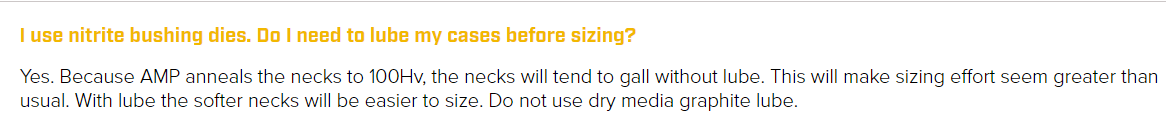

    I’m annealing with an amp, they even had to put it in their user FAQ to not use graphite as it dosnt stick.
    Even factory Lapua galled steel mandrels with graphite. After there is some carbon in the neck it becomes much less of a problem.

    I sent the question to Amp and they replied that graphite powder on the inside of the neck was fine. They did have an issue using a bushing die on the initial sizing operation using the imperial dry lube with the ceramic balls. The Imperial dry lube did not adhere well to the outside of the case neck.
