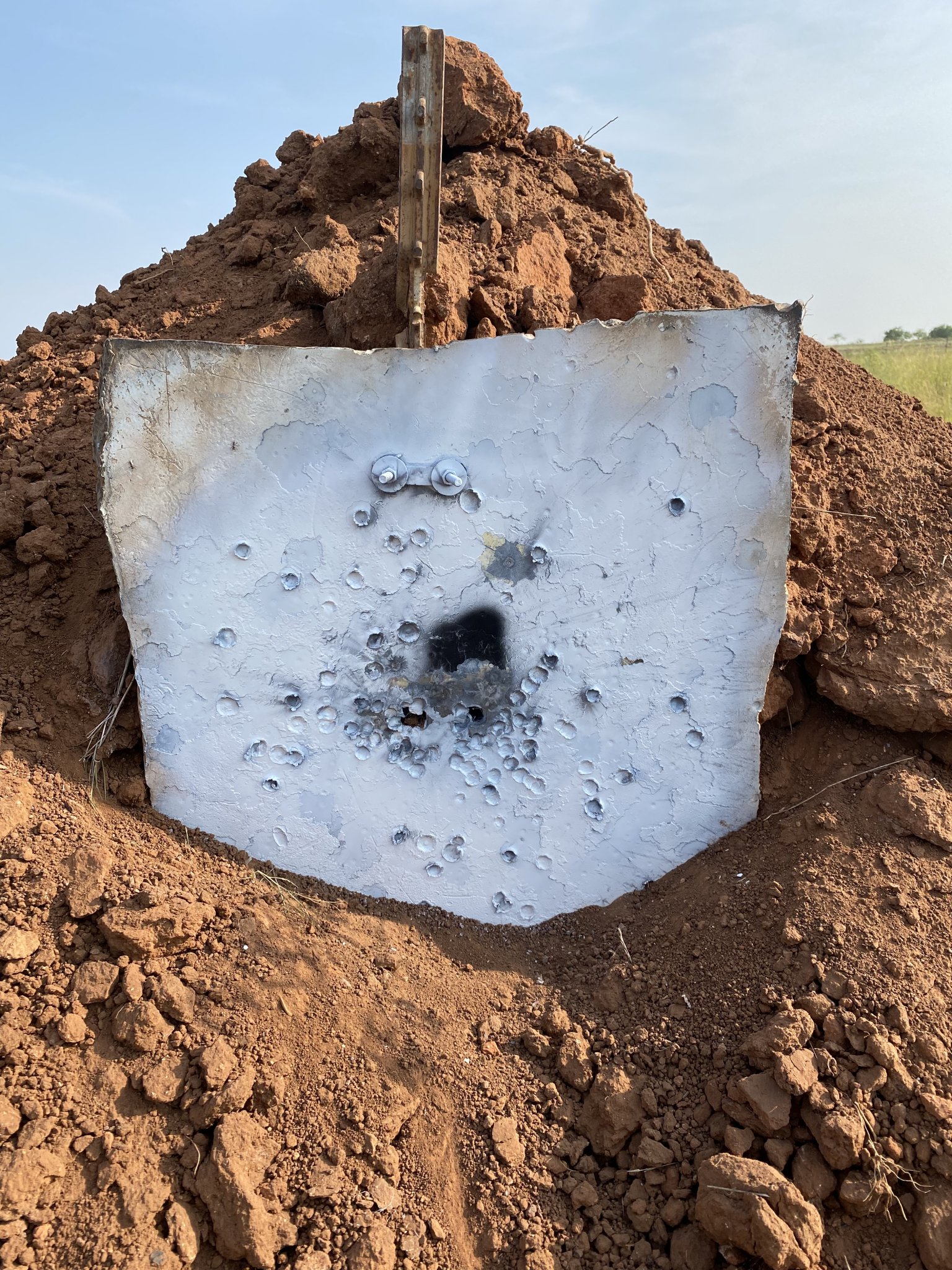

    Worked up a load with Varget and 123gr Scenars. Velocity trues out at 2940. My current 140 load is the Hornady BTHP at 2685. I could push it harder but that is where the best groups are. With the 123gr Scenars my best load is at 2940. When compared to my 140gr BTHP load at 1000 yards with a full value 10mph wind, the 123gr Scenar has a .1 mil wind advantage but it has a whoppin’ 1.5 mil advantage in trajectory.
    Here’s a 5 shot group at 900 yards. Can’t account for the flyer. Was it me? Don’t know but I do know I’m going to give the 123gr Scenars a try.
    John
