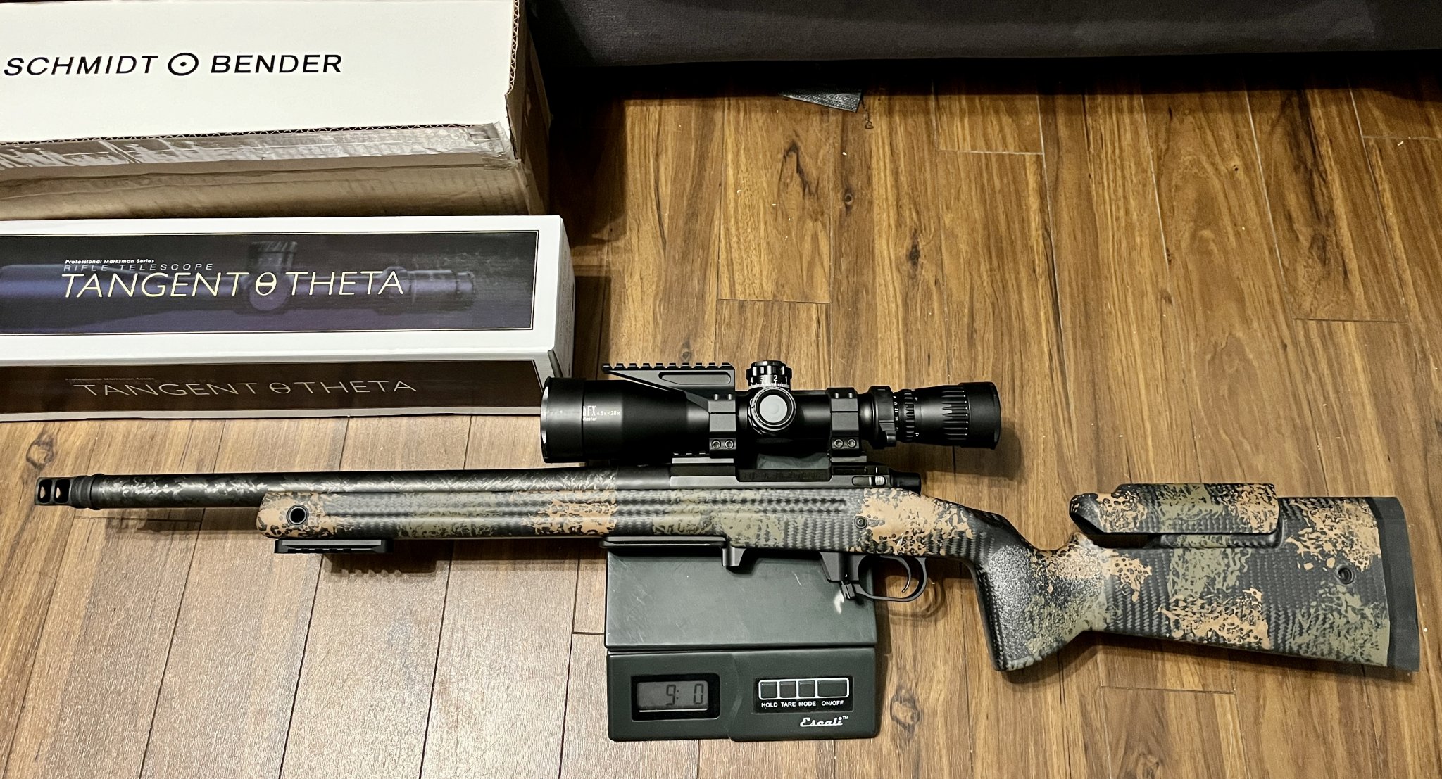

I just built a “lighter” 6.5 PRC and my plan was to put my 4-20 ZCO on it. The ZCO currently sits on my 16” .308 AR. I was going to put a 4-16 NF ATACR on the AR as a replacement. I really liked the NF MIL-XT reticle.
After I found the this March I think I have changed my mind. The 4.5-28 would be a great scope for a light 6.5 PRC hunting rifle.

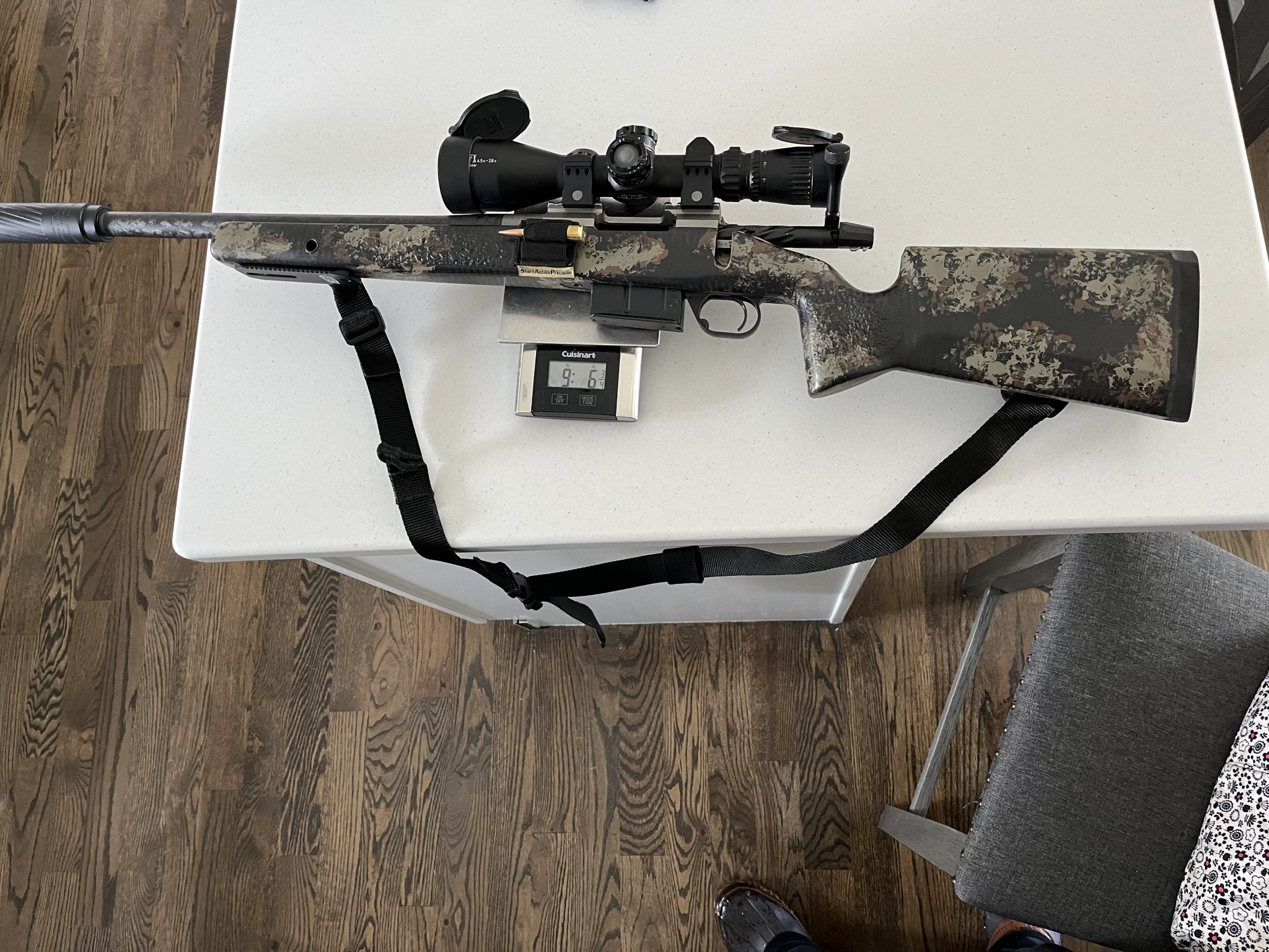

Well you didn't tell me this was for a lightweight 6.5 PRC, here's my lightweight 6.5 PRC and it just so happens to be where I'm using my 4.5-28 this year ;) Keep in mind I really like the ATACR 4-16x42, but if you can pay the extra for the March 4.5-28x52 then it offers so much more...

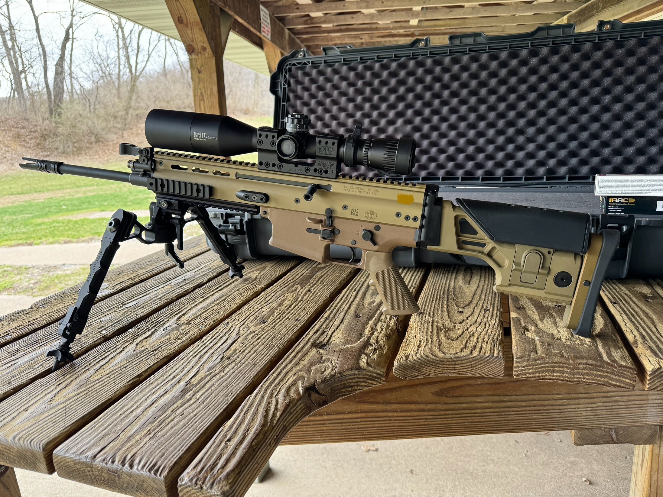

I put one on my SRS-M2 and I’ve been loving it so far. As mentioned earlier, the field of view is the best part, didn’t know what I was missing until now.

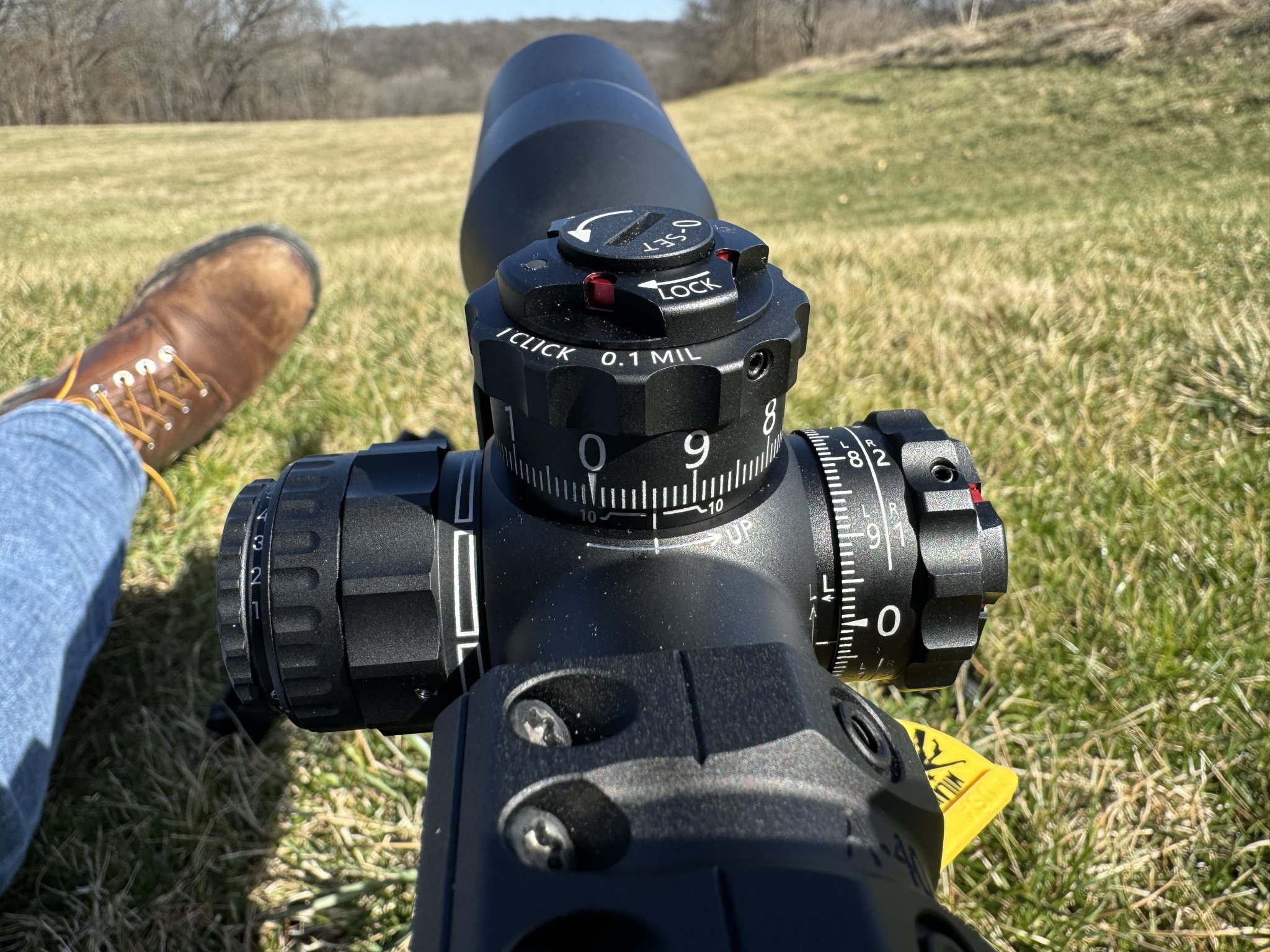

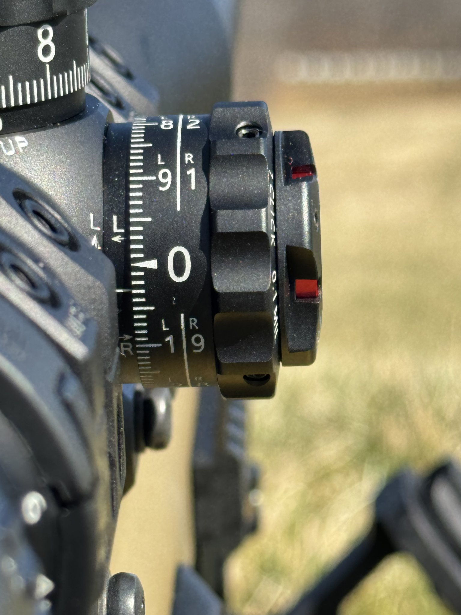

The only issue I’ve run into is how low profile the turrets are. Running my ARC mount, the top of the rings are so thick that I have to lift my head to see the turret markings. Going to switch to a different mount or maybe just a set of rings with a lower profile top ring to see it better and that’s will solve my only issue.
I ran into similar with mine using ARC rings, I went to Spuhr and that helped solve the issue, the new Shuriken lock turrets are a little higher with larger numbers which may make this easier. Doesn't help you but if others should see this post it is just something to be aware of.
I have a Shuriken model with a Spuhr mount and can confirm the markings on the top turret are above the mounting rings. That said, I need to rotate the rear flip cover so it’s not blocking my view.
