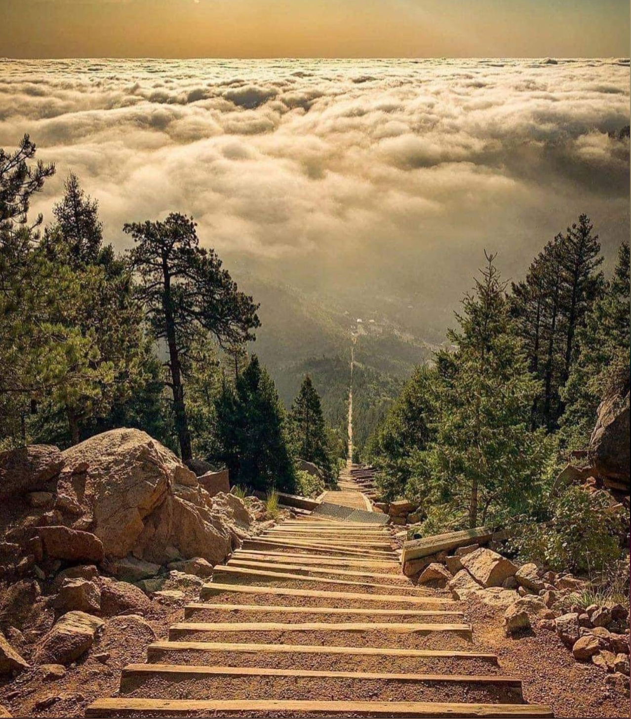

Lewis and Clark surveyed the west with chains. The photos below are the US-Canadian border. Imagine surveying that with a ball of string and a compass.

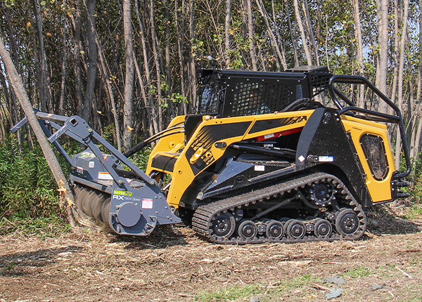

Look around the want ads in your area for people that do land clearing. We hired a guy that had a skid steer with a mulching machine attachment and he cleared WAAAY more than that in a very very short time.
He would have your range cleared of brush before lunch.

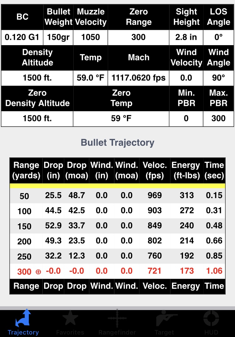

Serious question - how high up were .22 bullets hitting tree limbs when shooting a target at 300 yards? Are you with your rifle and the target at about the same elevation?
Did some quick AB ballistic math. 40gr bullet @ 1050fps. Didn't mess with height offsets or anything. Zeroed @ 50 yards.
@ 300 yards drop in inches is 165.4". So 13'9.4".
Edit: Upon further searching closer to 58.5".

Is that the way the math works?
I mean, I understand if you aim at a target at fifty yards and shoot it dead center that it is zeroed for 50 yards. I think the way those charts work is that a drop of 165.4 means that still shooting at 50 yards zero, the bullet would theoretically drop that much further. I am not sure that math holds once you re-zero for 300 yards, tiling the barrel up. I could certainly be wrong. I don't know the answer, so I am not really debating with you. I am just trying to figure this out in my head without the math skills to figure this out or any real work plausible testing.

Yes, that is the way the math works, almost.

Edited above upon further searching.
It's more like 66% not 50%...
if you go too the kestrel and look at the TRACE setting, which shows you where to look above the line of sight for your round. If I have a 65.8 MIL Hold on the shot, it shows 43.8 for the TRACE so it's gonna go up that high when trying to look for it.
If you don't have a Kestrel you can do the same in most ballistic calculators by changing the zero setting in that app to the range to target..
Say1000, then look at the trajectory, which normally shows all drop - negative numbers But, with a zero at 1000 yards the trajectory will then show some positive numbers.
The highest point in the trajectory positive numbers will be the highest point over terrain assuming a near zero angle between rifle and target.
Closer to 58.5".
