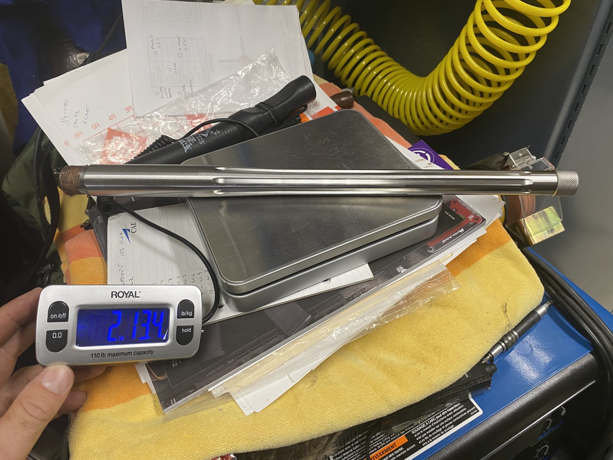

I've received my 7mm-08 Tikka prefit from McGowen and it headspaced as it should. Send it out to LRI to jazz it up with some flutes. Will see how it shoots.

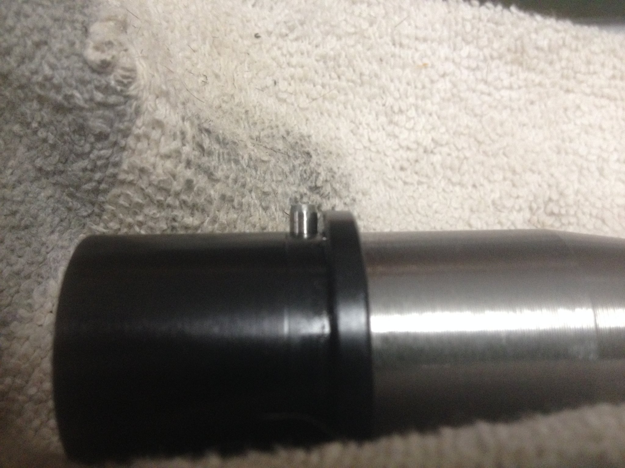

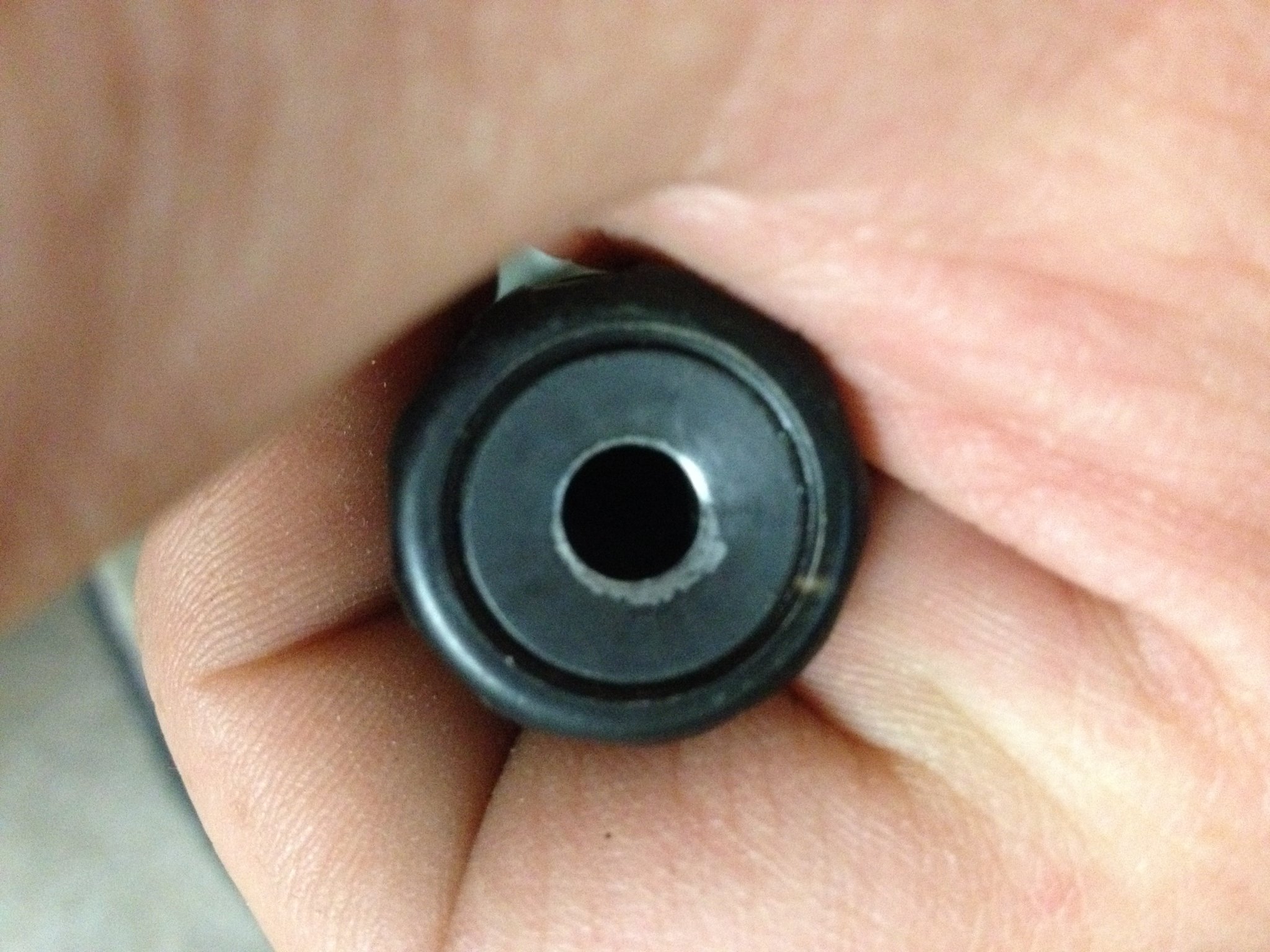

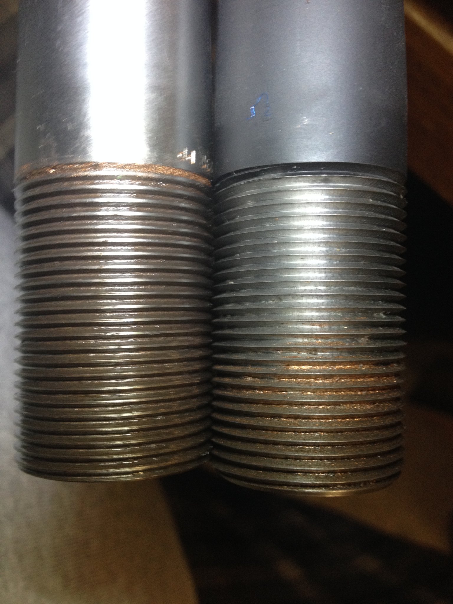

Here is some more. Threads on the right are on a McGowan remage barrel. It was a replacement for a barrel with drastically undersized muzzle thread. Pretty much the loosest thread fit I have ever seen, with this barrels fit to the action being high on the list also. And I worked on trucks and tractors that farmers and truckers worked on, so I have seen some shit. :ROFLMAO: :ROFLMAO: :ROFLMAO:
The next one is a 20 practical AR-15 barrel. Even with a small base die, brass fit is pretty snug. You can see the pin in the extension was way too long. The muzzle threads are questionably tight, as are the muzzle threads on the first barrel. The first barrel also has no crown.{just a paint line}
I am kind of in the same spot. I don't even know if I trust them to fix it. Maybe they would just replace it with a blank. Or maybe a 6mm-300PRC. That way I could toast in 400 rounds and feel like I got something out of it, but not have to deal with it long. :ROFLMAO::ROFLMAO::ROFLMAO:
