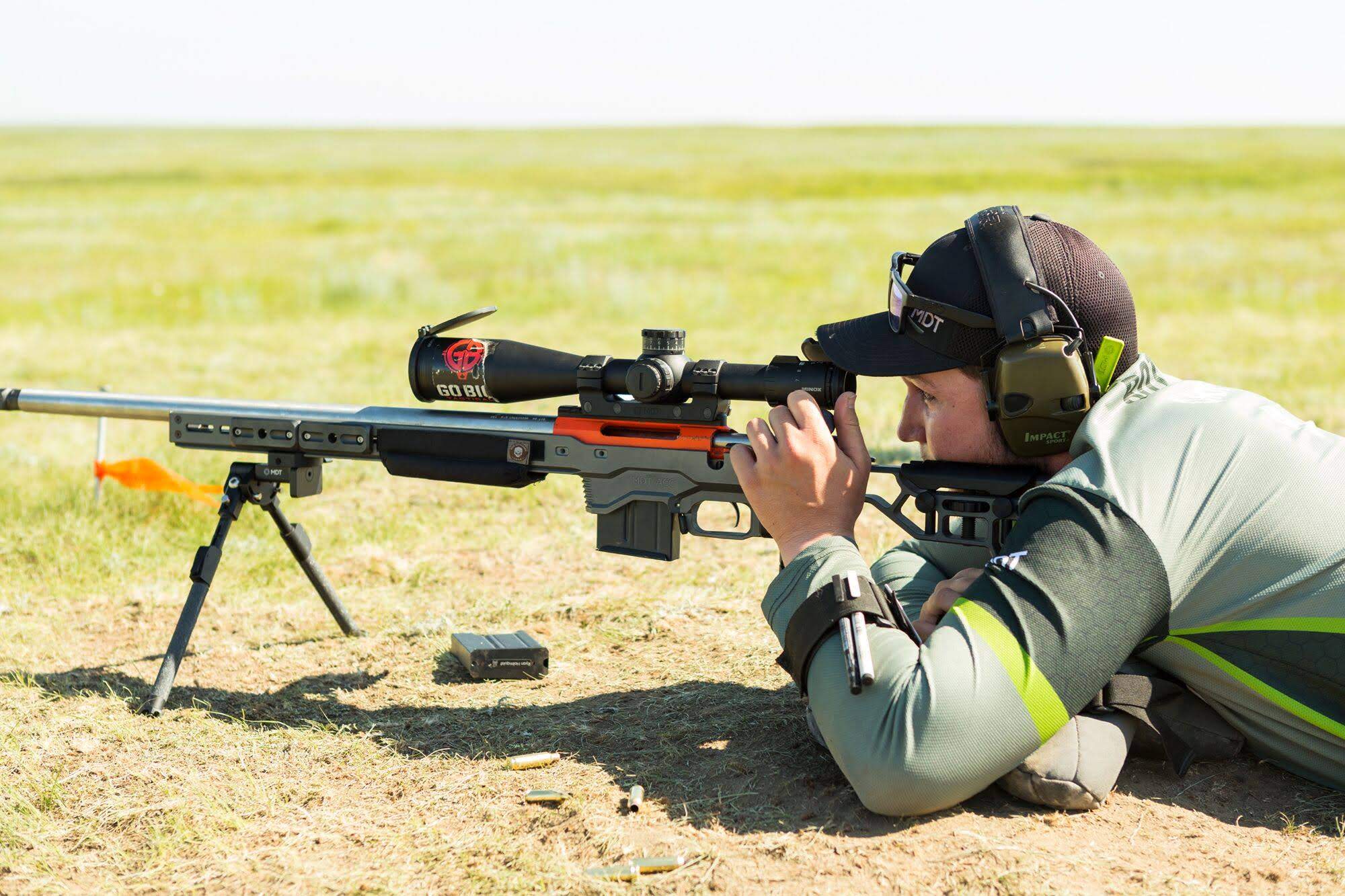

Here's me shooting mine in a match a few years back in WA. You need to clear the bolt handle and the safety slot and be careful that the bolt release pin will not fall out!
- Josh

Would it be possible to convert a HNT26 in tikka LA to left handed?
Kind of... The problem is that with all of the material removal we have done to lighten then chassis, you will almost certainly have bolt release issues and may have to get creative there? Also, for removing material for the safety and bolt handle, there is a lot less wall thickness, so the margin for error is very small.
I would advise against modifying this chassis for a lefty more so than most other chassis we make.
- Josh
