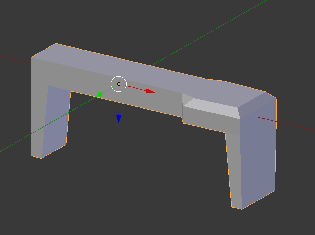

Just an update for the BR/Dasher folk out there. I had a Primal Rights kit that I tried to get to work in the MDT magazine and it just wouldn't work consistently with Dasher and either the kit or the original MDT follower. Lots of nosedives due to the followers flopping around.
Finally broke down and got a 3D printer on Black Friday and managed to make a new follower that uses the Primal Rights flat spring and has long anti-tilt legs on the front and back. Here's what the model looks like:
Running the Tikka action I can fit 12 rounds in the mag and they seem to function very well. Will give it a real go this weekend.

I was able to get it to work very reliably with my printed follower. Essentially the internal profile of the MDT mag was slightly different than the Primal Rights one and the addition of anti-tilt features seemed to help a lot with nosediving.
Are you using the MDT springs or are they from the primal kits?
