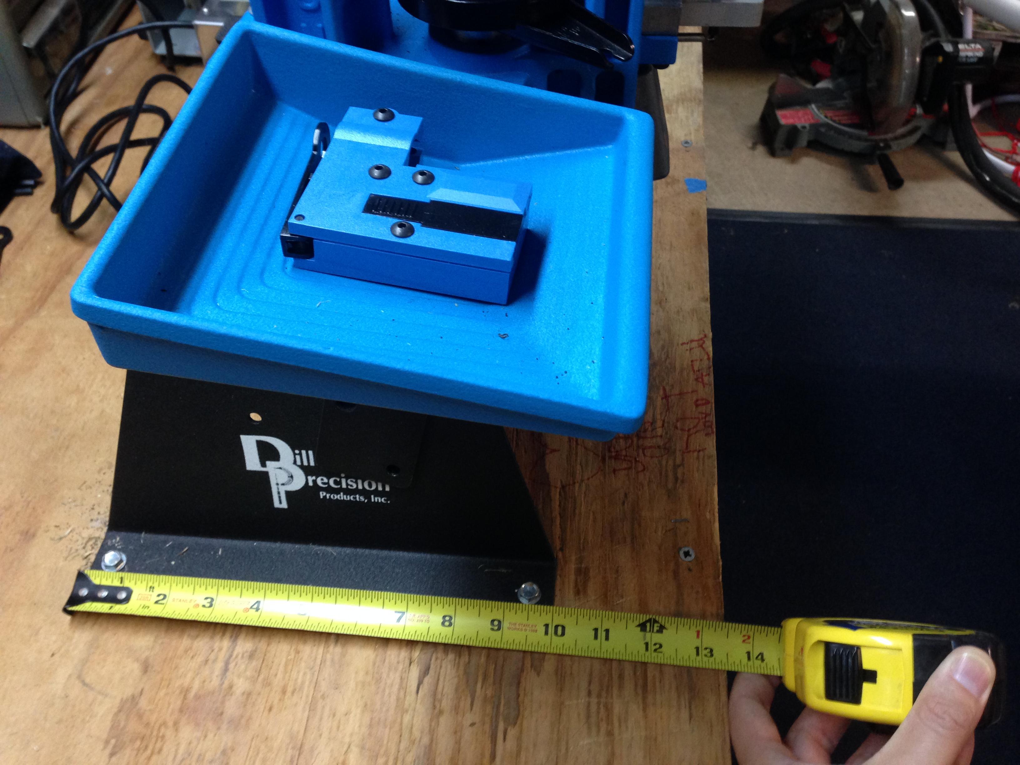

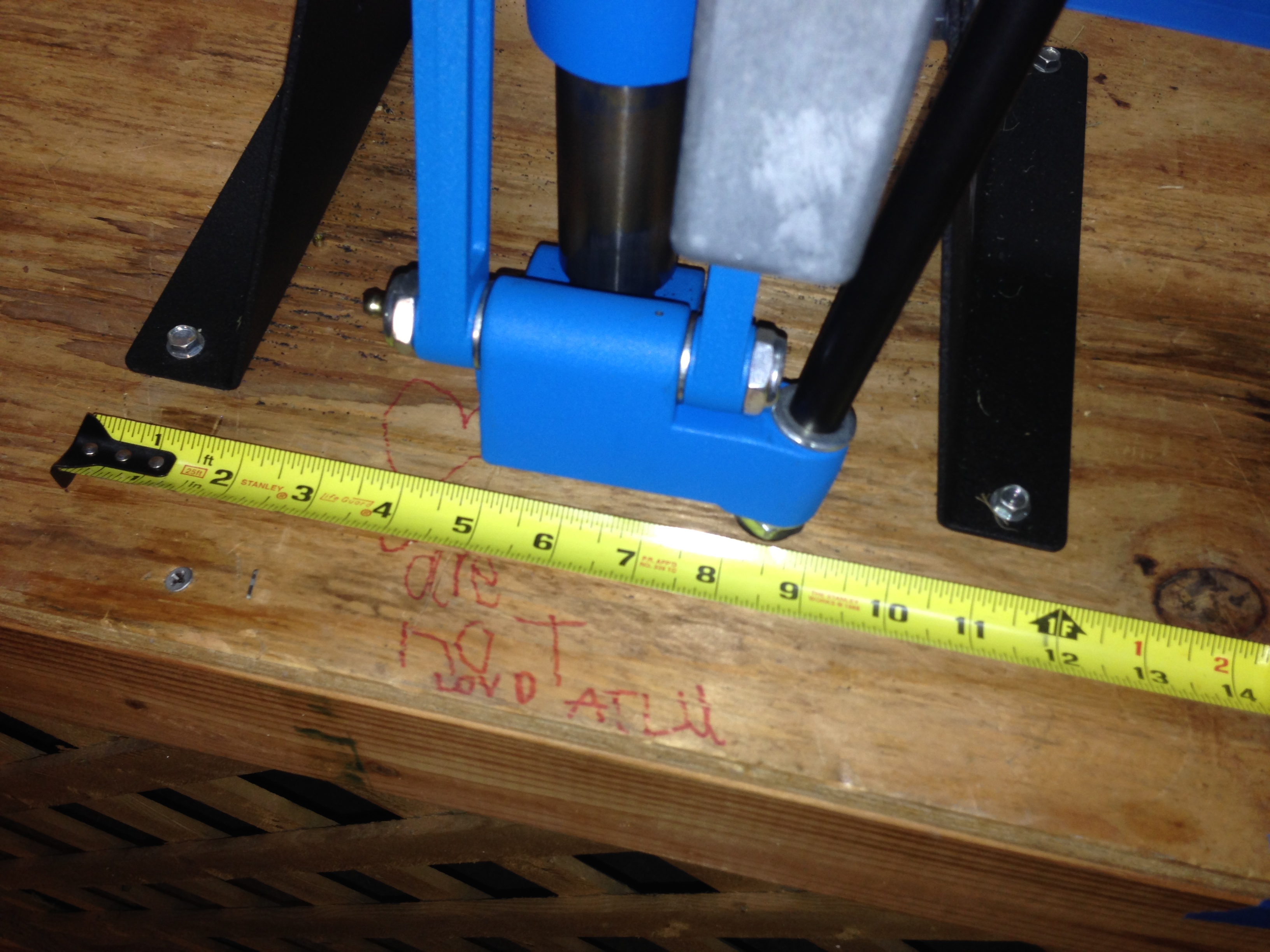

Some photos for you with a tape measure...
From the manual:
Using the machine itself as a template, mark and drill
four one-quarter inch holes in your bench and bolt your RL
550B securely to it, Fig. 1.
