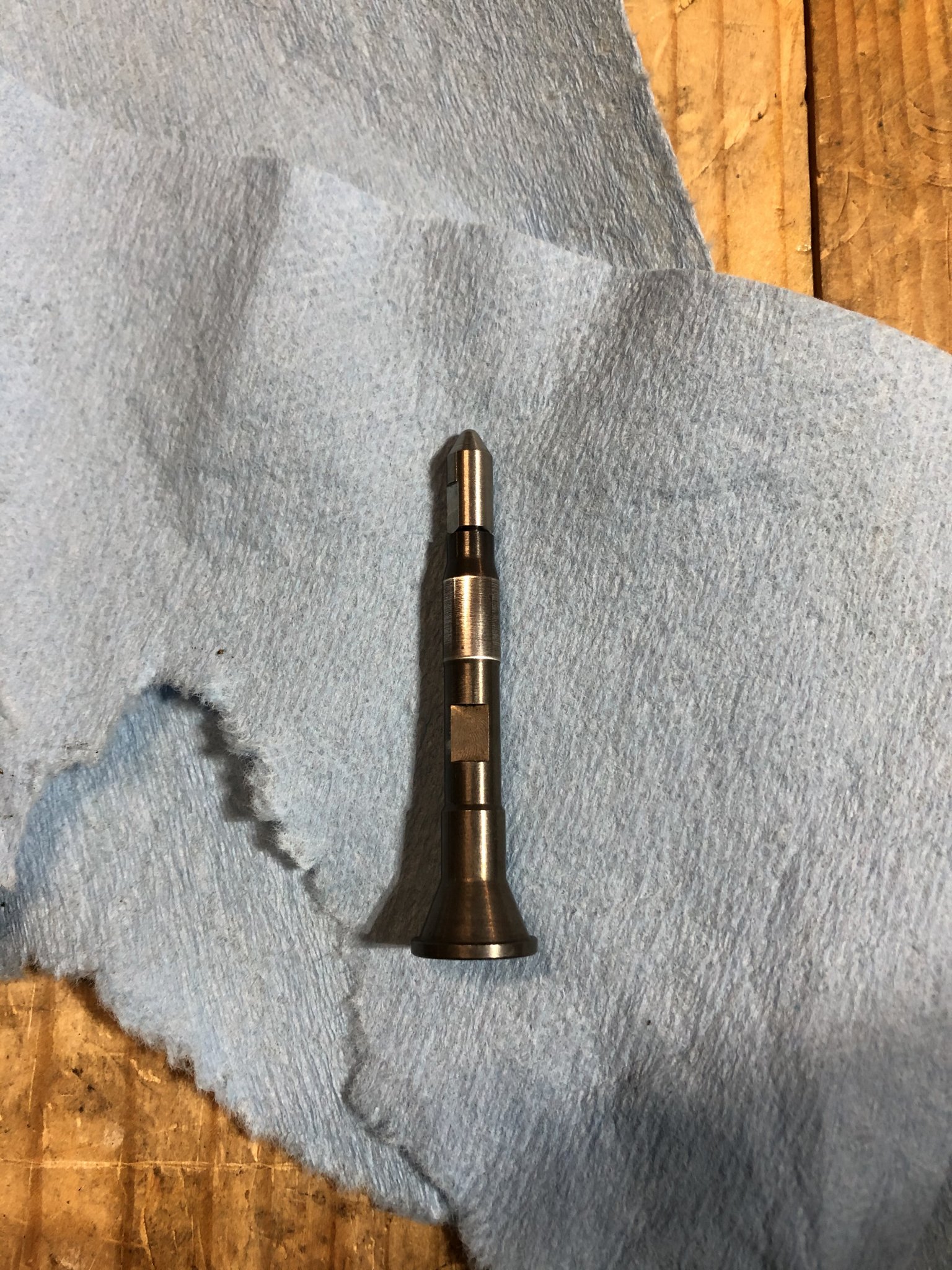

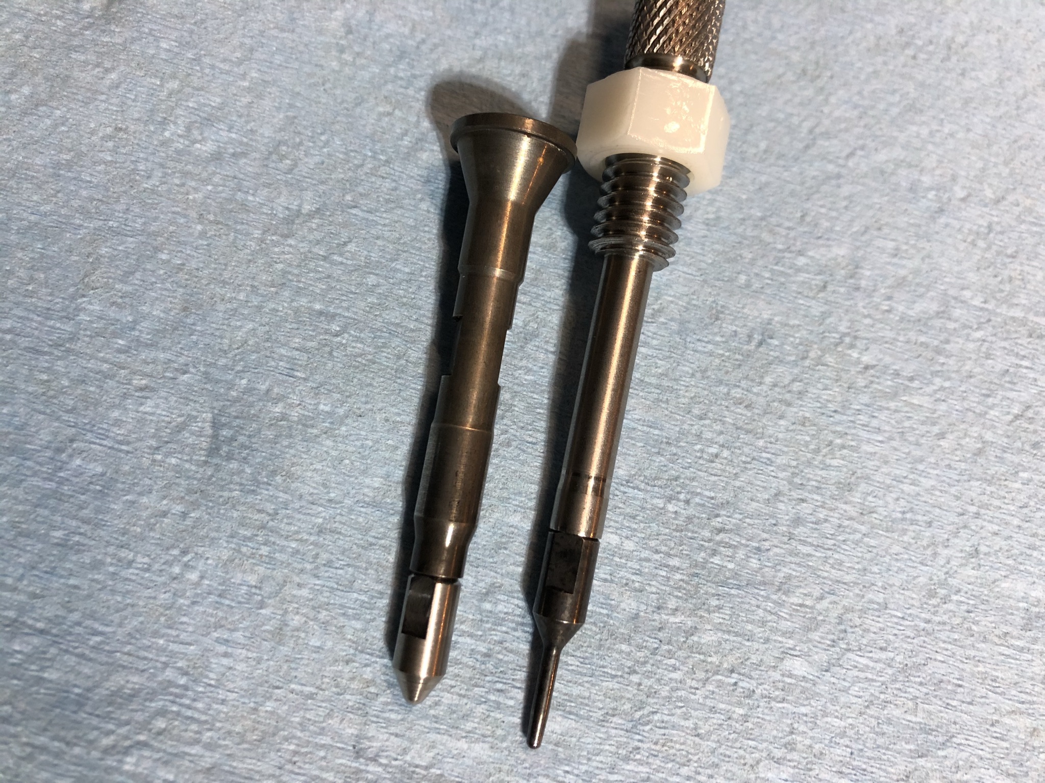

    Padom;
    No prior experience with them. It looks like the top of the decapping stem butts up against the inside of the top cap (?). If so, that would stop “Stem walk” that I have with my decapping dies that use collets to hold them in place. That’s a big bonus in my book. Seems like no matter how hard you tighten the collets, the stems eventually walk. That has been a constant source of aggravation for me.

    Padom;

    Yes you are 100% correct and I know EXACTLY what you mean with the stem walking.... So frustrating when your processing 1000's of pieces of brass on a XL650 and come to realize your decapping stem walked and half your brass isnt decapped.....grrr.. Not with the MA decapping or FL sizing dies. If your on a progressive The Blue is amazing with a sprig that kicks the primer out....
    You just 100% nailed my setup and experience......

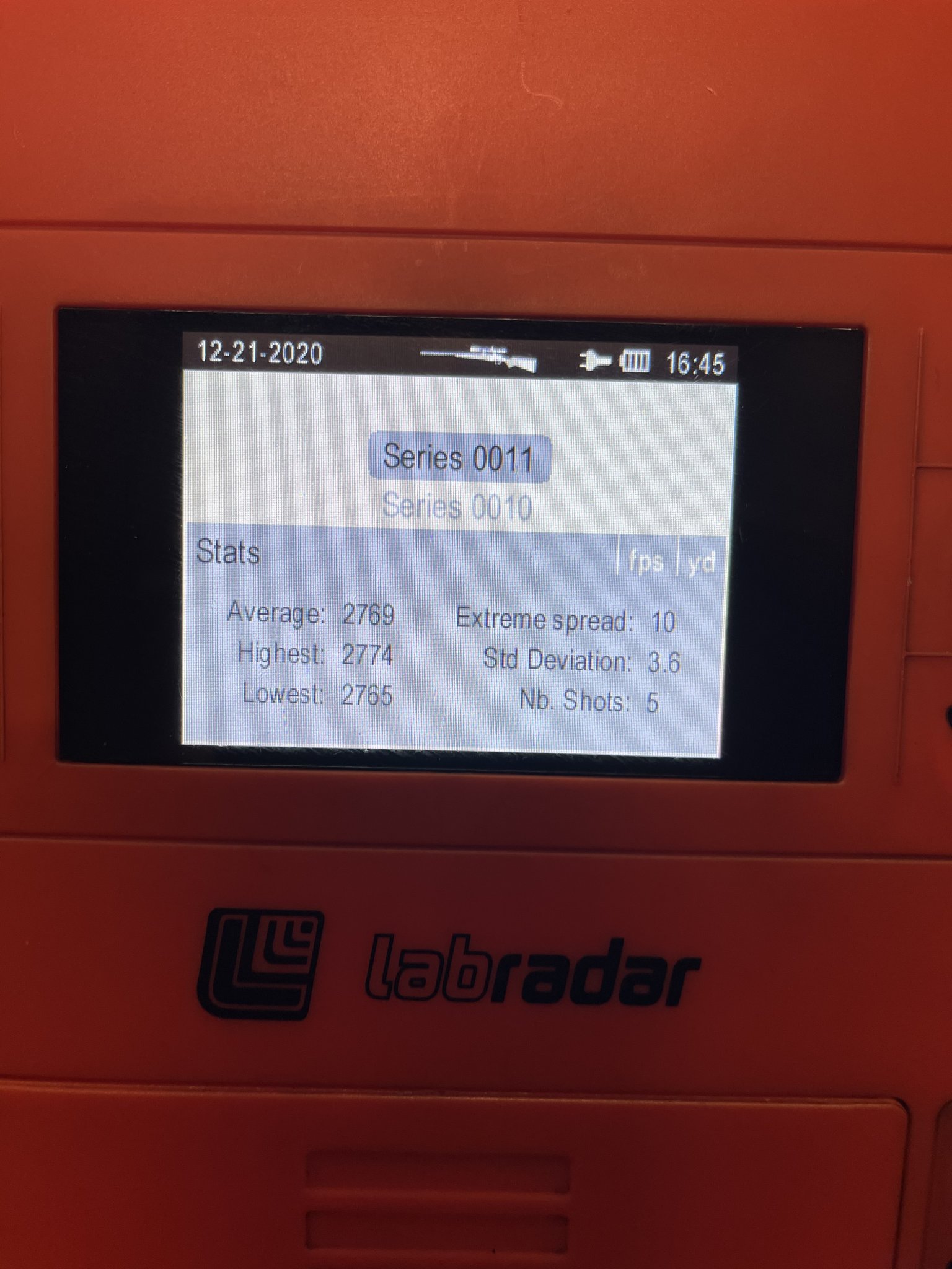

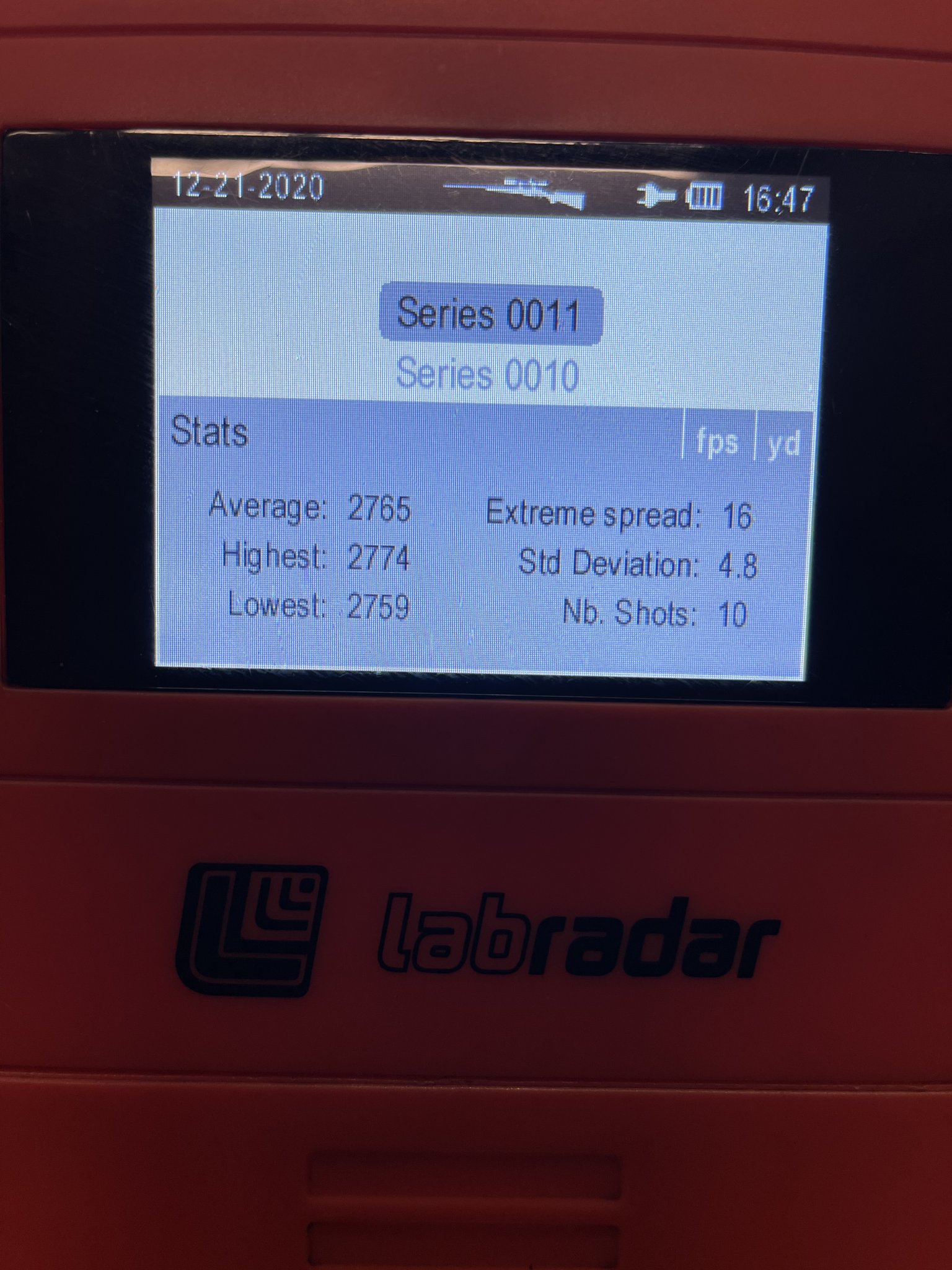

    Quick update - since I just got to pull the handle a few times, and I got a PM asking about the Flag Star Sizer...

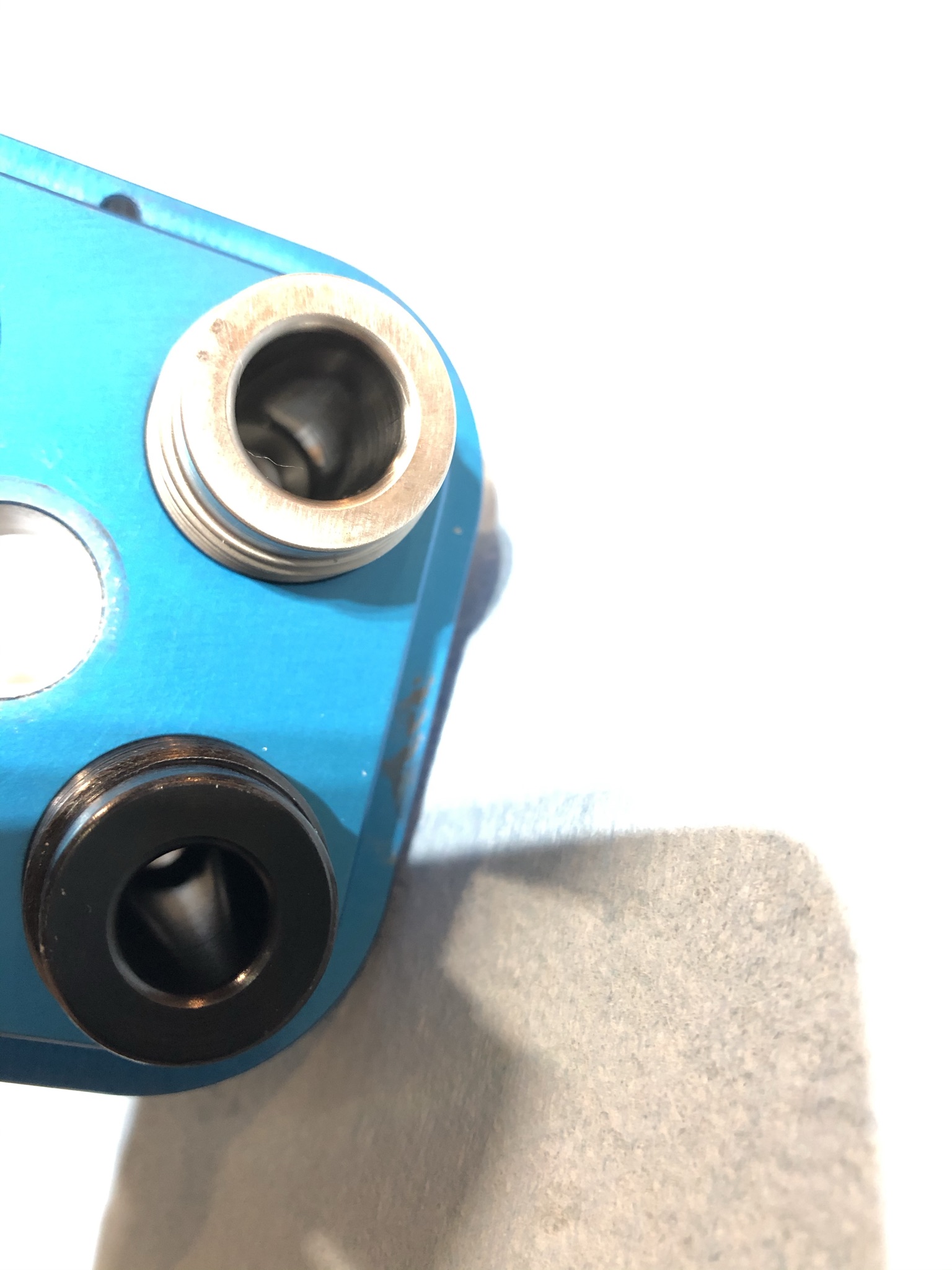

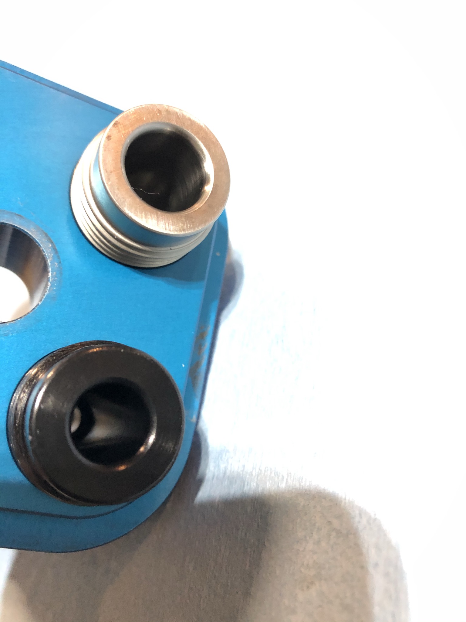

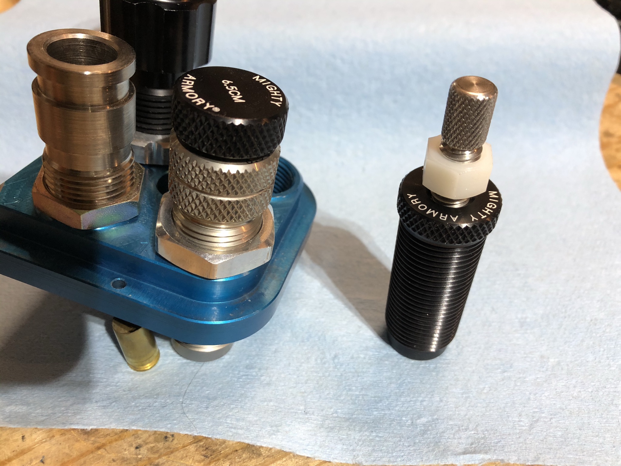

    I just got the 223 flag star sizer into my Dillon 550. Couple issues right away - Don't plan on using this with a floating toolhead. There's not enough thread left above the toolhead to use a floating lock ring, or even a lock ring and O ring on the dillon alluminum anodized toolheads.
    EDIT: The issue was running the armanov toolhead without the matching lock ring. Running a standard Dillon head - no issues at all. Update post below.
    As soon as this post is done, I'm reheating leftovers and pushing out an email to Wayne. I may be a one off experience, or I may be overlooking something in hanger, as the rest of the die is quite nice, and the Gold Medal 6,5 is the cat's pajamas.
    OTHERWISE
    I got this die primarily to run without the expander - chased with a mandrel die. The inside finish is good. It's not the mirror polish of the gold medal, but it has a black coating and sizes quite smoothly. Again, it's not the buttery wow factor of the gold medal die, but it is better than the Dillon or redding dies I was using before.
    Pictures compare the Gold Medal 6,5 Creed (left and top) with the Black Flag 223 sizer. I can provide additional images or measurements on request.
    I can't tell from your picture, can you put the lock ring on the underside of the toolhead? I have a few dies from other manufacturers that I have to use the lock ring on the bottom of the tool head instead of the top.
    Can you get a lock ring on the bottom of the die, underneath the block? Also, it looks as though you need to tighten the pin in all the way till it shoulders up better. I think the case would have an easier time if there wasn’t a gap there to get caught on.
    I could, but that defeats the purpose of the armanov toolhead.
    I took that picture before I put the die together - I did notice that and tightened it before I started. It is not loose. There is still a lip prior to the taper and the taper is extremely short. If I pull the squished cases and put the decapping rod into them - they all catch right where the decapping pin threads in - there's a definite lip there.
    I conversed with Wayne back and forth for 3 or 4 emails and he was very quick to respond and answer all my questions.
    I have been using a Redding Comp die set with a bushing neck die and body bump die, with excellent results, but adding in an expander mandrel for final sizing and I was just pulling the press way too many times to make a cartridge. Especially if I decapped before annealing. The thought of cutting out those extra pulls was very appealing.
    I will say I have not emailed Wayne about this, and it’s not my intent to point fingers at the die. It’s a very stout unit and a very nice design. I’m still in the problem solving phase and hope to not even bother Wayne at all. Especially being cross border.
    The first anomaly was that the die bottomed out on my shell holder before I could get my .002” shoulder bump that I do with my Redding die. No big deal. I faced .020” off my shell holder and got the bump I needed. The die does run extremely smooth and measured concentricity is every bit as good as advertised.
    The issue I’m still troubleshooting is shoulder sooting that I’ve never gotten with any factory ammo or ammo I’ve made with my previous die setups. It’s weird. I have the same headspace measurements that I achieve with my Redding die. I even used two different size comparators to check different datum on two cases sized with each die, and they’re the same, so it’s not a shoulder angle issue. I thought perhaps because the Redding neck bushing die doesn’t size all the way down the neck, and the body die doesn’t touch the neck at all, maybe that unsized portion was acting to seal the chamber, and the new die was sizing that portion now, but if it is, it’s only minutely, and not an amount I can decipher with calipers. Also, factory ammo has never sooted the shoulder. I thought maybe because this brass has been sized with the Redding dies so many times, perhaps I should just keep them married to each other, so I shot some Berger factory ammo and resized that with the Mighty Armory die, but it still neck sooted. Research says my loads may be light, or my brass may need annealing. I’m running 42.5gr of H4350 behind Berger 140 Hybrids and running 2820-2850 FPS, and anneal every firing.
    I have two more things I want to try. Removing the expander and running my previous mandrel through instead. Maybe the expander is pulling on the shoulder and causing some weird change in geometry that I can’t determine with my caliper, and I want to try a different chamber with once fired brass then run through the Mighty Armory die.
    I know that if I email Wayne he’ll have suggestions for me. I don’t doubt his level of service for a second, but I pride myself on being a problem solver of these sorts in my day job, so I can’t throw in the towel yet.
    All that said, I cannot say definitively that this shoulder sooting is even an actual problem. My ES are greater as one may expect with more pressure leaking back behind the case mouth, but out to 300 yards, I haven’t really measured much of an accuracy difference.

    I had a great phone call with Wayne from Mighty Armory today – I’m up and rocking and rolling with the Flag Star. There’s some misalignment when you run a no-play toolhead without the floating lock ring, and that was causing the case to enter the die off center. Returning to a standard Dillon toolhead with a little bit of float got it running smoothly.
    I’m now running a very consistent shoulder bump – seeing +/- .0005 on shoulder bump and pin gauges are showing a very consistent .221 inside neck diameter (the expander is .222, so I’m seeing 1k springback with 4x fired and not annealed brass).
    Also, now that I’ve pulled it some- this thing is a smooth sizer.
