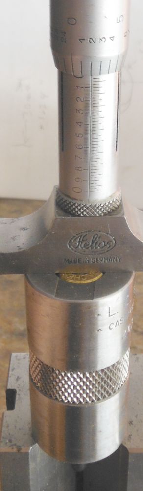

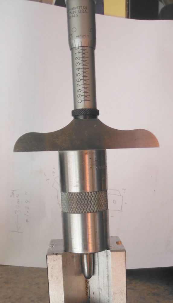

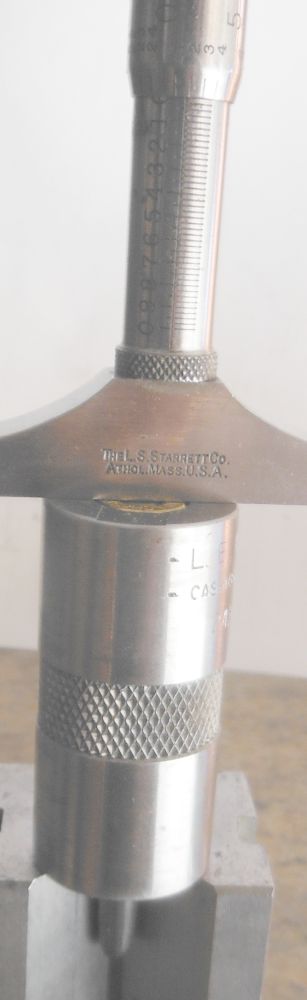

case gauge and depth micrometer measuring case head space c 7-11-2014.jpgcase gauge and depth micrometer measuring case head space b 7-11-2014.jpgcase gauge and depth micrometer measuring case head space 7-11-2014.jpg
Can you accomplish what you want with a Wilson case gauge and use a depth micrometer to measure the case head space, and go gauge as your standard?
A case gauge is $26 and a go gauge is $27. This is a cheap way to measure.
For this post I tried a loaded round with 3 different depth micrometers and all of them said the same loaded round was 0.002" down from the top.
I dropped a 1.630" Go gauge in there and it measures 0.004" from the top.
So the round I loaded must be 1.632" case head space.
So if the 308, 243, etc ammo is supposed to be between 1.627" and 1.634" per SAAMI, then that round I loaded was 1.632" or .005" longer than the min and .002" less than the max.
