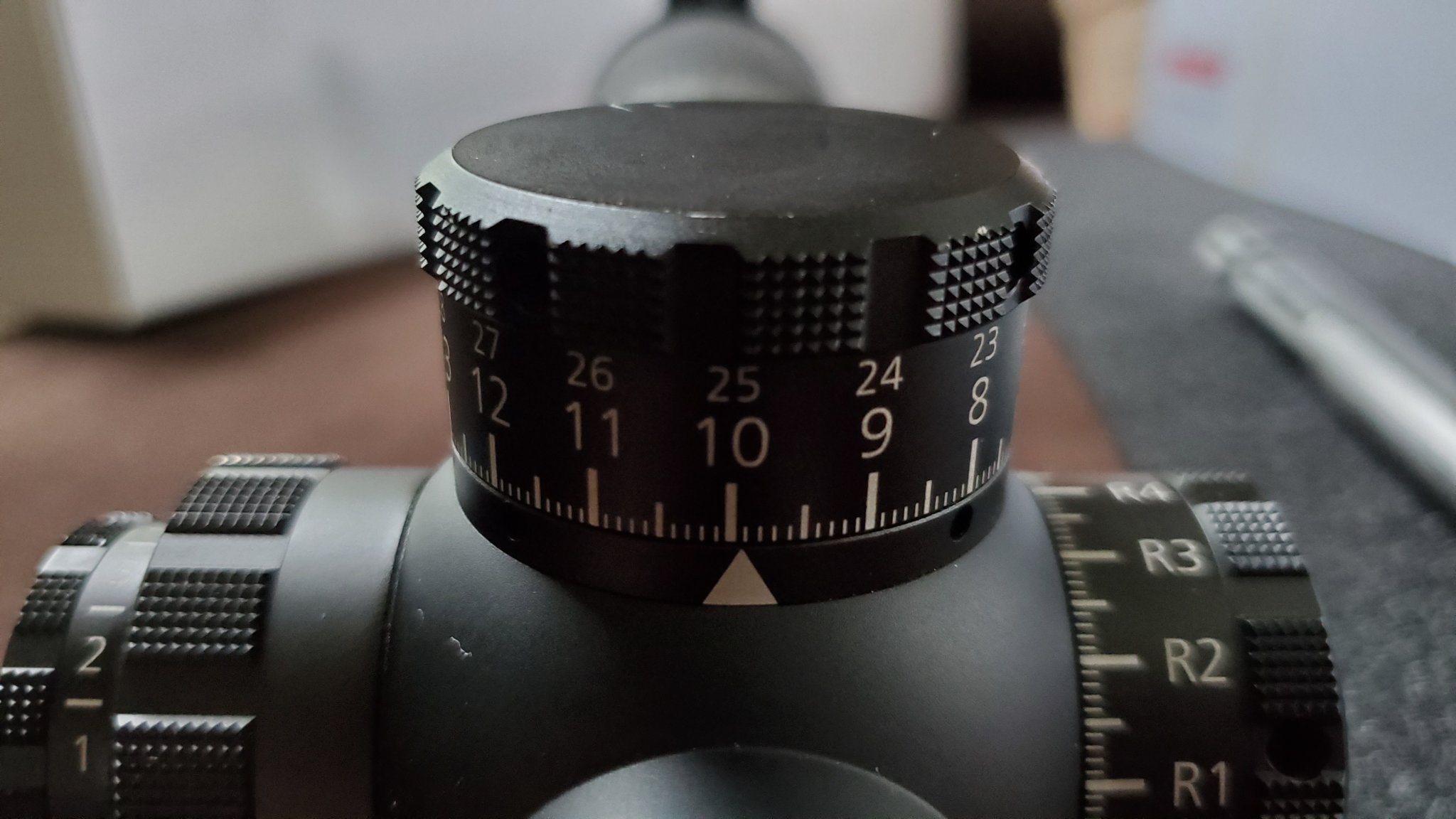

I picked up a used ZP5 off the PX here, initial impressions are good except for a few areas.
The parallax seems to have been ruffed around a lot and the knob has a very slight bind in it (what I'd expect in a used scope I guess) and the parallax doesnt seem all that forgiving but it does work.
But the main issue I've noticed was the turrets dont always line up with the corresponding hashmarks. It looks like the previous owner learned to live with this and slipped the turrets so they were offset ever so slightly when zero'd leaving the indicator arrow dead center when further on in the first rev.
I slipped the turret to line up perfectly on zero. I start to see it wander at 5 - 5.5 mils and at 10 mils lines up with the 9.9 mark (yes, I counted every click).
Anyway all this to say, have you guys seen this before? Was there anything you could do to fix this or was Minox/Blaser willing to fix this? I've emailed and called them but it seems no one is home. Which is understandable. I hope its user error but I dont know...
If I have to live with it. What is the best strategy? Do I just shoot my dope? Or enter the offset into my software?
No tracking test just yet.

I took one more picture of the turrets set at 10 mils.

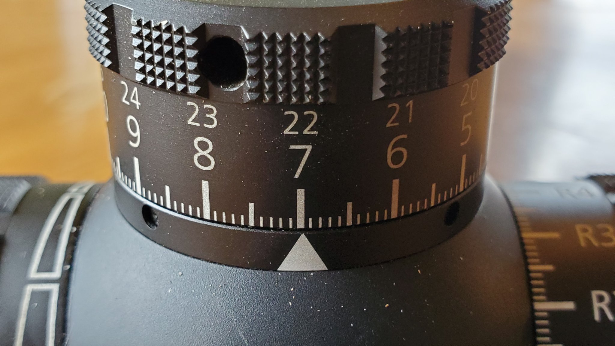

That is 7.7 mils on mine. Yes it’s slightly off on the indications but it’s not like I have zero clue where it is, the scope tracks fine besides that. It slightly bugged me at first but it dials true so I just moved on

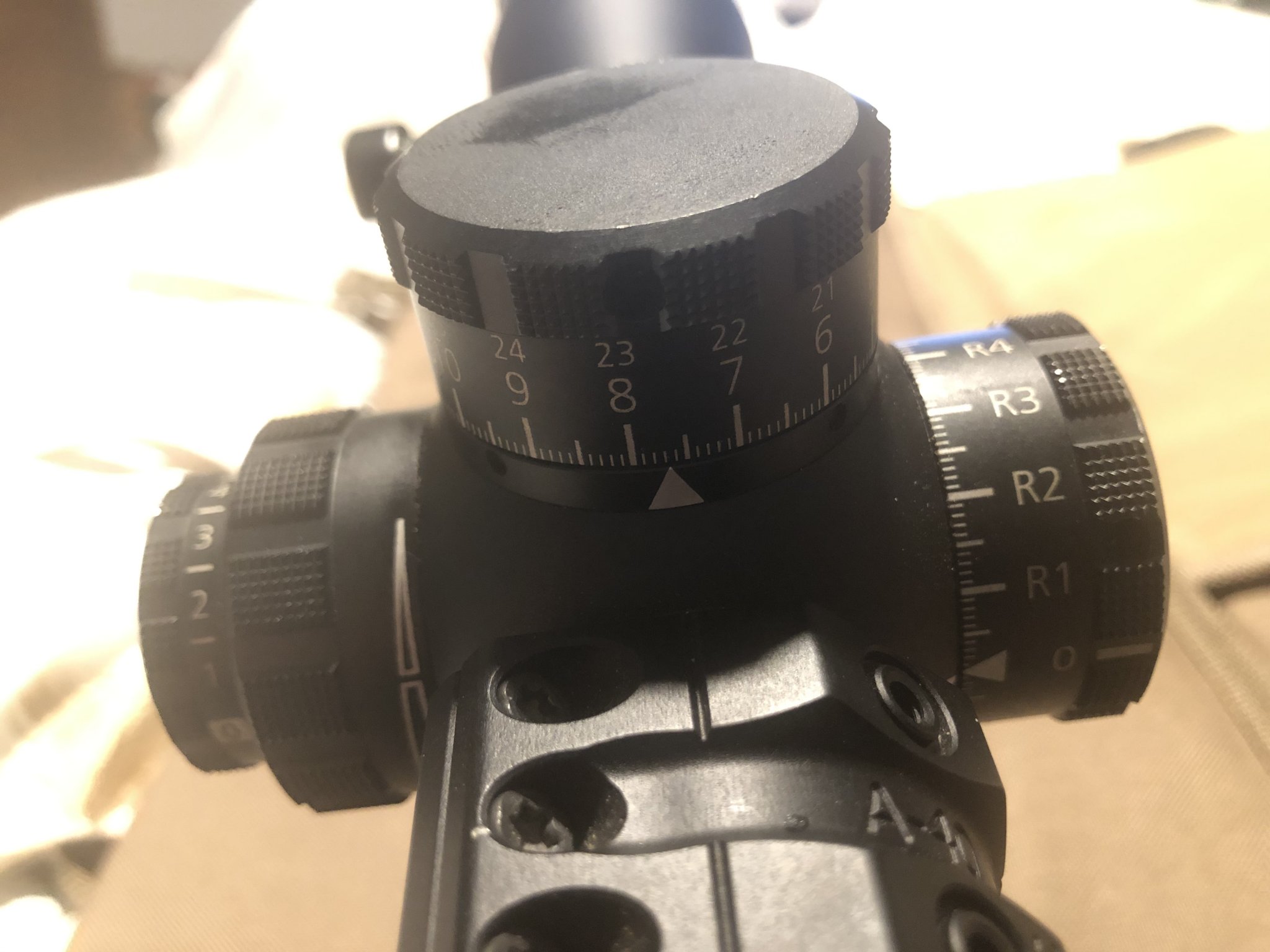

I would guess that this has nothing to do with tracking- or turret quality but is simply the result of the laser engraving, where the cap was not aligned perfectly on its axis.
Many other manufacturers reduce the effect by creating some distance between the 2 indicators or are trying to avoid the whole problem with differently shaped indicators. (like dots for example) A triangle right next to the line just makes it very obvious if something went wrong.

Send this pic to Blaser and see what they say

To the OP. Losen the set screws and tighten them back in small increments. Sometimes if one is tightened down too much first it can tilt the cap (like on the mk5s) and it will be off at some point in the rotation.
I had one that was a little off. I pushed the cap all the way down when tighting the screws and then it was lined up perfect. Could be something simple. Dial up a few mils losen screws and rezero it. Tighten and see what happens. I wouldnt just send it in just yet.
