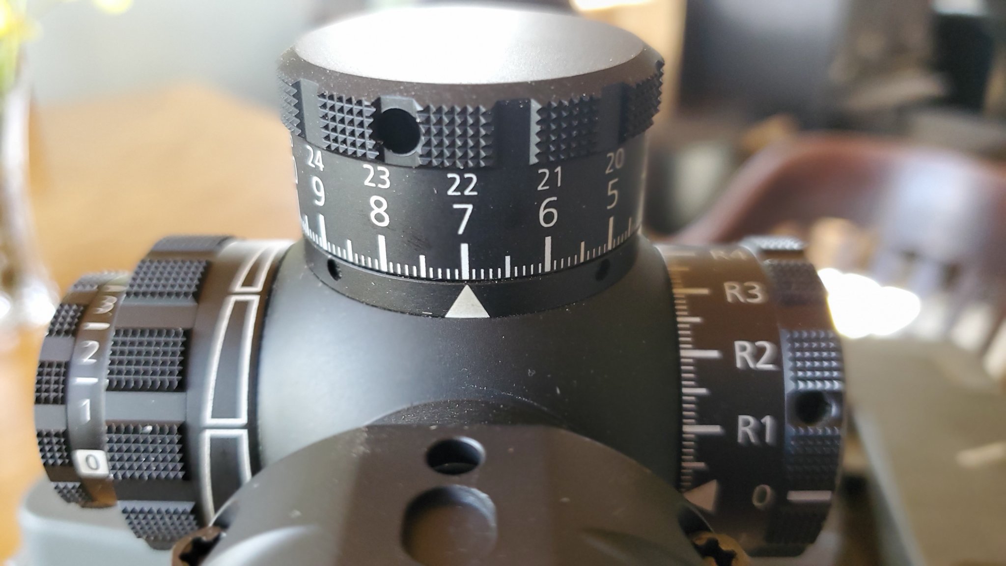

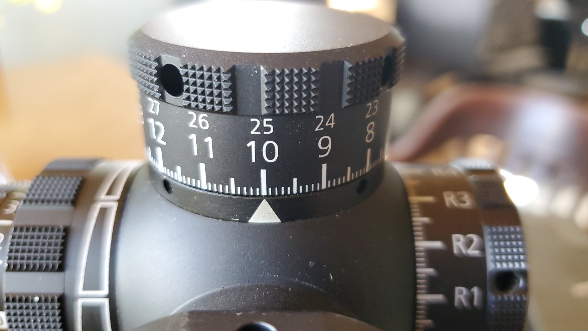

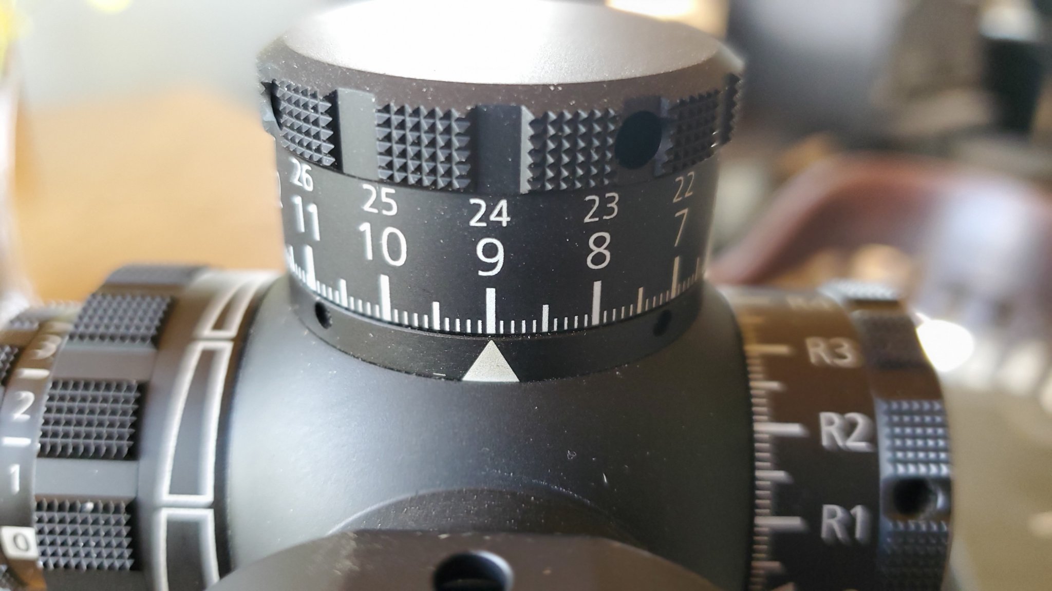

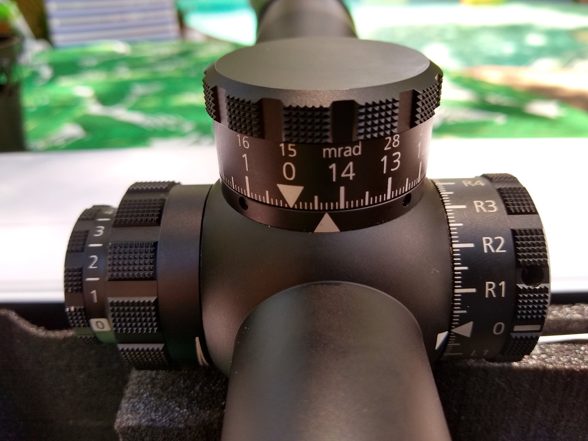

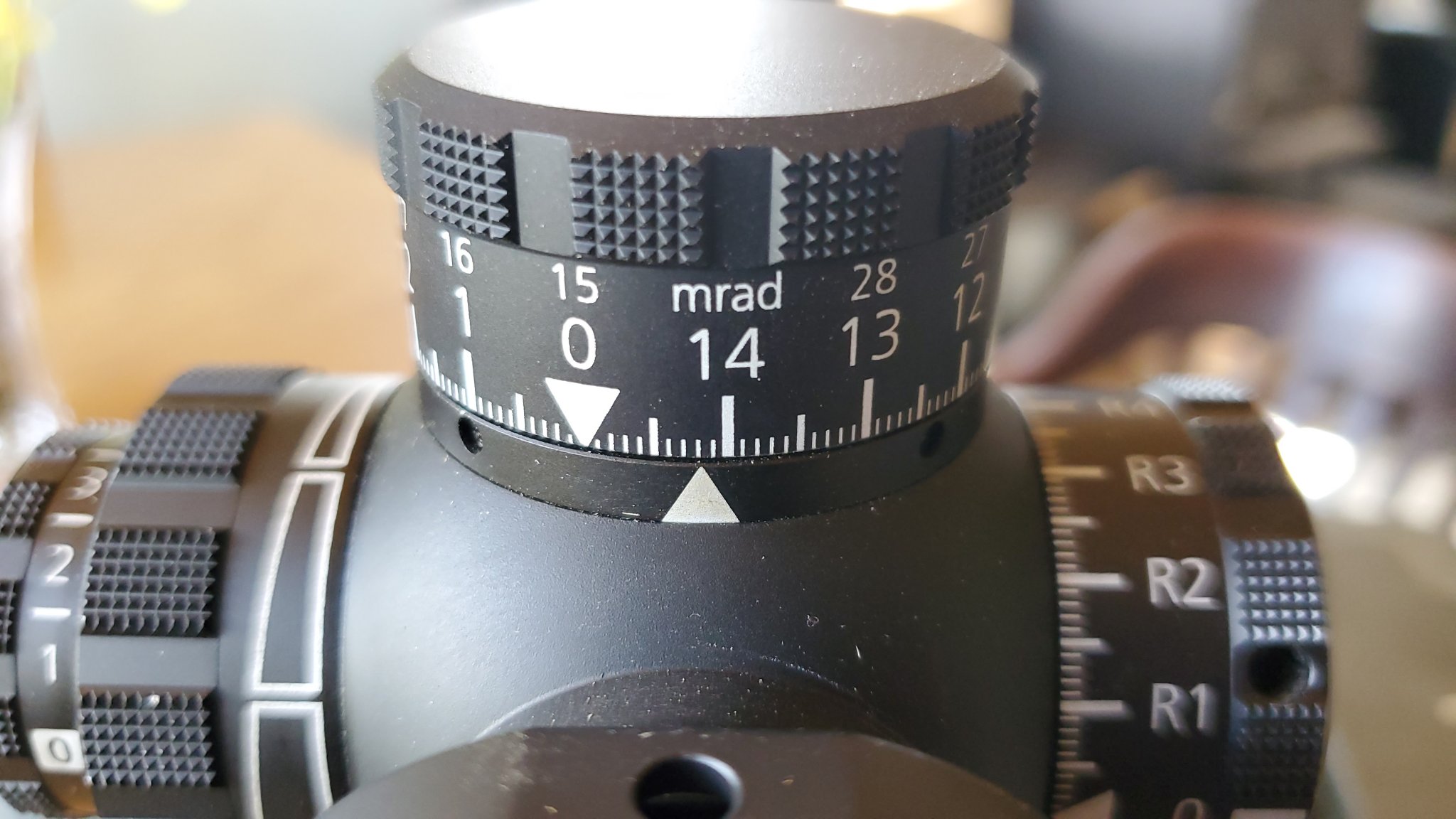

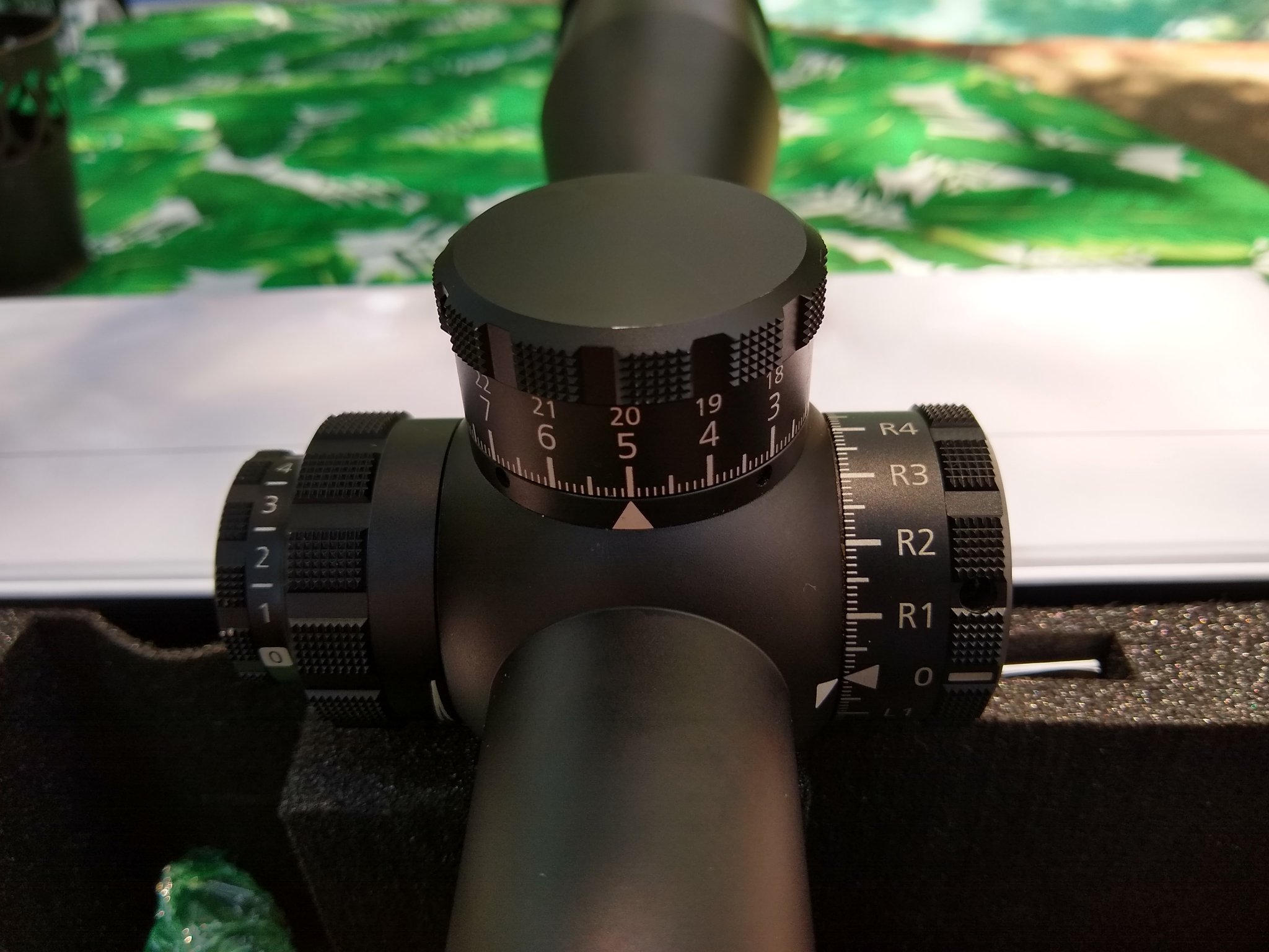

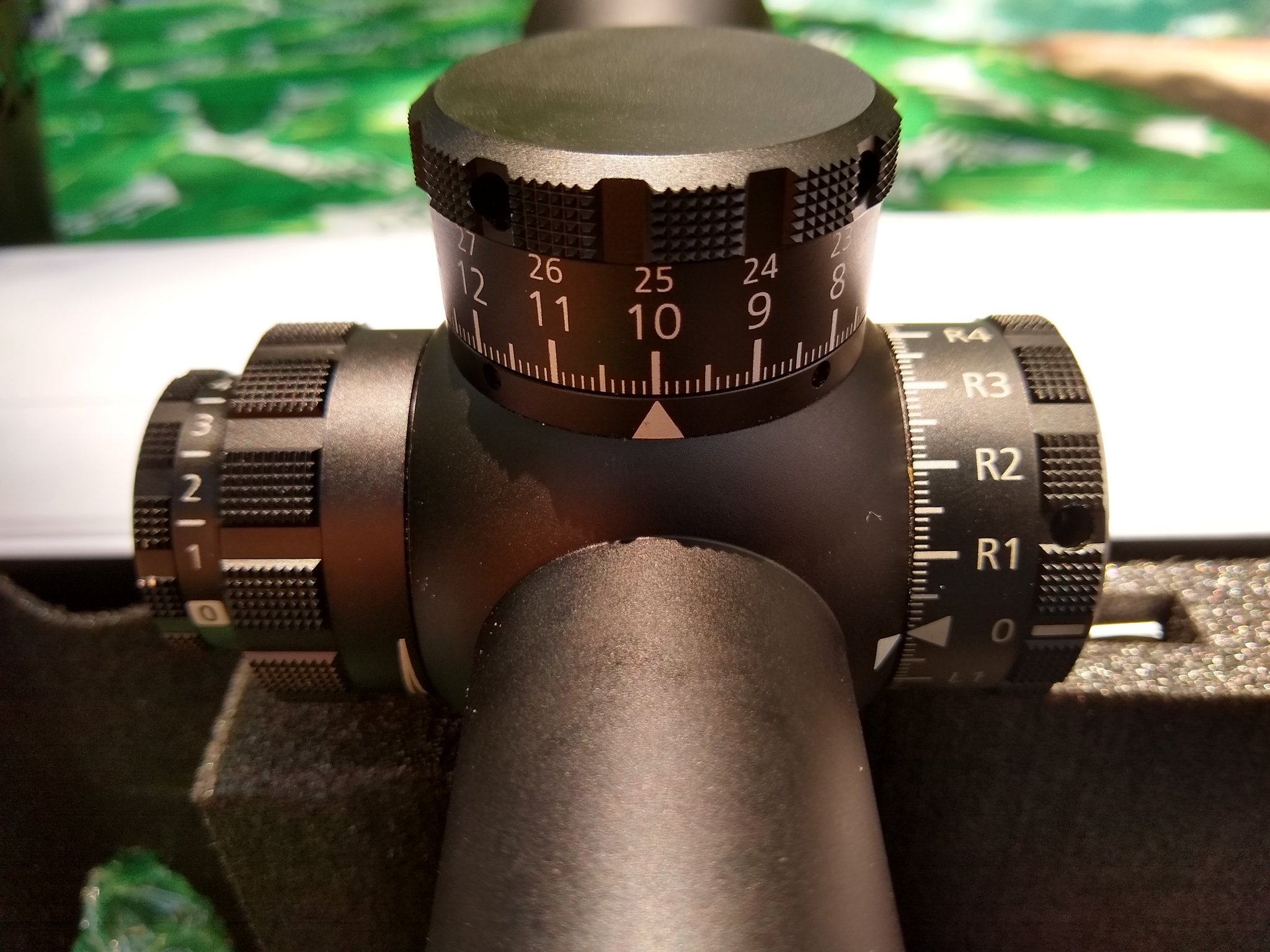

Finally got home to check my ZP5. White box version. Photos taken of alignment at 0, .7D zero stop, 5 mil, 10 mil, 15 mil (0 second rev), 20 mil. I have no alignment problems and this is what you should expect to have.
The elevation is extremely positive and I quite like the feel. The resistance into the second rev is a touch more stiff starting at 13.7 ending at 14.3 then back to normal.
The windage turret is a little less positive but not what I would call mushy. Not quite as loud as the elevation but I don't plan to dial wind that often.
My illumination knob feels similar to how you describe yours.

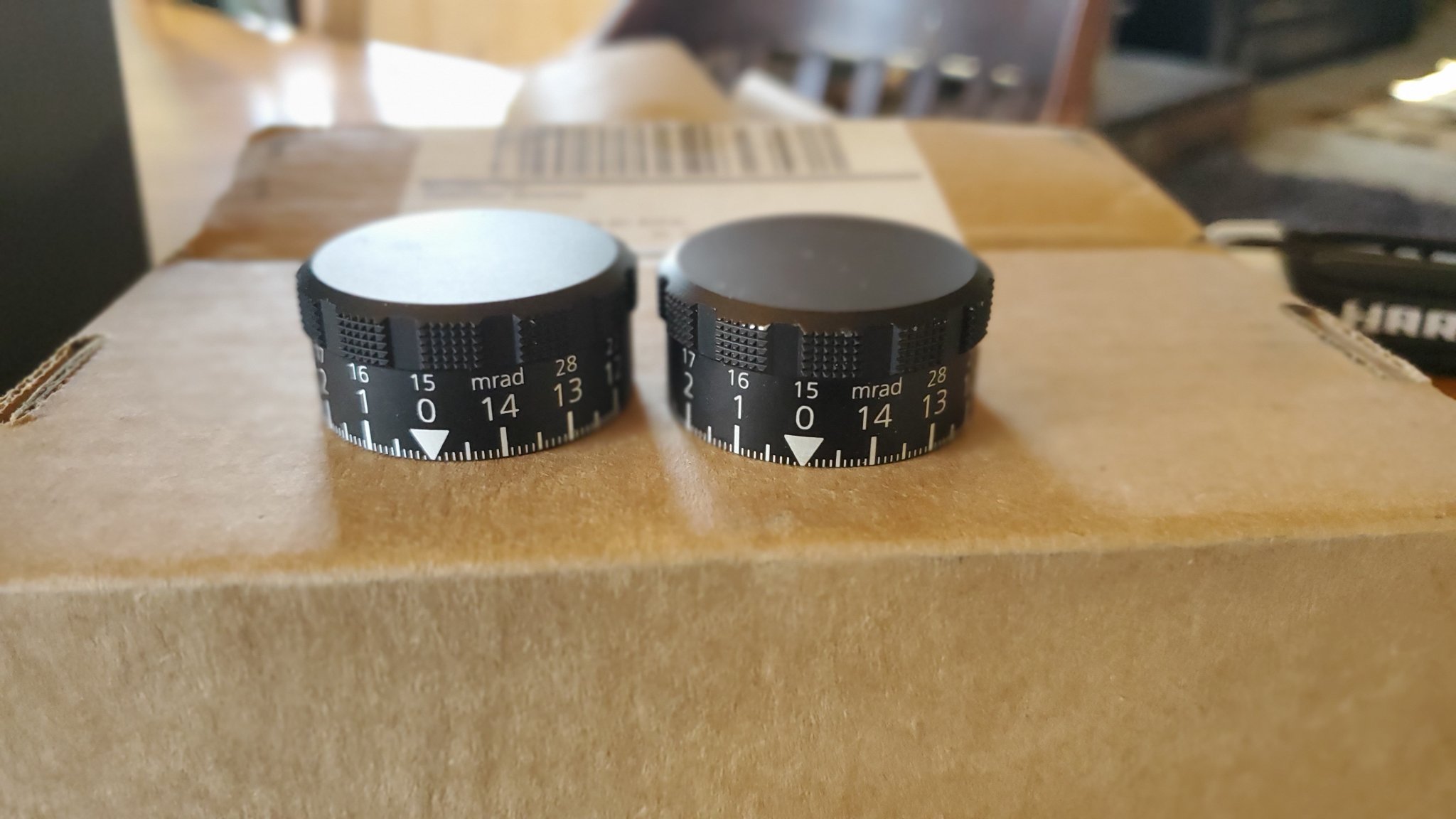

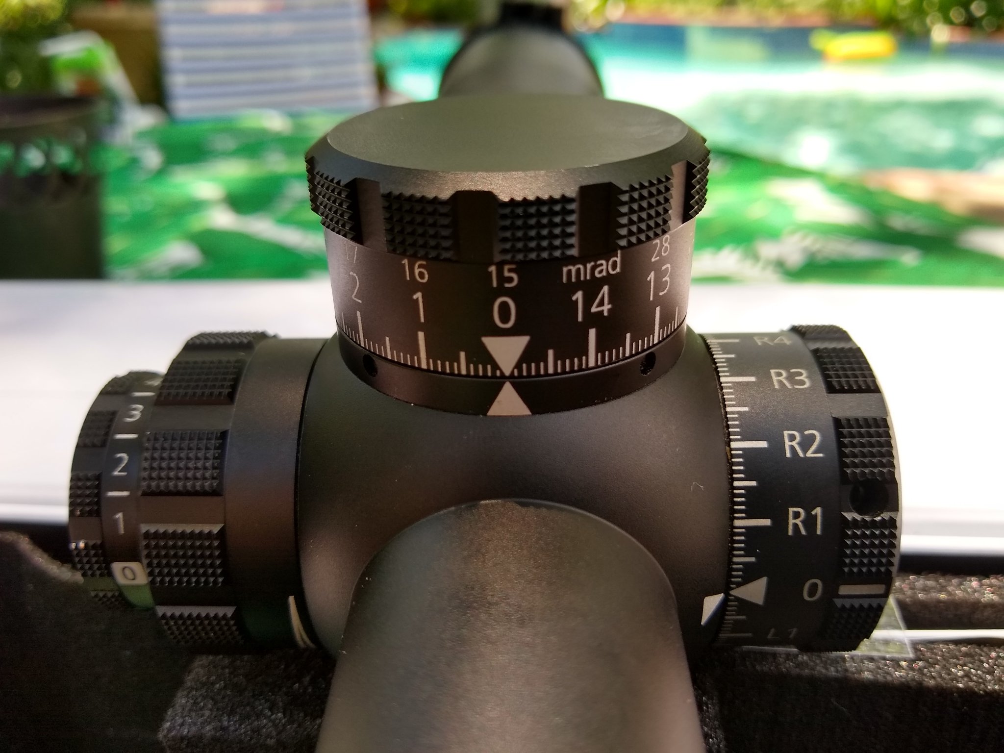

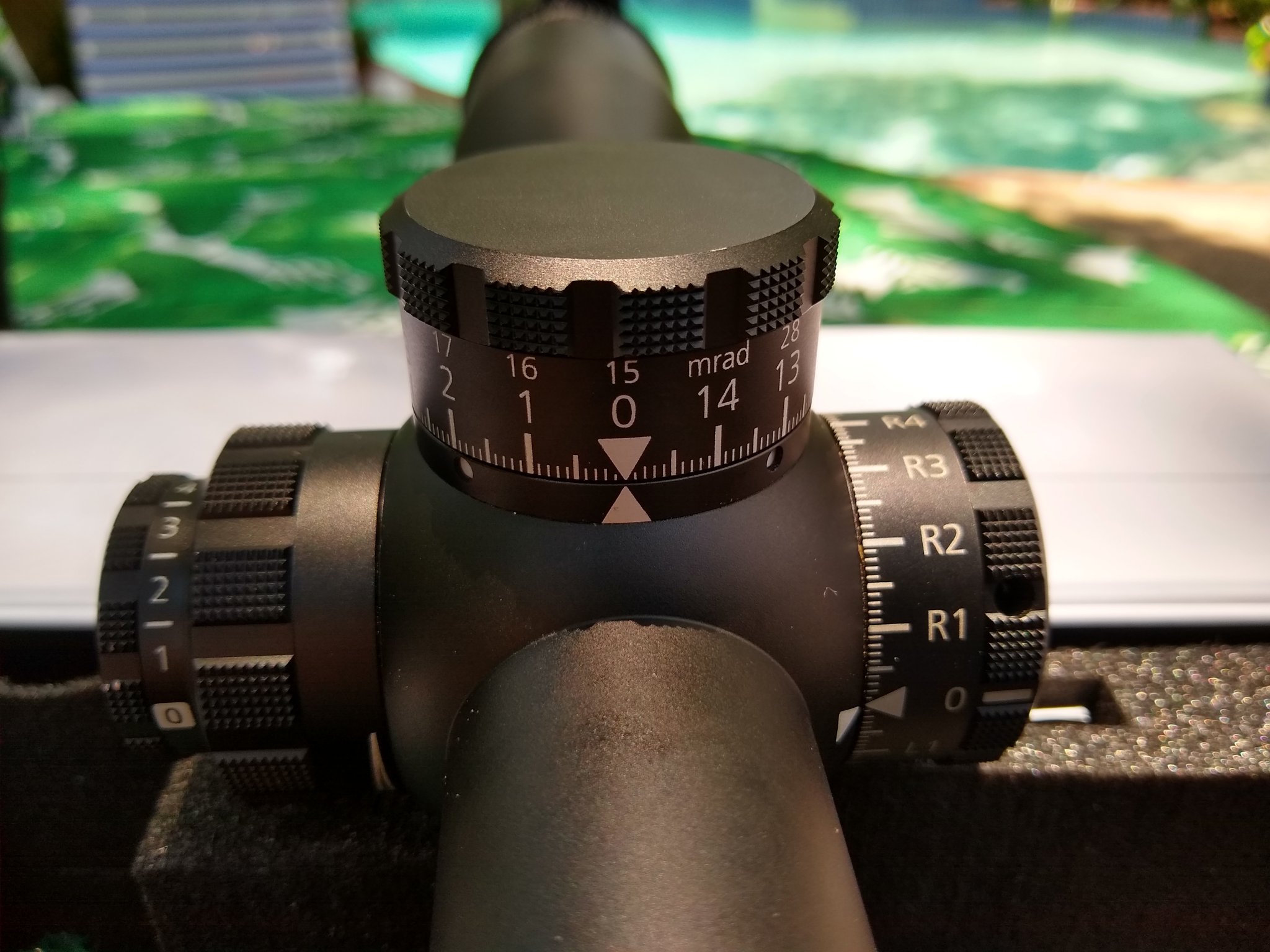

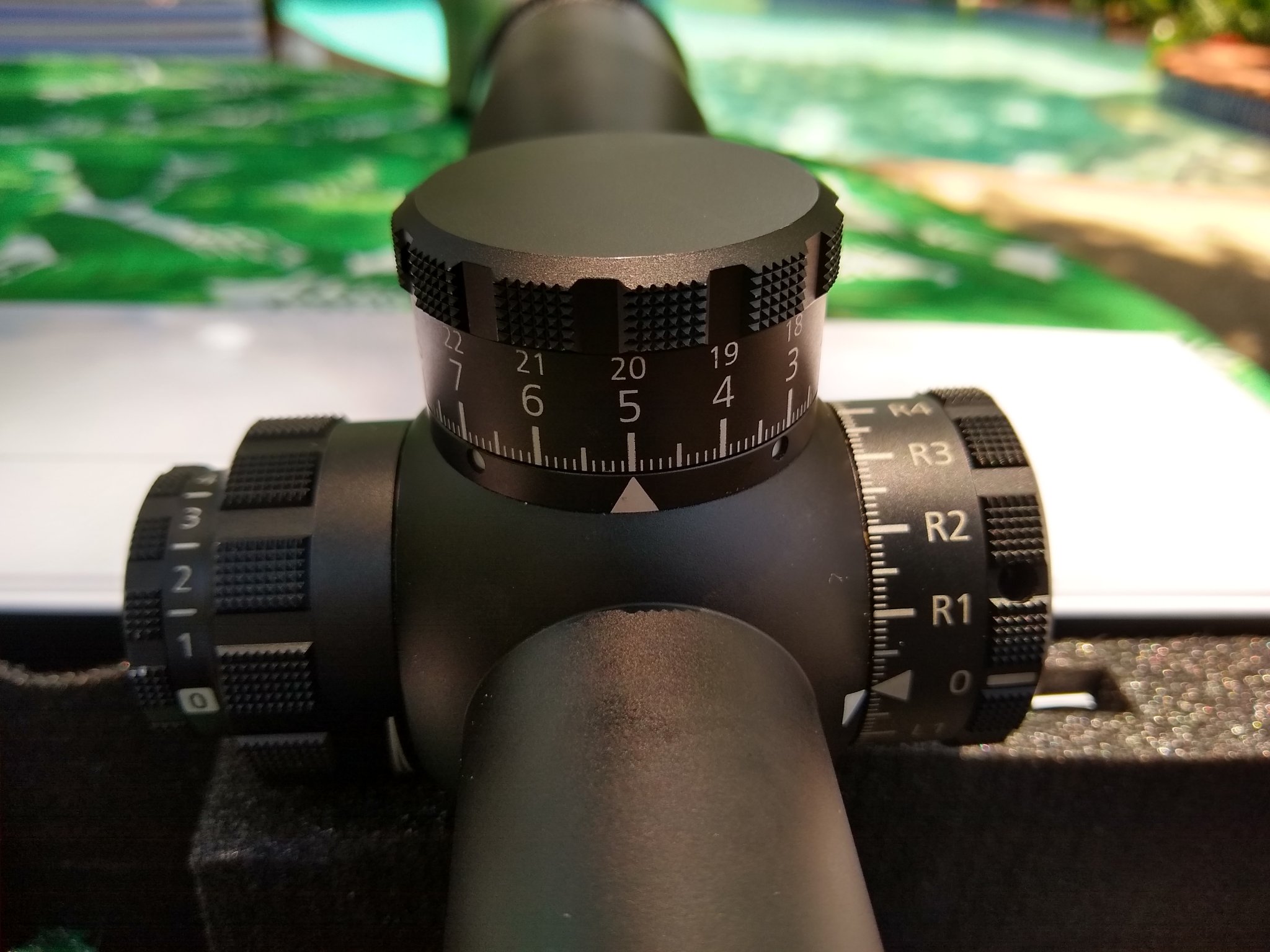

Turret just showed up! Installed it with no issues. And here are the results!
Only came with one set screw ( odd but fine) and markings look a bit more vibrant.
New cap on the left.
Zero stop is at -0.8 mils, old was -0.7 (again just fine)
And the important part!
Looks great!
Thanks guys for all the help! The minox boys were fast and now that I think of it there was no proof of ownership.
Looks great!

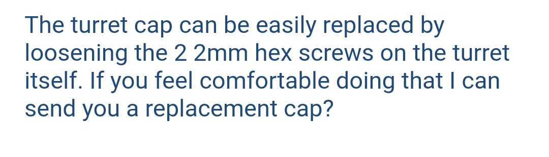

That's fantastic news, and thrilled it was simply a printed turret housing issue and not an issue with the internals!
So I tried reaching out to Yim at blaserusa because she was so helpful before about possibly replacing the elevation turret, but apparently the customer service on a 3k optic stops there because I was referred to their service request for on their website. Guess it's off to Germany. :\
Contact the service department and inform them what is happening. I emailed Blaser USA telling them about the mis alignment and that the scope is in otherwise perfect working order. Got an email the following day that a turret would be shipped over from Germany in the next order, don’t know how long that will be, but feel like the customer service was very responsive and fast.
