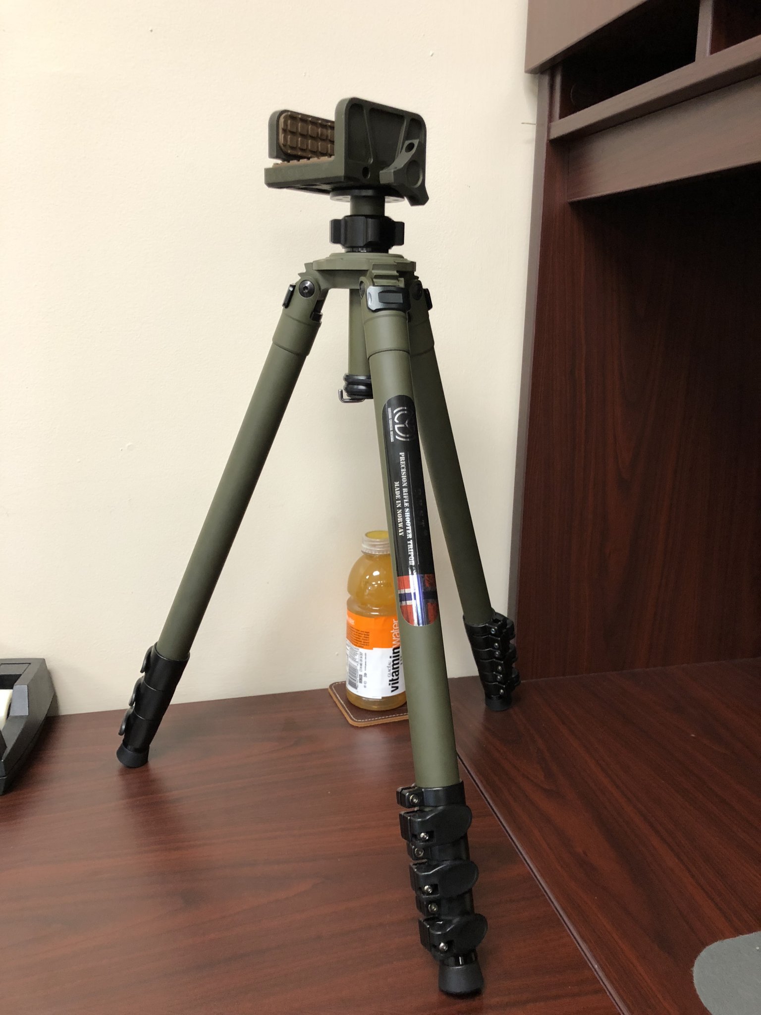

    Got it in today, overall looks to be solid. Will update once I get some more time to play with it.
    Reactions: sd0311msg
    How heavy in that configuration?
    I don't have a scale, should have weighed it while I was at work. Based off the website specs:
    4.1lb- prst tripod
    15.8oz- hog saddle
    = 81.5oz / 5lb
