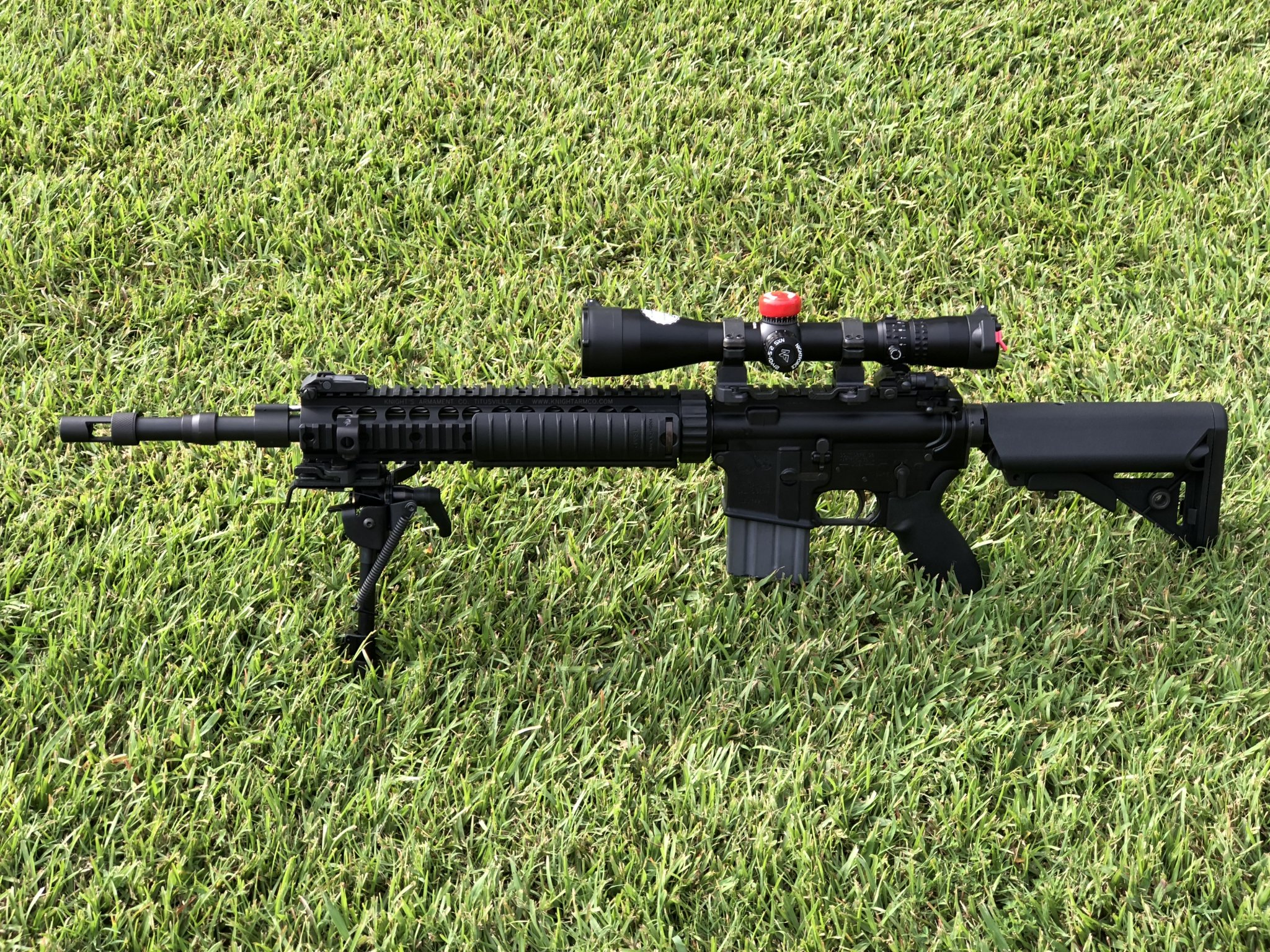

Not trying to steal any thunder from ARFCOM, but I can't hardly stand to get on there anymore. Figured there may some interest in a MK12 picture and discussion thread on here. I'll start:
Lower: Nodak Spud M16A1 'black' lower, Geissele SSA-E trigger, Colt A-1 grip and stock (trapdoor), Fulton Armory A1 extension with buffer and spring, Colt no-tic safety selector, no name milspec LPK
Upper: Colt AF forged M4 feedramp upper, tear drop FA, PRI Gasbuster charging handle with .mil big latch. Colt BCG. A.R.M.S. #40 rear with bonus point wingless swan logo, A.R.M.S. #38 SPR-PEQ 2-3 rail, Douglas barrel 1:7 twist, PRI milled flat flip up gas block, Colt gas tube, A.R.M.S. #22 M rings, Leupold MK 4 2.5-8 M/RT with M2 dials. Actual old stock Ops brake and collar. Allen Engineering AEM5. KAC bipod adapter with Harris BRMS and pod loc. KAC sling mount with Uncle Mikes sling stud. Oh and a A.R.M.S. TRC ring cap and rail.
This is my best effort at a late gen Mod 0. Big upgrades would be a Colt M16A1 lower (my birthday is coming up if anyone is feeling generous) and the original OPS 12th can.

You forget the Duct Tape and Foam Cheek Rest. ???
I've always had a special kind of Love for the MK12 MOD 0.

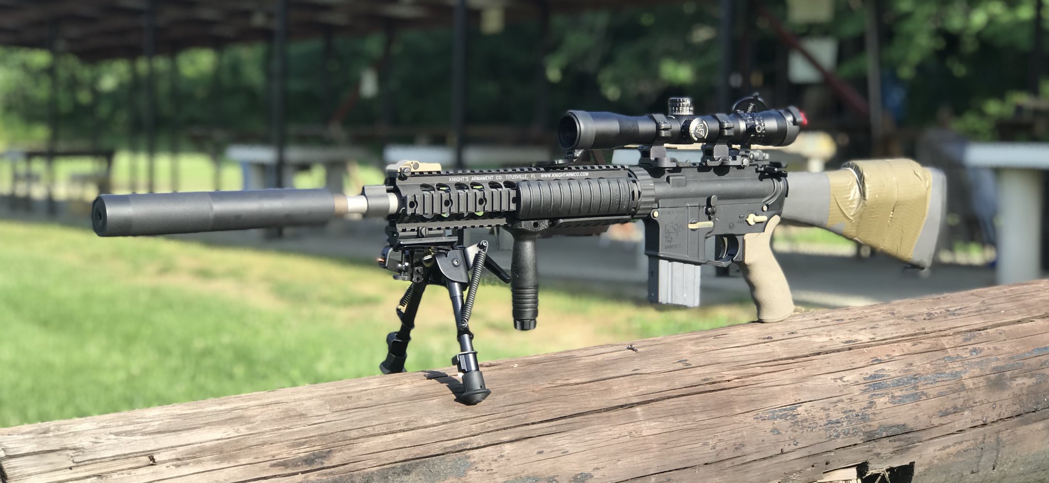

Nice, are the Mk12's cousins allowed? Here's my Seal Recon Rifle. Probably my favorite AR I've ever had.
Colt lower and upper guts
Gen 1 LMT SOPMOD with KAC QD
KAC Medium FF RAS
Lilja Seal Recon barrel with Mk12 gas block and KAC M4QD
NF 2.5-10x24 in a NF 20MOA Unimount

Can’t see the pic, but I’d like to lol. How’s that Lilja shoot?

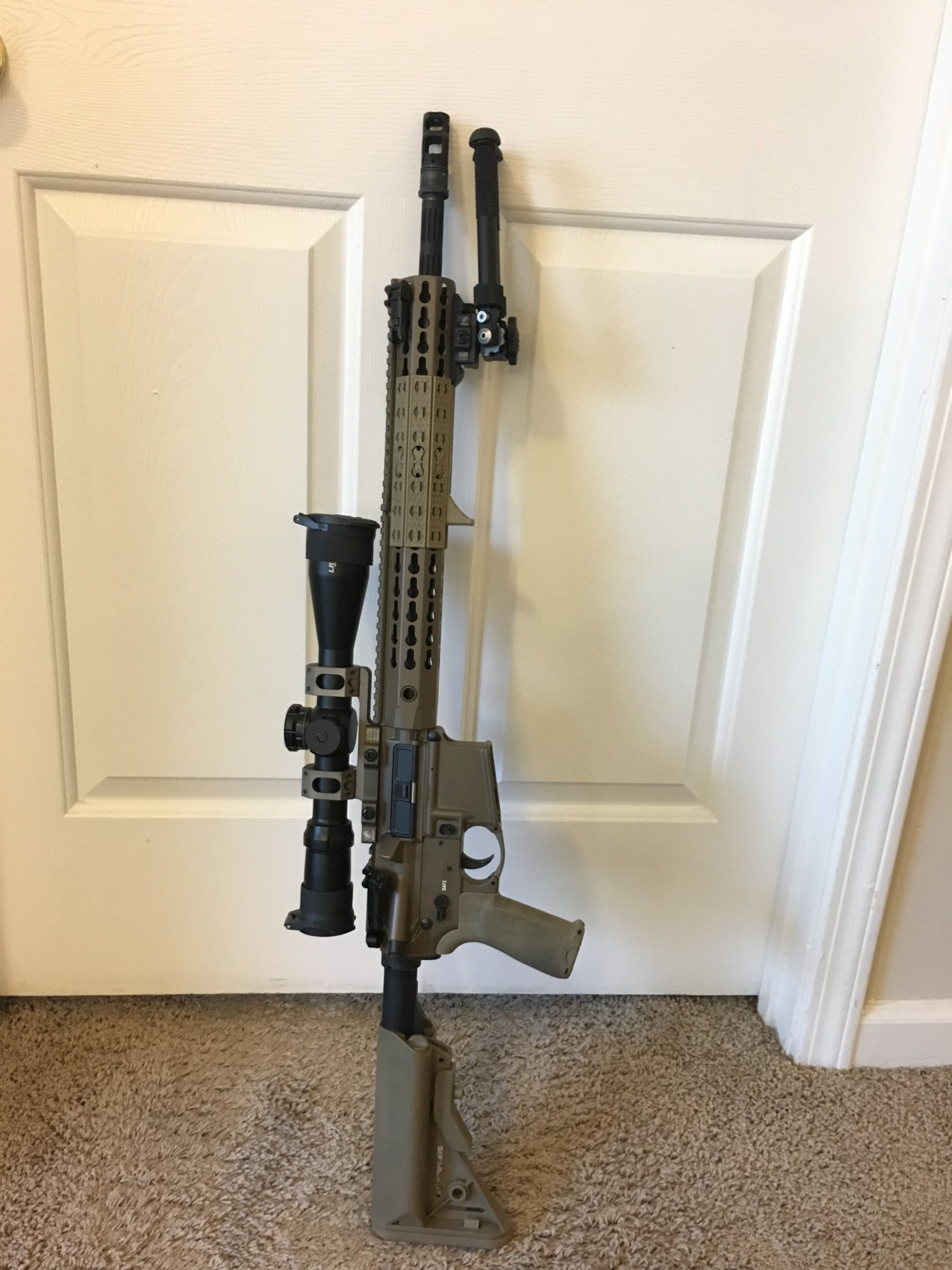

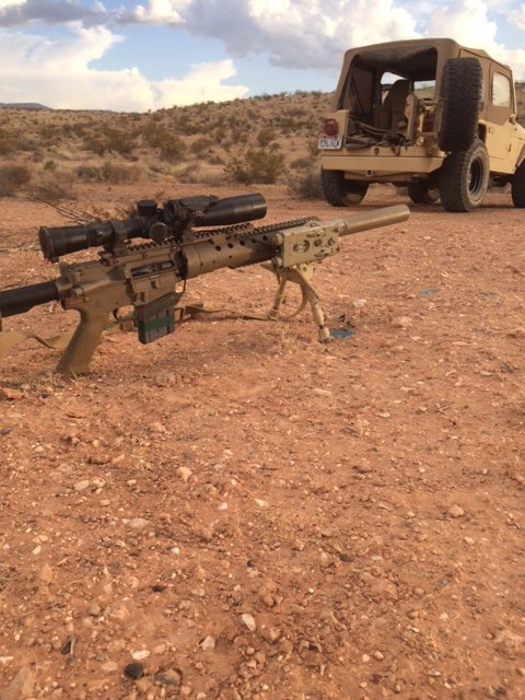

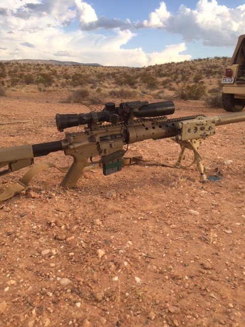

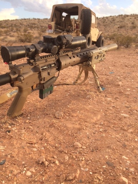

This started out as a Mod 0 clone build. I decided to modernize it a few years ago. No regrets. I still dig the clone guns and love the Mod0 look, but this is much more fun to shoot.
WOA 18” SPR barrel abs upper
LMT Lower with Giessle HiSpeed DMR
KAC URX4
Bushnell LRHS 3-12

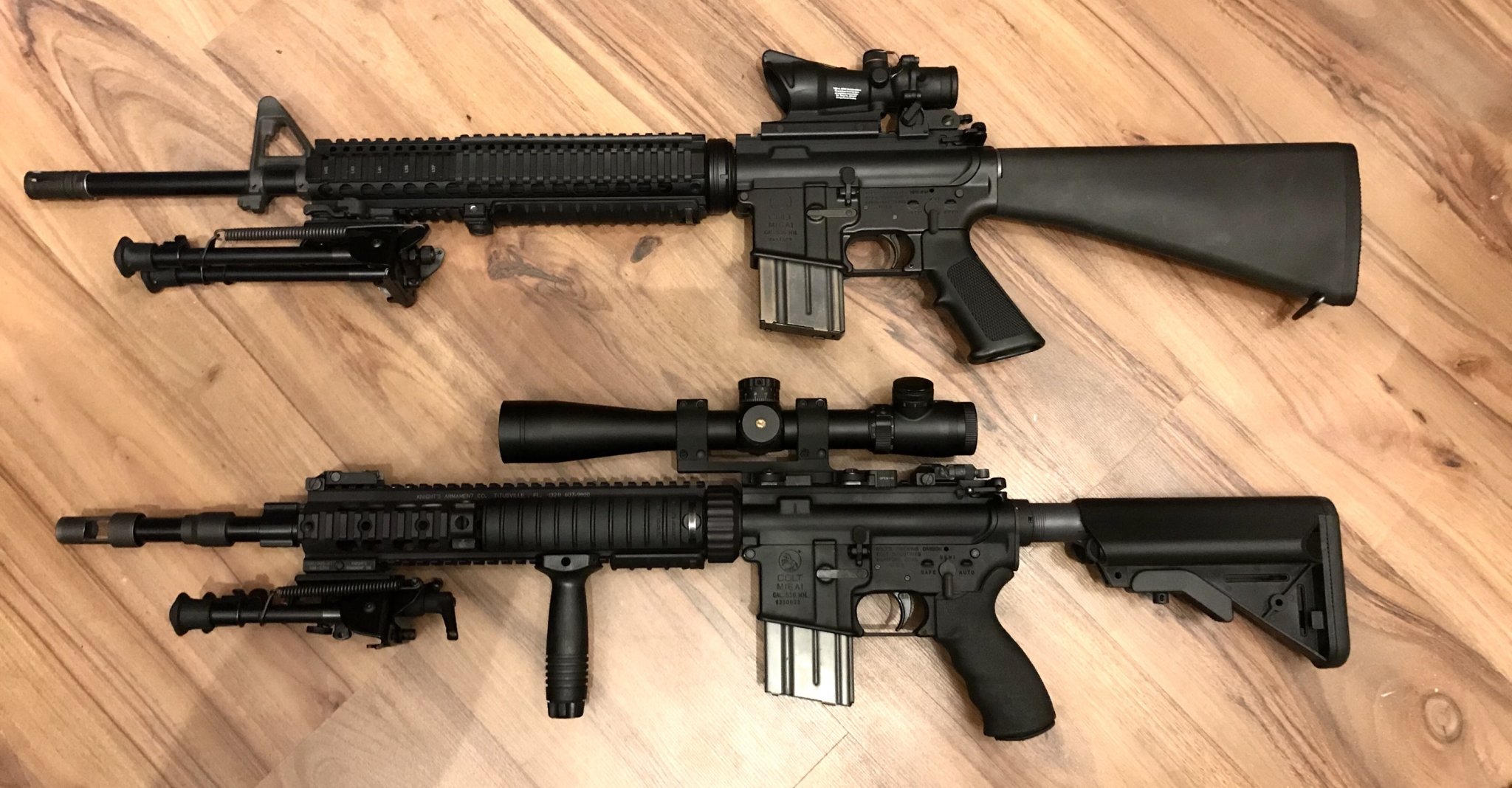

Mk12Mod Holland
Complete 16" Douglas PRI upper assembly
Colt stamped M16A1 lower
Leupold Mk4 3.5-10
Aimpoint T1
Peq2A
Ops Inc 12th Model that it shares with my Mk12Mod1
I prefer this version to the Mod0/Mod1 as I was able to get the same velocity from a 77g TMK loading as Mk262, yet I have a shorter barrel. I normally shoot alot of 5-700 yard 1/1.5 MOA targets with it and have it to where at 550-600 I can empty the mag on target.
Took these today while shooting further, but I forgot I only had a 6 inch plate out there. Storm was moving in so I said screw it and shot 745 at a 6 inch plate while 15-20mph wind was coming constantly from the 4 o clock (where the storm was coming from) with gusts of 25+. Knowing I was a bit in over the head of the system/ammo, I was actually only pissed that the target was only the 6 inch plate as almost all of the misses were very near on either side of the target from an obvious wind change/gust. I did manage to hit the plate about 40% of the time and needed 22MOA and 2.2-3.2mils of wind.
Only thing I want to change is I want to swap the KAC bipod pic rail mount for a LaRue QD. When handling the gun like a carbine, its very beneficial to have the ability to drop the bipod and stow it; the bipod gets in the way and is actually worse at unbalancing the gun than the suppressor is.

I definitely fixed the photos. I haven't really shot the Lilja on paper yet. It's dead nuts to 400 on steel. I got to clean it and only shoot match ammo to put it through it paces. I'll end up loading for it when I get around to getting some dies.

Nice rifle. What does it have to do with this thread?

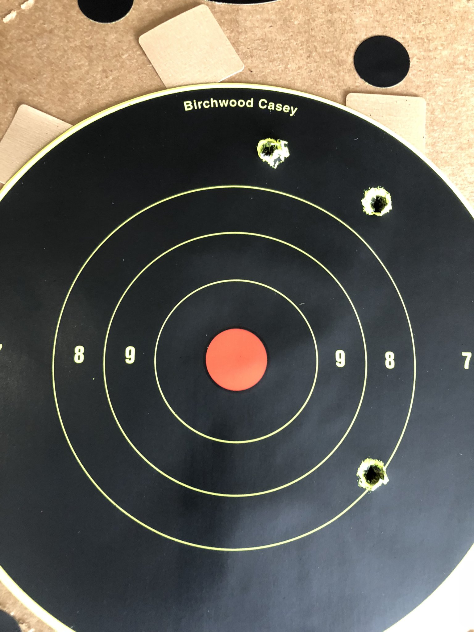

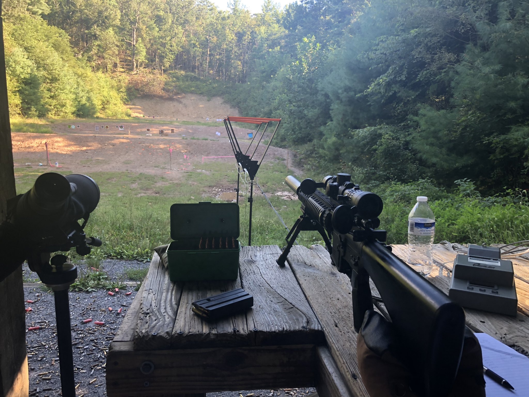

Some good looking rifles so far. I need to get mine out to the range soon and shoot it some more groups and try to decide on ammo. It was doing some downright silly things with Black Hills TMK last time I went out. It was almost like the scope was loose, but everything checked out when I got home and cleaned it.
Top pic is Black Hills 77 @300 and bottom pic is Federal GMM @300. Actually it was 293 yds but I was super impressed with teh Black Hills 77 gr.

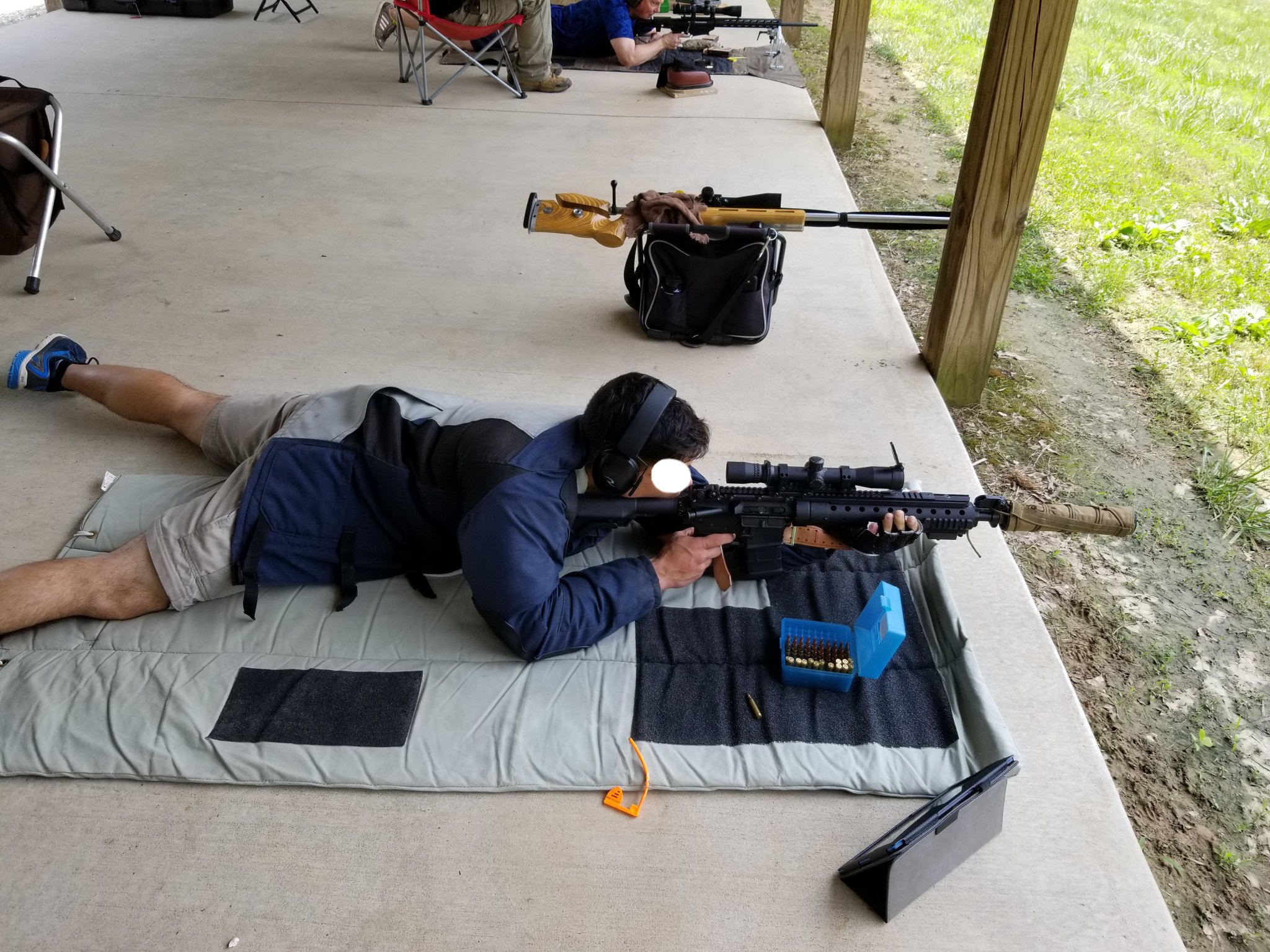

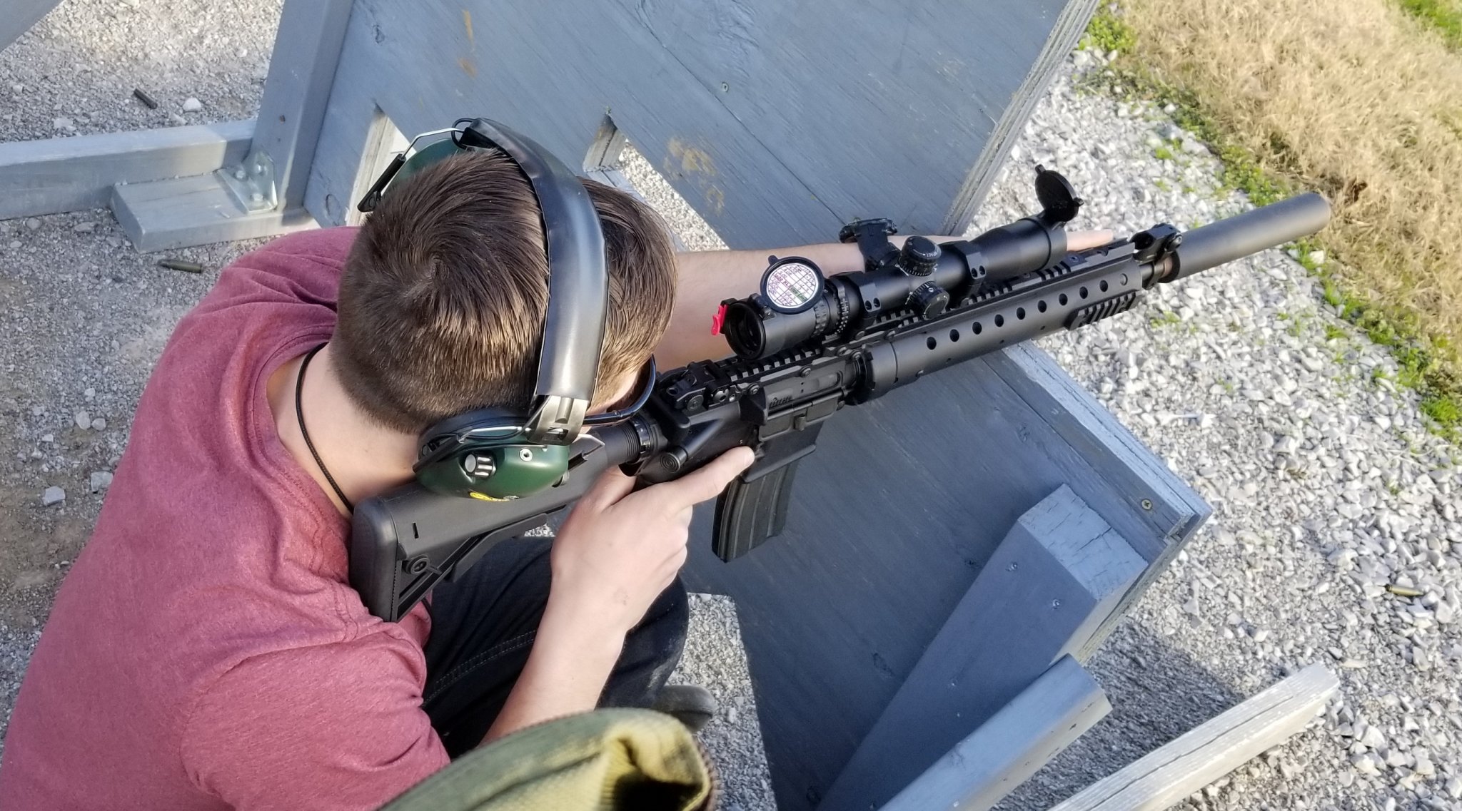

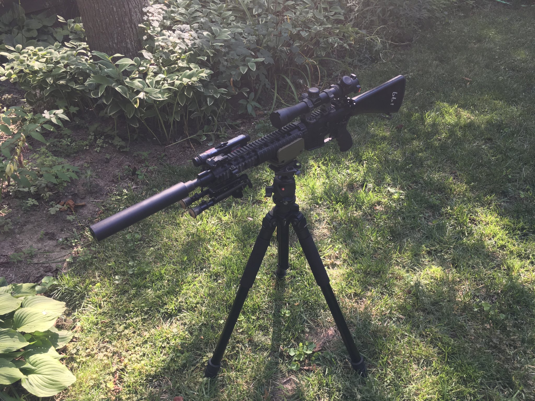

My daughter's boyfriend running my mod0. AEM5 can. I went with a badger riser and rings like my buddies unit downrange. They shitcannned the QD rings. I started with my M3 variable (love it) but find the fixed parallax works better for what I use this rifle for. 32mm NXS becusse I can't bring myself to spend $1800 on a 24mm yet.
Another soldier buddy shooting Highower at 600. (I know the can is illegal but F it)
I love this rifle and after running it a couple years , find it is my favorite out of all my rifles, to include a bunch of high end custom match rifles and my mk13s. It just works.

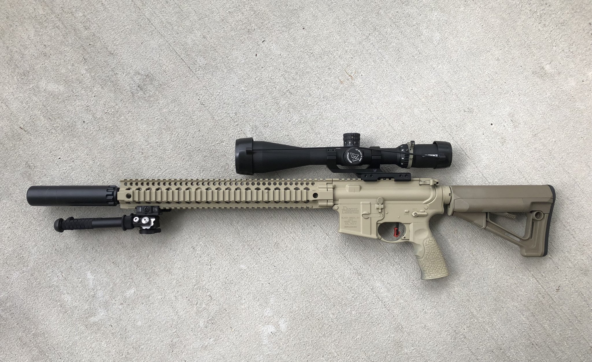

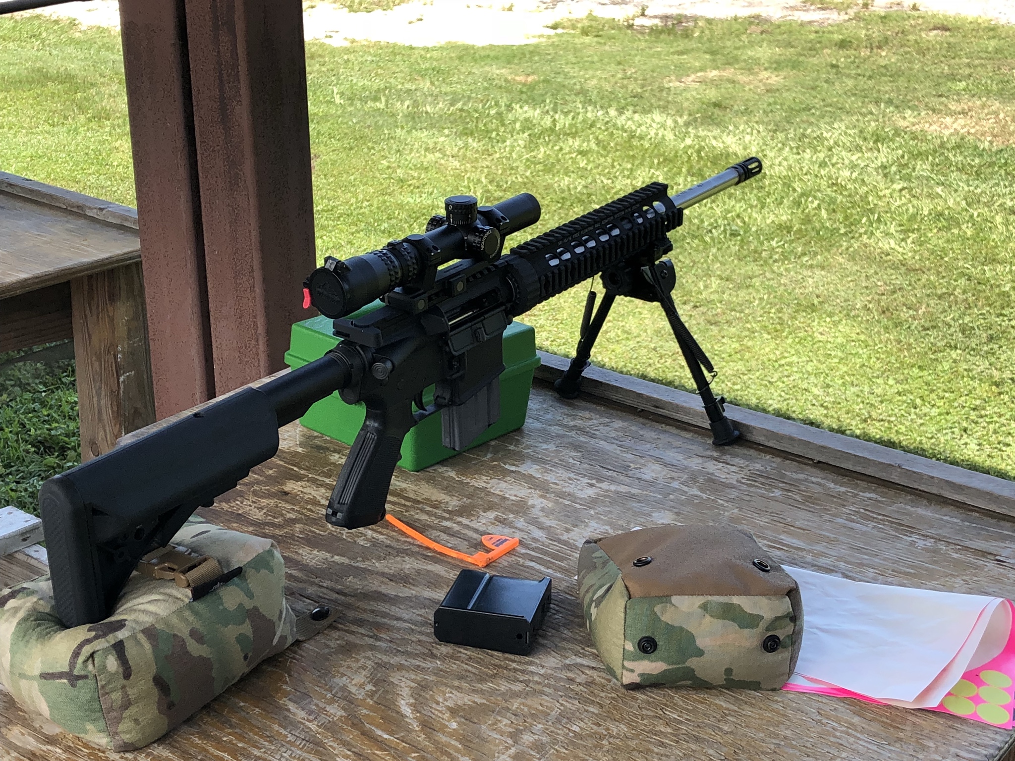

Newest addition to the fam, going to part the OPS brake to suit my surefire can—then work on Hornady 75ELD’s and 77SMK’s to see what she prefers.
KAC rail/bipod adapter/sights
Krieger barrel
NXS 2.5-10x32 with OPS QD

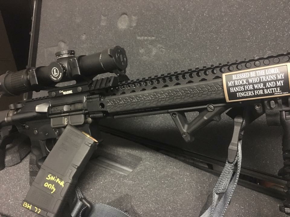

I’ve been running this one for almost 3 years. Stock Daniel Defense MK12. Leupold MK6 1-6. Very dependable and fast setup.
