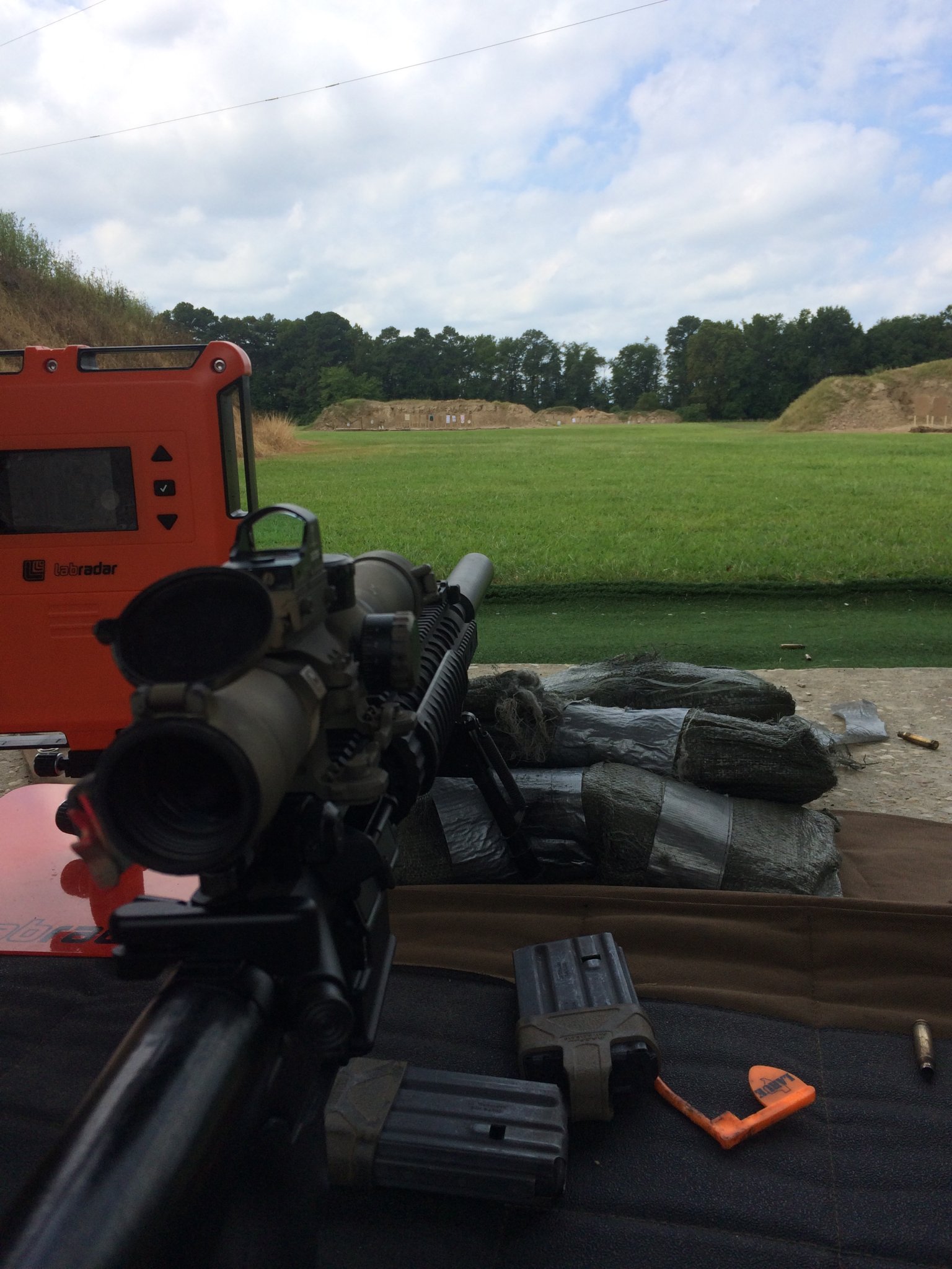

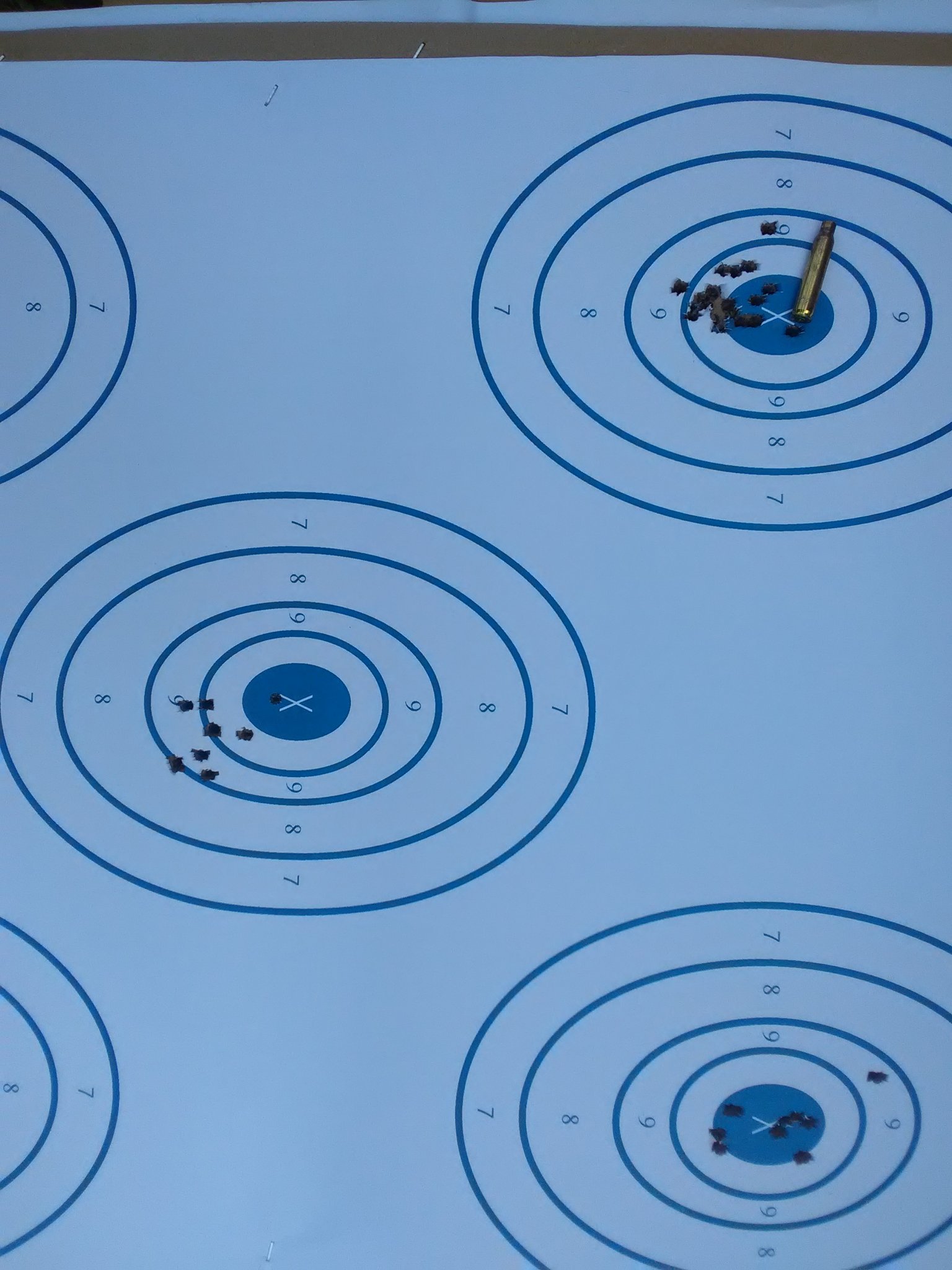

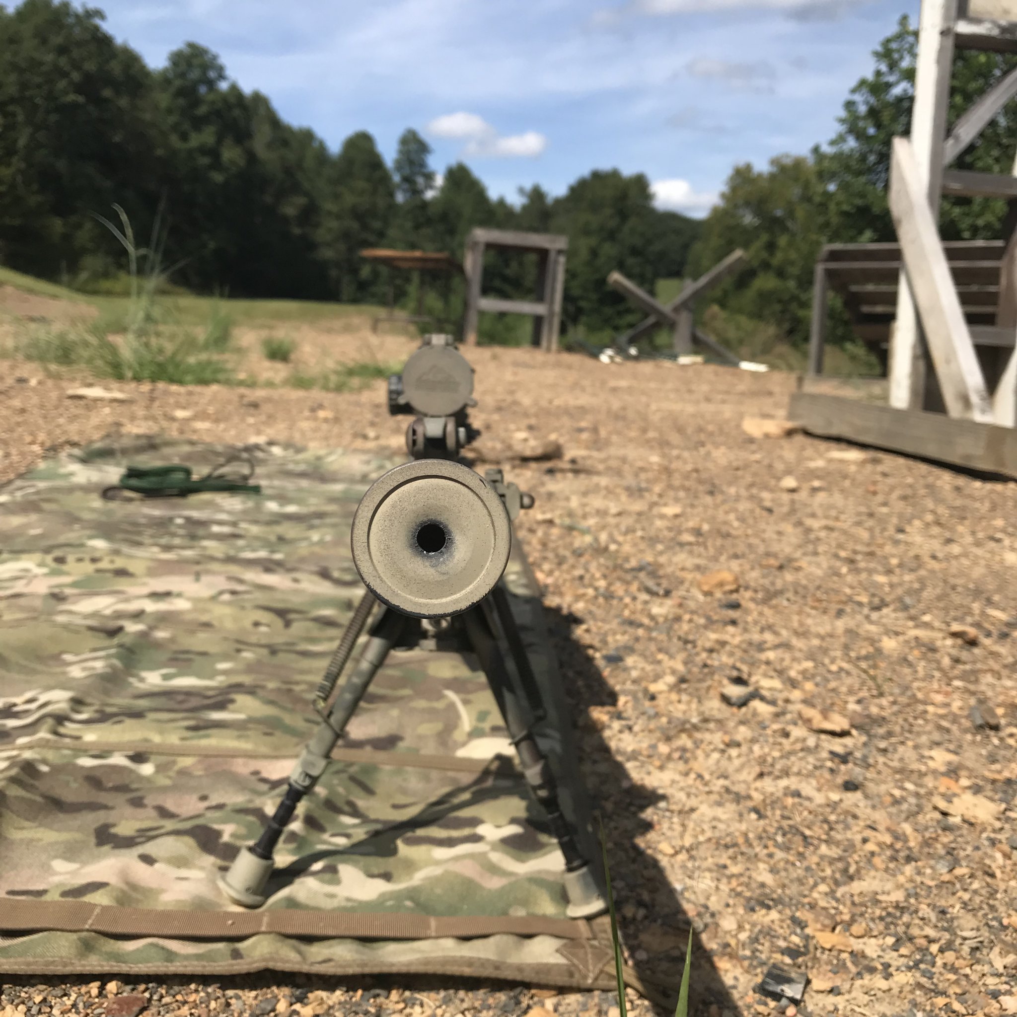

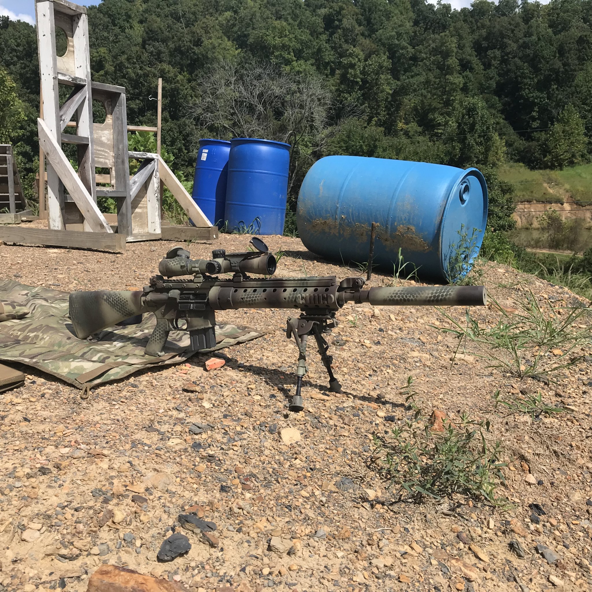

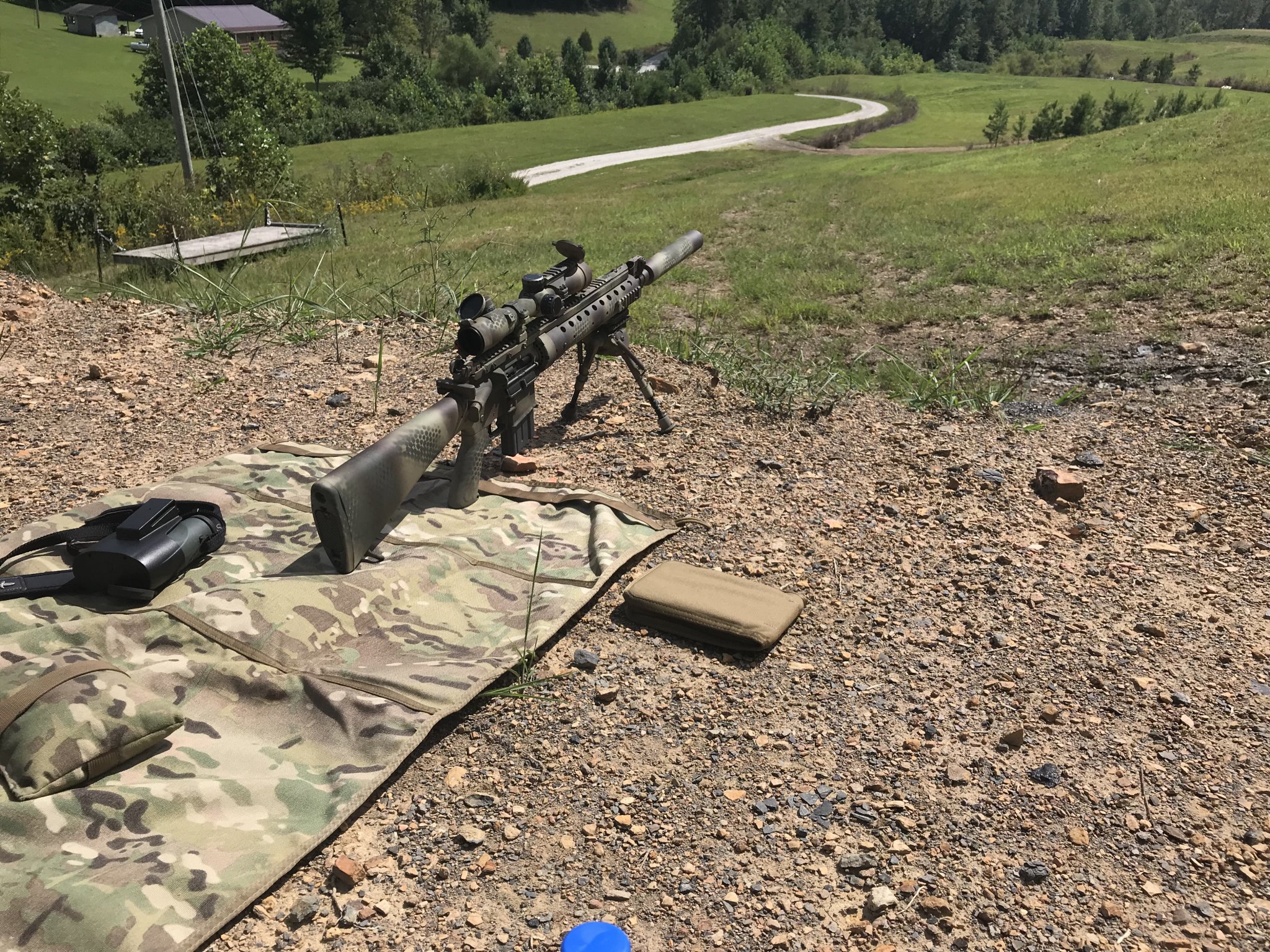

Went to 575 today with ease. Wind was fun for a while then died off completely. IMI 77 Razor Core may be just a bit too spicy. If I calculated it right, it was hovering around 2,900 FPS and only took 12 MOA out to 575. Old numbers and charts were saying 15’ish.

24-24.4gr of Varget or RL15 under a 77SMK (been taper crimping them lately) LC or Win case with 205 primer is a very accurate load to 600y. (I drop .3gr with win cases)
Not as hot as real deal 262. Around 12 moa to 600 depending on temp. Not sure what MV is, around 2800.
Off the shelf I was shocked how accurate the FC262 was. Not cheap but it shot half MOA at 500y. Most days I'm a 3/4moa shooter with a gas gun but a 3" singer was boring unless the wind picked up.
What length is your barrel? I have never seen anyone get anywhere close to that kind of speed on varget with those components. ~2600 is more the normal with 16-18" Even with more energy-dense powders like TAC and 8208, you are still at max 5.56 load data to get that kind of speed in a suppressed 18" with the SMKs.
So let's play this out- assuming a G7 BC of .193 and ~12 minutes to 600 yards with 2800 fps.... you're at 12,500ft above sea level?
Whatever it is, it seems to be working for you... if a 3" target at 500y with a .223 gas rifle is easy enough to be "boring," I would not change a thing.
Something is up...did it sit out in the sun for a while? It's also possible they are using a different projectile with a slightly better profile.
I can tell you this, with a .193 G7 Nosler CC (Litz AB data) running between 2695 at 35F and 2780 at 95F in the sun/hot gun I am 14.7 moa to 575 according to AB at 70F. I've trued it at 600.

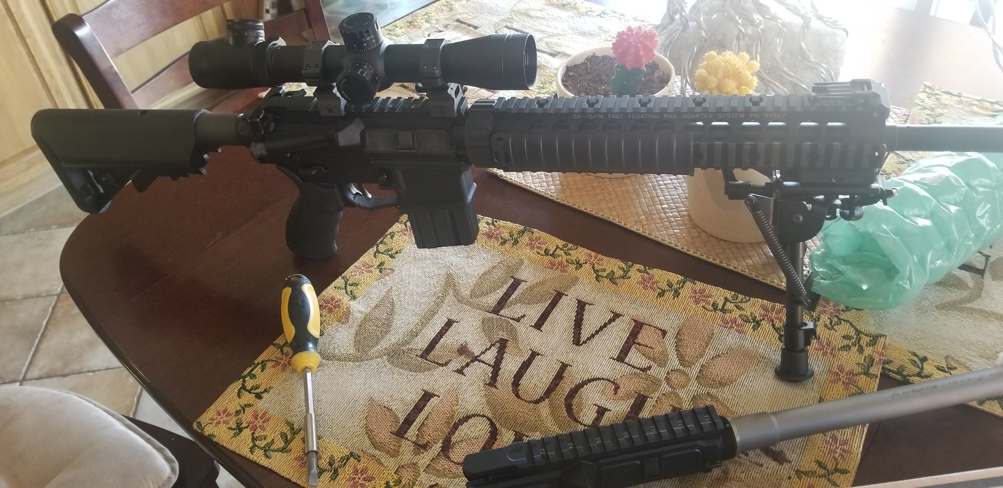

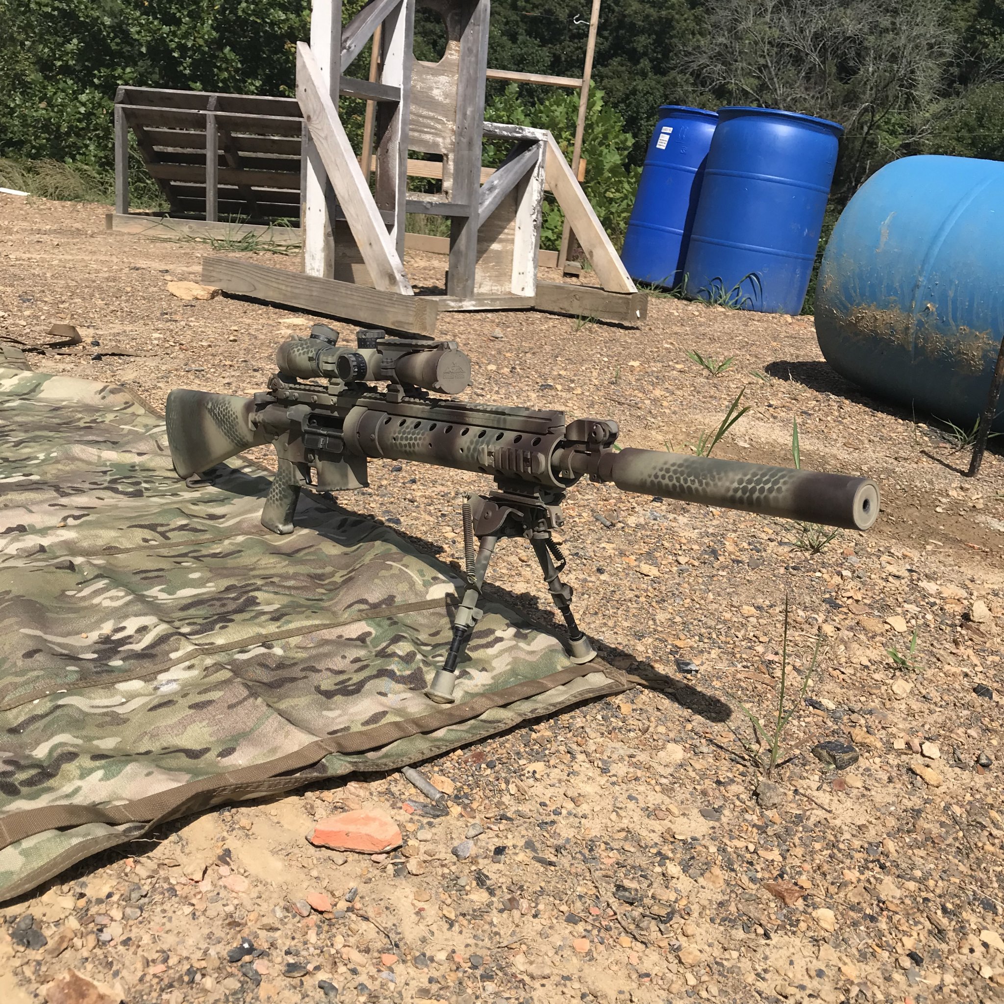

View attachment 6940231Breacher, liking that paint job!

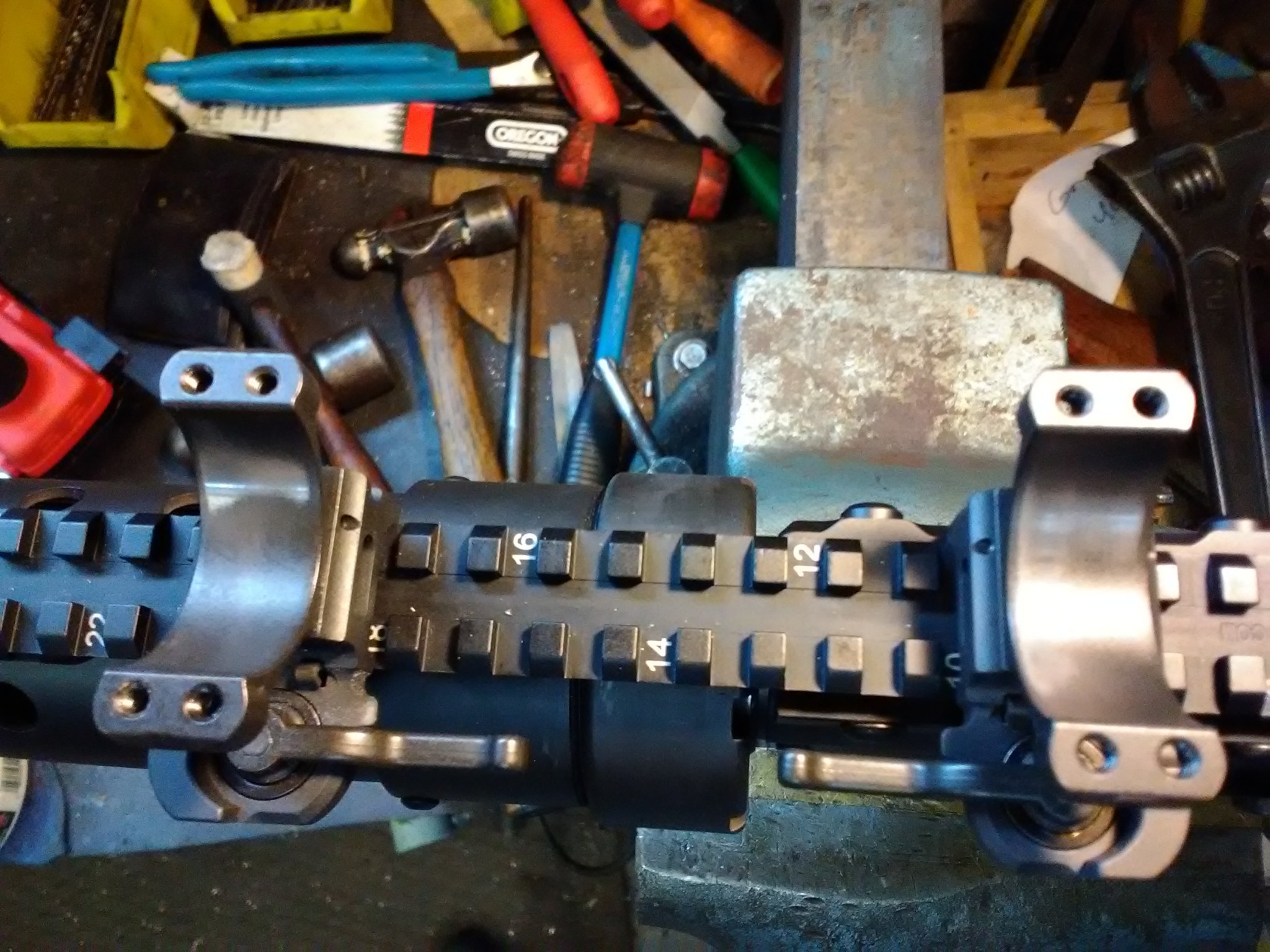

These arms rings are really bad.
I guess we're spoiled by (mostly every other) company paying attention to the scope mounting surfaces.
Lapped these a fair bit already...
By far one of the weakest parts of the MK12 are the awful ARMS #22 rings. I've threatened to swap them for NF ultralite rings more than once, and if I had a Holland that's exactly what I would run.

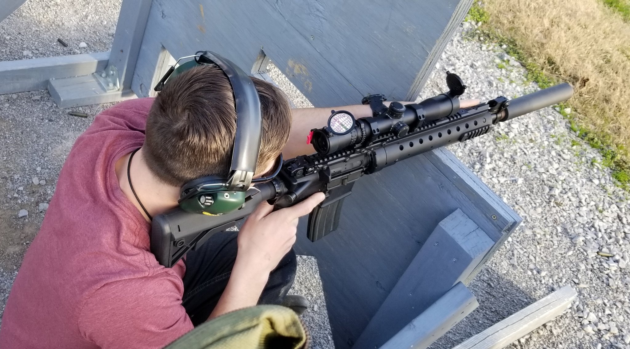

My daughter's boyfriend running my mod0. AEM5 can. I went with a badger riser and rings like my buddies unit downrange. They shitcannned the QD rings. I started with my M3 variable (love it) but find the fixed parallax works better for what I use this rifle for. 32mm NXS becusse I can't bring myself to spend $1800 on a 24mm yet.

Sadly, my Mod1 absolutely loved the 23.4 load that was .010 further back.
The TMKs of all flavors seem to build pressure at lower charges. I did not feel comfortable going above 23.2 to keep the load OK across multiple rifles.

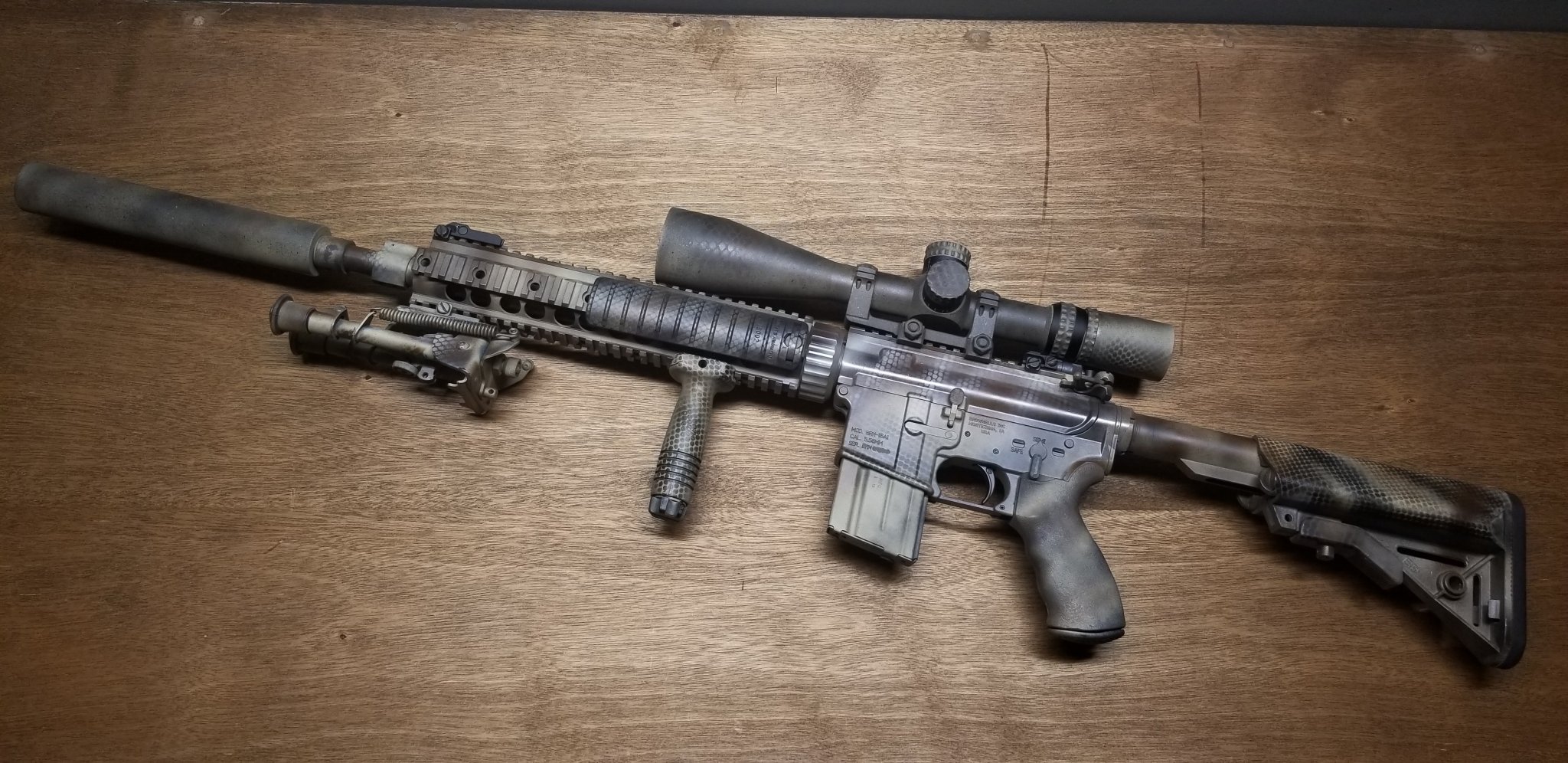

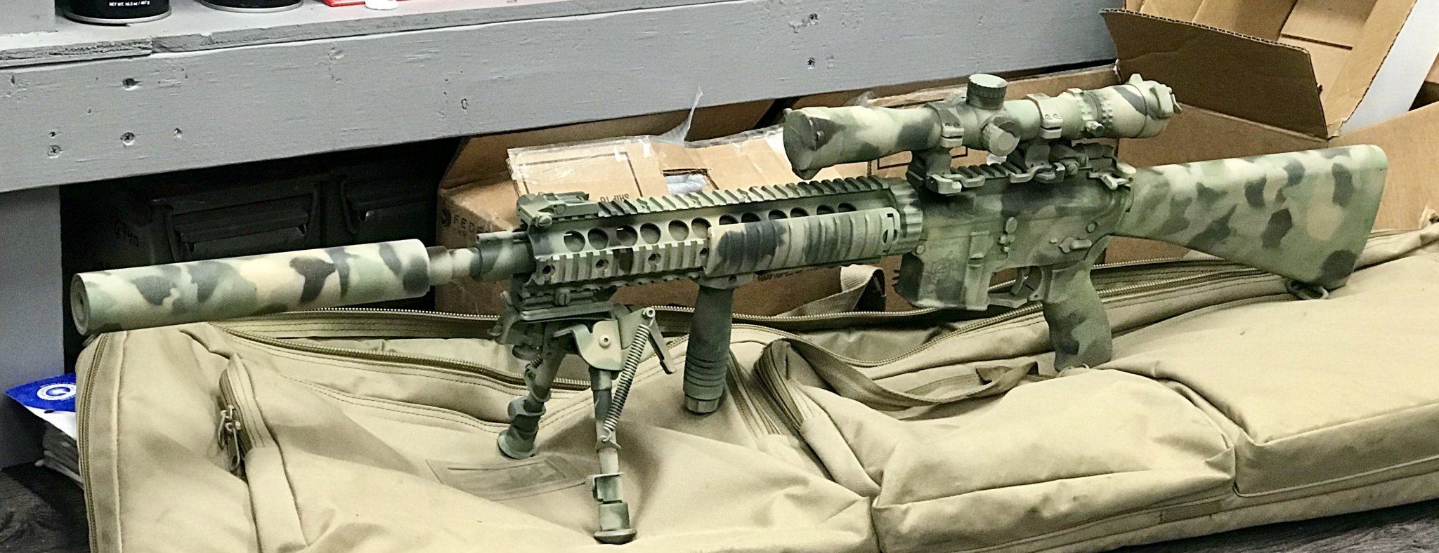

I put one on my wife's RECCE. The tips of the prongs made contact with the end of the blast chamber in my can with just timed peel washers. We had to remove it and cut about .040" off the back to shorten it and it's been fine since. Before that modification, the can would shoot loose, it's never done that on my Allen units.
Another soldier buddy shooting Highower at 600. (I know the can is illegal but F it)
I love this rifle and after running it a couple years , find it is my favorite out of all my rifles, to include a bunch of high end custom match rifles and my mk13s. It just works.
Do you prefer the AEM5 can over others like the SPECWR from SilencerCo. I know the SilencerCo isn't the correct can for the build. I am looking at building a MK12 Mod 1 soon. I just can't decided if I want to order another can or just use the one I am currently waiting for.

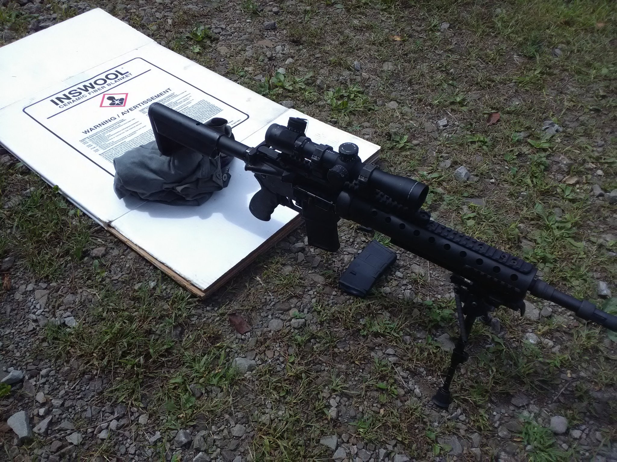

I'm going to our another one if these together, either a H or 0.
But a little looser guidelines like using any scope that's in the system.
Thinking nightforce 3-15 nos.
What would you guys go with in this situation ?(other than a 4k s&b?
I can't speak to any other 223 can. I ordered the AEM5 when I started the build and to perfectly honest I love it. Sounds good. Accurate, repeatable and reasonably priced. I switch it between my mod0, a 20" "mod10" and my wife's RECCE and its rock solid on all three.
Of I was going to deviate from the Ops12 can I would probably get the 30 cal version, just so I could run it on a large frame too.
Any of you guys have eye relief problems using 2 piece rings on a flat top before the handguard?
man i would think, i guess it depends on the scope but ive got mine mounted well ahead of the charging handle and with my nose touching the charging handle it is just black around the edges. youre talking at least an inch probably closer to 2" behind that.
BUT i see plenty mounted that way.
