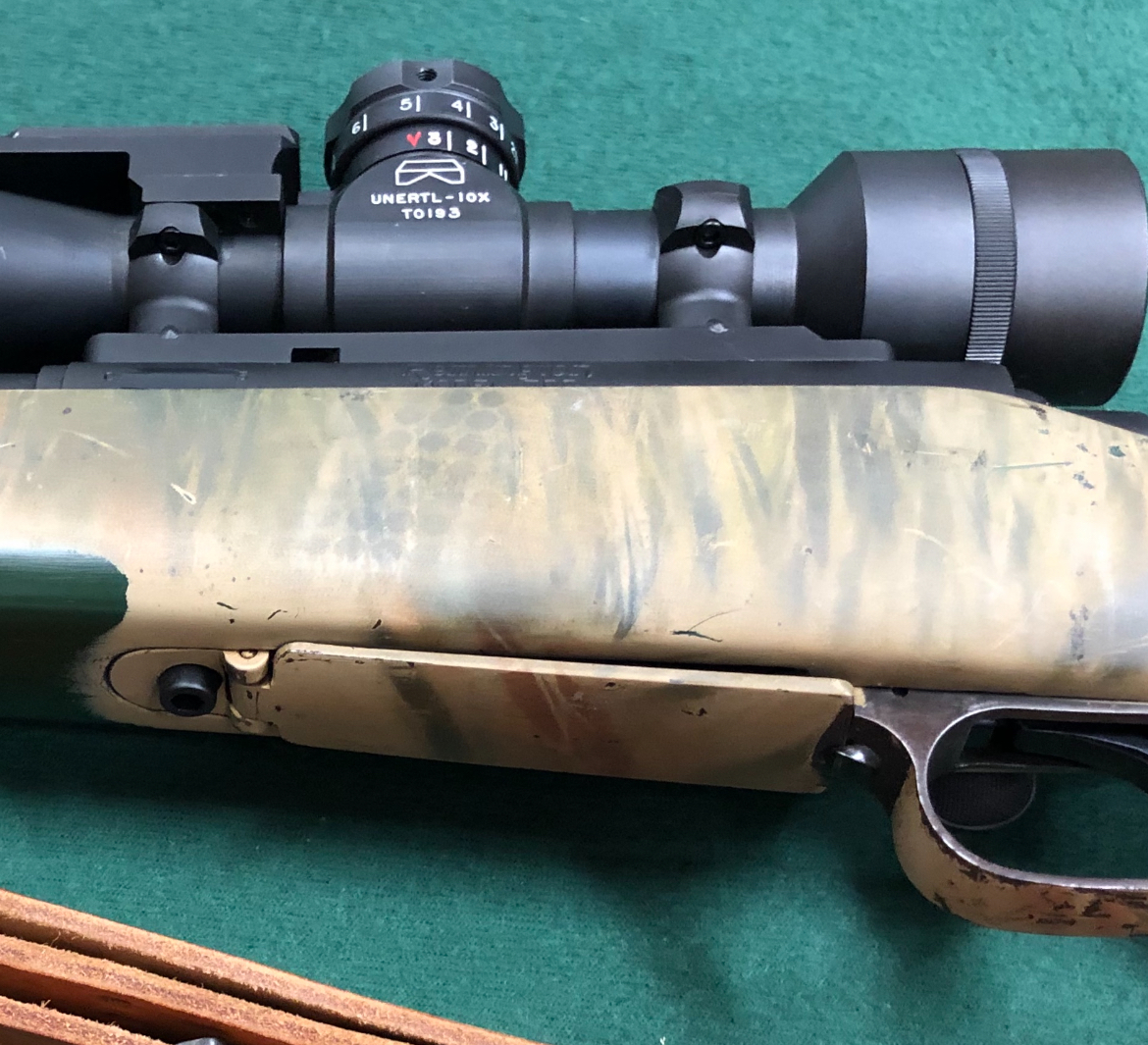

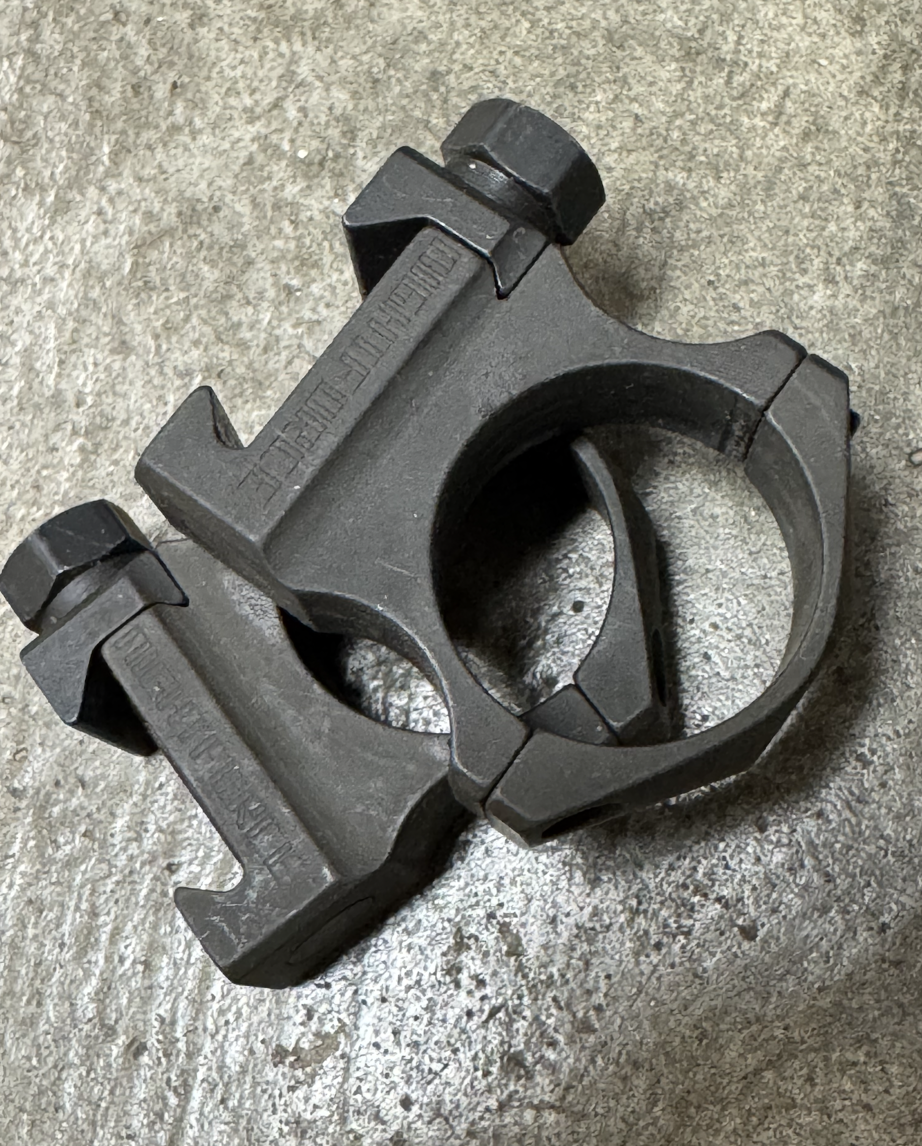

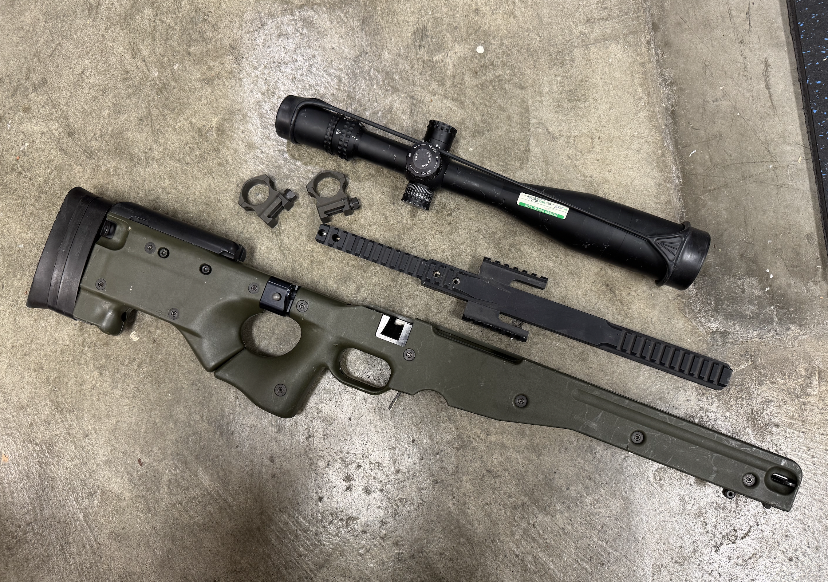

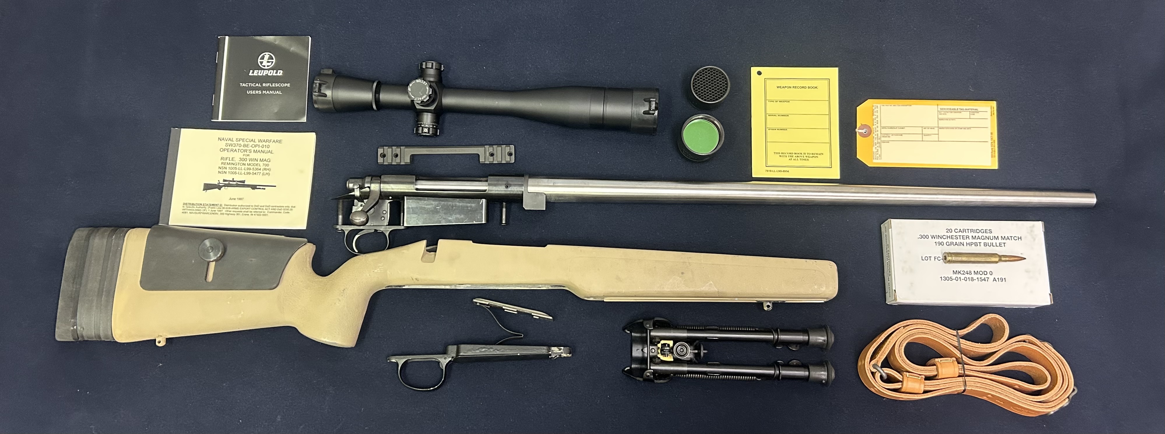

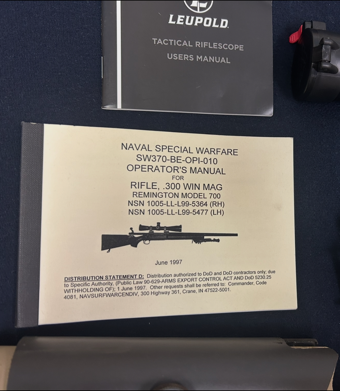

This one is getting closer, still need a few things: old Leupold Ultra rings and the action screws, but hope to send it off to Red Bull soon, for Chris to finish later this year or early 2026.
Early grey stock underneath the tan paint.

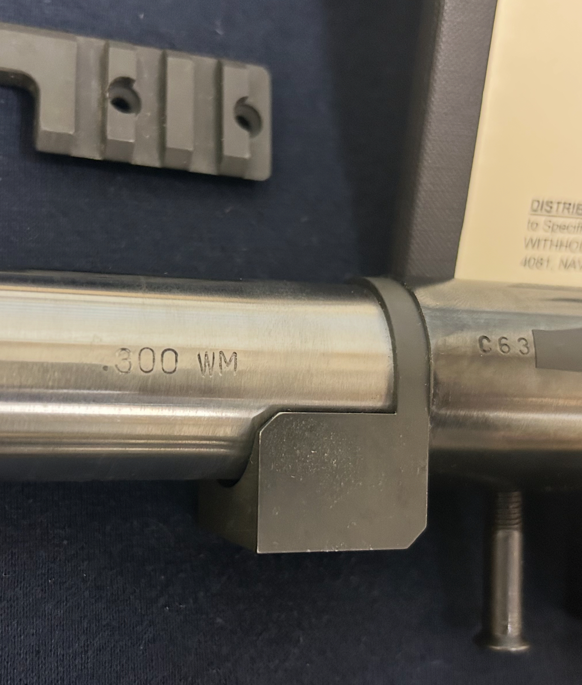

C-prefix action from early 1990s.

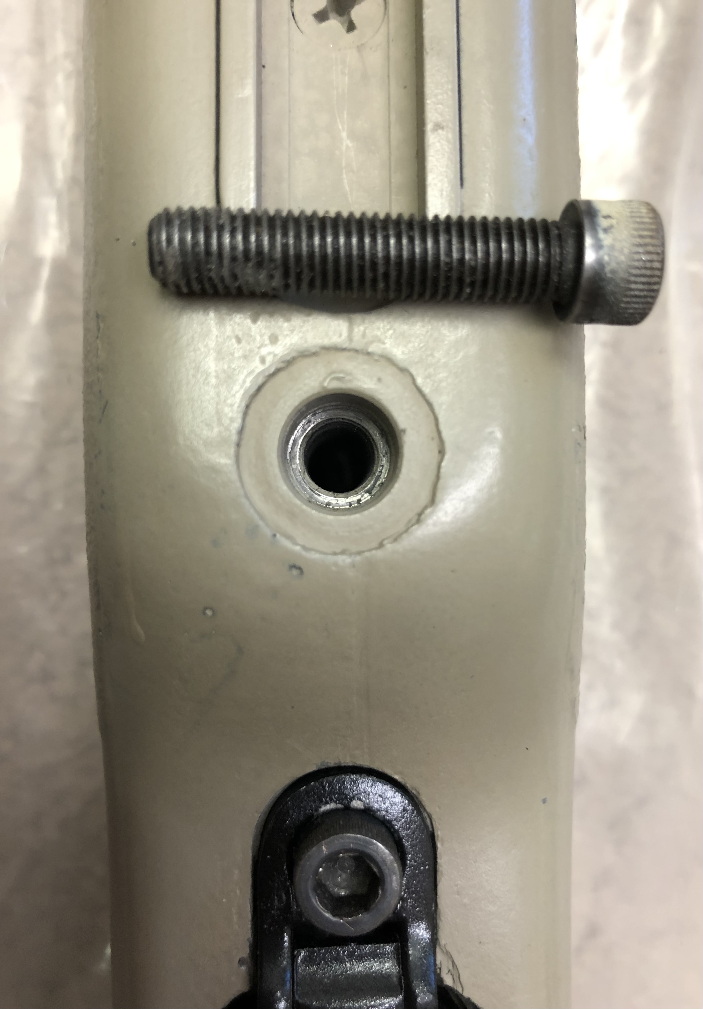

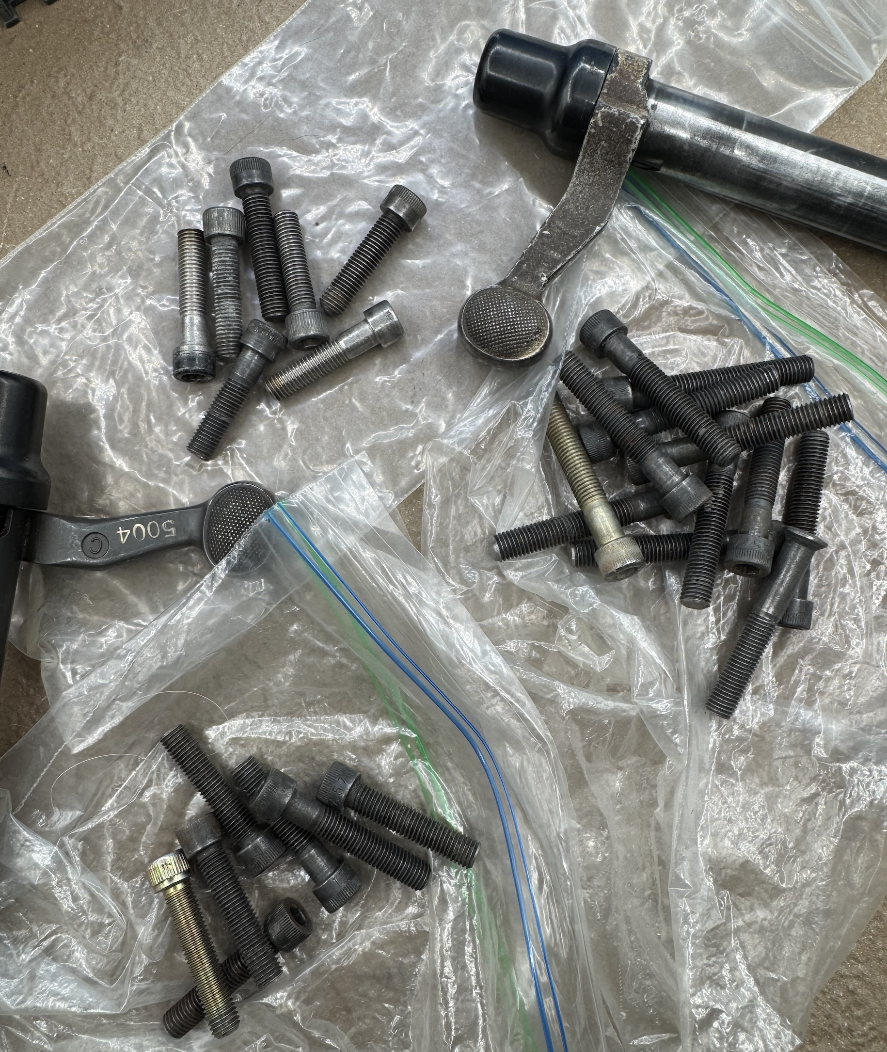

I presume this is a Mod 0 Build. Don't you already have the action screws or does this build require a different set of screws?
Crane used heavy duty Allen head bolts instead of regular Remington action screws, including the threaded recoil lug which also used a bolt. I need those three parts, as my stock was missing them, but it’s no biggie once cut to proper length.
