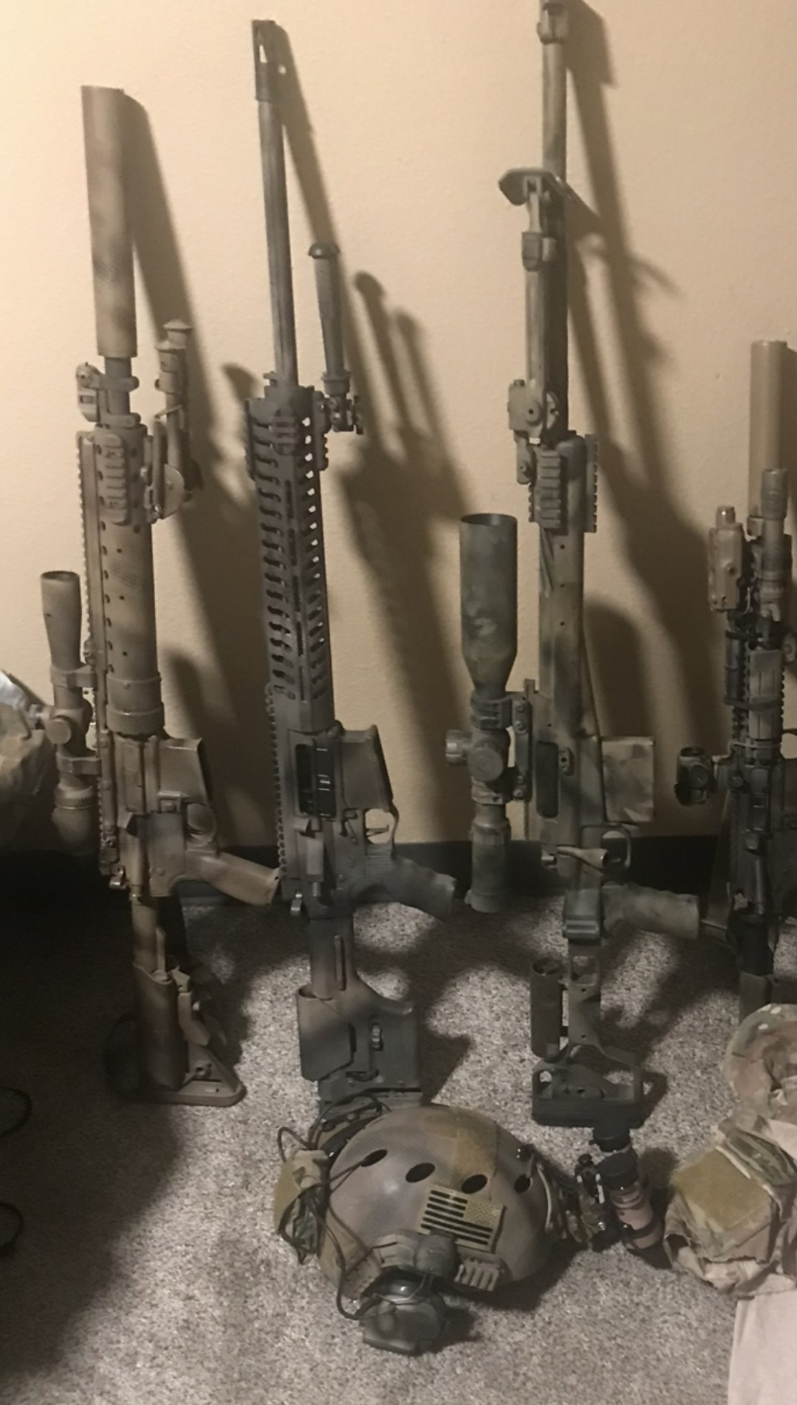

I built mine "clone ish" using a Seekins upper and lower and a Rainier Supermatch barrel. I tried to like the PRI foreend but just couldnt....so I swapped it to a midwest 15" T-rail.
Thats similar to the original SPR I built.
You can change a lot of things on one, but if it doesnt have the carbon handguard, its just not a MK12.

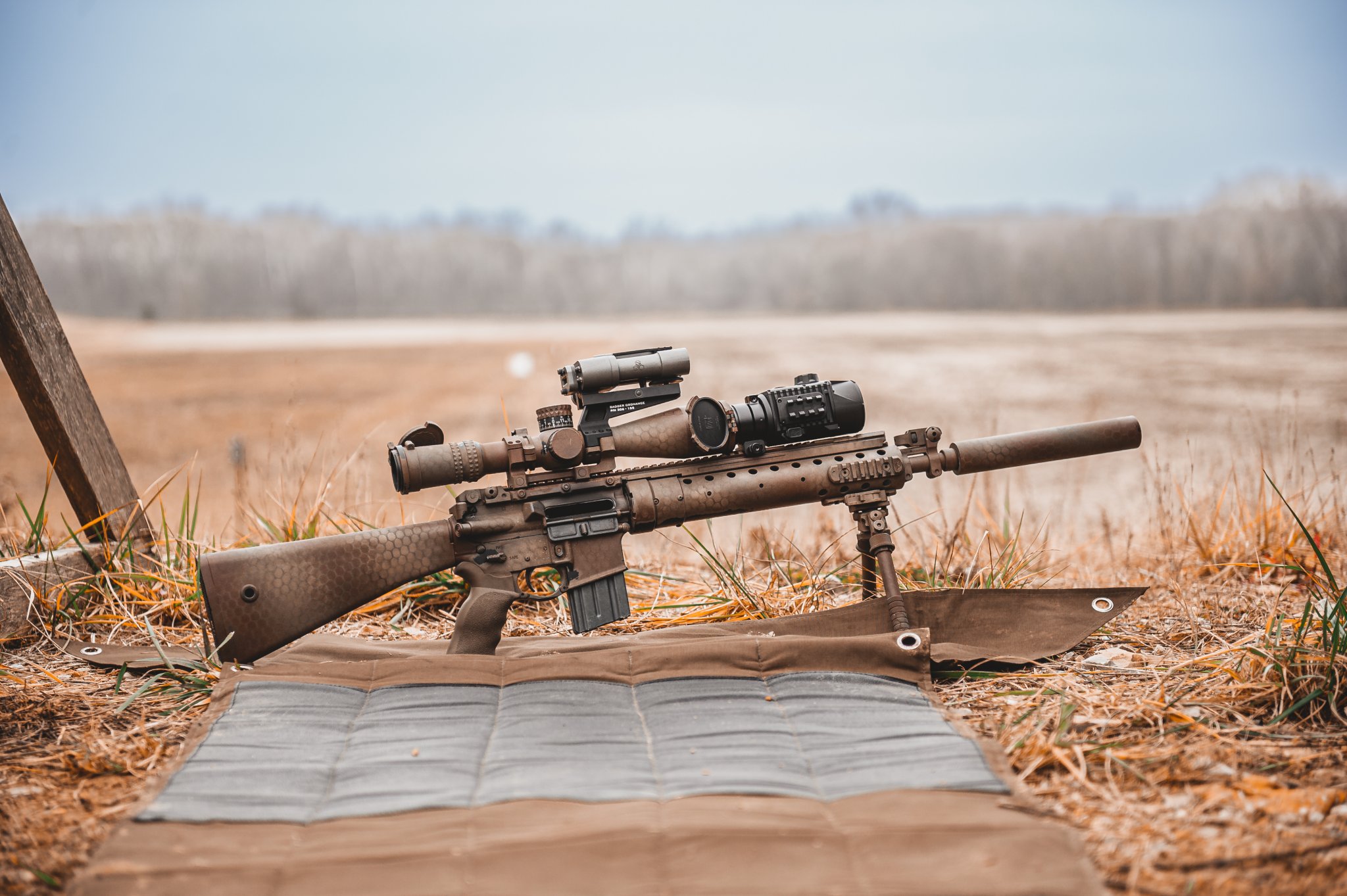

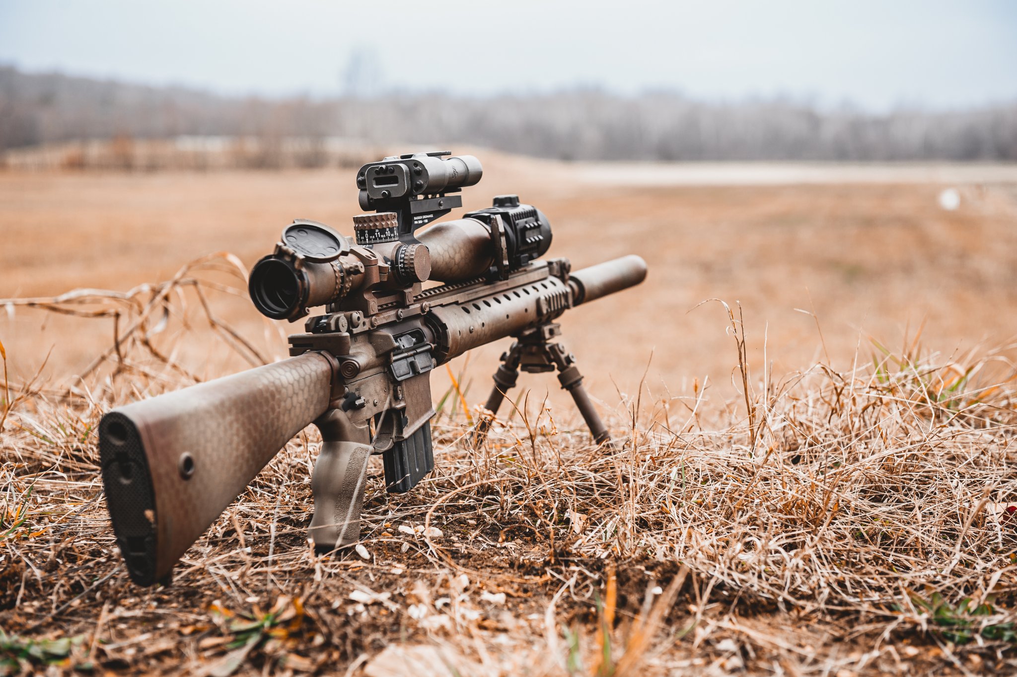

Made a few changes since the last post, figured I'd update.
10" plate through the thermal at 430 was no problem last weekend.
No extra heating done to the target outside of what the overcast sun gave them.
Verdict is still out on the SiCo Radius...havent really had a ton of time behind it on varying types of targets and sizes.

A beauty. What clip on is that? C35?
Looking to do very similar with mine for day into night use.

Pulsar Krypton.
Was going to get the C35 based on some videos and stuff I read, but after talking to some people decided to go with the Pulsar

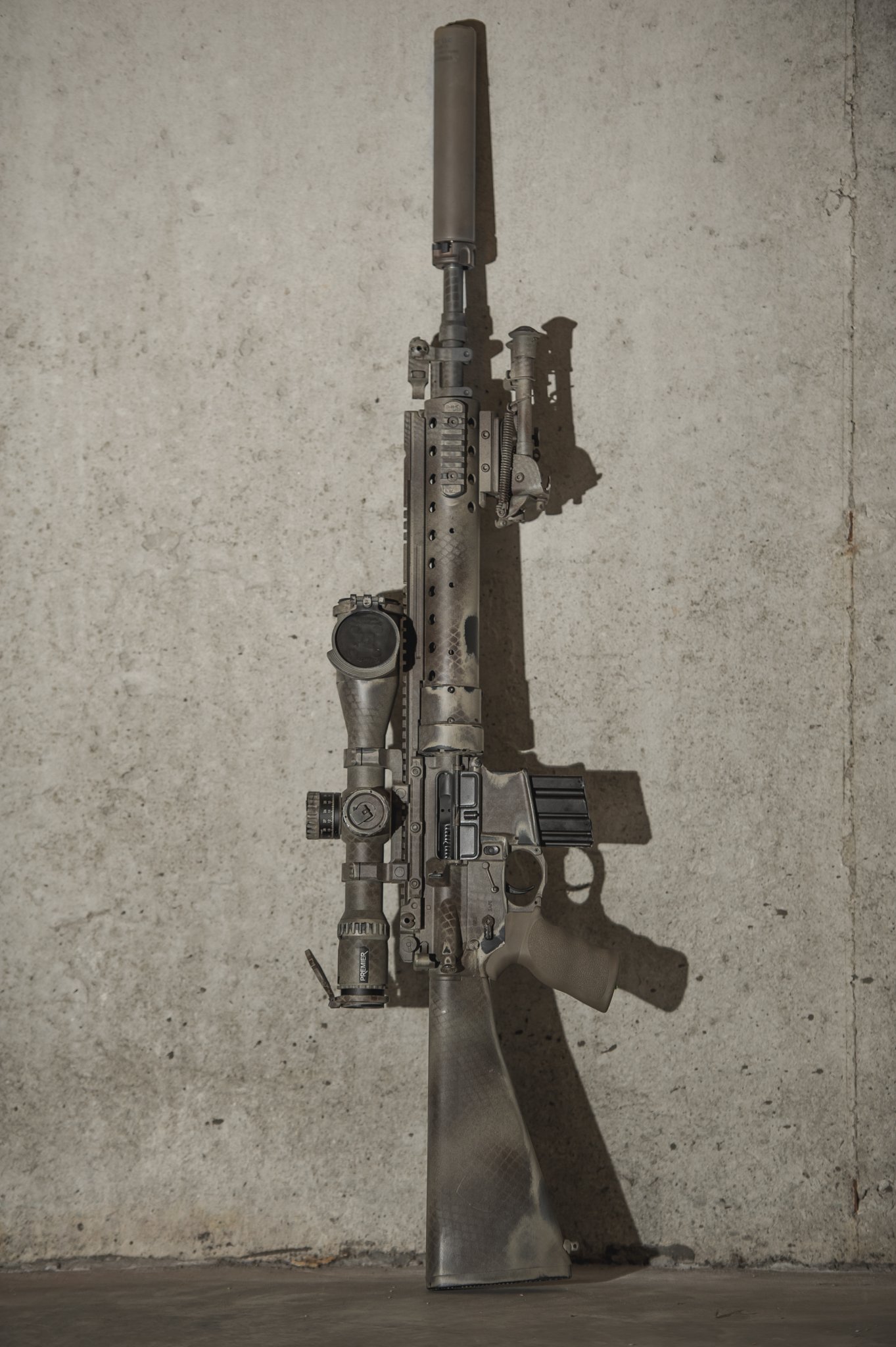

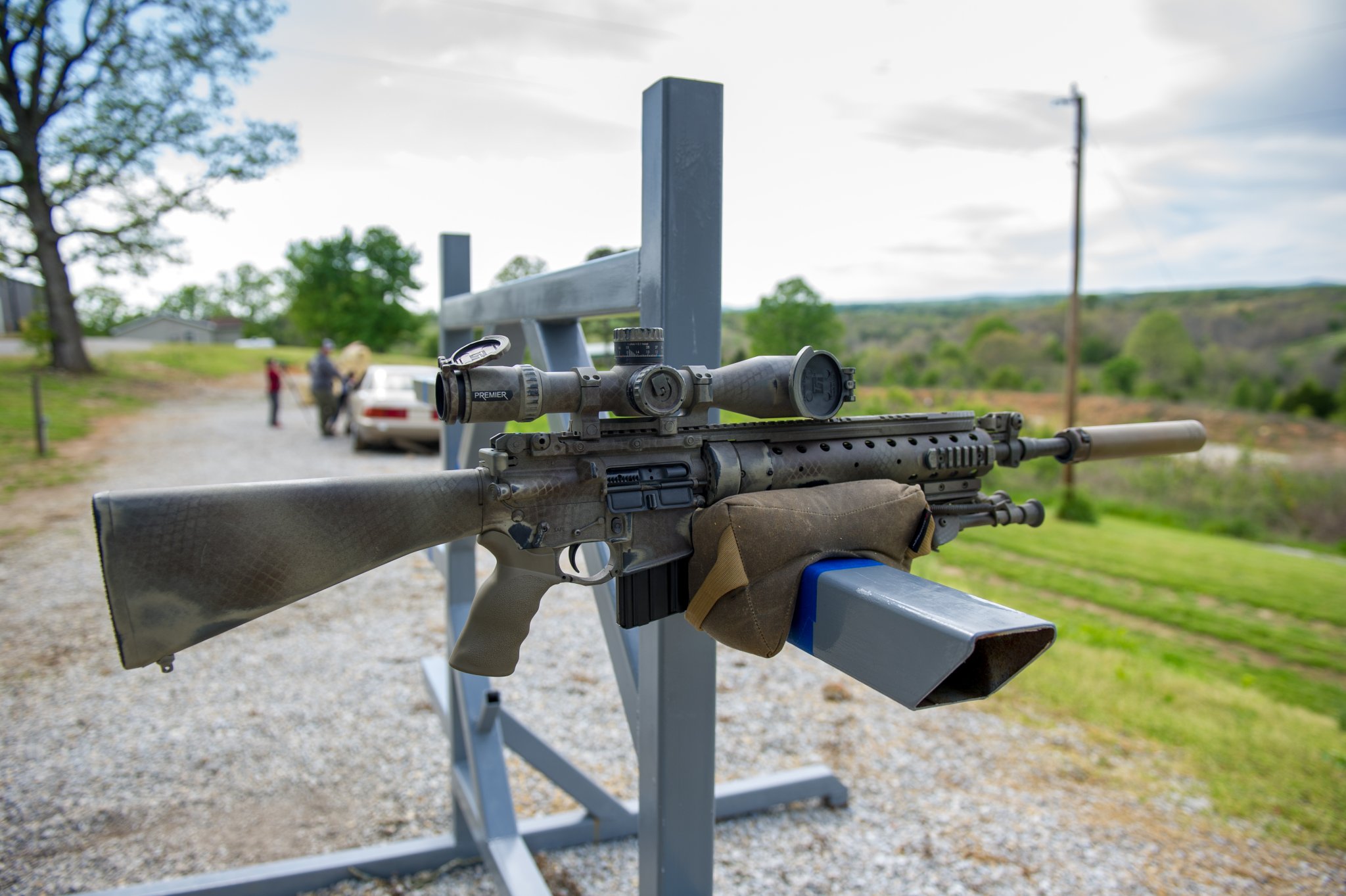

If you’re a 100% cloner, I’m going to apologize now...
Like a shitload of people I love the look and idea/premise of the Mk12.
I built an 18” SPR 5 or so years ago with that Mk12 image in my head but once it was done I never really liked it much. Its just didnt do anything for me, barely liked shooting it. So I sold it.
Got really heavy into PRS style shooting and couldnt justify building another that would likely just sit around. So I just kind of lusted for the past few years.
Finally said fuck it and put one together. Its not 100% correct because I didnt want the shitty Leupold and ARMS rings, and didnt want the A2 grip. Just waiting on the crown for my AEM5 now.
I havent had a chance to actually print any groups or do any real load development, (just threw 24gr Varget under a 77smk) but Ive ran it out to 1000 without too much trouble, and 800 seems to be the realistic “effective range”. Zero trouble getting on a 2MOA plate there.
Movers from a barricade as fast as you want to go is super fun.
Glad I wasted the money on a gun that probably won't ever serve any purpose for me other than a fun gun.
PRI Mk12 Mod 0 Upper (7tw 556)
Premier 3-15 G2 Mildot
Badger Unimount
Geissele SSAE
Surefire RC2 (for now)
View attachment 7332089View attachment 7332091View attachment 7332090
Ooo she's sexy nice build.

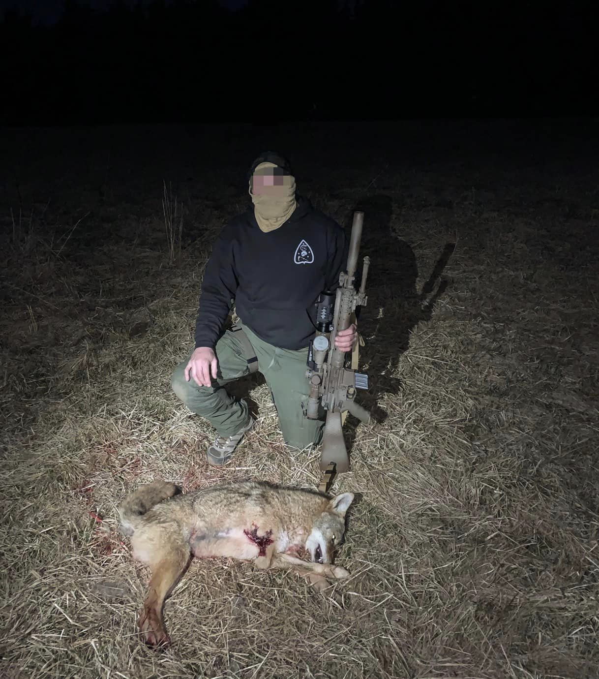

Pulsar working out great!
Got it out last night and got one at 150ish and one at 55y.
Also tagged a coon at 199.
Zero shift is almost non existent (especially at those ranges on game size targets) and its been very repeatable.
One thing I have noticed is that you have to find the parallax setting in your optic, that eliminates parallax from the thermal... and thats not always the best image.
