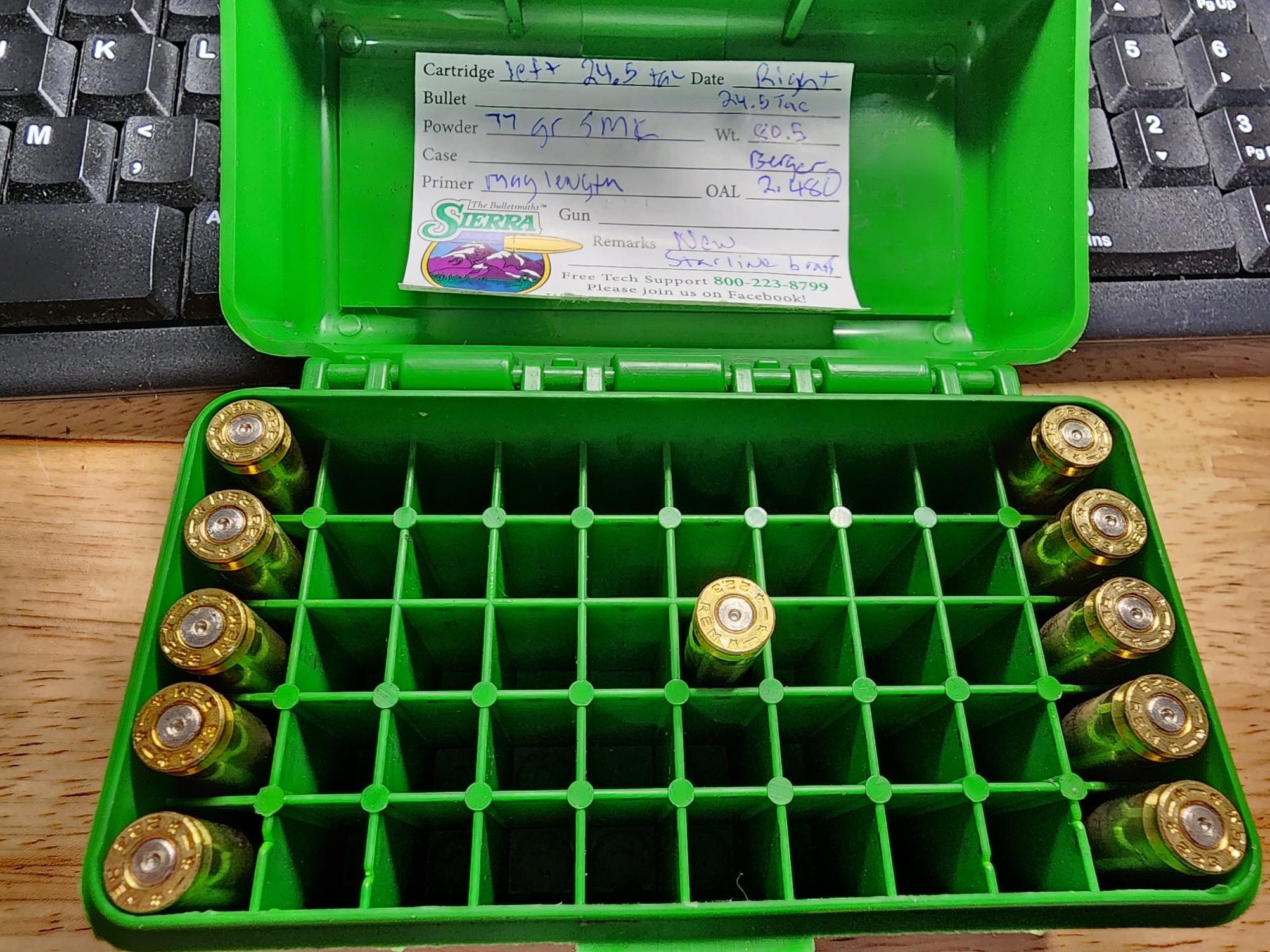

A little late to the party but I just chronographed some loads with tac. Will attach a pic with my scribble. I am hoping I don't wind up with some holes in primers once the temp gets up to 95. This is from my AR set up for xtc service rifle matches. Krieger barrel 1-7.7 twist 20". The pic of the brass is attached afterwards as well. Left side is the 77gr smk right is berger 80.5 center is one shot at 24.7 gr with a 80.5 berger. The primers are a little flattened but I dont really see any ejector marks so i loaded 50 of each up. What do you guys think am I pushing my luck here?
So you're single loading @2.480??? I'd think it'd be ok at that length, but every barrel has it's own personality. Might get spicy in the heat.
I've run 25.0 Tac with 77smk @ 2.255 oal = 2801 from a 18" proof.
24.8 Tac with 80.5 Berger's @ 2.280 oal was 2766 from same 18" proof. No pressure issues on those in my barrel.
Also the rumor is that Starline 5.56 brass is a little harder on the bottom end so primer pockets hold up better with hot loads.
