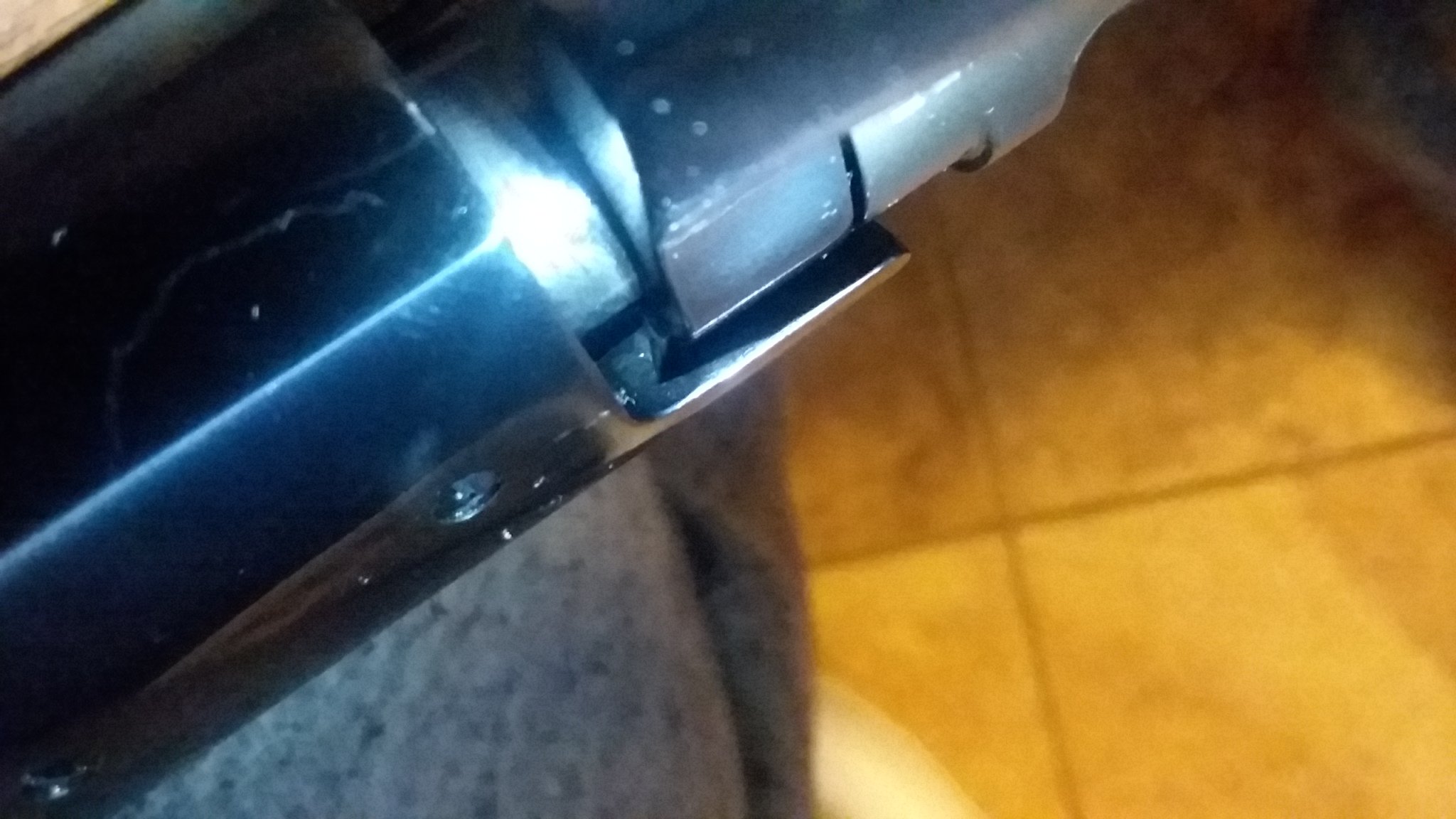

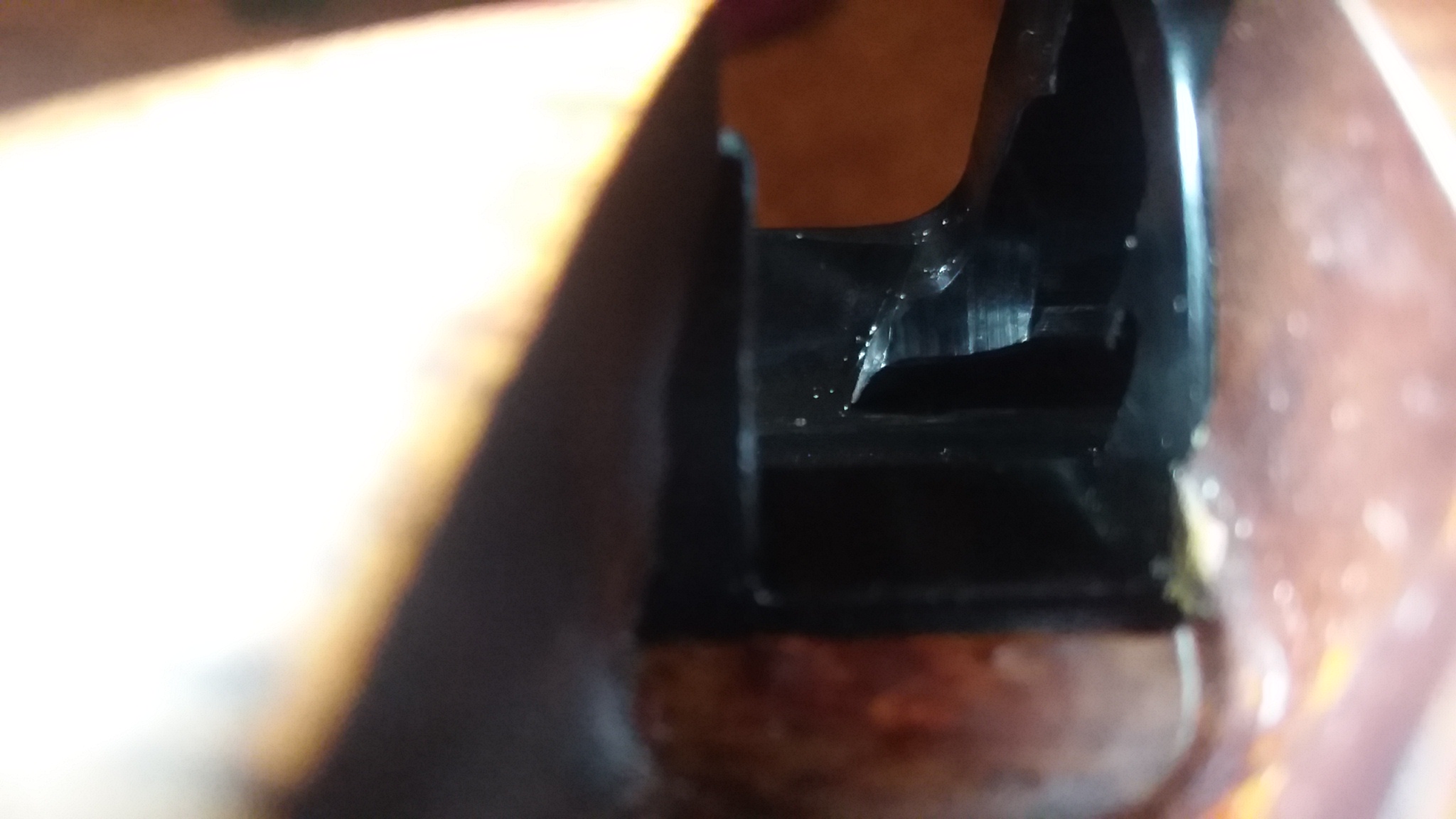

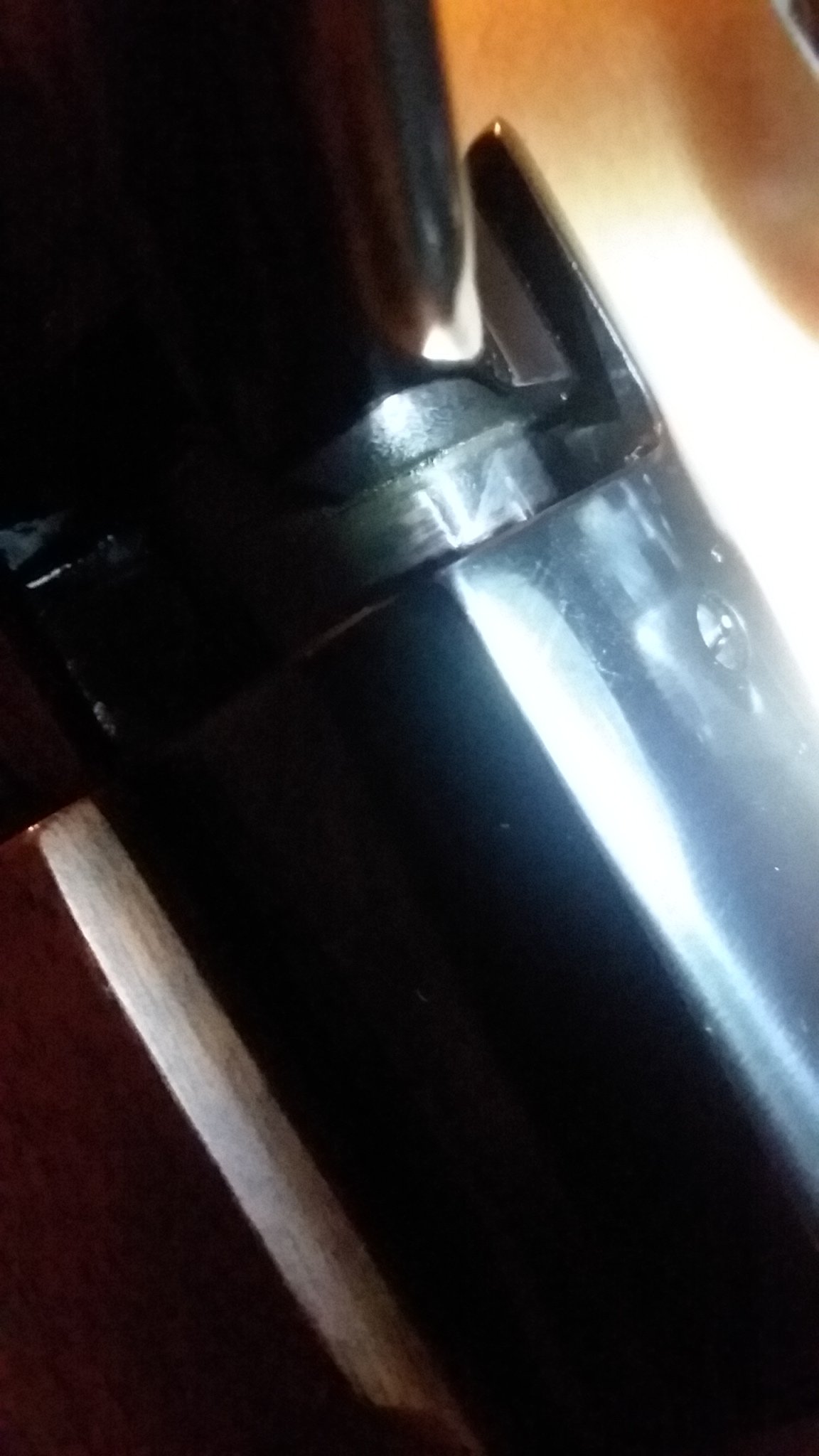

What is this indentation? None of my M70s have this. If it is in fact a dent as it appears and metal was moved down then that would pinch on the bolt raceway causing hard bolt removal.

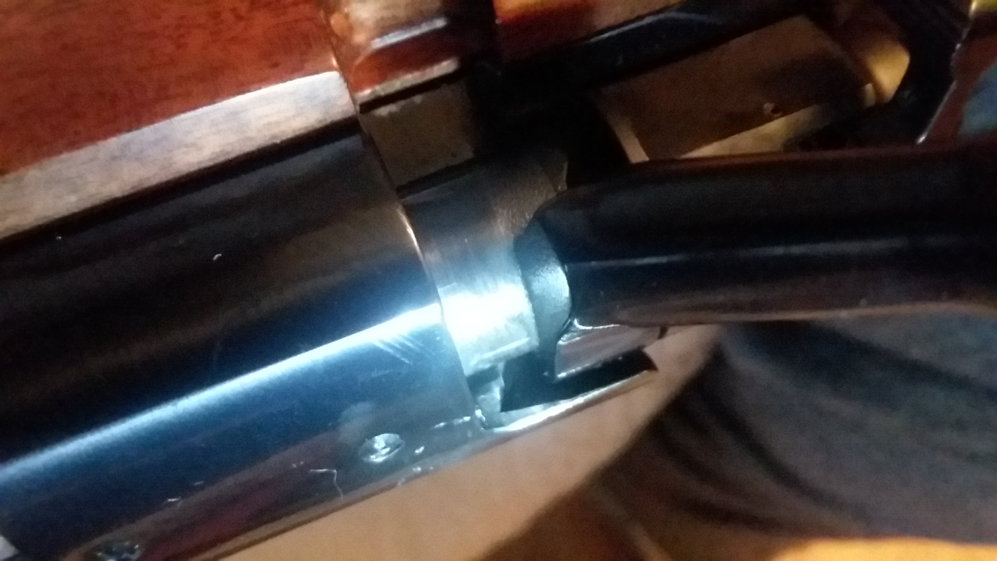

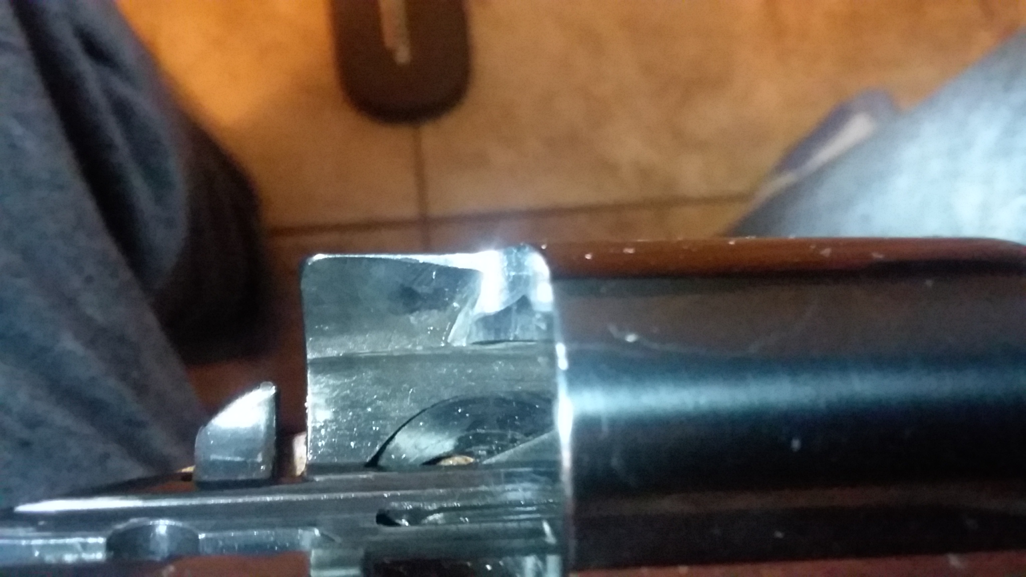

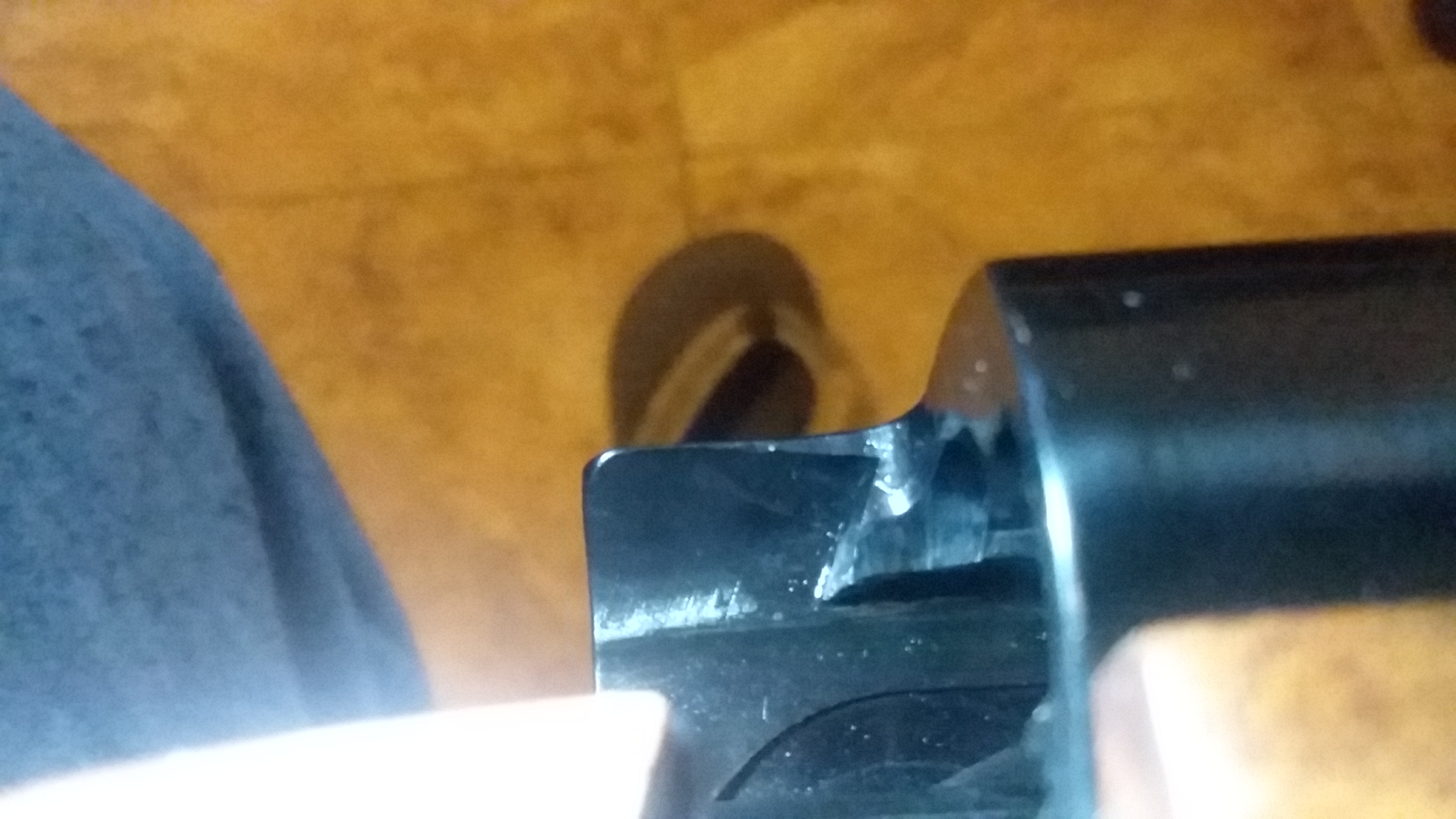

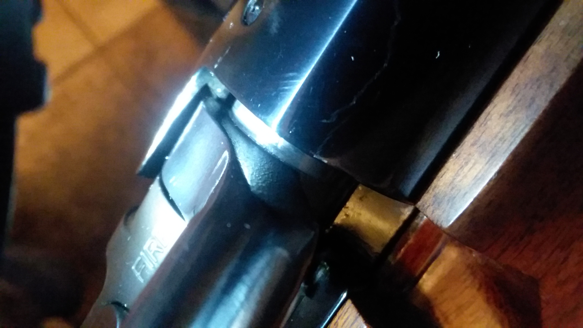

Here are some pics from the side.
It does appear that the "collar" of the bolt handle (where it wraps around the bolt) makes contact with that spot. There is a slight wear pattern on that part of the bolt handle, and this does appear to be the issue.
I wonder if grinding off a little metal from the dented part would be fine?

If that’s a brand new rifle I’d send it back to Winchester.
If it was some family heirloom then I would fix it and rock on.
It is brand new in the sense that I took delivery of it about a month ago, and it has never been fired. But I don't feel right about returning it as faulty if I know that I received it in properly new condition. Unless you're saying that the action should be able to withstand being beat up by the bolt slamming into it, and that the metal used for this rifle was faulty?
Naaman, DO NOT GO GRINDING ON PARTS OF THE GUN WHERE YOU HAVE NO CLUE WHAT YOUR DOING! Your receiver looks perfectly normal and the part of the receiver in your first picture is the camming surface for the primary extraction of your rifle. Don't go messing around with this part of the receiver. The Win 70 bolt release will jam up if you pull the bolt all the way back and then try to push the bolt release down without releasing rearward pressure on the bolt. Pull the bolt back, let it go then push the bolt release down.

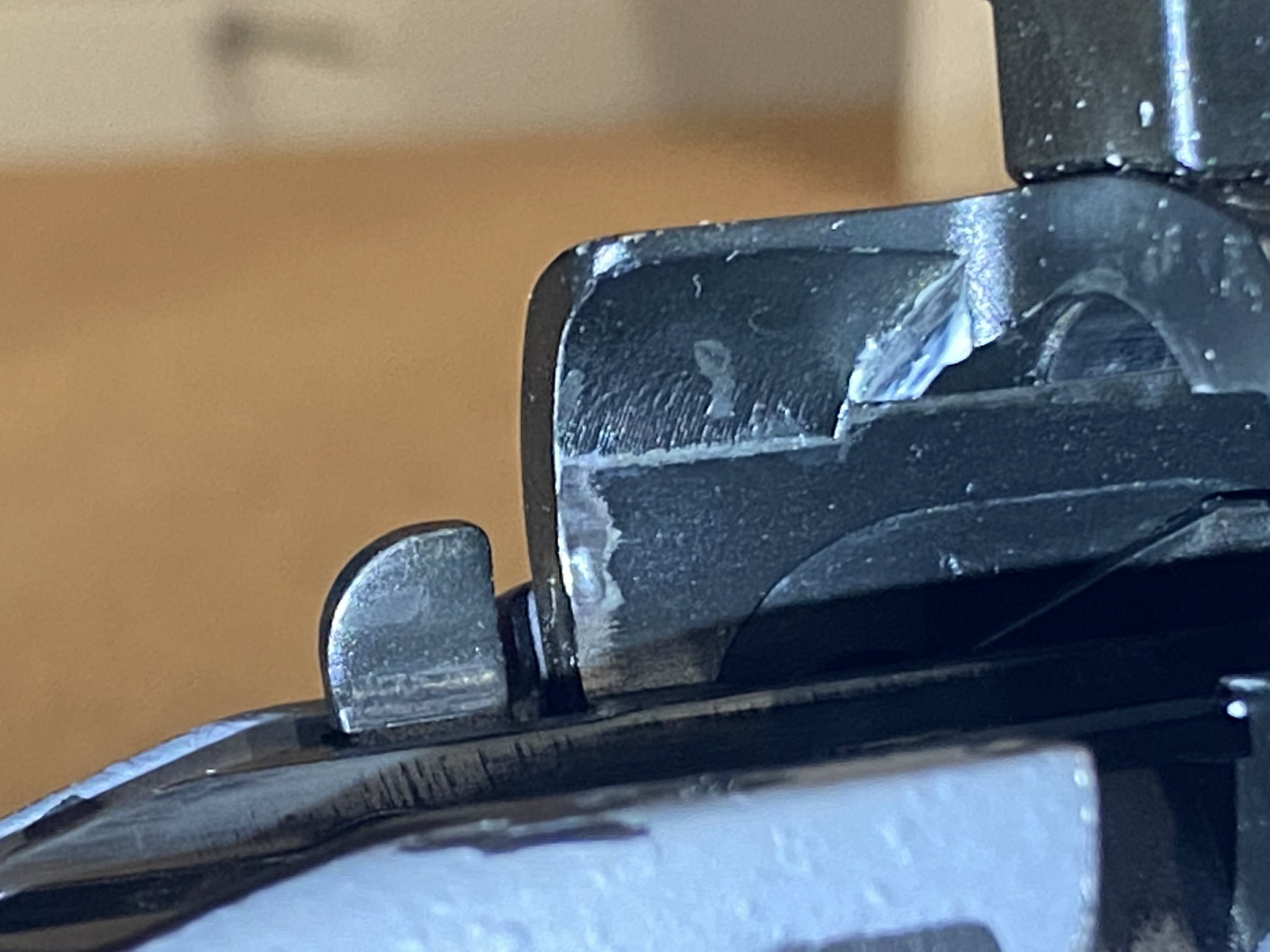

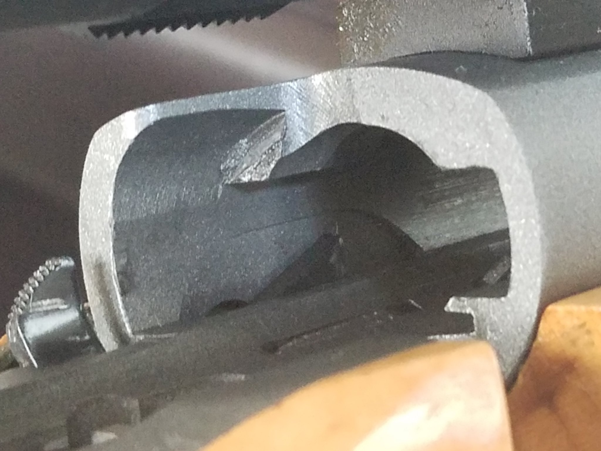

Here's a picture of my FN SPR receiver which now has over 5,000 rounds through it and functions flawlessly

With that kind of binding, something is amiss. At least you can get it to someone who can assess what you really have going on.
Added: As M1Match said you can't have pressure on the release to push it down. Put your bolt in mid-positon, push the bolt release down then pull the bolt back and remove it.
The bolt release is not the culprit.
There is some metal on the rear section of the action, upper left corner if looking from behind the rifle. That metal has become deformed from the bolt being slammed forward with excessive force by my son during dry fire. The deformity created a clearance issue whereby the front portion of the bolt cannot pass through that section unless forced.
Okay,
That is not normal to deform from running a bolt fast and hard. Military and Police train with those exact rifles that way. Your 8-year-old isn't going to produce enough force on that bolt to deform the action to where it's going to bind. If you find something stuck in a crevice somewhere, that may be your culprit. Actual cause, not result of actual cause. That's really what you are looking for.

Naaman, I take back what I said about your receiver looking normal, I looked again and you are correct, I see the problem area. I stand by my comment to not grind on that part of the receiver yourself since it is the primary extraction cam surface and if you mess something up it is much harder to fix than having a good gunsmith do the fix for you.

When I inspect the bolt, it appears to be undamaged. As to whether it is loose, I am not sure: I don't have a frame of reference for comparison. It SEEMS fine, best I can tell.
I took the rifle to PCR today. He said he'd have it done in an hour, so I went to a local diner and got some breakfast. Came back and it was done. Action slides out smooth as glass now.
Kieth charged me $0 to file down the burr.
That's hump number 1 of 3 cleared before I can actually put rounds through this rifle and get it zeroed.
I asked him about rails and rings for a scope mount, and he basically affirmed my experience with regard to finding something that will fit my rifle. If anyone knows of a solid rail and ring combo that will work on a late model CRF M70 Featherweight (30mm tube), I started a thread here:

On whether the receiver is soft, I can’t speak to that but it’s almost inconceivable that Winchester would have let that rifle out of the shop with receiver steel that didnt meet spec, but having said that we’ve all seen sh*t happen. Plus he took the rifle to PCR and they didn’t bring up any other issues that hey saw...
From his pictures I’m guessing that the cutter that cut the primary extraction cam was dull causing the deformation that we saw.

The whole “working the bolt too hard” causing the damage narrative is silly as there isn’t any protrusion on the camming surface of the bolt to cause the deformation shown. There are multiple examples in this thread that show normal wear. My 7mag M70 is on it’s third barrel with untold numbers of rounds fired and shows absolutely nothing like what you presented here.
That action was either damaged when you got it and you didn’t catch it on initial inspection or was caused on your end. You wouldn’t be the first guy to screw up a new gun, it happens..... It would take a pretty hard strike to make a dent that size. How it happened at this point is irrelevant, you had a top tier ‘smith clear the obstruction so get out there and shoot it.
Haha! I know it sounds ridiculous, but literally the only thing this gun has ever experienced is dry fire. The fact that it happened is a head scratcher for me. I didn't "miss" it on initial inspection: the bolt came separate and was installed and removed twice prior to the issue developing.
The damage in the photo looks a lot more like a dent. In reality, you're seeing a weird glare causing an optical illusion. The pics from the side show it better. It was basically that the metal seemed to deform (smashed down, creating a burr on the underside of the lip), which caused the left side of the front of the bolt to drag on its way out (felt more like a snag).
